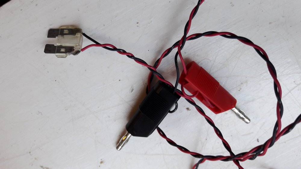

Done.  It lit a 21w bulb both ways round.  I assume that lays that mystery to rest, and that the diode is closed circuit?
New one comes tomorrow hopefully, so will repeat test on that before fitting, but may not risk fitting it until we've found the whatdunnit, dunno yet, it is tempting just to see if it is a fix and hope the short does not recur in a brief test.

I'd say that proves categorically that the diode has failed short-circuit, yes.
Important edit: If you do decide to test the diode in the new relay by your bulb method, be aware that a 21W bulb may draw more current when lit than the diode is rated to handle in its forward direction, and a brief inrush surge of considerably more when it's cold, so use a much lower rated bulb if you must. But I would stick to testing with multimeter. There's no reason to suspect it won't be working.  I do understand you wanting to see a difference, but don't want you to kill the new diode by overstressing it before it even makes it to the car!
I reckon you should chuck the new relay in when it arrives, repair the vac hose as you suggest and pat yourself on the back having fixed and improved the car.

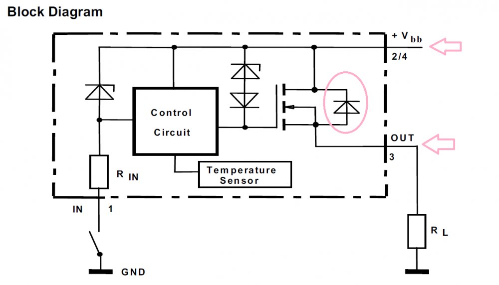

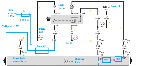

Only thing I'm still baffled by is the fault code pointing to the fuel pump relay, when the observed problem, and fuse blowing/misbehaviour is all focussed (thus far) on the ECU relay instead.
Relays do generate high-voltage reverse-polarity spikes when their coils are de-energised (example ref.), so it's possibly one of those that has killed the diode in the ECU relay.

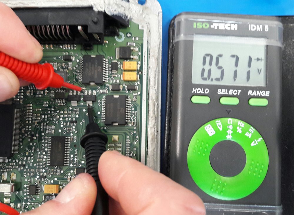

Relay just this minute came in the post, and checks out as it should for the presence of a diode and expected resistance across the coil, thereby further confirming demise of the old one.
As you say the fault code 17909, "fuel pump relay circuit short to ground" which did not recur after clearing remains unexplained, and so will have one more last go at a visual inspection of associated wiring in so far as we can even find it.  It occured to me that if there is a short in the wiring to the relay it ought to be possible to detect it by checking continuity to earth against the pins, or with ignition on, finding a voltage between a pin and earth, but without knowing what is to be expected at the pins, we wouldn't be able to understand what we found, and of course Haynes is as silent on such matters as its wiring diagrams are not wiring diagrams.  Mechanic says if you ask them they have to tell you, but their manuals are not available to their customers.  This would take too long.  We'll risk having to wait for another relay and setting fire to one of those nasty plastic fivers made from bits of animals in them, (and hopefully nothing else).
What you say about relays producing "high-voltage reverse-polarity spikes when their coils are de-energised" is interesting, but I'm not sure how it might be relevant here.
Are you saying that maybe the relay committed suicide, (ie. we are not looking for a further cause), and why you consider this a proper fix if everything works?  From the document you referenced I got that such 'transients' as they call them are dealt with by resistors in parrallel with the solenoid coil as one of the ways, and must be the case with this one both from the circuit diagram and the visible presence of a resistor.

Just thought of another useful measurement comparison you could do. Resistance of relay coil, old and new. Can't tell you pin numbers right now as I'm out walking the dog, but I reckon you can work it out. Use the pin without the diode.
If the coil on the old one has gone short circuit it could explain fuse blow and diode failure, I think.
Edited by Wino
  • Sponsor
But the relay couldn't work...
Dodgy theory that one.
