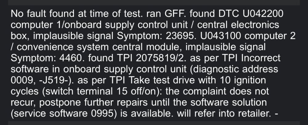

I have had an intermittent start issue with a 2024 Scala SE 1.5 TSI.
Often press start button, car tries to crank to no avail and engine management light comes on and occasionally EPC light. After a few tries it’s starts and no warning lights at all.
I called out Skoda Assist and it seems that a TPI was issued on the 04/11/24 detailing a software problem.
So, if you are having similar problems give Skoda Assist a call as they will pass this information onto your preferred authorised service centre after they have attended, then you can be added to the list.
I’ve attached part of the breakdown report I got after Skoda assist attended.
