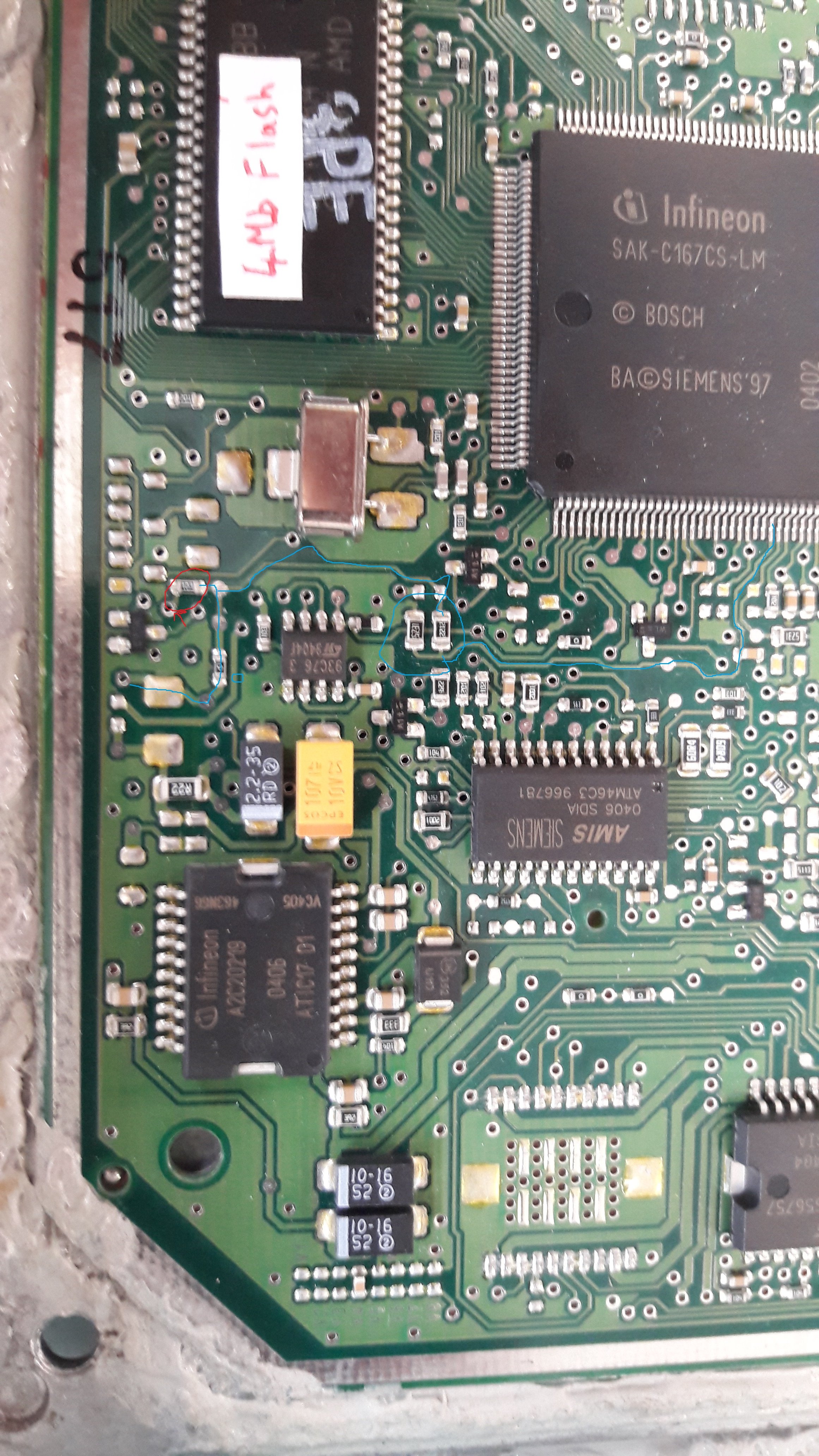

I have a spare AZQ ECU I can have a browse inside, possibly identifying some of the components/circuitry connected to those two pins.  That might suggest some possible (partial) failure modes whereby, for example, a component is taking more current than it should continually (rather than there being an intermittent condition), putting the diode in the relay, or the fuse, under more stress than designed for.
All speculative, but I'll dig out the ECU and take it to work tomorrow, should be able to have a look at lunchtime.

Would have been a waste of time looking at the other side, there's nothing on it. :)

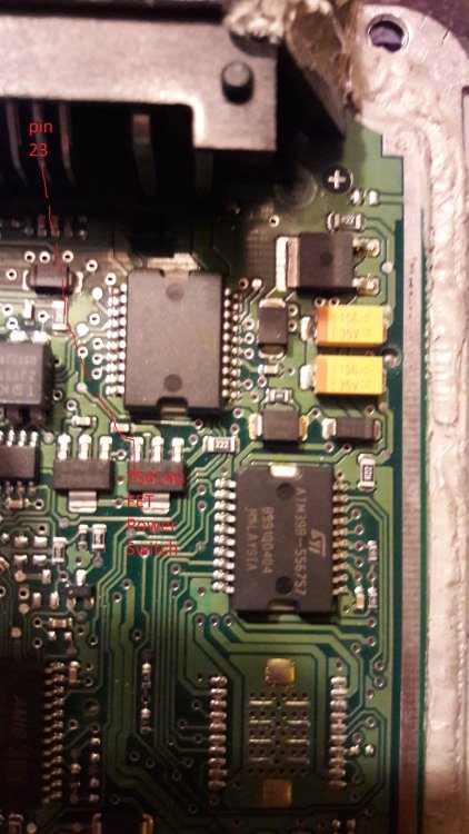

Pin 23 was relatively easy to trace, it comes from the output of a 'Smart' Power FET transistor as shown rather scruffily here:
Pin 62 took a bit more probing, but I eventually found it connected to at least a couple of things, one being the big chip in the middle, via a potential divider pair of resistors (ringed in blue) which I guess takes it from nominal 12V down to <5V as an input to that chip (telling it whether the relay is energised or not, at a guess). The other way, towards the red-ringed 10k resistor I haven't traced yet.  The resistor with the blue 0 next to it is a zero ohm link.
Edited by Wino
  • Sponsor
I can only think of two possibilities here at the moment. I have no doubt there are others though.
1. That power FET (link to a datasheet) has some internal damage causing it to fail to adequately deal with the switch-off spike that relay coils always generate when they are de-energised.  This could mean that the diode in the relay is getting a voltage spike instead, every time the engine is switched off, gradually damaging it to the point where it fails short-circuit, giving the strange back-feeding of 12V and blowing the fuse.
2. The voltage spikes are coming from beyond the ECU/relay system, for example due to an alternator fault.
It would be nice to compare an oscilloscope trace of what's happening at pin 23 (or pin1/86a of the relay) during shutdown/ignition off for your daughter's car (with new ECU relay fitted) and A.N. Other like ours. Also a comparison of voltage smoothness across the battery terminals might eliminate or point to possibility number 2.
It would be fairly straightforward to change that FET for a new one if the traces looked significantly different.  You could just change the FET anyway, but then you won't really know if you've actually got to the bottom of the matter.
Pin 62 appears to be monitoring the presence (and probably magnitude) of the voltage on the relay side of fuse 14.  I can't see how that could be the cause of any trouble.

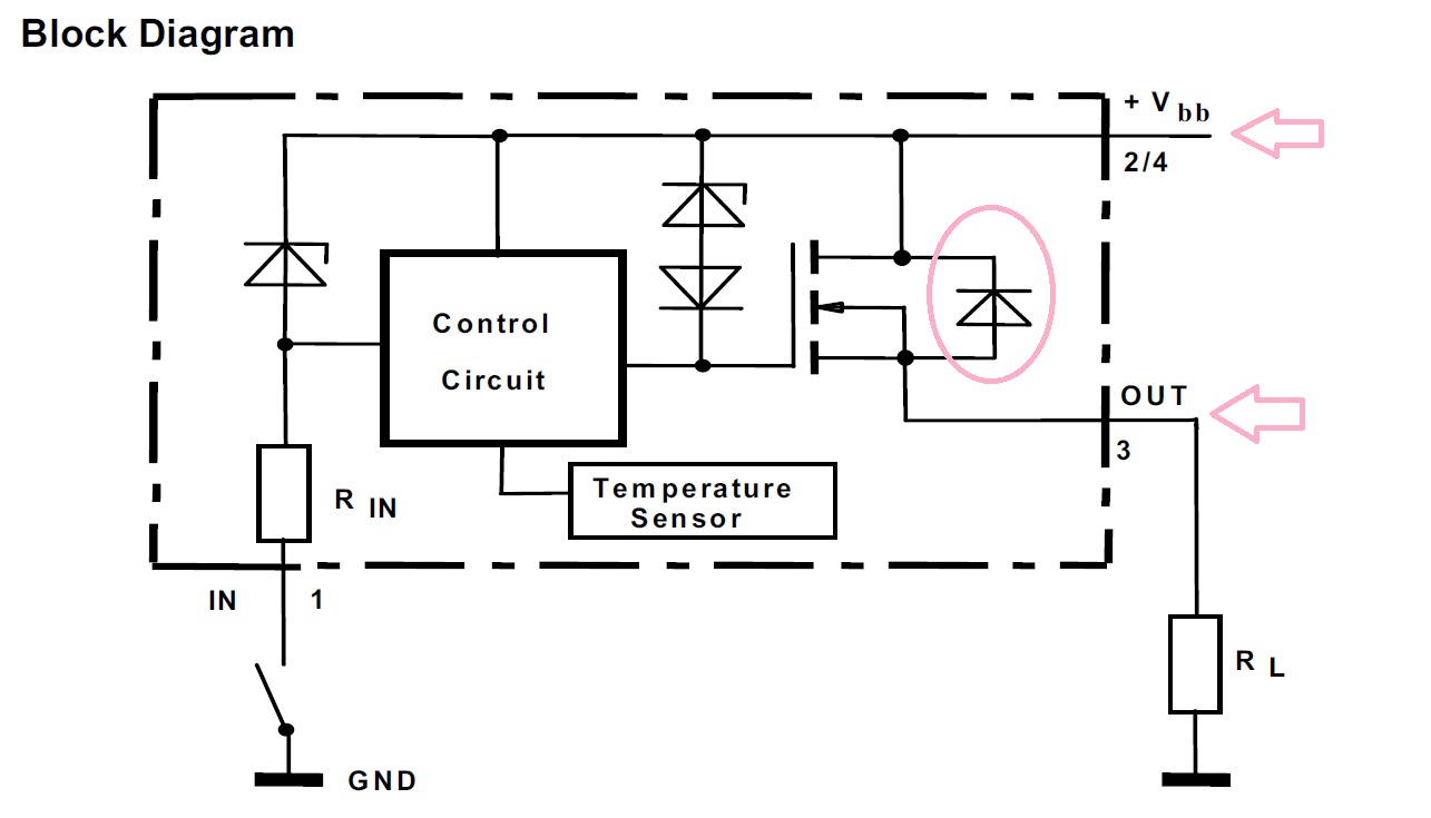

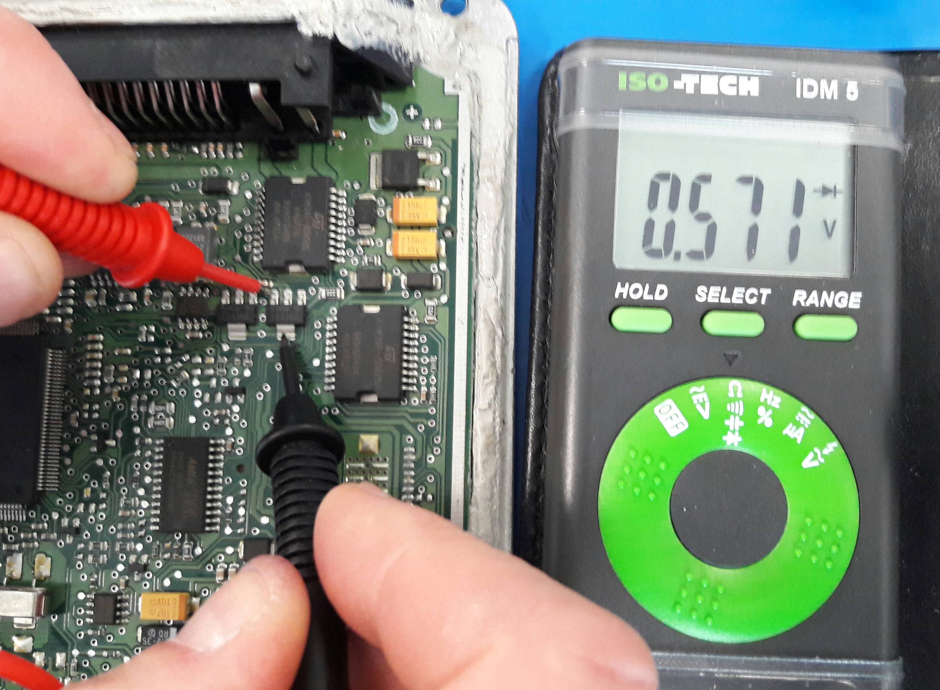

I have a plan though...The datasheet for that power FET shows you, on the right of the diagram, an internal diode that would tend to catch that switch-off spike when the relay is de-energised. With multimeter set to measure diodes, we could compare readings between pins of that device on our respective ECUs. If different, that would be useful evidence that your FET might be the problem?
  • Sponsor
FET block diagram with diode ringed, and positions arrowed for diode measurement, then an action shot.  With probes swapped, I just see a negative sign come up in front of the same number.
If you do see a significantly different number, try sliding your meter probes across to the other FET just to the left of the one I'm probing, and see how the readings compare between the two. On the pictured ECU both give the same number.

What an amazingly clear and instructive photo, thank you.
I've conducted the test and suspect that it does not reveal any anomaly.  both diodes read 650 on my meter which reads out differently from yours.  There is no decimal point in my readout, just 3 digits.  If I short the leads out it reads 2.  As a comparison, I tested the diode in the new relay which reads 634.
I would expect that the different numbers in our readings probably reflect comparative inaccuracies between our meters, unless your slightly different ECU has slightly different value components.  The consistency, and being in an expected sort of range seems more significant don't you think?  My meter cost something like £2.50 inc postage from China through ebay, LOL.

Yep, that test gives the FET the all clear in terms of the protection diode, I think.
I would have been surprised if it hadn't, because I think if that diode dies, the first subsequent victim would be the main guts of the FET, rather than anything external, but it was worth a try.

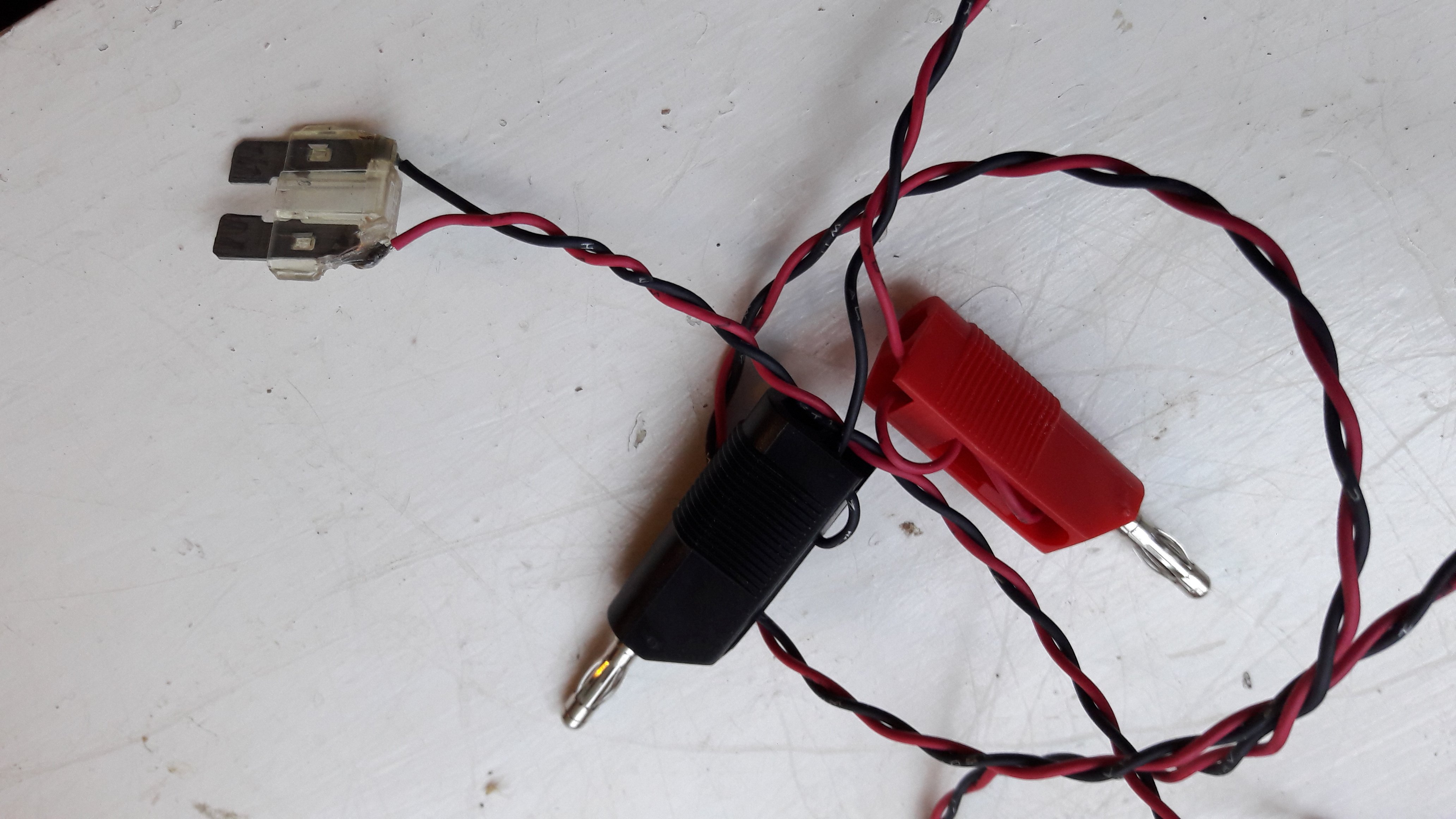

Well that was quite interesting. Widget fitted in place of fuse 52 (15 Amp).
Ignition on and the ammeter says about 0.35A, start-up (from cold) had a very brief blip up to about 2A, then settling quickly down to about 1A. Danced about a bit between about 0.85 and 1.25A. This is all at idle, sitting on the drive.
The interesting bit was shutdown. Key right round to off position: Brief blip up to 1.5A as the engine dies, then down to 0.7 for about 10 seconds, then down to 0.35 for another 15 or 20 seconds before finally going to zero.
I had been wondering what the 'secondary' feed to the relay coil from pin 23 was all about. Why does the ECU need to continue to arrange power for itself (its pin 3, via the relay) after ignition off? Best guess it's a little like shutting a computer down (well the ECU is one, after all) and it takes a while for it to sort itself out and get in a state where it's ready for the next start-up?
A bit surprised how little current the ECU/coilpack combo takes at idle, I guess the coilpacks will take an amount roughly proportional to revs, but I didn't try that.
Picture of 'widget':

  5. Fault condition – Internal diode in relay has failed short-circuit.  Now in scenario 4, when the ignition is switched off, chaos may ensue, because the FET will now try to power not just the relay coil, but back-feed everything connected to ignition 12V, via fuse 14. Depending on what loads (e.g. cabin fan) are switched on at the time of the ignition switch being turned off, the fuse will last more or less time before blowing. Furthermore, the conduction through the failed diode, down legs B and C to the voltage measuring circuit of the ECU, will mean that it doesn't even know the ignition is switched off at the key.

My brother realised that the FET in the ECU was a 'smart FET' that could not pass more than about an amp, and so that route for the diode shorting and fuse blowing as Wino described in note 5 above was ruled out.  In fact I think it is probably correct to say that if enough current to short a 10amp fuse had passed through the ECU board it would have left scorch marks and destroyed some components along the way.  I'm thinking that the nature of the event in itself weighed against the likelihood that a visually inspected OK board could have delivered such a current, but the Cannock testers said 50/50 chance of it being wiring or ECU.  Worth a visual inspection first therefore before committing to expensive testing I would say in these sorts of circumstances.
By the time that the very slow first class snail had slime trailed its way to Milton Keynes from Saturday to Wednesday with Wino's test lead for measuring the current draw of the ECU and coils, I think we had already worked out that the culprit had to be leg D in Wino's diagram, the thin .35 blue and green wire that connects pin 86a of the relay with pin 23 of the ECU.
Wino supplied me with a link to a video of his test of his wife's Fabia, showing the current draw and pattern of current draw on the multimeter throughout the sequence of ignition on, starting, running, and stopping.  I made my own similar video, and it seemed that the measurements were comparable, and so we concluded that the ECU was functioning as it should, and not drawing excessive current as the ECU testers had posited could be a sign of eventual stress failure.
Wino and my brother having deduced from an analysis of the circuit diagram that only an intermittent short to earth somewhere on leg D could have shorted the diode and blown the fuse, I set about trying to find out where the short was likely to be.  By testing continuity between pin 86a and nearby earth, I was obtaining more or less a dead short.  By testing between pin 23 and nearby earth at the other end of the wire I was getting a resistance of .1 to .2 of an amp, suggesting the short was at the relay end and measuring the resistance of the length of the wire.  This was then confirmed by measuring continuity from one end while waggling the wires at the other.  Nothing from the ECU end of things, but tugging on the wire to the back of the relay socket it became open circuit several times, and shorted, and all points in between, and activity furthest from the relay socket seemed to produce it.  We had found which bit of the wire the short was occurring on, but impossible access behind the relay holder, visually and physically, as well as fruitlessly searching high and low for my endoscope, has robbed us of the possibility we may have got a visual of the actual short, and perhaps some idea as to what could have caused a short in a pristine and never visited deep region of behind the dash against the bulkhead.
