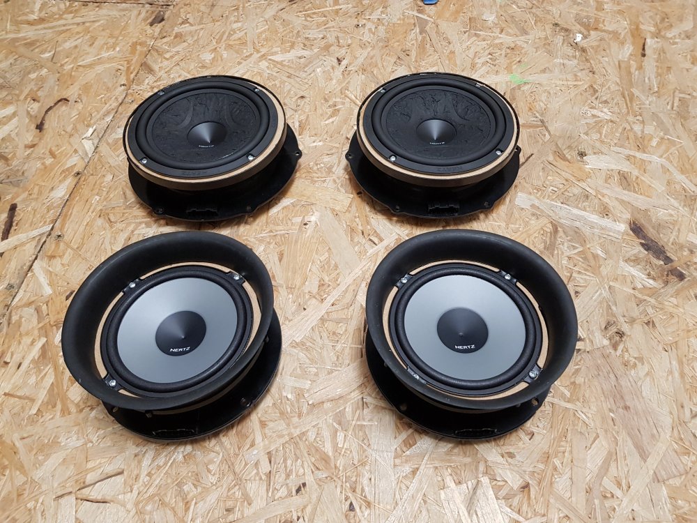

I found this thread after buying a 2014 F/L Elegance Yeti and finding the standard Bolero 8 speaker system lacking. I agree with the comments of Andy916 and sampo regarding the harsh treble. Retrospectively, I quite frankly disagree with the other members that advised to keep the stock setup 'who know a thing about audio'. It really is poor.
Replacing the stock speakers was the first avenue for modification for me. Finding information was a little difficult but there are some useful threads on here. I removed a front and rear door card after following some clear instructions to take a look. A few car audio YouTube videos recommend using pre-installed design features to increase midbass. In the Yeti, these features include damping foam between the riveted speaker carrier and the door skin in both front and rear woofers and a rubber seal in the front door card that fits around the woofer carrier and a rubber cone around the rear woofers. I can only surmise that these features are there for directing the sound into the car rather than being lost inside the door and reduce vibrations into the interior card.
A F/L Yeti is fitted with:
Front:165mm component speakers.
Rear: 130mm component speakers.
Both have passive crossovers soldered to the tweeters manufactured by mass production car audio company, Sonovox.
Mounting depths:
There was no information that I could find online regarding mounting depths for replacement aftermarket speakers in the Yeti. This was the primary reason for removing door cards prior to choosing make and model of replacement speakers. Here are a few measurements.
Front :
With window glass fully down, from front edge of metal door skin to window glass is approx 50mm.
51mm from front of metal door to front edge of speaker mounted on stock speaker adapter.
Stock speaker mounting depth, 77mm
Stock speaker adapter height, 40mm.
Rear:
Tweeter clearance 40mm
Tweeter diameter 33mm
50mm from front of door metal to window glass.
Spacer depth 30mm
Mounting depth of stock speaker 50mm (56mm with lip)
I went with the Hertz ESK 165L.5 speakers in the front and Hertz UNO k130 in the rear doors. With cutting pliers I removed the stock speakers from the carriers and made mdf rings to mount the woofers to the moulded OE carriers. This way, I was able to keep the fitting of the front door card with the rubber seal around the carrier and maintain the rear rubber 'funnel' type pieces. I then took these pieces to my local car audio shop for the chap there to remove and glue in the tweeters and wire in the crossovers/fit dynamat sound damping insulation. This work was carried out for £90. Reasonable I thought.
Music in the car now is much more pleasurable. With regards to volume, having speakers with a higher sensitivity the stock 4x20 RMS is ample.
Ultimately with the design of the 8 speaker configuration in the Yeti, the bass drivers are towards the back of the door pointing into the driver's and passenger's hip while the tweeters are more focused at ear level. The addition of a 100mm midrange speaker (found on the 12 speaker configuration) would definitely help this. A good sound can be achieved with the Hertz speakers, especially if the crossover switch is set to the - 2db that feeds the tweeters but if I was buying again I would probably choose aftermarket speakers with a silk soft done tweeter rather than a metal tweeter to soften the treble further to compensate for the Yeti layout.
Quite a lengthy and geeky post, but hopefully it might help someone choose /fit aftermarket speakers in their Yeti should they wish.

I ended up using a grab adhesive for my mdf rings. Specifically it was Nemesis used in a mastic gun.
The glue is massively strong, suitable for interior and exterior use, so will resist moisture and dries to a rubberised consistency thus eliminating unwanted vibrations.
A year later and I've had no problems since installation.
Yes, it did involve work but every time I drive the car I have no regrets. It sounds loads better and music is enjoyable.
