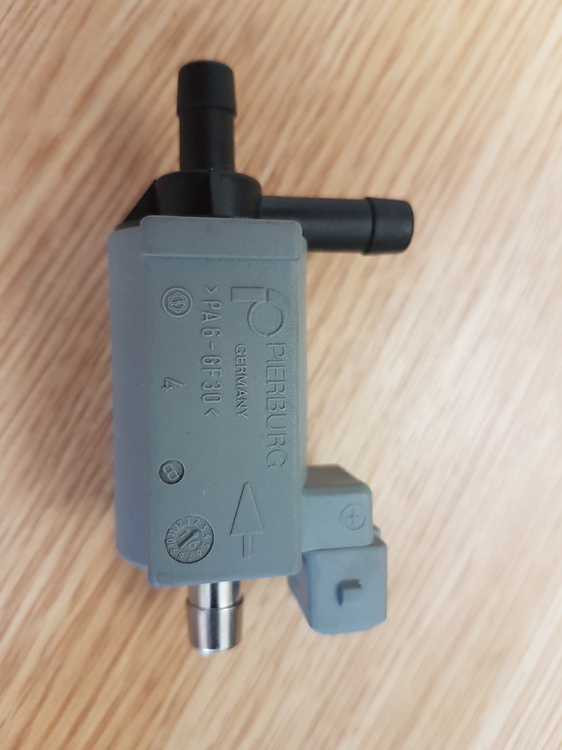

Need to fit a new N75 valve, but my new one is very different from what's fitted.  Has anyone fitted this newer version, and if so, what inlet fits where?  Many thanks in advance
That dont look right to me.
What's the part number, should be able to tell from that.
I have a spare N75C valve if that is no good...
rgds
The part number on the box is 078-906-283-A.  It's a Pierburg PA6-GF30. Got it direct from the local Skoda dealer.

Never seen a N75 like that on any VAG 1.8T that I've owned.
Should be 058 906 283C which I think was revised to 058 906 283F
Thanks for that pauldazzle.  That's what I was looking for.  Any ideas on what they have sold me instead?
Thanks for letting me know.  Skoda are getting kicked in the pods today!!

I thought that looked like a N249. defo not a N75.
