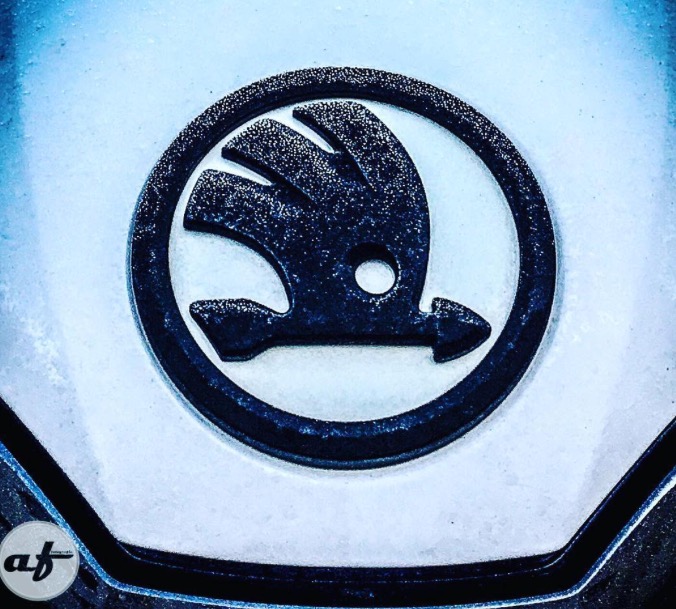

Black & White skoda emblem
The best results are from using a black magic emblem, taking it apart and spraying the back plate your chosen colour.
But I got reasonable results using plastidip and adding clearcoat on top.

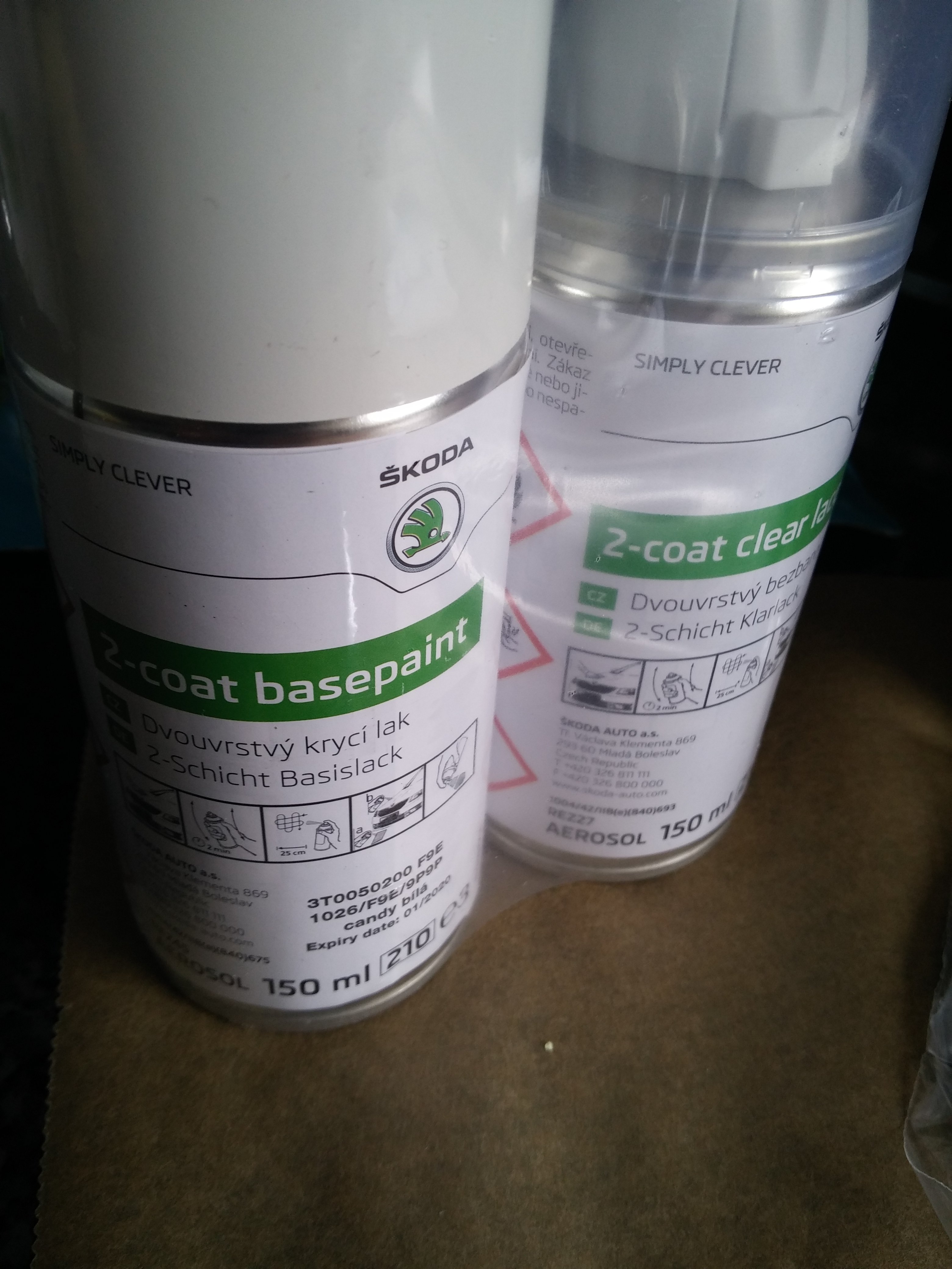

I got the candy white on my car MY14,
List of what I bought from Skoda dealer:
5JA853621AUL = front and rear badge.
3T0050200F9E = candy white and clearcoat spraycan
I had black skoda paint since my last car..

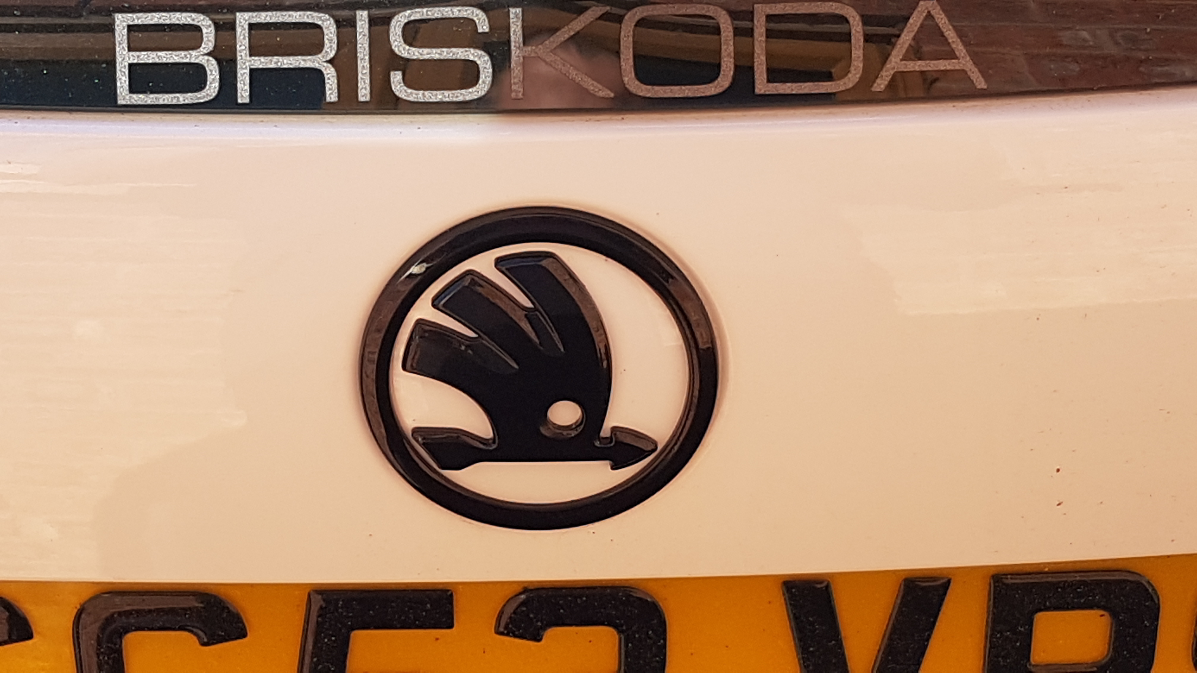

Just fitted mine, 20% off the other week.

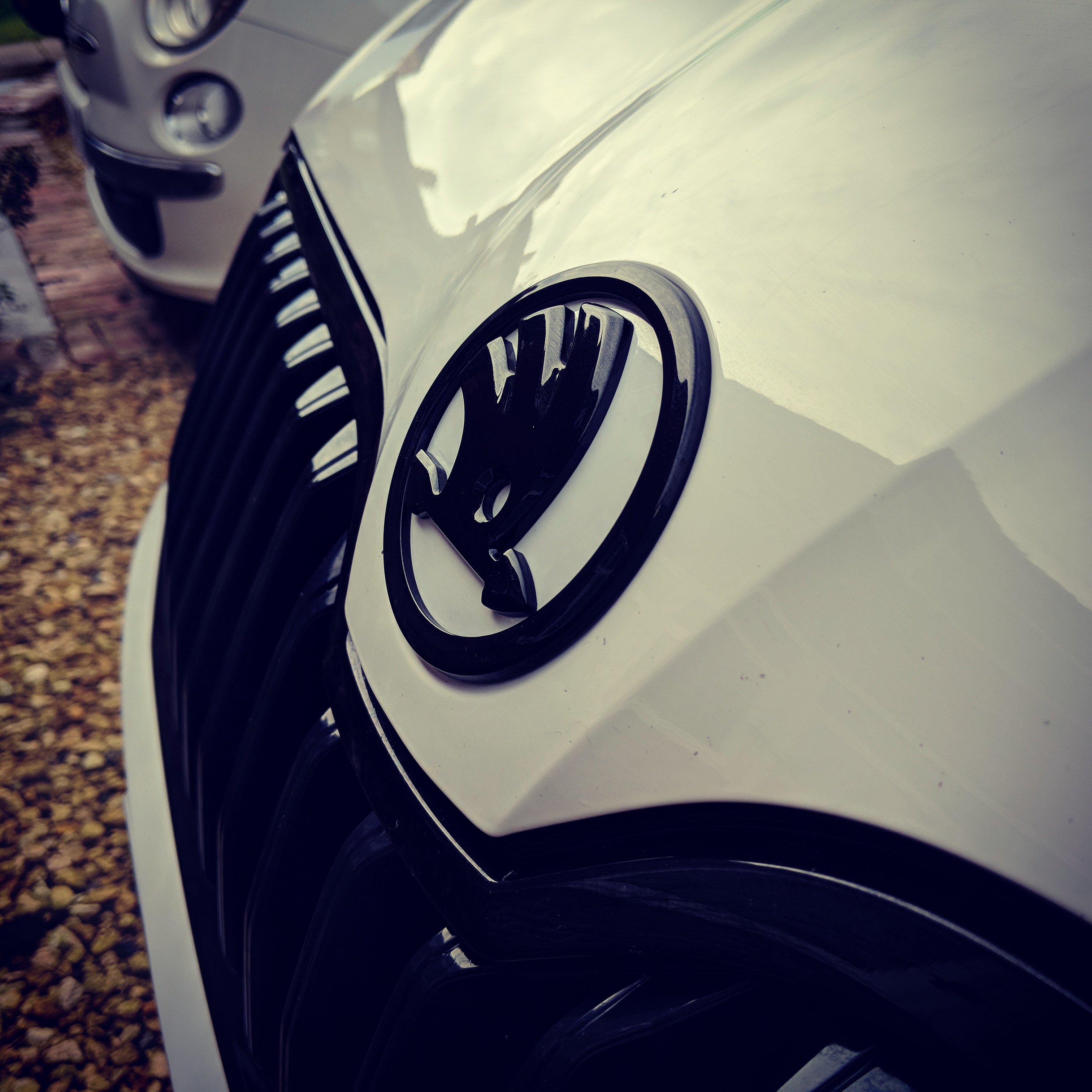

On 08/03/2017 at 18:20, pist0nbr0ke said:
Paint (and lacquer) from here.
These badges.
Plastidip from here.
About £50 all in for both badges and paints, so a good bit cheaper than two of the black OEM Monte Carlo ones from Superskoda, although it takes time and patience.
And you will have plenty of paint left over for further experiments ;)

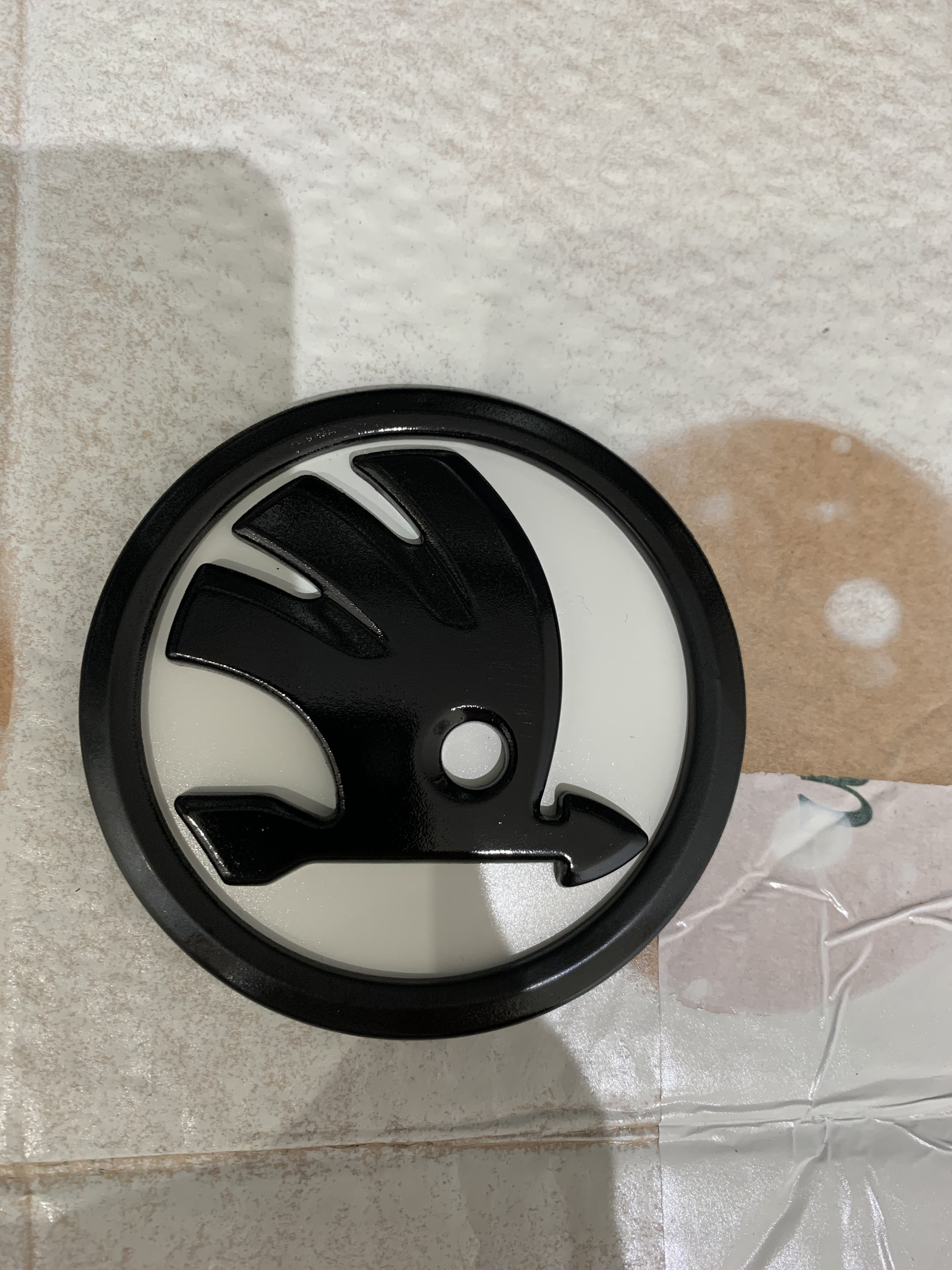

Having read through this topic I thought I’d give it a go after not really liking the full black emblems you can get. I purchased my badges from this guy:
https://www.ebay.co.uk/itm/203092116751
And bought all the paint from sparesworlddirect on that auction site, which came next day.

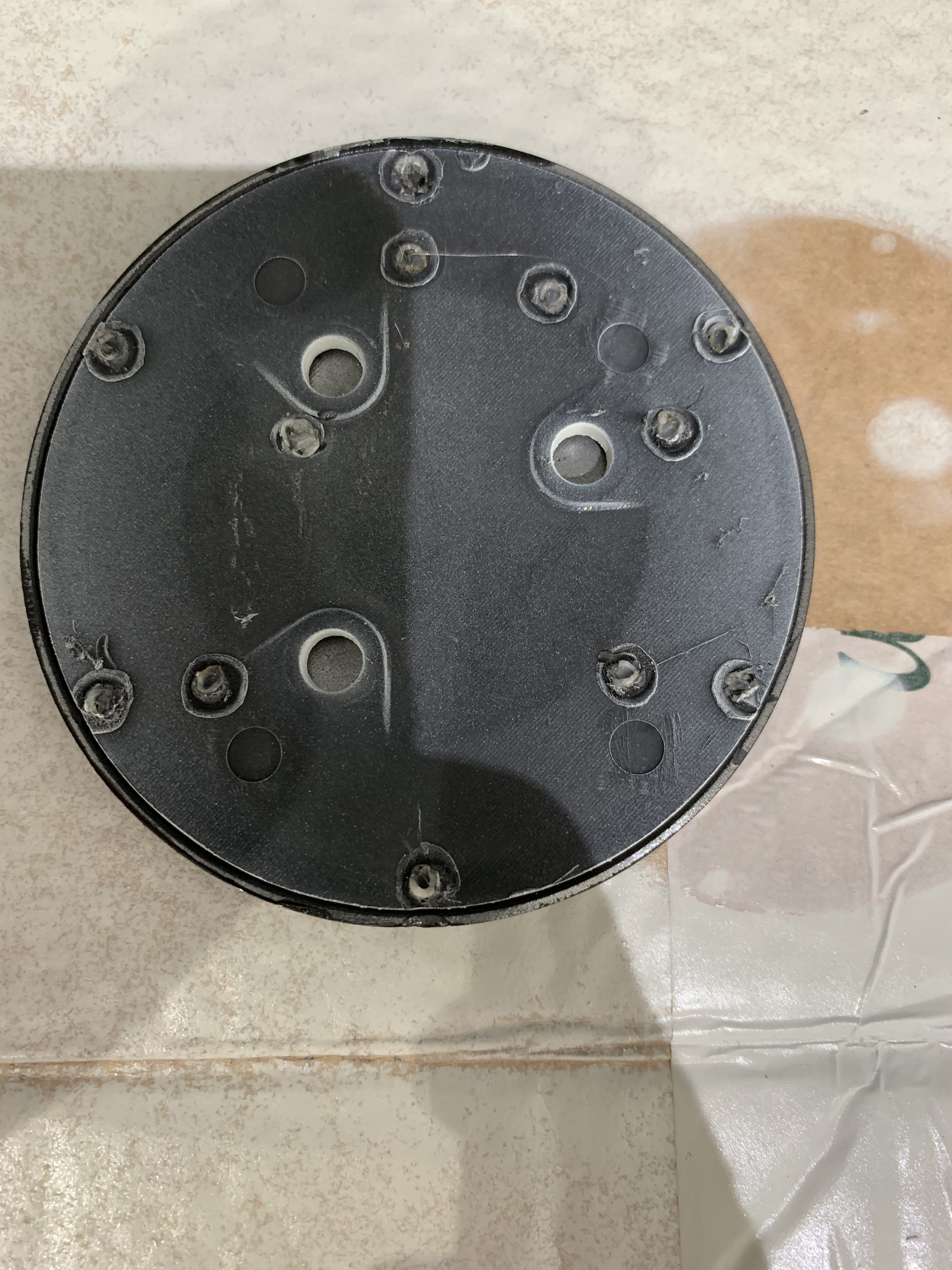

the badges seemed to be held together not by clips but by little lugs that looked like they’d been melted so they mushroomed. I simply cut the melted plastic away and the badges came apart. When putting back together, I used a soldering iron to do the same and it seems to have worked. All I need to do now is finished some lacquer coats and then I’m going to use strips of gorilla tape for the back. Here’s some images:
8E01D7E5-8CCC-408C-9070-342028CE9920.thumb.jpeg.12a2bee06991dee4ccf75002a5a2e29c.jpegE2A6C803-77BB-479D-A956-FB7E993DD5ED.thumb.jpeg.20a550e91176197724bb194ea3e21f24.jpeg
