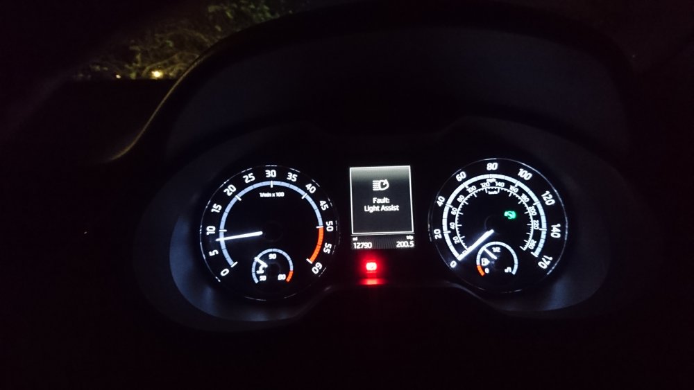

Hi all,
I recently had a tow bar fitted to my Jan 14 VRS, TDI, DSG Kombi Octavia.  It was done by a reputable local garage with a Westfalia removable towbar bought from PF Jones and the car had towbar prep installed so there has been no interference with fuse box or wiring other than to plug in the control module.
Shortly after installation I noticed that the high beam assist now shows a fault and does not automatically dip when a car comes the other way.  The headlamps go through their normal sweep when switching them on so the towbar doesn't appear to be the cause, however, my dealer says they have seen another Octavia with a Westfalia towbar which was causing other electrical woes in the workshop recently.
Has anyone one on here with a similar spec Octy and a Westfalia towbar had an similar issues?  I have searched but nt got any results hence the new question.

Yeah it went back in today.  I'll speak to them again in the morning.  They siad the coding was incorrect, changed it, the fault came back and the coding had reset to pre-towbar.  Very odd. I doubt it's the towbar but thought I'd ask... just in case.
Glad I have a 5 year warranty as it ran past 3 years old last week.
BTW, the fault code comes up without a trailer plugged in.  I had the towbar fitted in anticipation of buying a trailer, but haven't got that far with that plan as yet.
Update.
Local Skoda dealer had the car in the other day and ended up having to pull the fuses on the towbar electrics to make the high beam assist work without showing an error.  They showed me it working with fuses out and bringing up the fault with them back in in.  I am now convinced that the Westfalia kit is causing this issue (how, I do not know, but it is)
