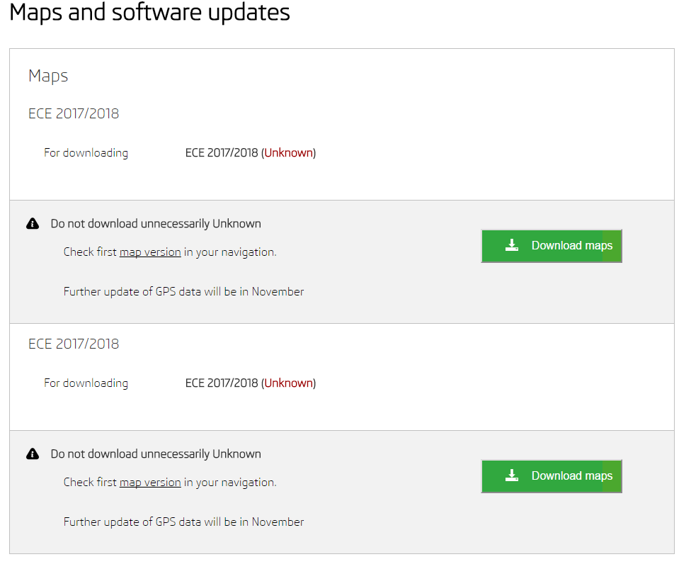

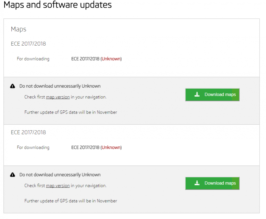

When I go onto the Skoda Upgrade Portal I get the following options, do I need to download both, or are they both the same?
This always appears far more complicated than it should be!
They're the same, they both point to the same file - HIGH12_P161_EU.zip so use either one or the other but don't use both.

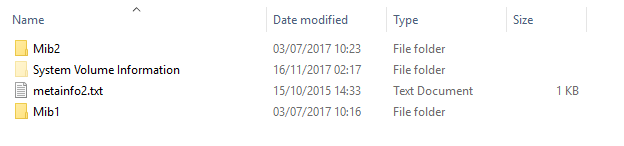

I've decompressed the .7z file. And I've downloaded Tinkertool to get rid of the .ds that the Mac OS likes to write. I'll try that before I spring for Blue Harvest, being the freetard that I am...
The expanded .7z download shows four files: metainfo2.txt, Mib1, Mib2 and P161_n60s5mibh3_eu_nt.md5. I'm guess the last of these is not meant to be included on the SD card?

... and P161_n60s5mibh3_eu_nt.md5. I'm guess the last of these is not meant to be included on the SD card?
You guess correctly. It's a download checksum file and not part of the actual update.
