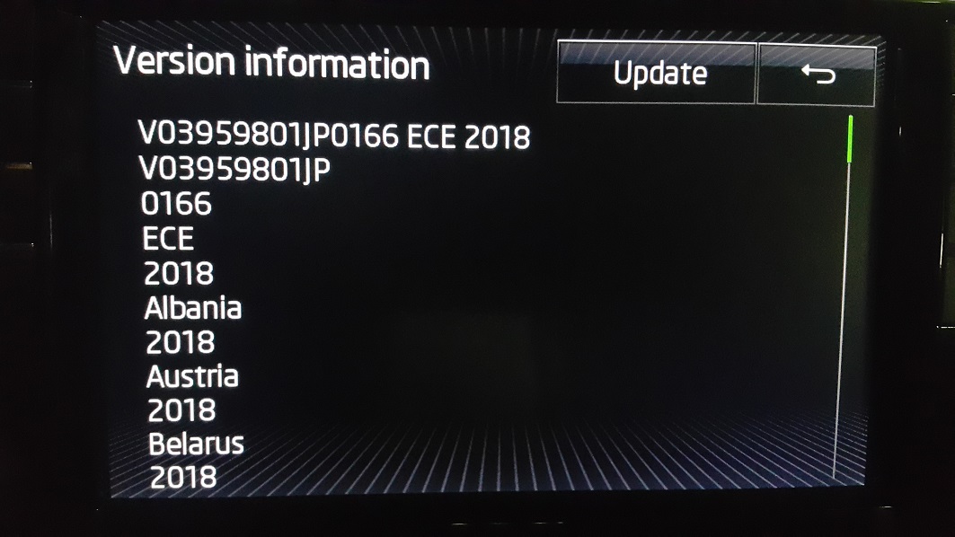

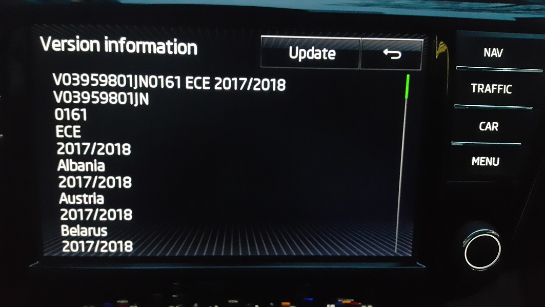

how do you think, why did i add lines "publicated:" and "Files inside:" in post?
https://www.briskoda.net/forums/topic/440808-columbus-map-update/
just check out version in your system
new:
previous:
+ 1
I downloaded the files in @MartiniB's link and updated from 161 to 166 as your screenshots show. Maps were showing 2017/18  now 2018.
