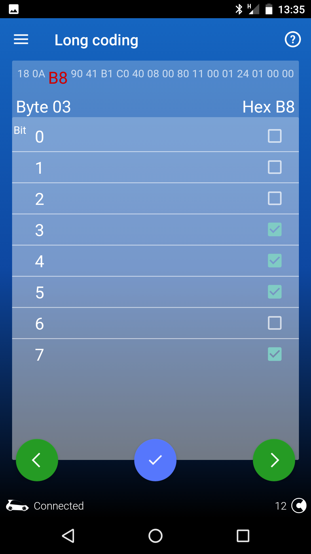

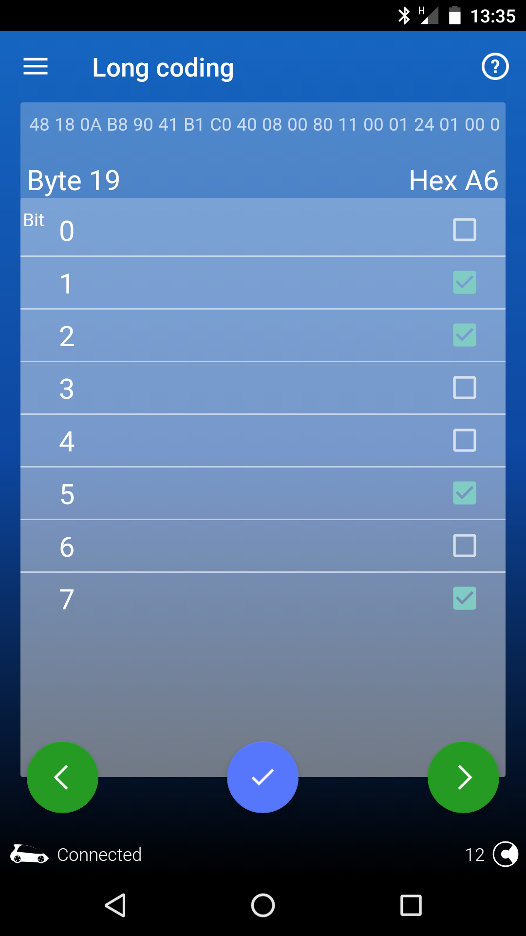

Hi all, so I'm trying to code my HIDs with OBD eleven rather than VCDS. I have access to a friends VCDS but want to try this the app first.
So, I've found from other searches that I should change in module 9, byte 3 bit 4 to enabled and byte 19 bit 3 to disabled.
So looking through the app when connected, I get the below screenshots:
Does this look about right? Any other bytes I need to change at all?

I think it might, I'll find it after work and post it. In the meantime, I managed to find that byte 14 bit 4 might do something I need too. Is that right?
It will depend on what module it is.
Cheers mike, good idea! I fitted them 2 days ago, so may take them out now! Is there any way of telling what kind of module I have if I find the module part number?
