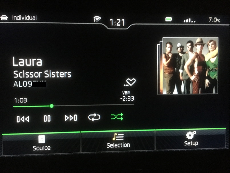

In the last 12 months since I started ensuring the metadata is complete and accurate* for every audio file, be it original albums or home-made compilations, whether on the Columbus Jukebox, SD Card or USB, I've never seen Columbus forget the track it was last playing. This works for me [1] if I've switched off and later returned to the car, or [2] I return to an audio source after having switched to another audio source.
Now every track that plays on my Columbus shows the song name, artist, album name and artwork...
* For best results ensure a minimum of: Artist Name / Album Name / Track Number / Album Artwork
For double albums or multi-disc albums either number the tracks 101, 102, 103... 201, 202, 203... etc, or alternatively specify the Disc Number, or even do both.
I also read somewhere on this forum that VBR (Variable Bit Rate) doesn't show the song progress. I think the picture above proves that wrong.
And I apologise for it being slightly out of focus but not for my taste in music - hic :party:
