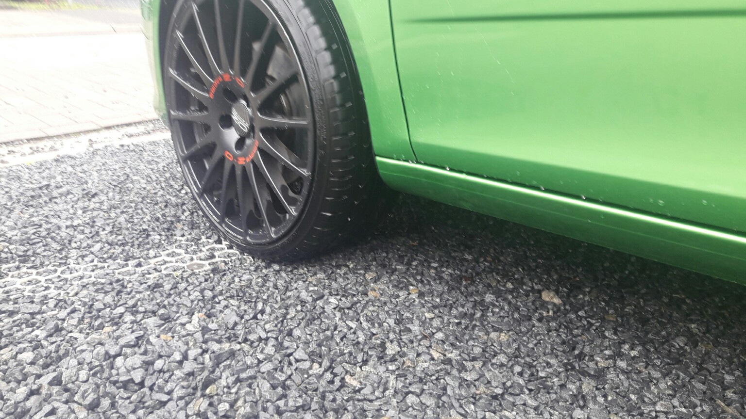

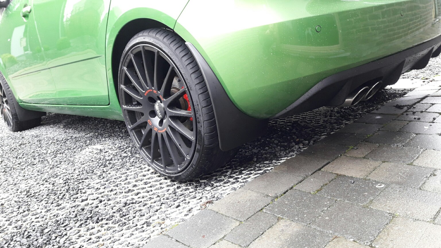

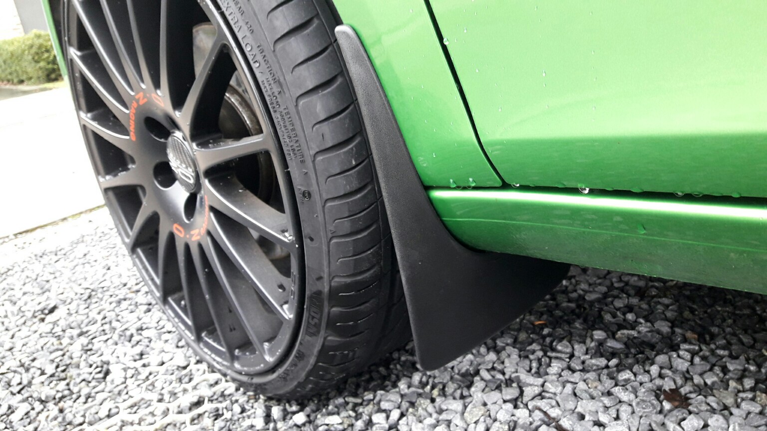

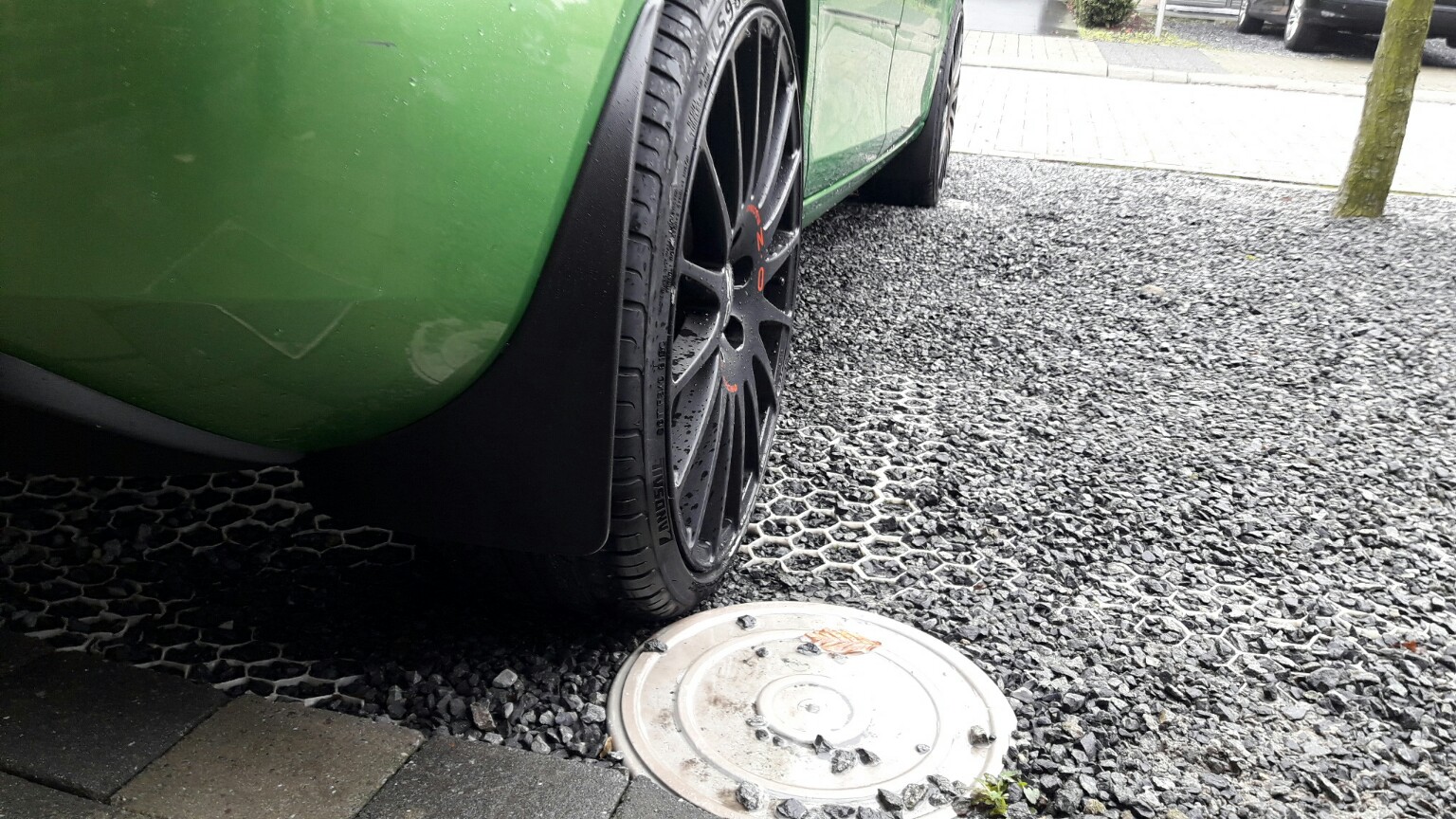

    So the mudflaps where a pain in my ***  Because of that 18inch oz that i didnt remove . It was almost impossible to get to the torx20 bolts So there on the vrs now . Looking nice and supergo
  • And done ^^ superhappy how it came up.  Easy job with much joy after.
  • Prefer the much rarer grey myself ;-)
So there on the vrs now . Looking nice and supergood fitment

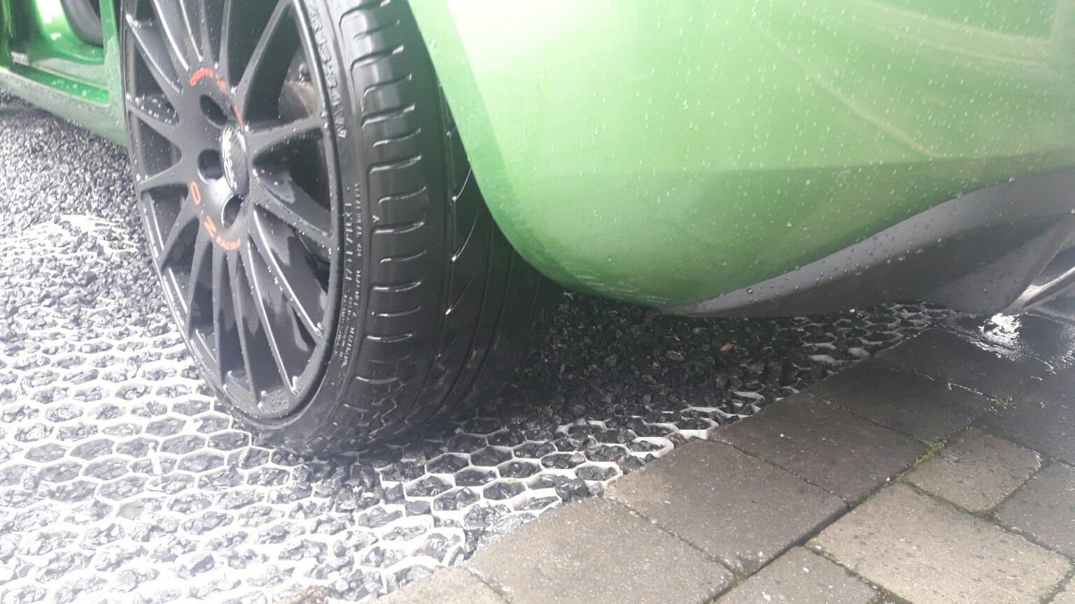

What size alloys / tyres setup have you got, All the best alloys seem to be listed as either (17x8) for tyres 215/45 /17 or they are (18x8) for tyres 215/40/18
What rim size is yours ? thanks
Edited by Kobayashi
Ok found them 35R?
The mudflaps do finish them off don't they? I fitted some to mine within a week of having the car!
Your car is starting to look smart
Yeah its getting better step by step . That previous owner didnt care for it much...

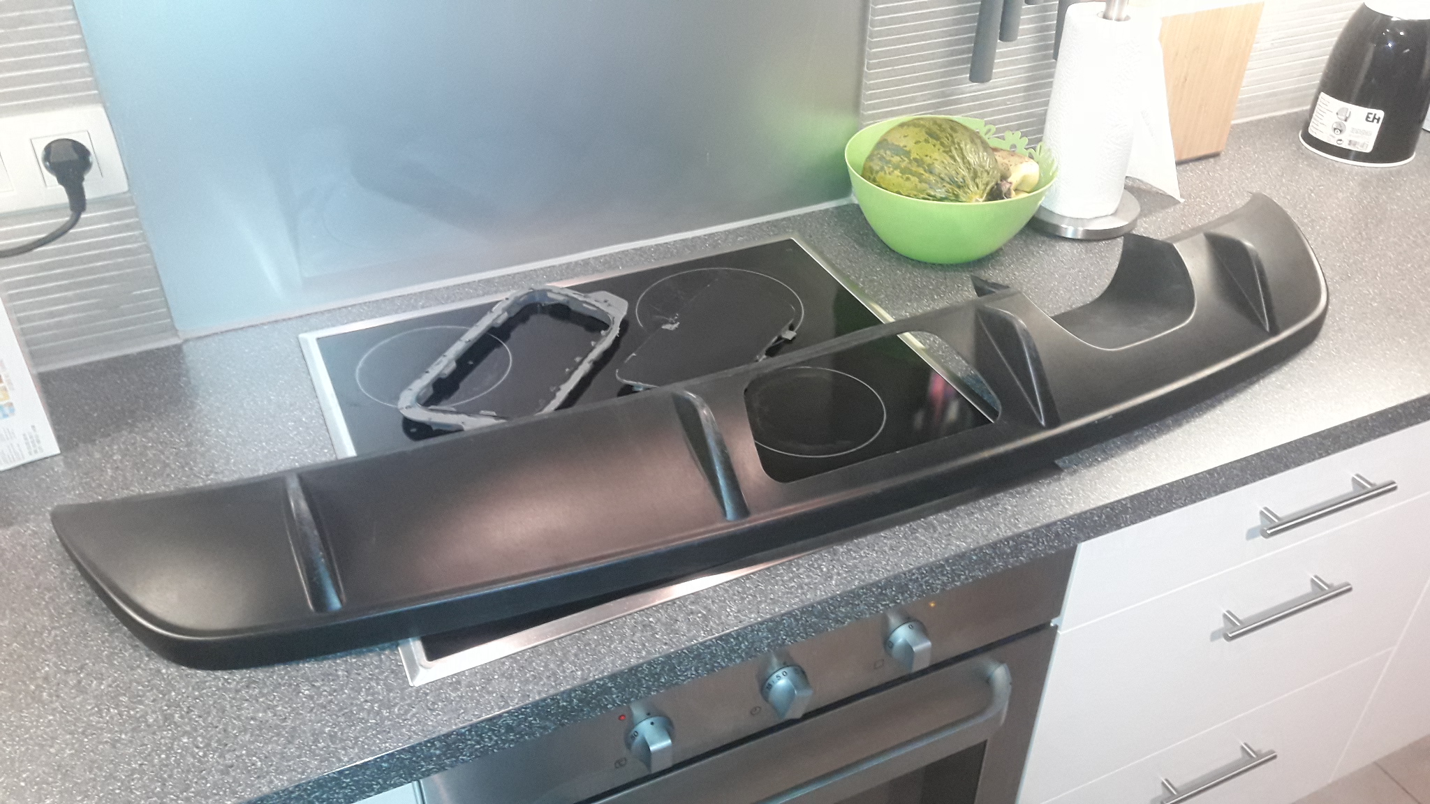

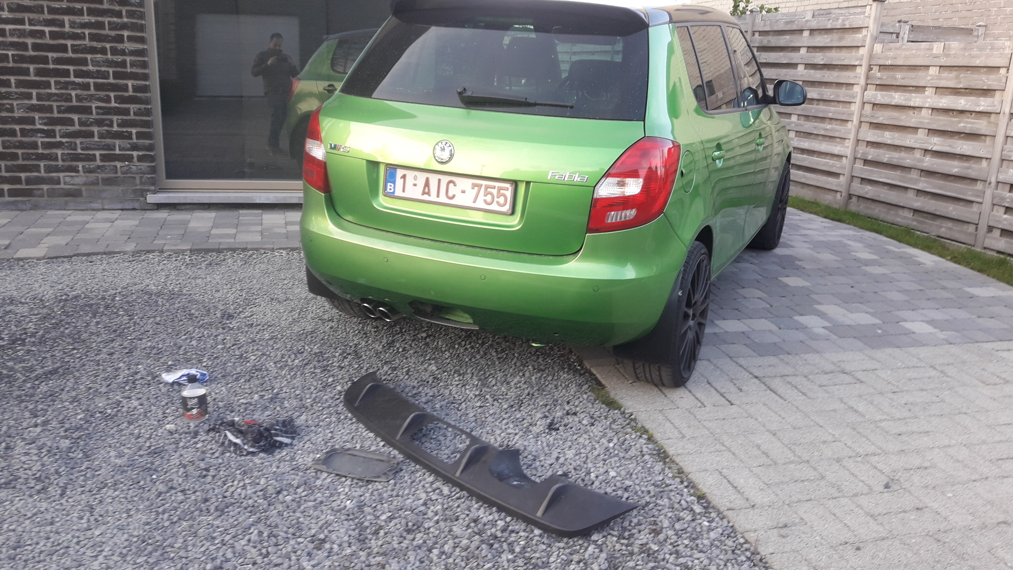

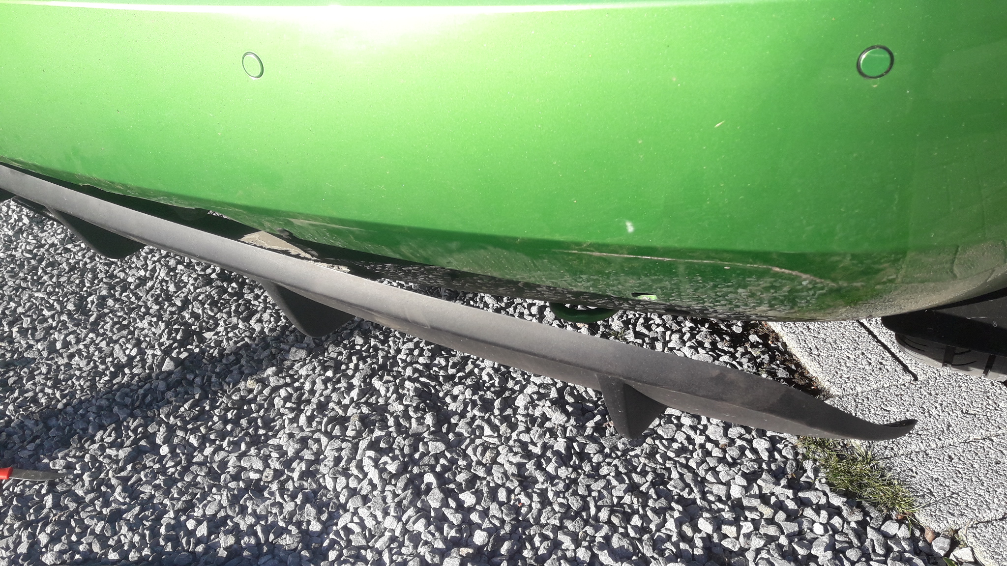

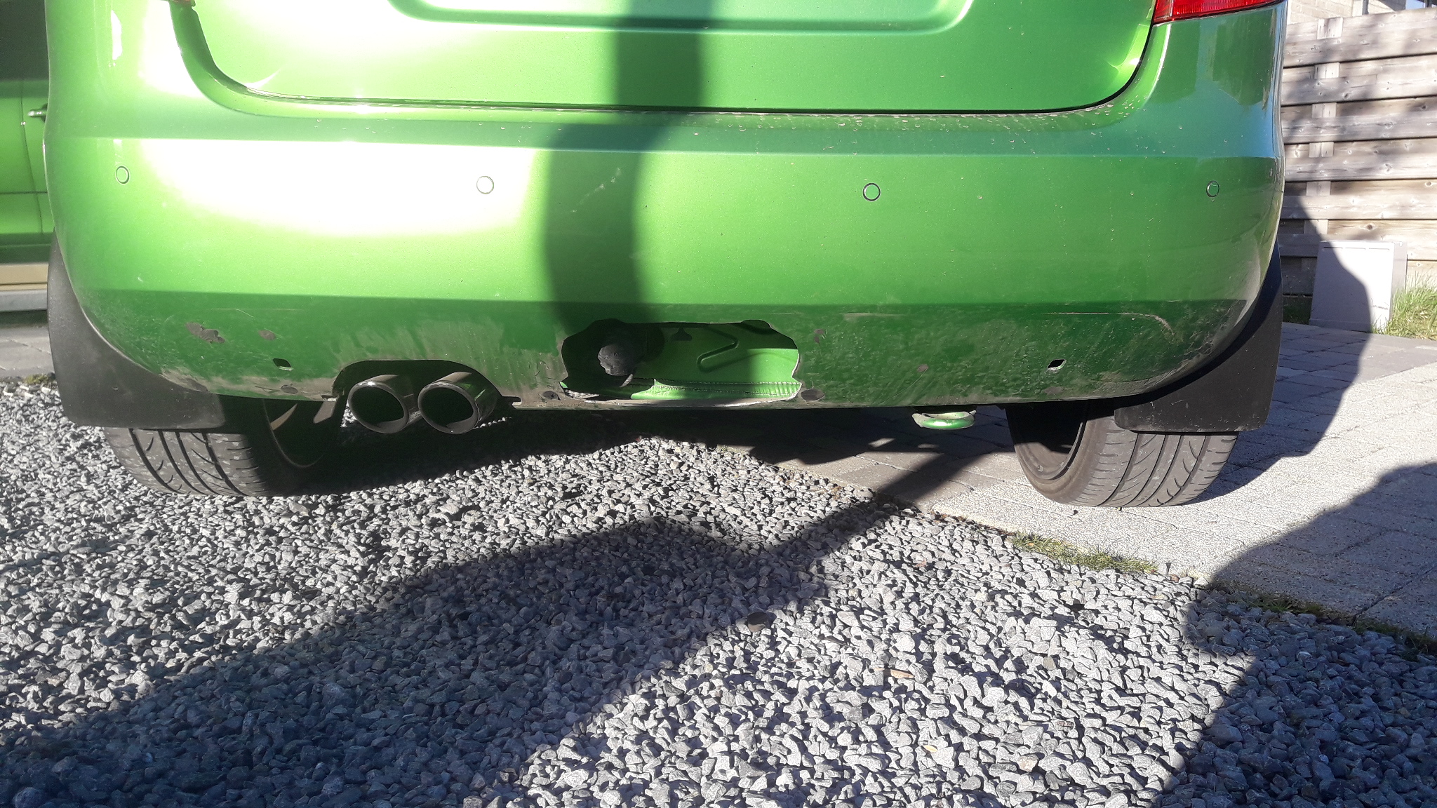

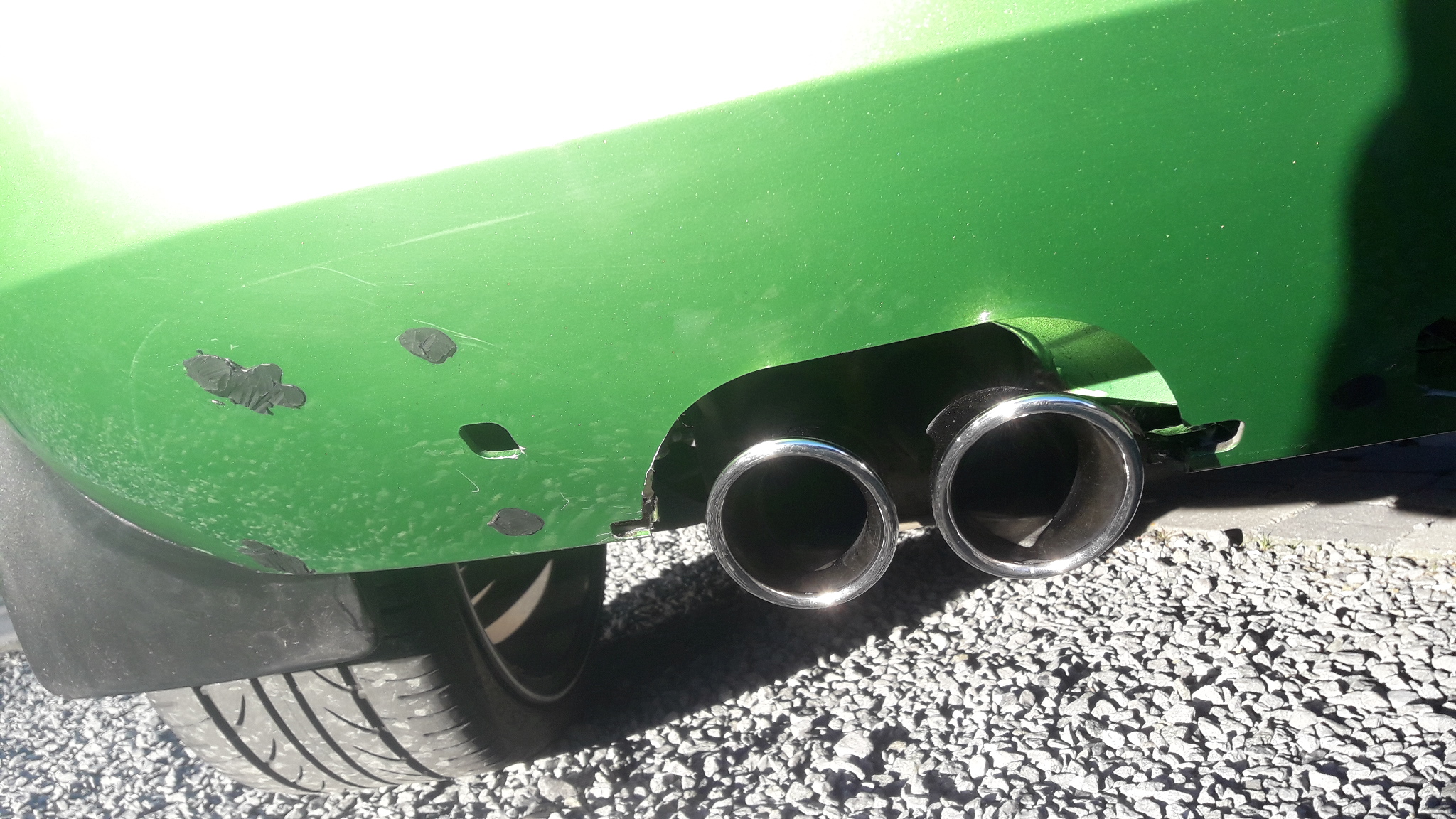

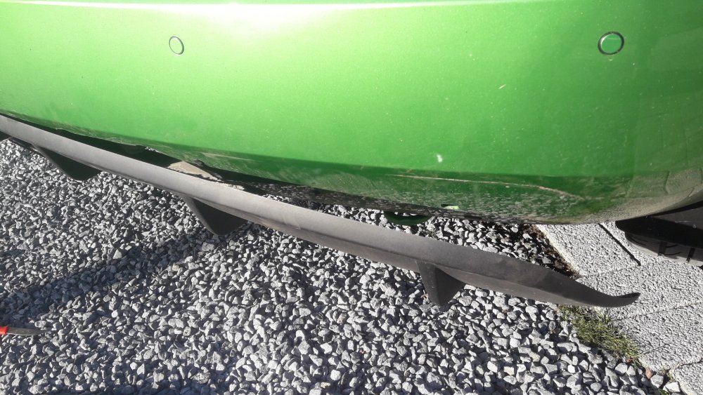

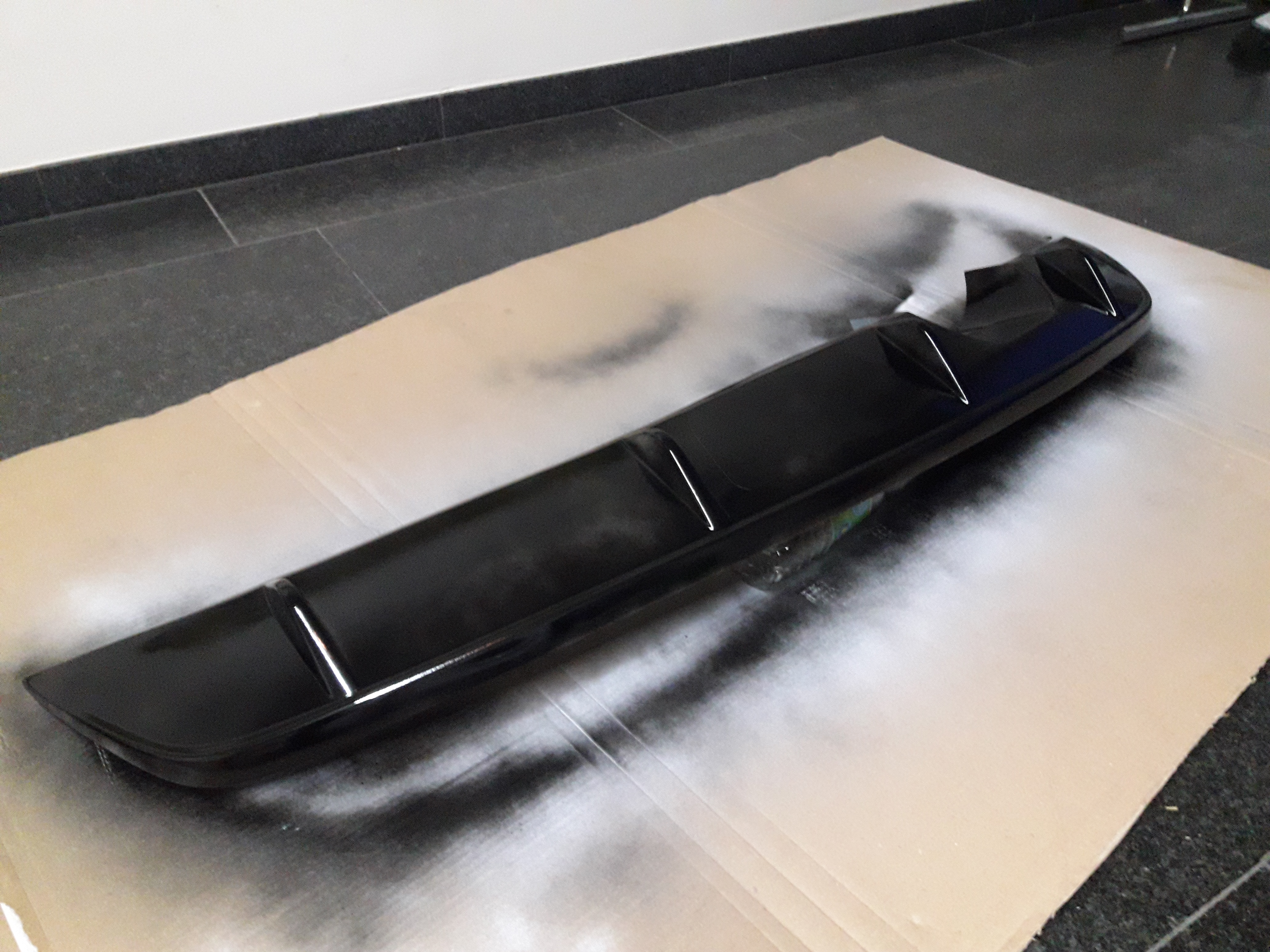

im going to tackle that messed up diffusor tomorrow

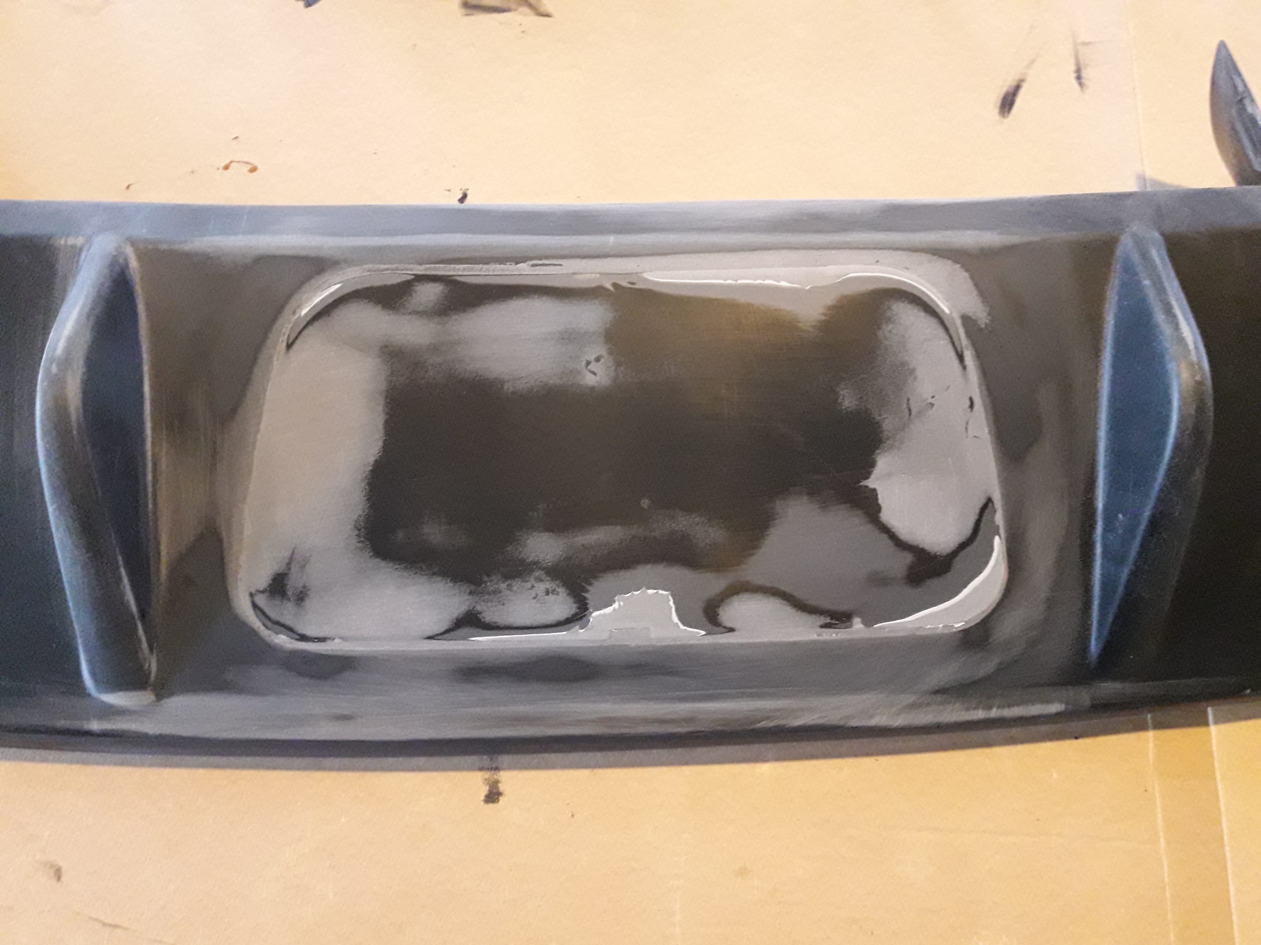

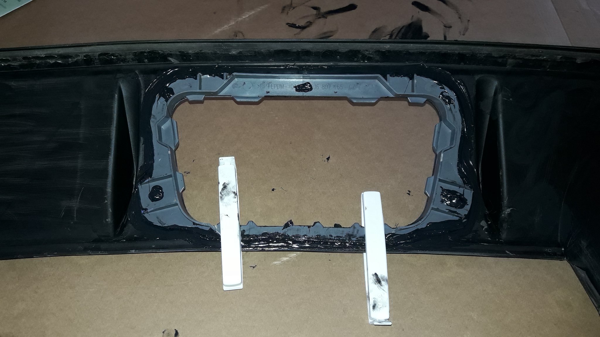

ill post pictures of it . ive read in some other threat that its gluued and plastic welded on... and that u need to buy a new bumper  therefor ill first try to get that diffusor off and repair it with plastic putty and a lick off black paint... then reinstall it with hotglue and some plastics fixall...

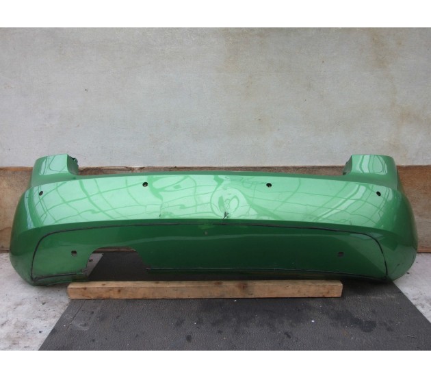

I've got a spare Monte Carlo bumper, I tried to remove the rear diffuser but failed basically.
The side trims came off ok but the main bottom one is stuck on pretty well!
ive found out that it can be done
like this :)

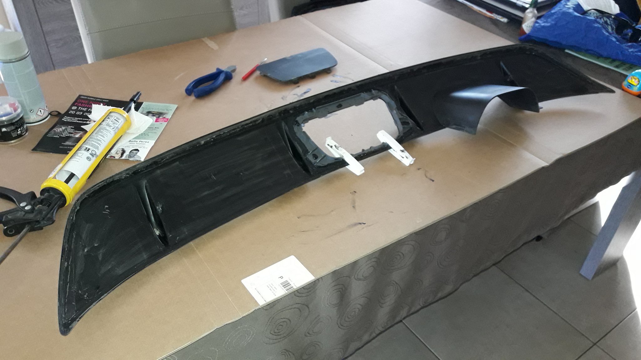

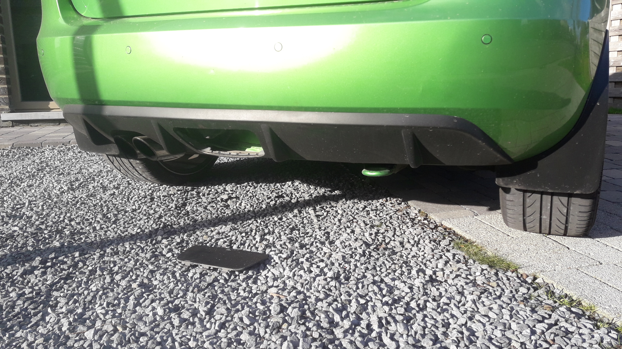

yes good news lads . ive got it off .
those guys that managed to do this omg . silicone kit everywhere :( poorly done job ... im going to repair it the decent good way .. check this out
that hole tought haha lol
From where did you buy the ornament for the spoiler?
I haven't seen one with a hole in the middle until now.
i dont know where the previous owner bought it but i called the dealer and u still can buy only the vrs diffusor part . with towing hook hole . or the regular . contact ure dealer and ask them . grtz

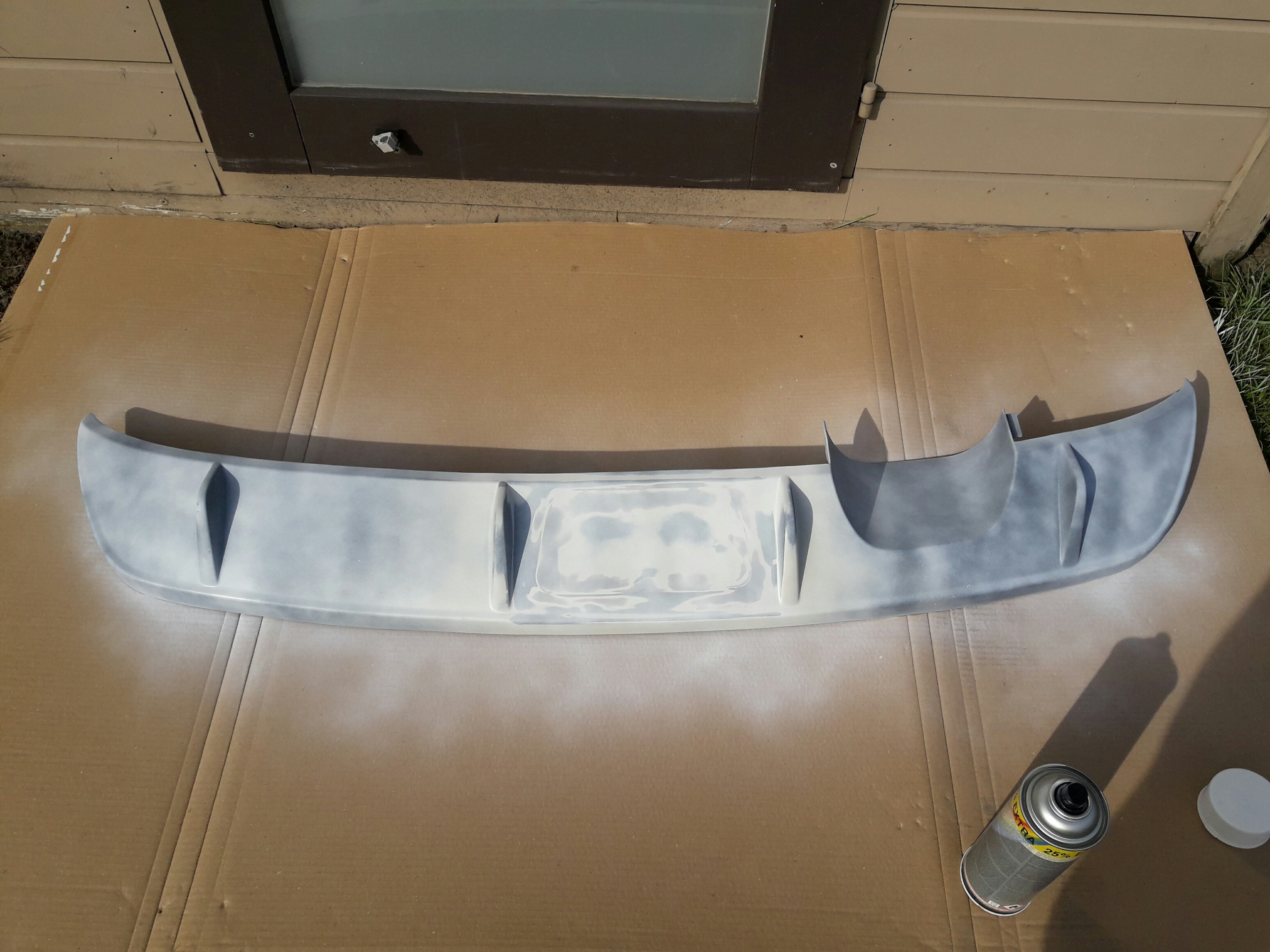

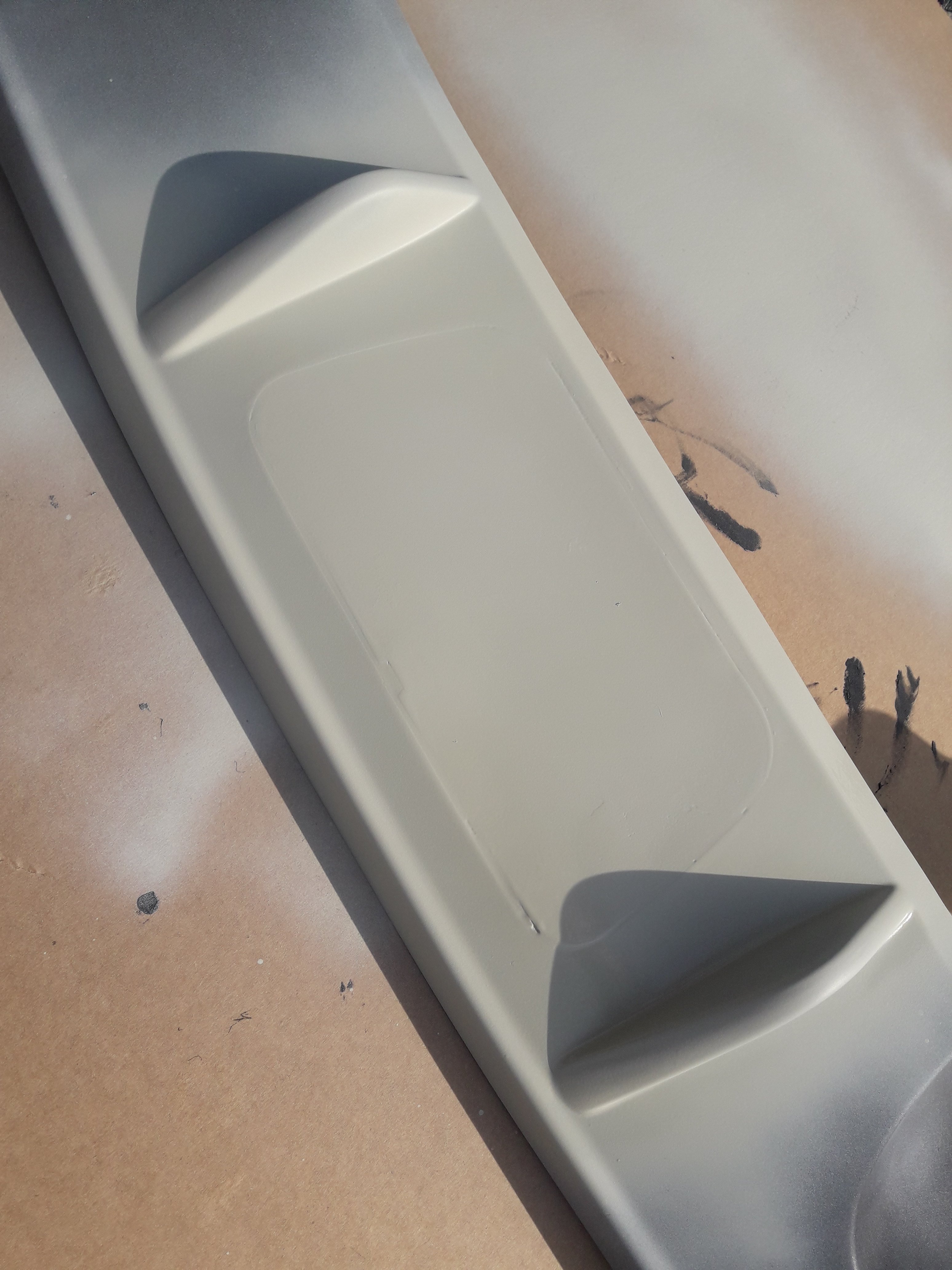

okay heres some progress on refitting
Layer 1 gloss black done

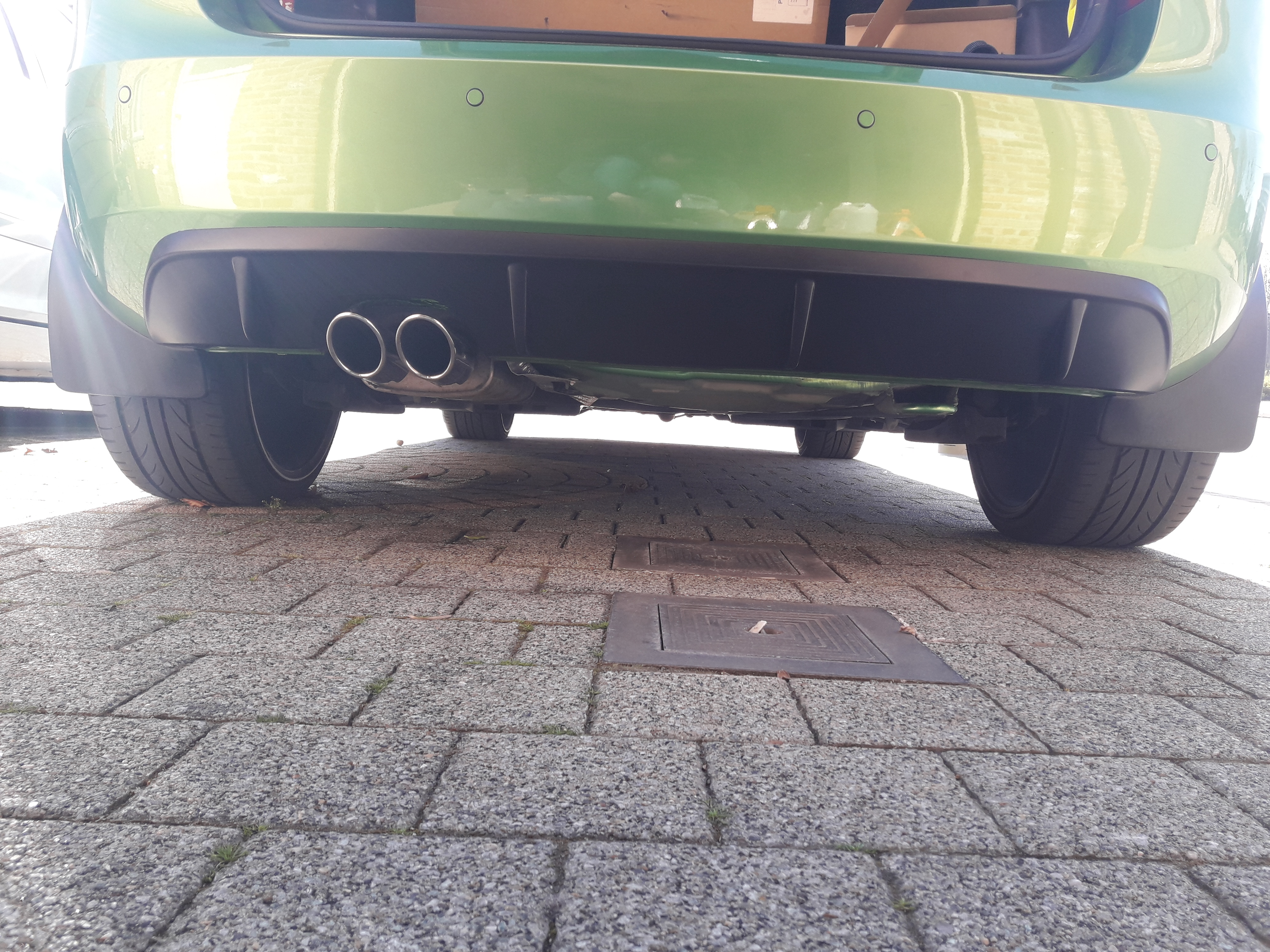

Resprayed mat black after all . Gloss showt to much little defects..
Great effort, your right about removing the diffuser, the VRS one isn't bad to remove but the Monte Carlo one is solid.
Gloss black wouldn't look right either, mat looks better :)

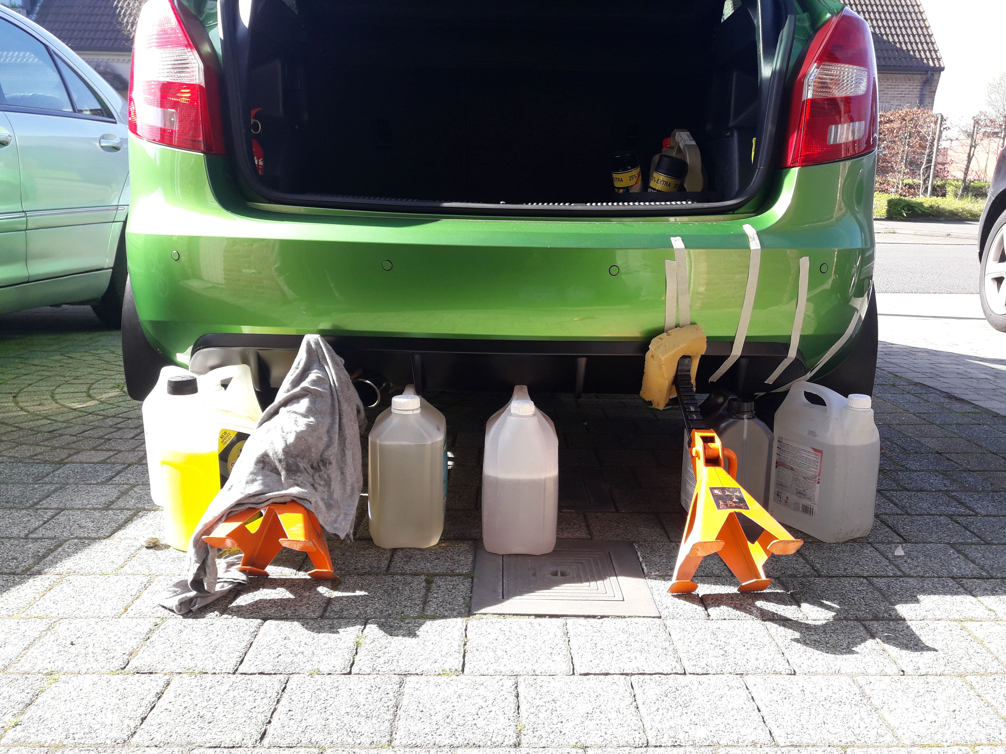

Removed the supercharger sound proofing . Pain in the ass to get to it
Do you have the weights off the rear crash bar?
That will be a project in the coming week. And sort out how to actually remove the charger cover .. its stuck in there . Even did try to break it but from underneath my car i cant get much force.. also noticed coolant and oil drips ... ill check it out too
Just drove a little and omg removing that sound proofing is totally worth it !
Check out that coolant drips, because the Water Pump might need changing and that is also the magnetic clutch for the supercharger.
I have a thread started with the part numbers including seals and replacement belts in the Fabia section.
EDIT,
i bumped the Supercharger Insulation removal thread,
just shout if you need part numbers on the water pump and can not find them.
Edited by Awayoffski
i used a soldering iron to melt the plastic cover in half to remove it as it just doesn't phiscally come through the gap you have i did start with a dremel but it was taking forever
