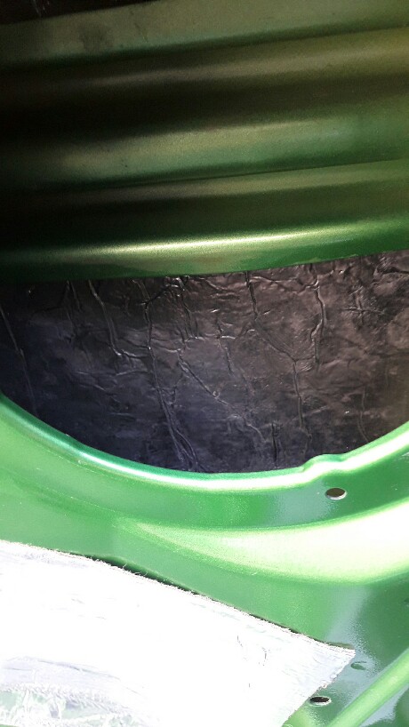

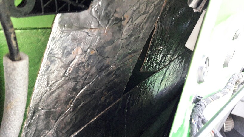

Actually busy on the sound proofing now
It actually works fine
  • Replies 275
  • Views 36.9k
  • Enslave666
    Enslave666

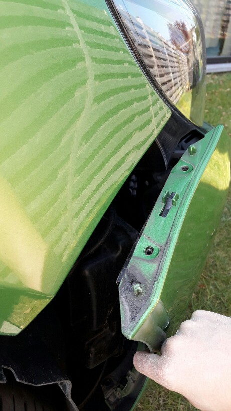

    So the mudflaps where a pain in my ***  Because of that 18inch oz that i didnt remove . It was almost impossible to get to the torx20 bolts So there on the vrs now . Looking nice and supergo
  • And done ^^ superhappy how it came up.  Easy job with much joy after.
  • Prefer the much rarer grey myself ;-)

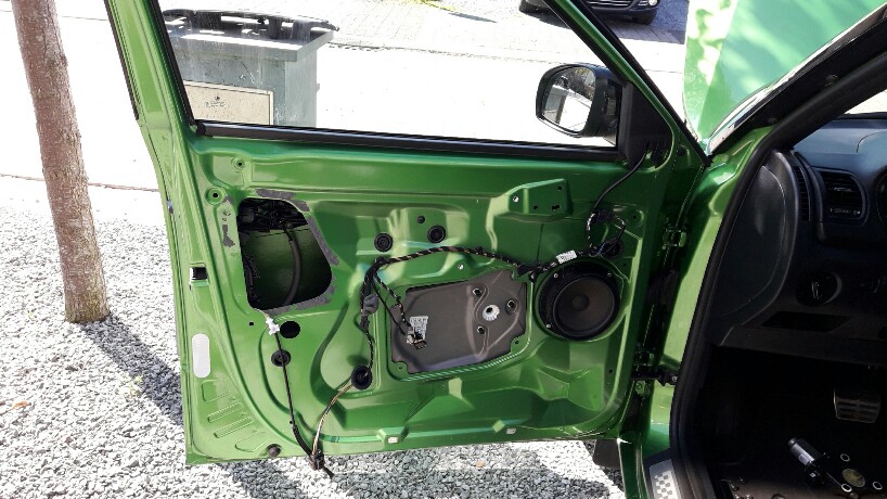

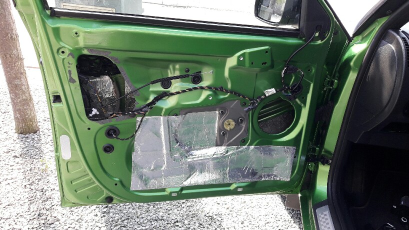

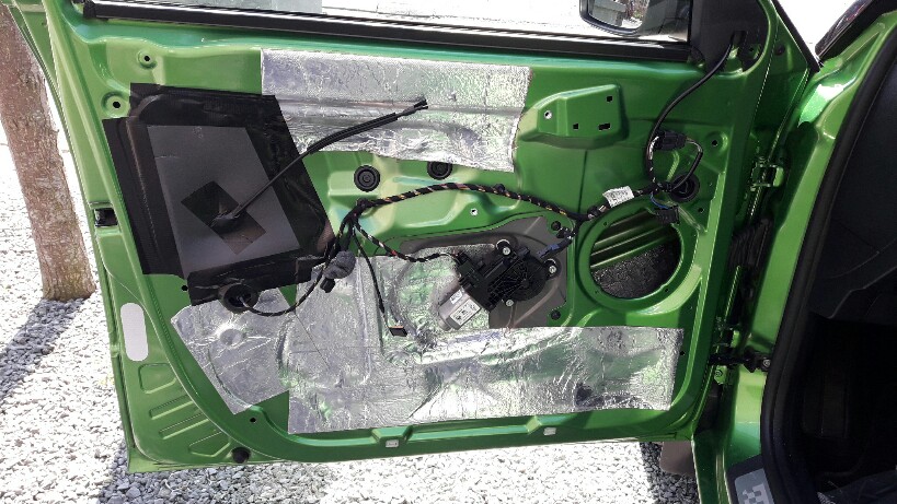

Works fine actually . The doors dont sound like a tin can anymore . There like audi doors . They sound solid ^^
Just have do drive around to test it
Audio should be beter to

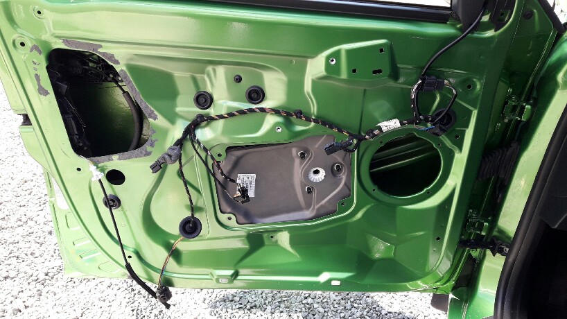

How easy are the door cards to get off?
Edited by S27VEJ
2 bolts underneath .
2 bolts under the door handle
And pull the doorcard off and up
Beware for cables from mirrors tweeter
Doormech.
Speaker
Super easy really

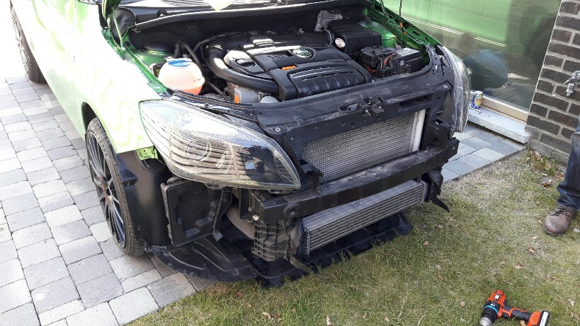

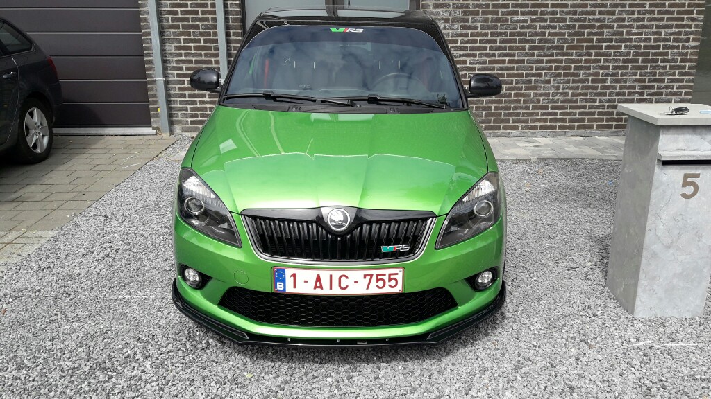

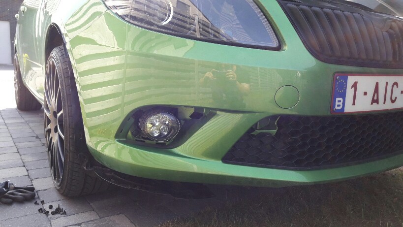

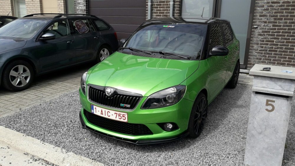

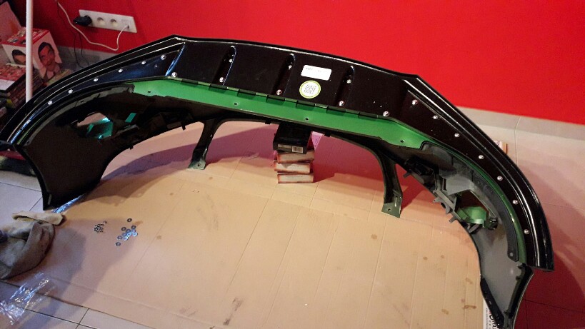

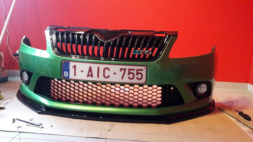

Okay . So today my maxton splitter arrived.

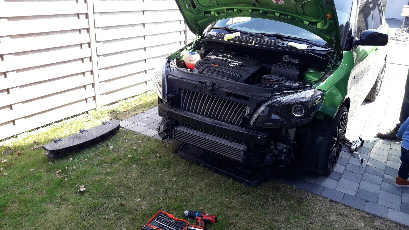

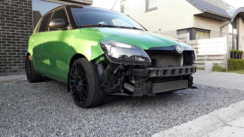

So i took off the bumper.
Easy peasy

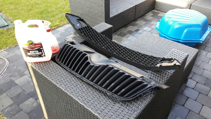

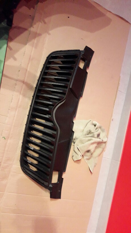

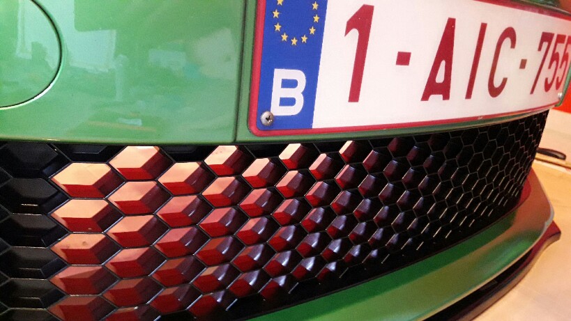

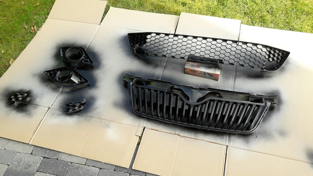

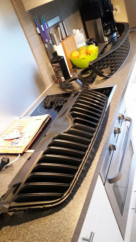

Took out the 2 grille's for painting
And cleaned the bumper inside out .
Because of the previous owner theres speedbump rash on the under and frontside of the bumper . So that will be sorted and repainted

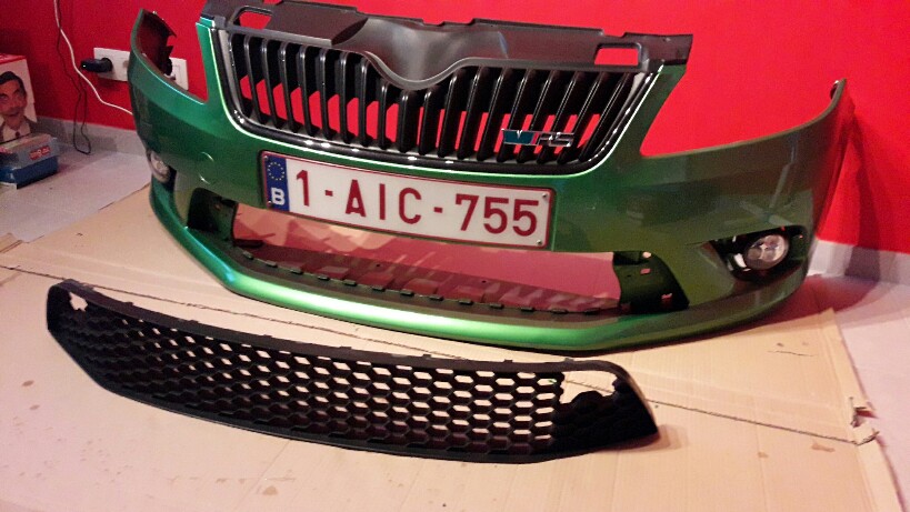

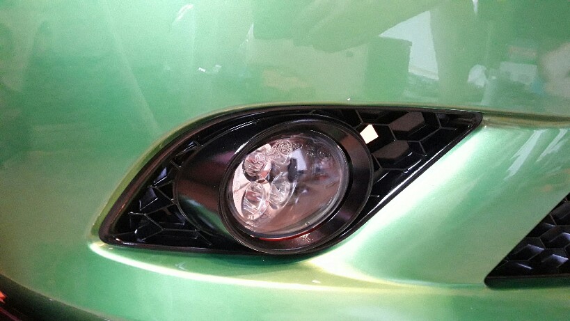

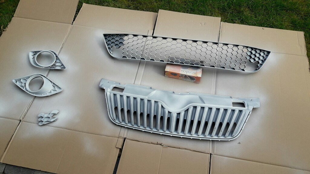

Grille and honeycomb-
gloss black paint DIY
DRL polish

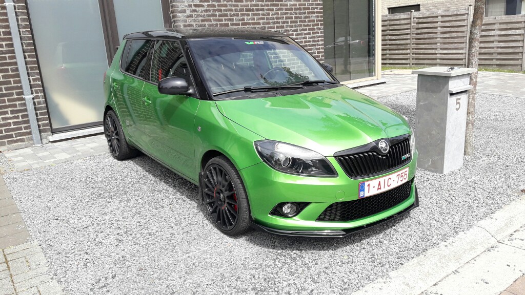

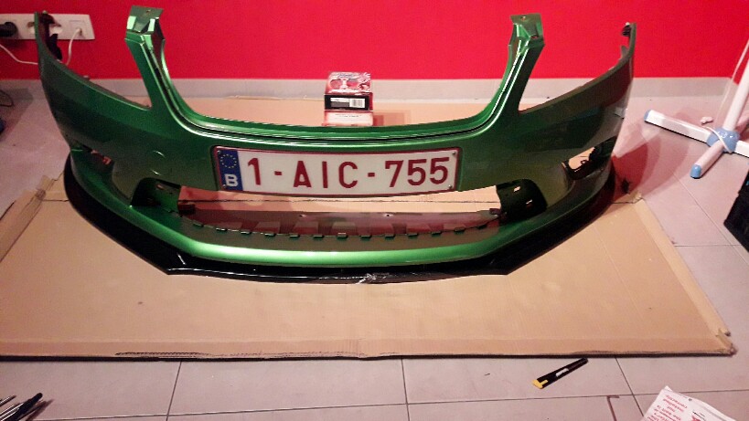

And splitter install
Also gonna replace the 2 torx screws on the inside wheel arch with hex nuts for easy'r on and off .. will be beter to fit in a allan key and loosen or tighten them.
The torx always pops out .
Anyway it makes me nervous A F

So this happened
Primer
And in a few moments gloss black .
Will try my best .with 5 tin coats . Should be nice ... lets hope

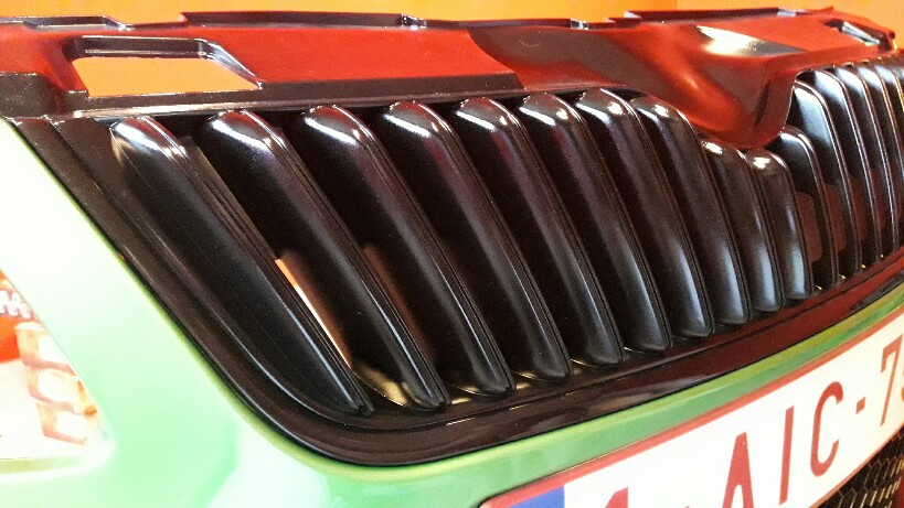

5 minutes ago, Enslave666 said:
This is 2 layers
Old pic off me ant minty <3
♡loved it

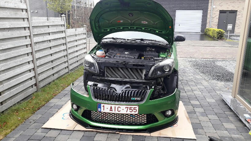

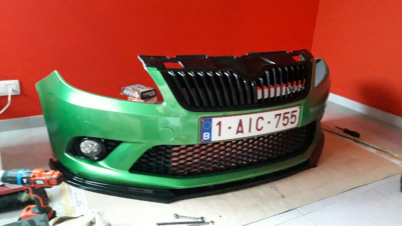

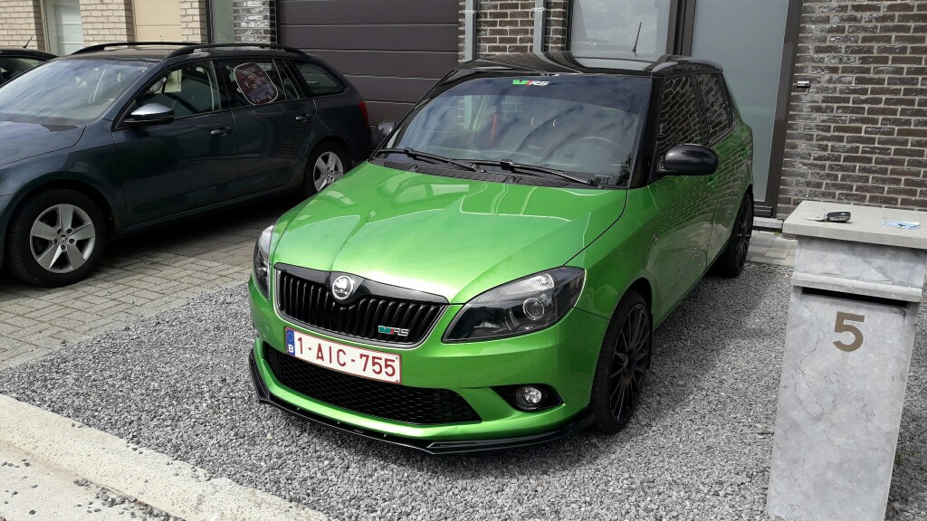

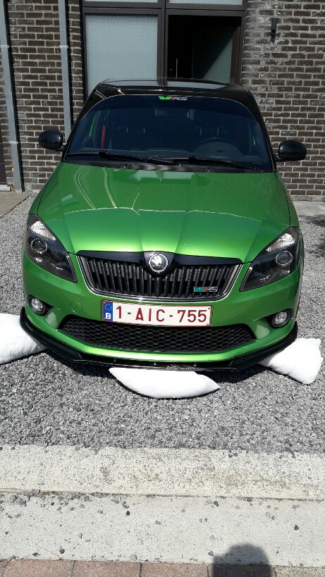

Oh boy ime super excited about the front bumper now . Its perfect now and the splitter wont go anywhere
Looking mean :o

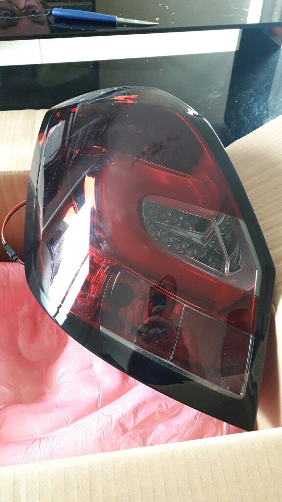

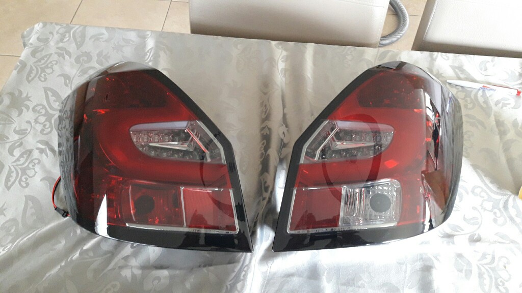

Monday the smoked lights will be in .
Then my car is only green and black.

Love the splitter, I wanted one for mine but could never find one local
Maxton design have a local website

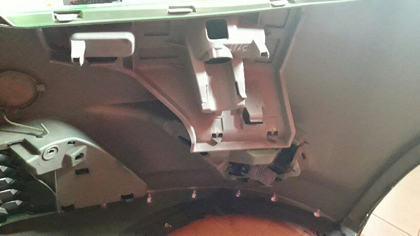

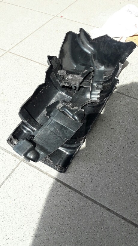

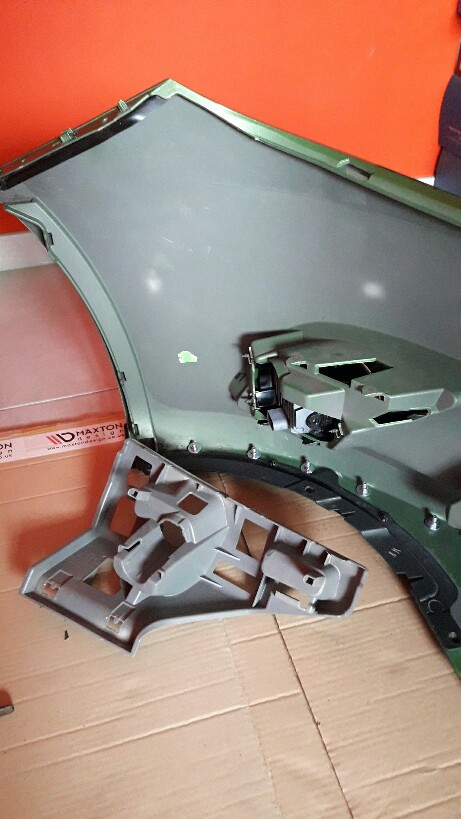

Found out that the bumper has plastic brackets for headlamp sprayer
As my car doesnt have a headlamp spray unit ive removed them .

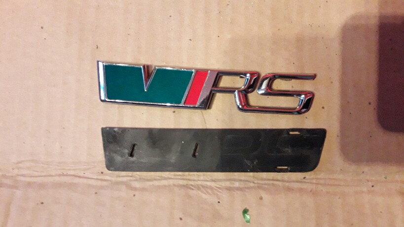

Have to sort the vrs badge with some 2 component glue . Normal plastic glue doesnt to the job ...

No the bumper does not have the holes for headlamp washers . Why would i install those anyway ? I dont want the car to get heavyer . And i dont see the point of the washing system...
Do u want those brackets hutchysrs?
Valid points I suppose. I'm just a sucker for optional extras and gadgets.
I do want them yes but after seeing this post I checked online and buy them them for around £10 each so will just get them new when I need them :) thanks though :thumbup:

Install this afternoon
They just need a little polish

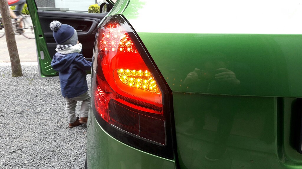

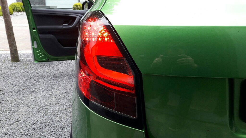

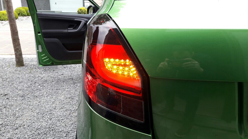

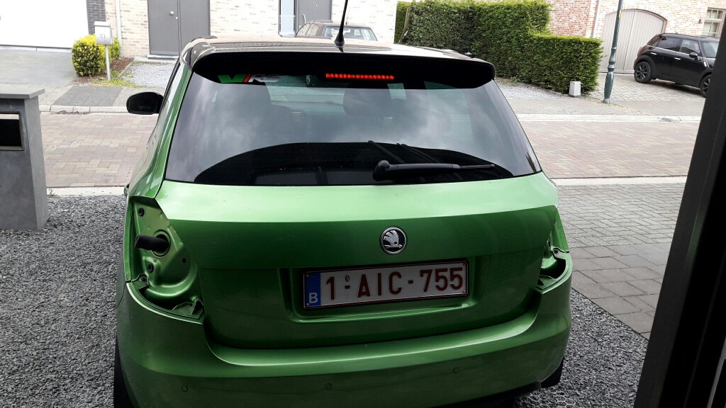

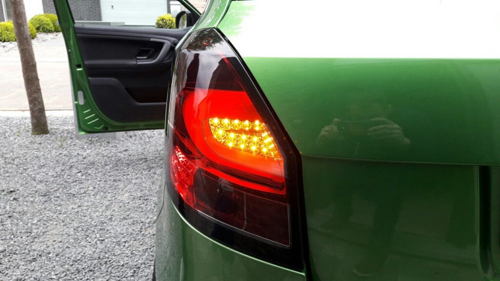

Here installed . So they are red smoked .
which side is reverse light on I'm sure in uk mine is on the left. Yours is on the right? Might be wrong, defo my next mod
coming together nicely mate, making me want to make a project thread for all the mods i have on at the moment ;)
