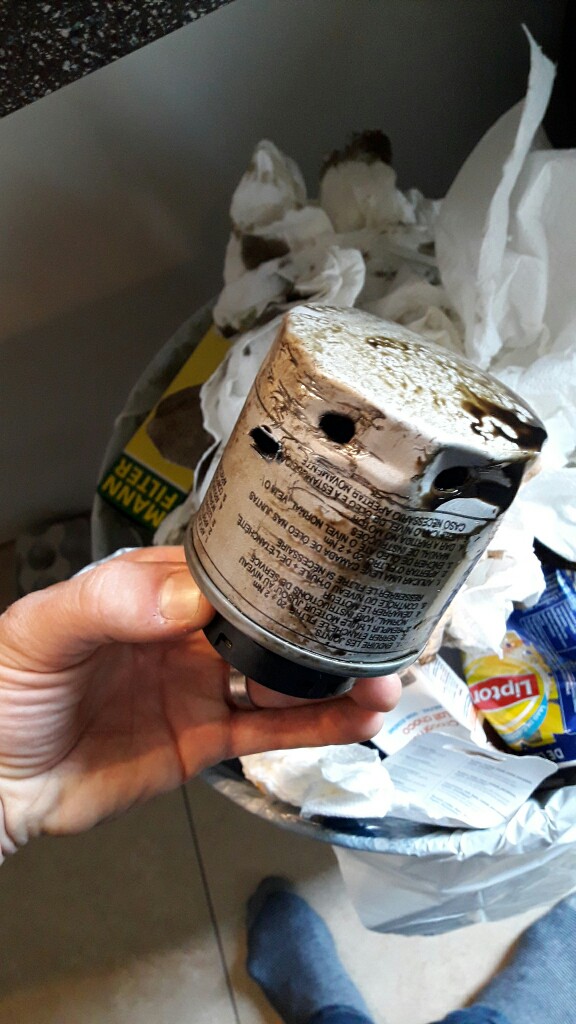

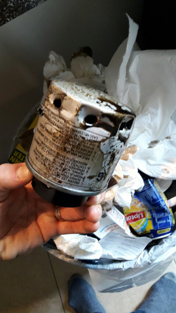

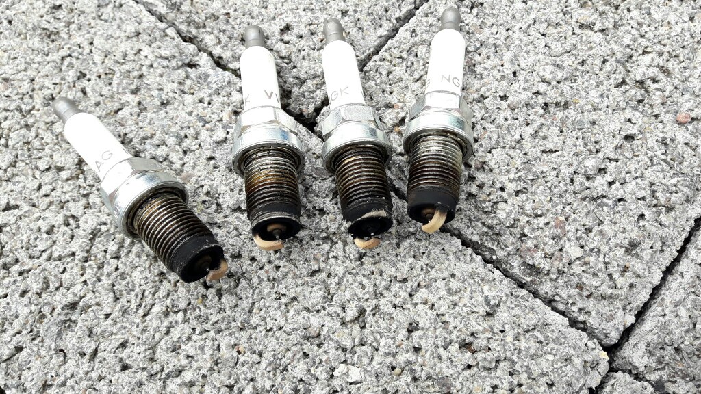

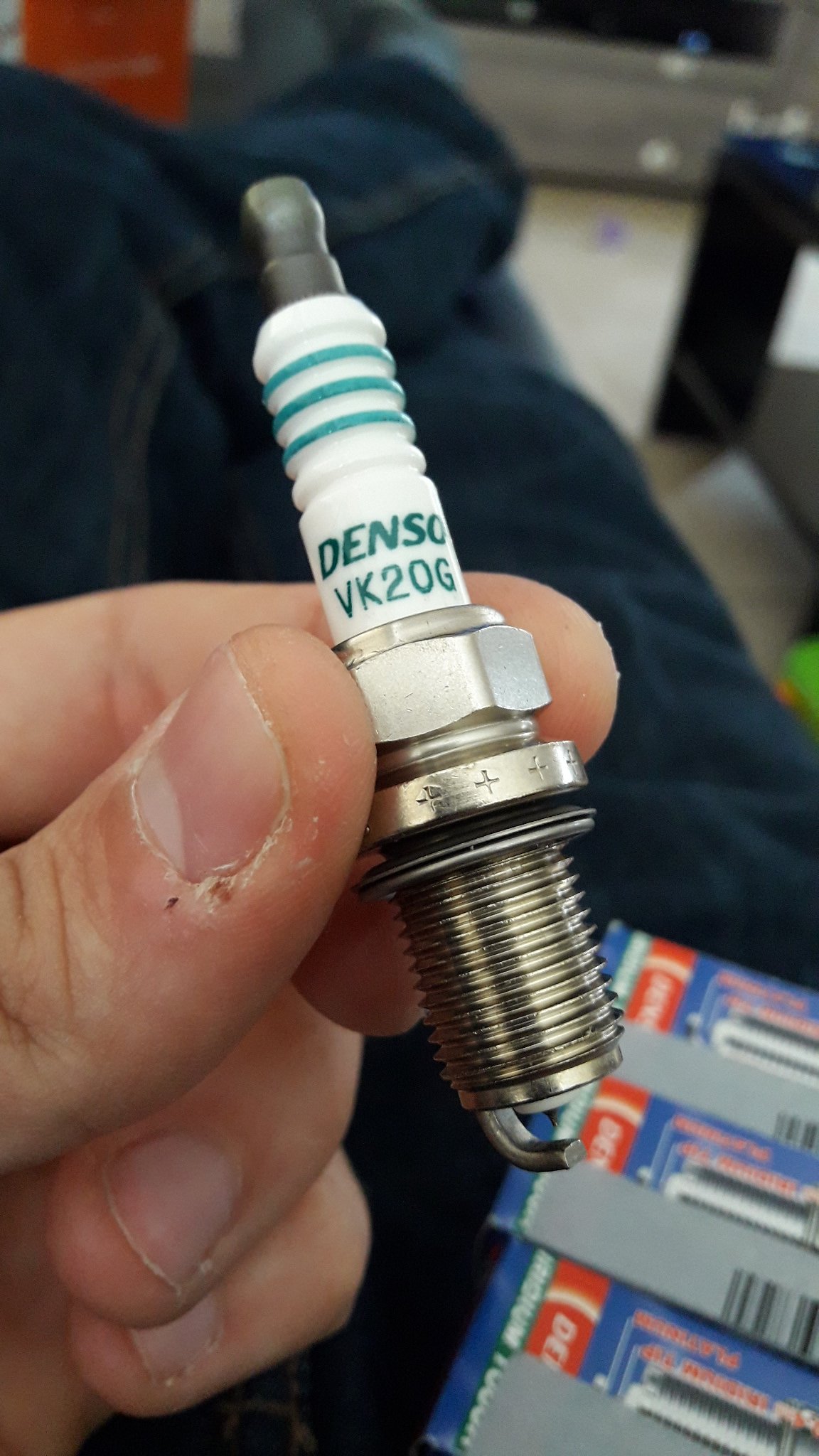

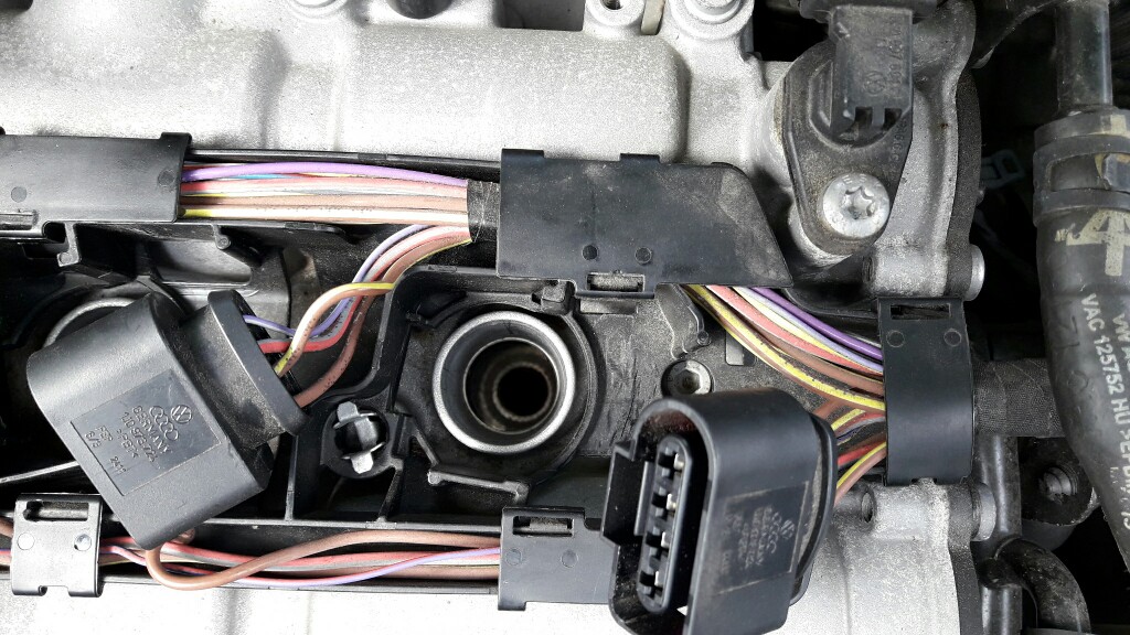

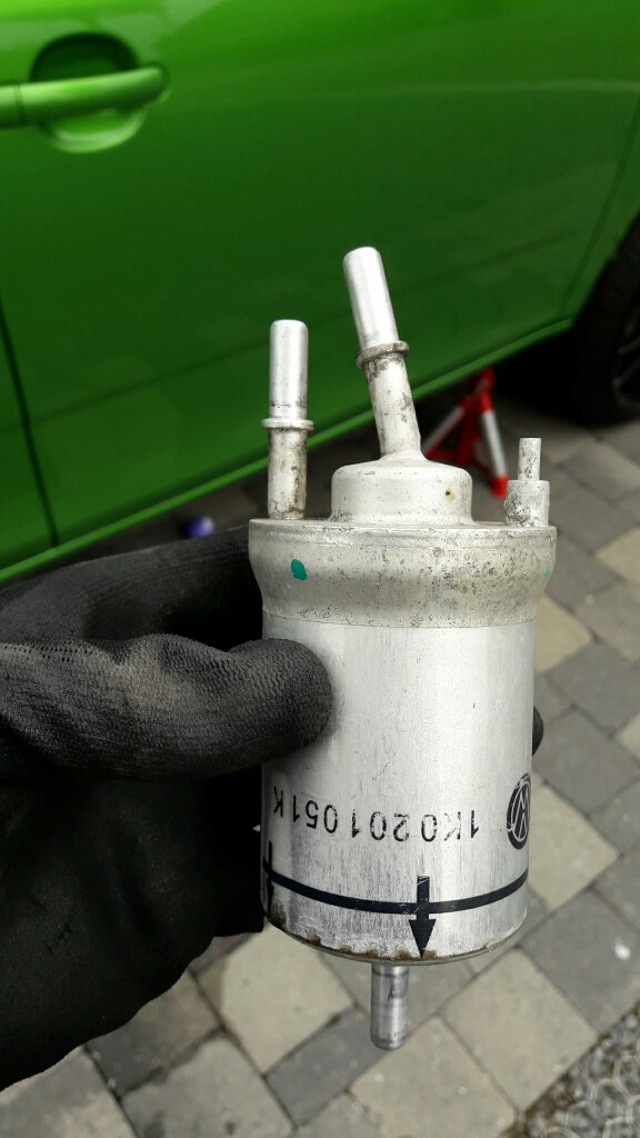

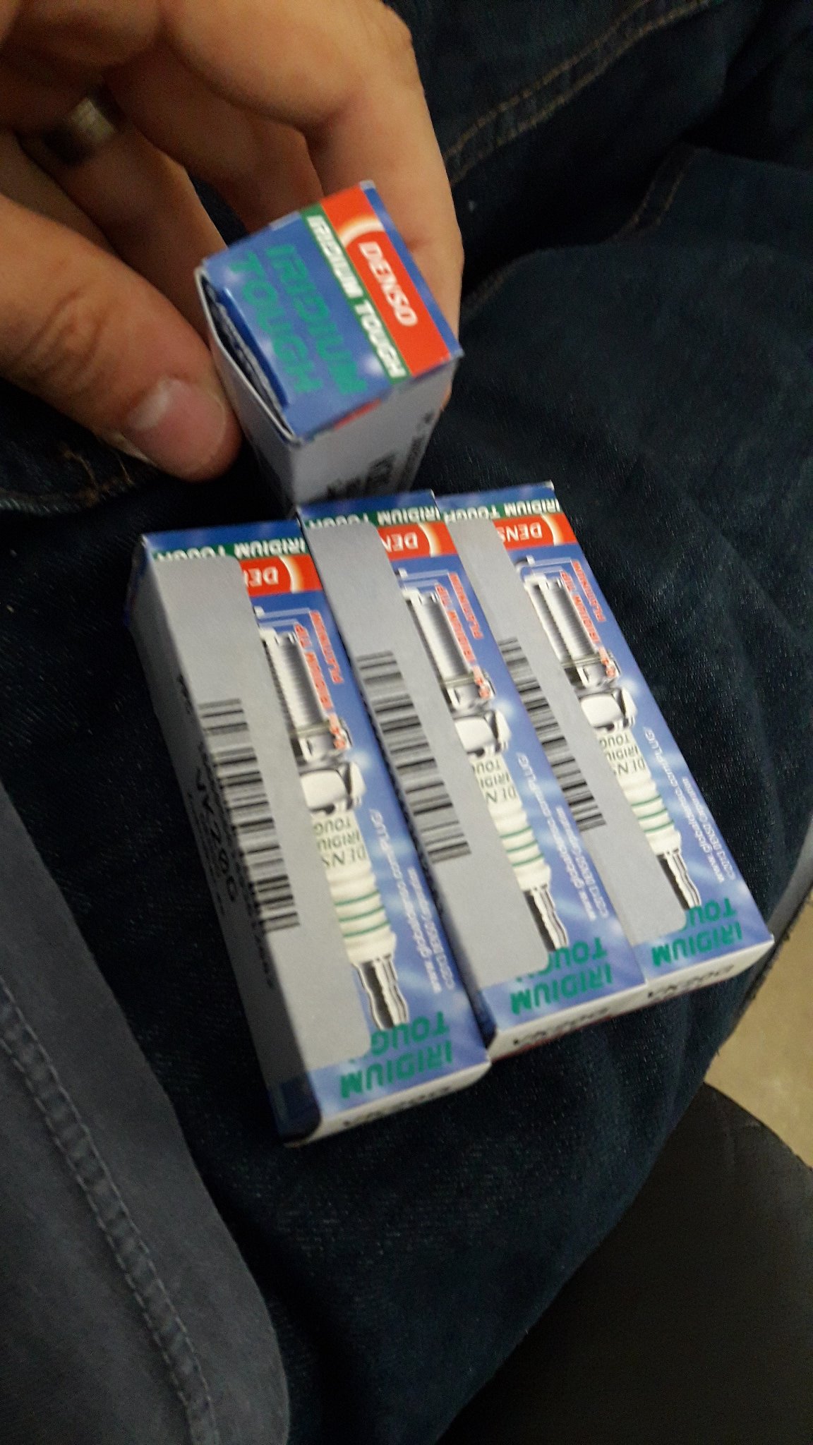

Did the big service today . Oh boy . Ive been trough some **** on this car..

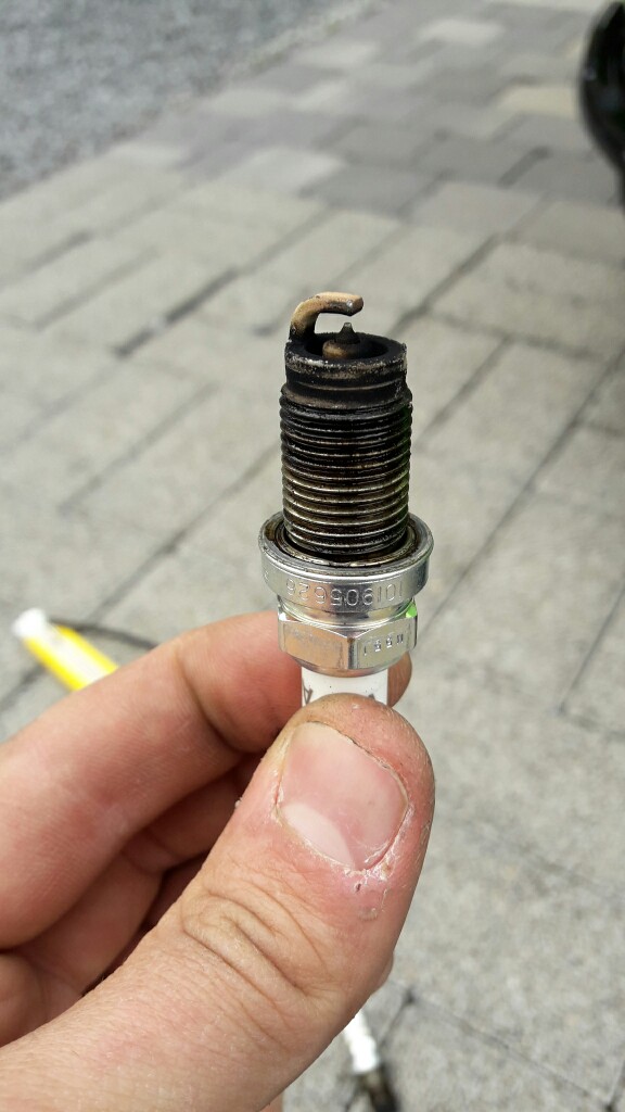

1 sparkplugs where torqued to 1million pounds..
2oil def. Needed a change..
3 fuel filter is apparantly bend
4 oilfilter torqued to 1million also .. had to buy a filterkey and even then i still pulled the beak into the filter housing ..
Had to punch holes into it with a screwdriver . Only then i could get it loose.
The good news my engine is now in tiptop condition .
No headgasket leaks . No mayonaisse on the oilcap or white oil.
No metal flakes to the drainplug
And the sparkplugs where okay .
So now its def. Okay .

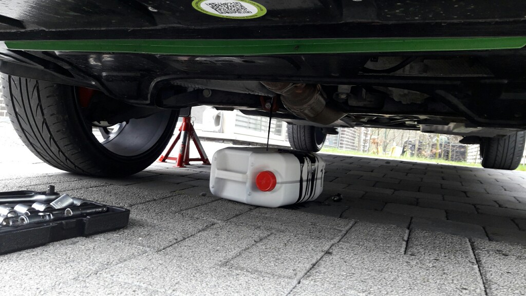

I did put to much oil in tought
The manual says 3.6liters
 Ive put in 4.5... hope its not that bad that i put in a little to much..
Will check to oil level after driving a little so the system can fill up nice ..
Check that oil cold on the flat, and it needs to be above the cross hatch a bit top of the flat bit is OK.
I put in 4 litres, and some techs have been putting in 3.9 or 4 litres for a few years now.
4.5 litres is too much.
Yea i didnt thrust it so i let off a bit...
Now its spot on level ..  thx !

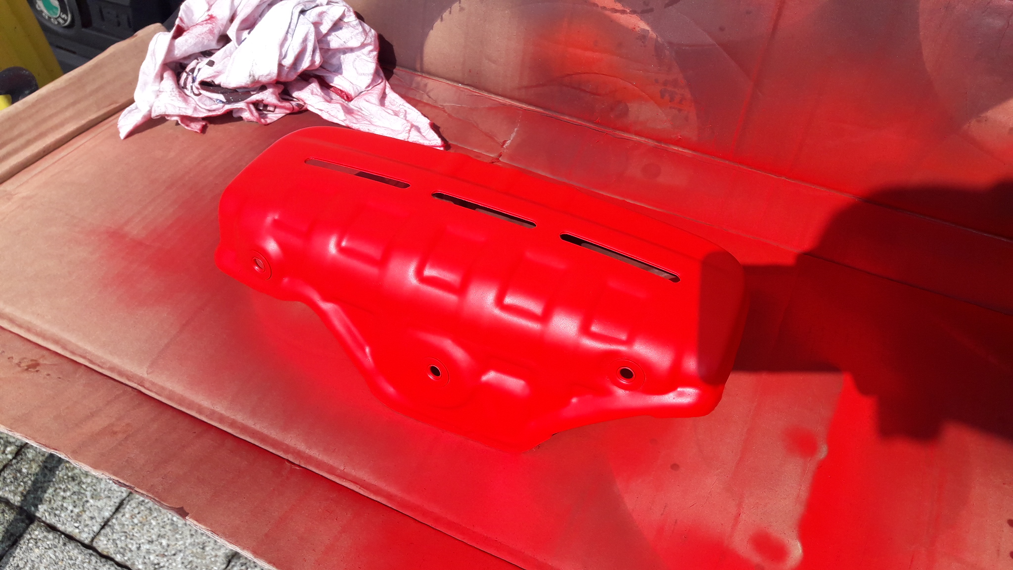

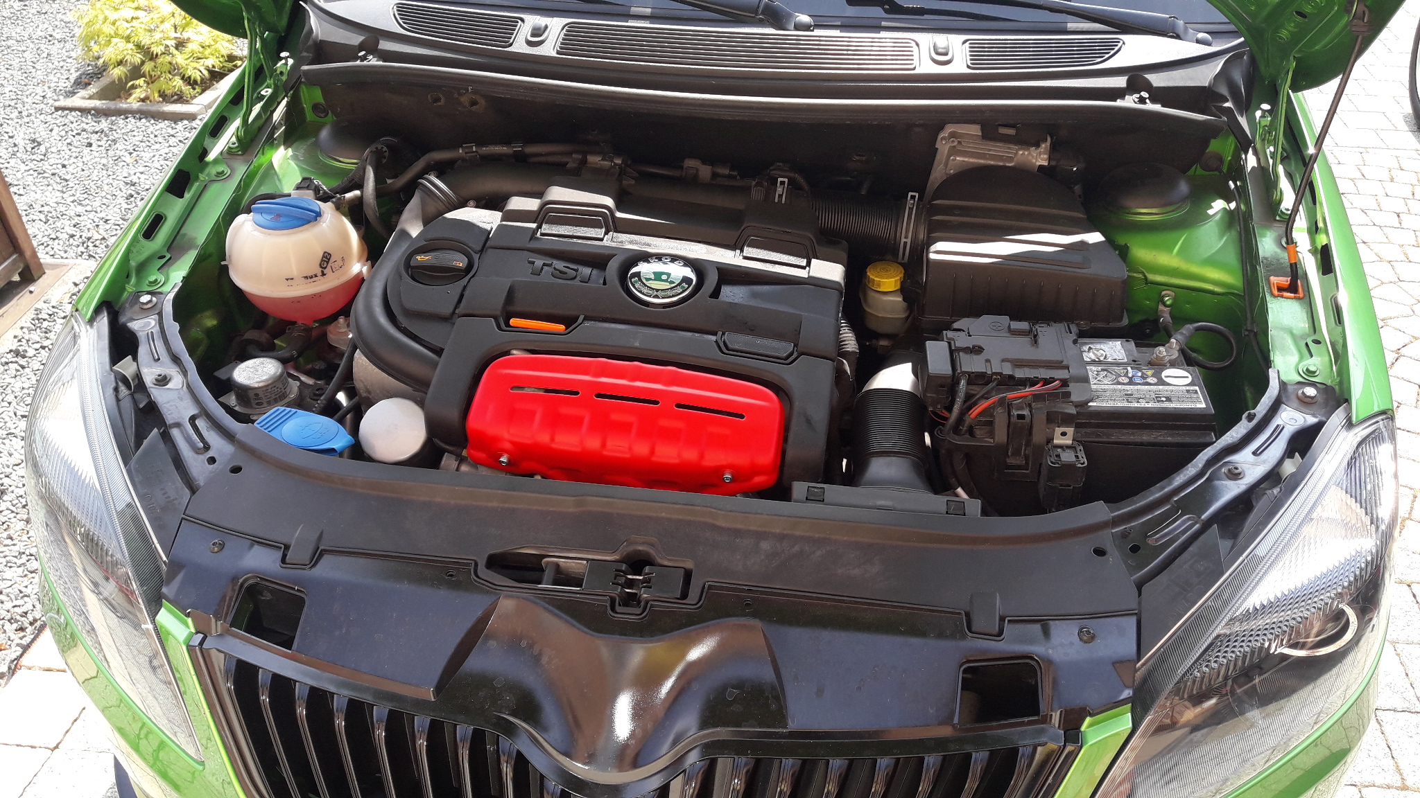

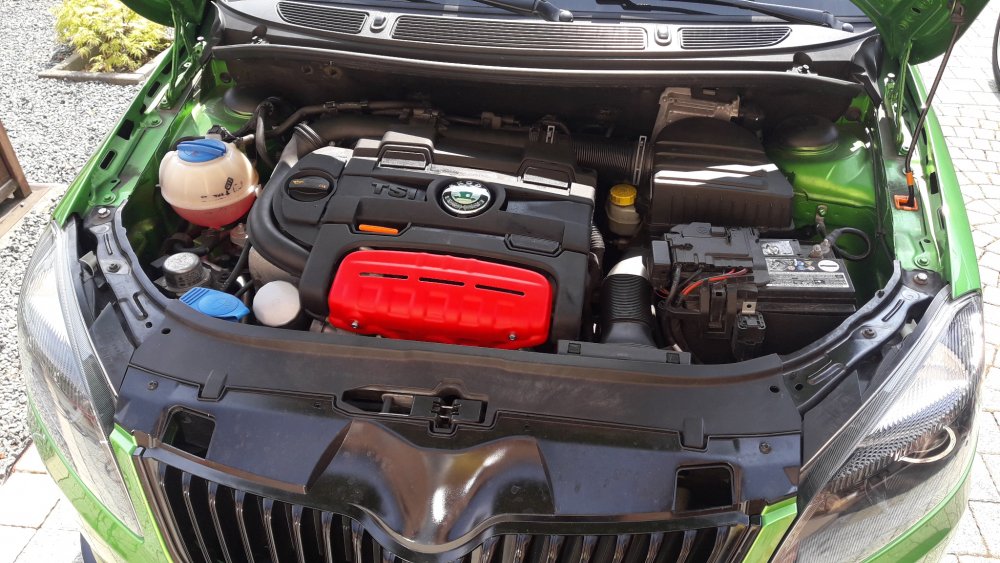

Today painted the turbo heatshield red
Nice touch that, will look great with a few other red pipes in the engine bay.

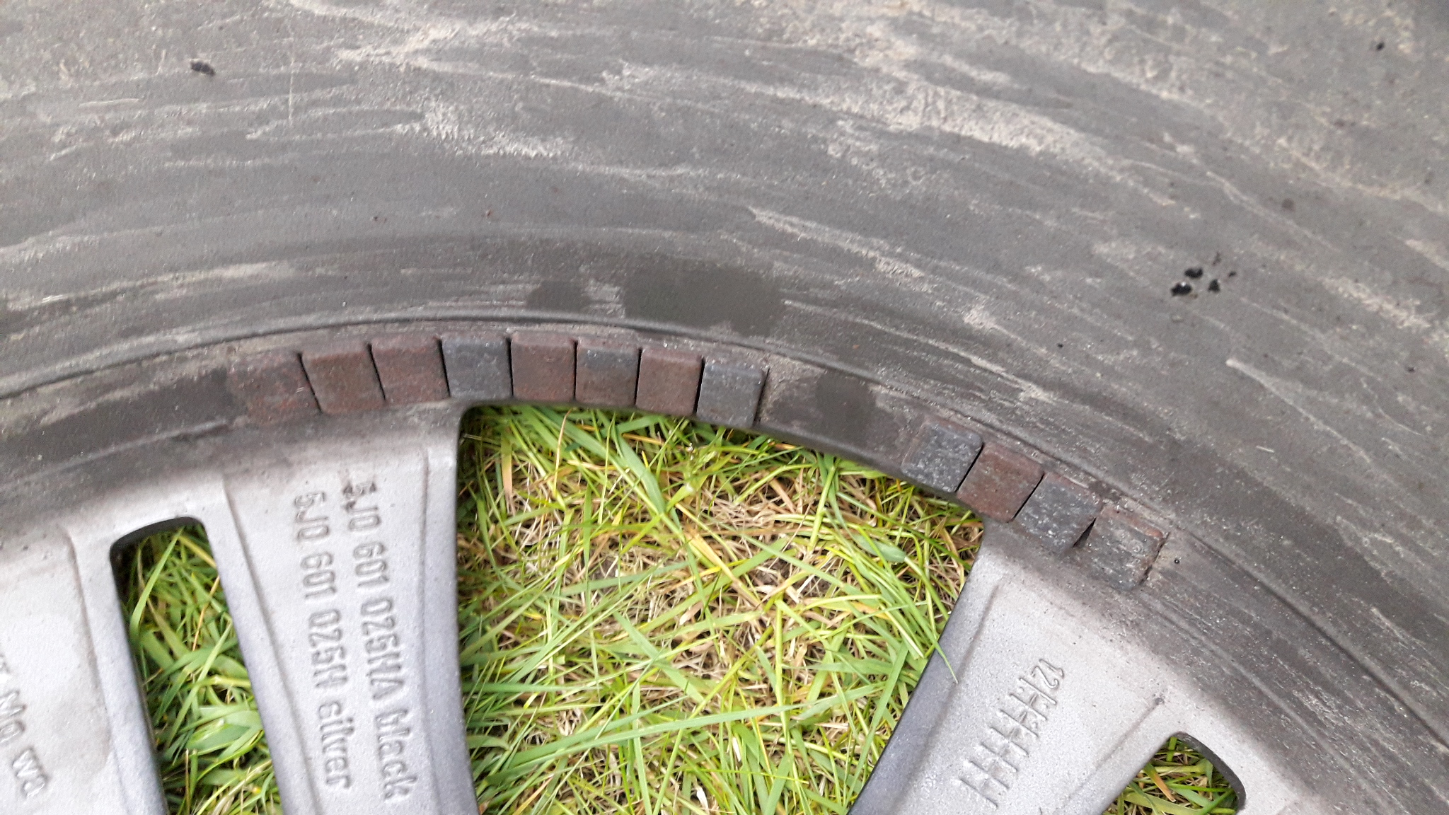

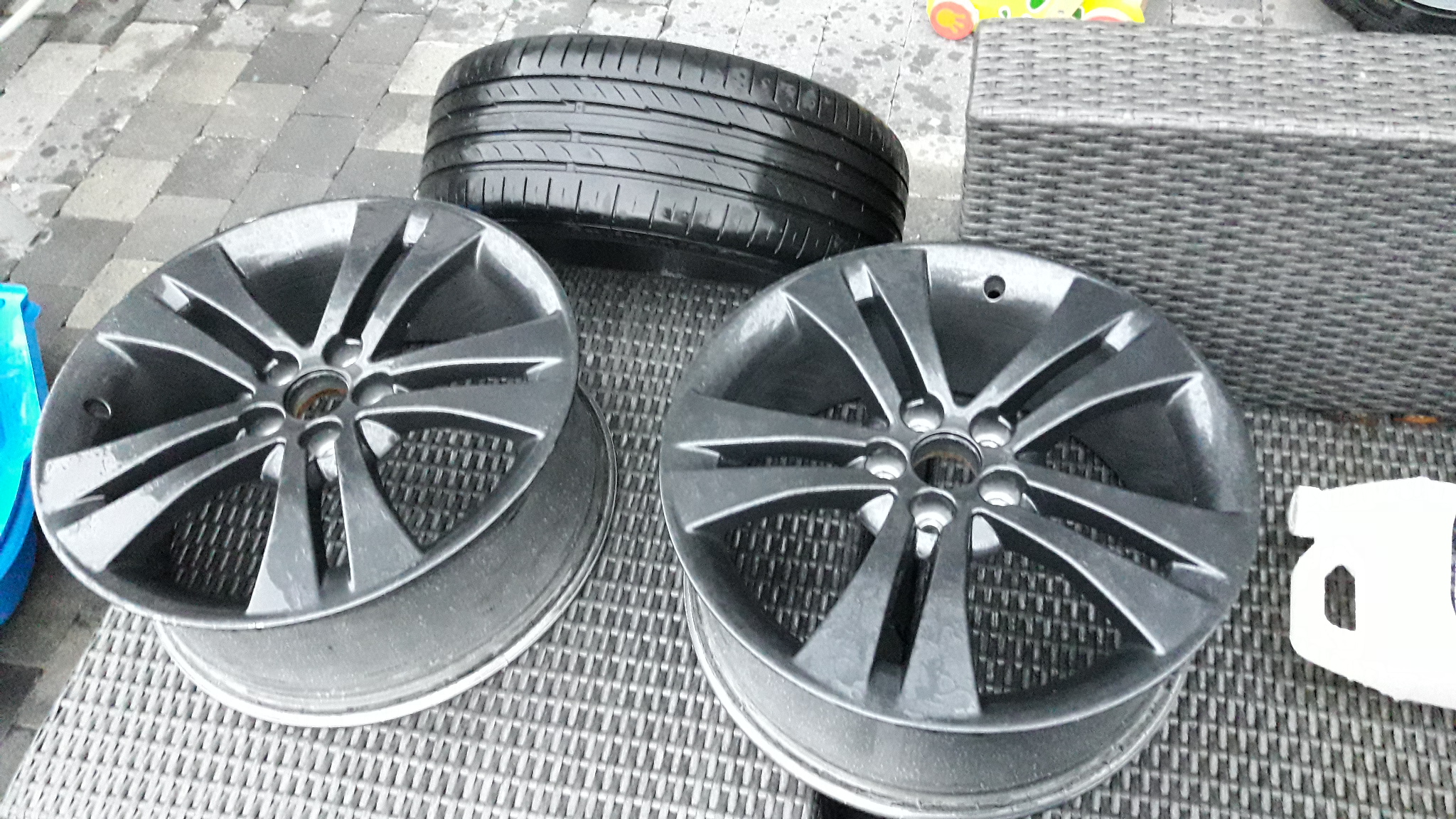

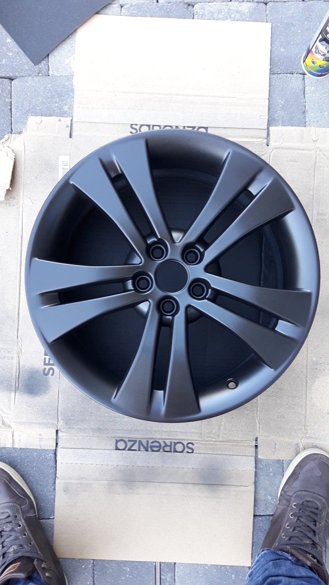

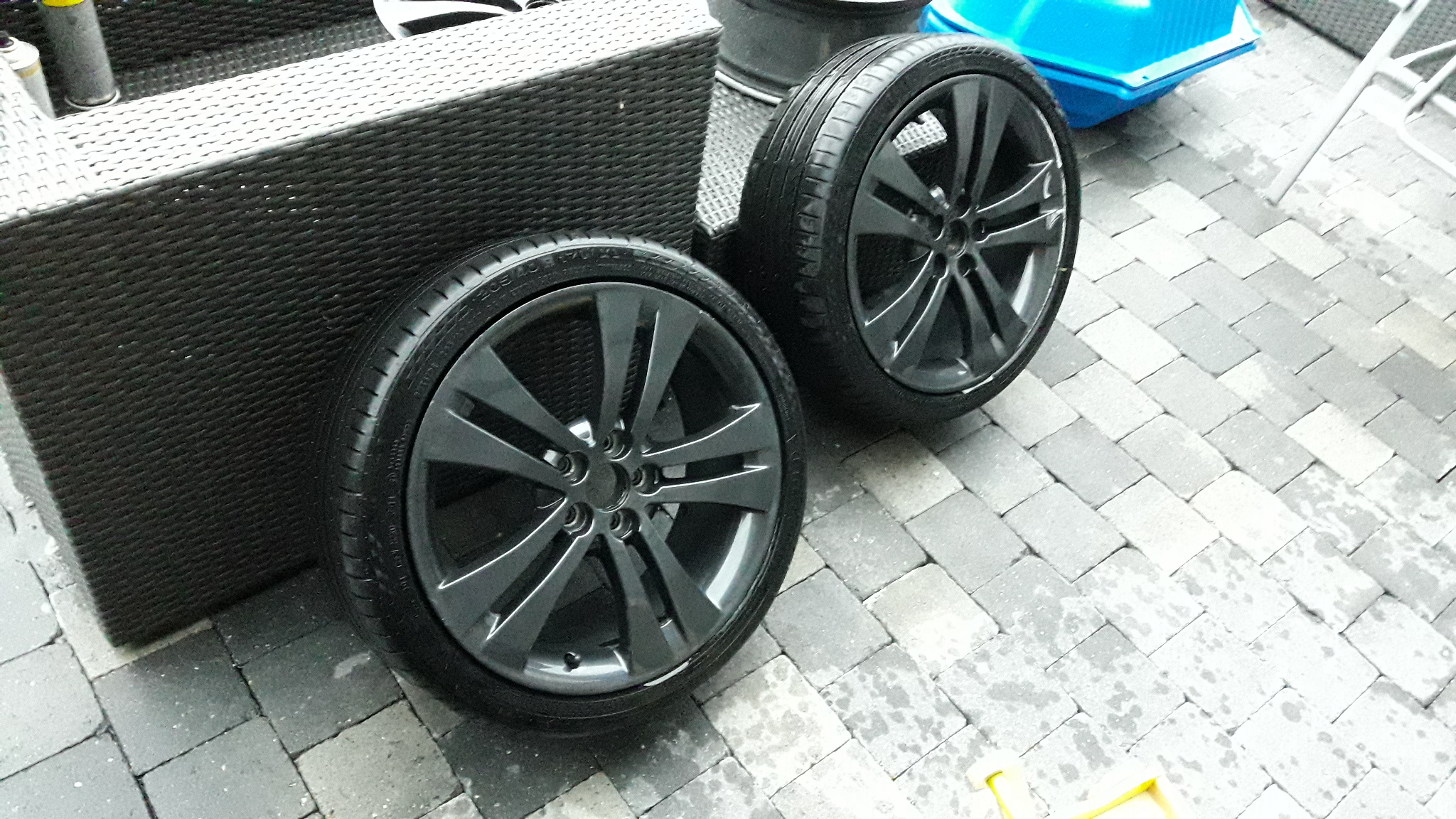

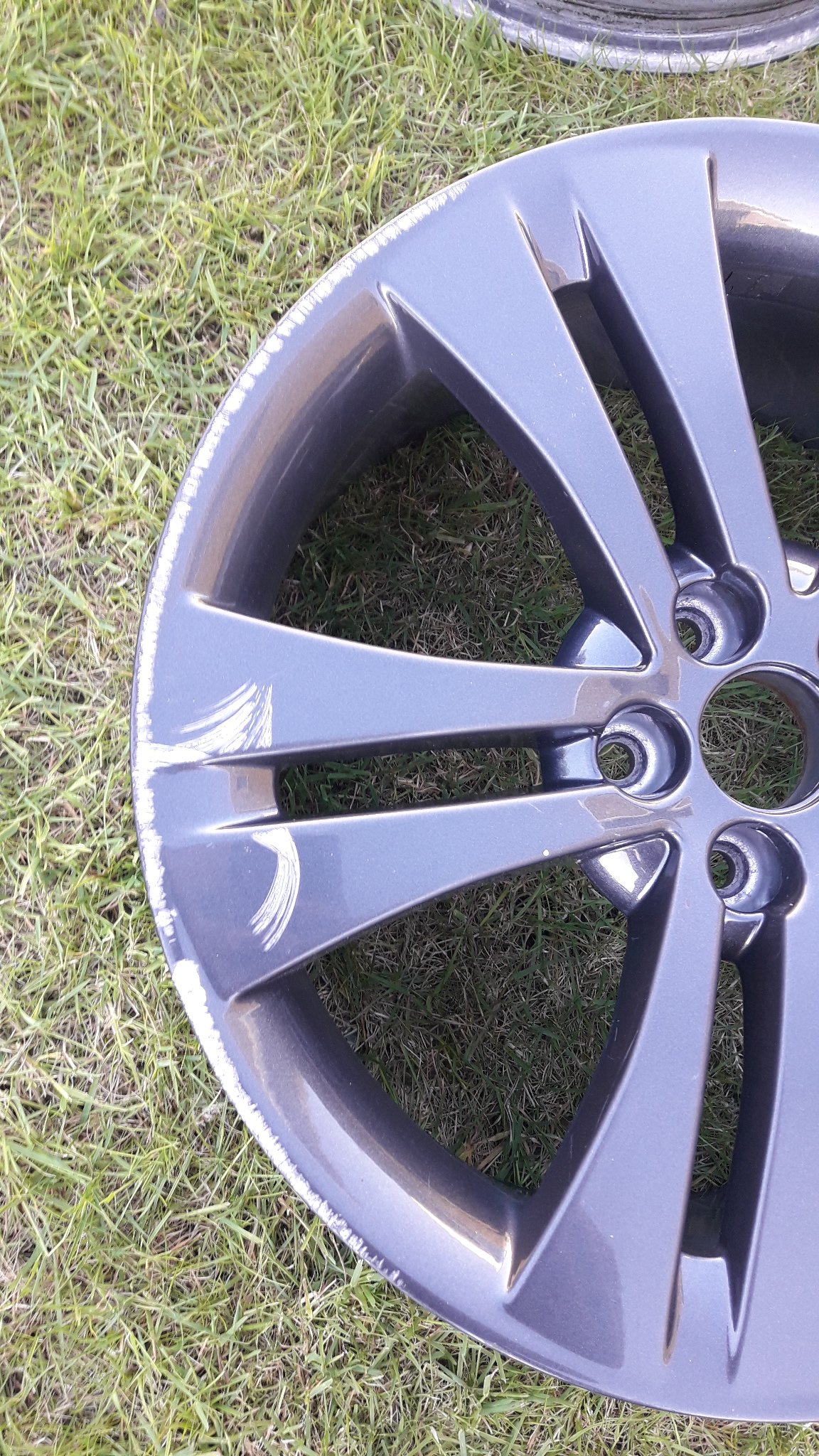

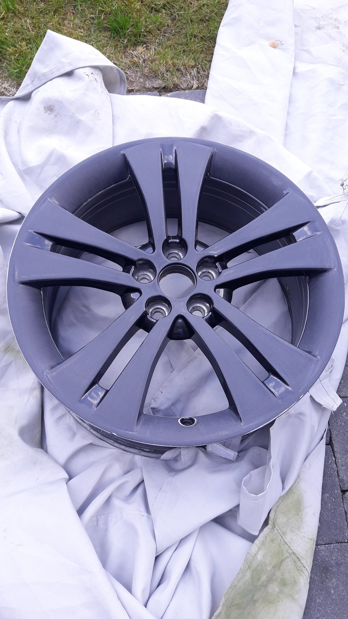

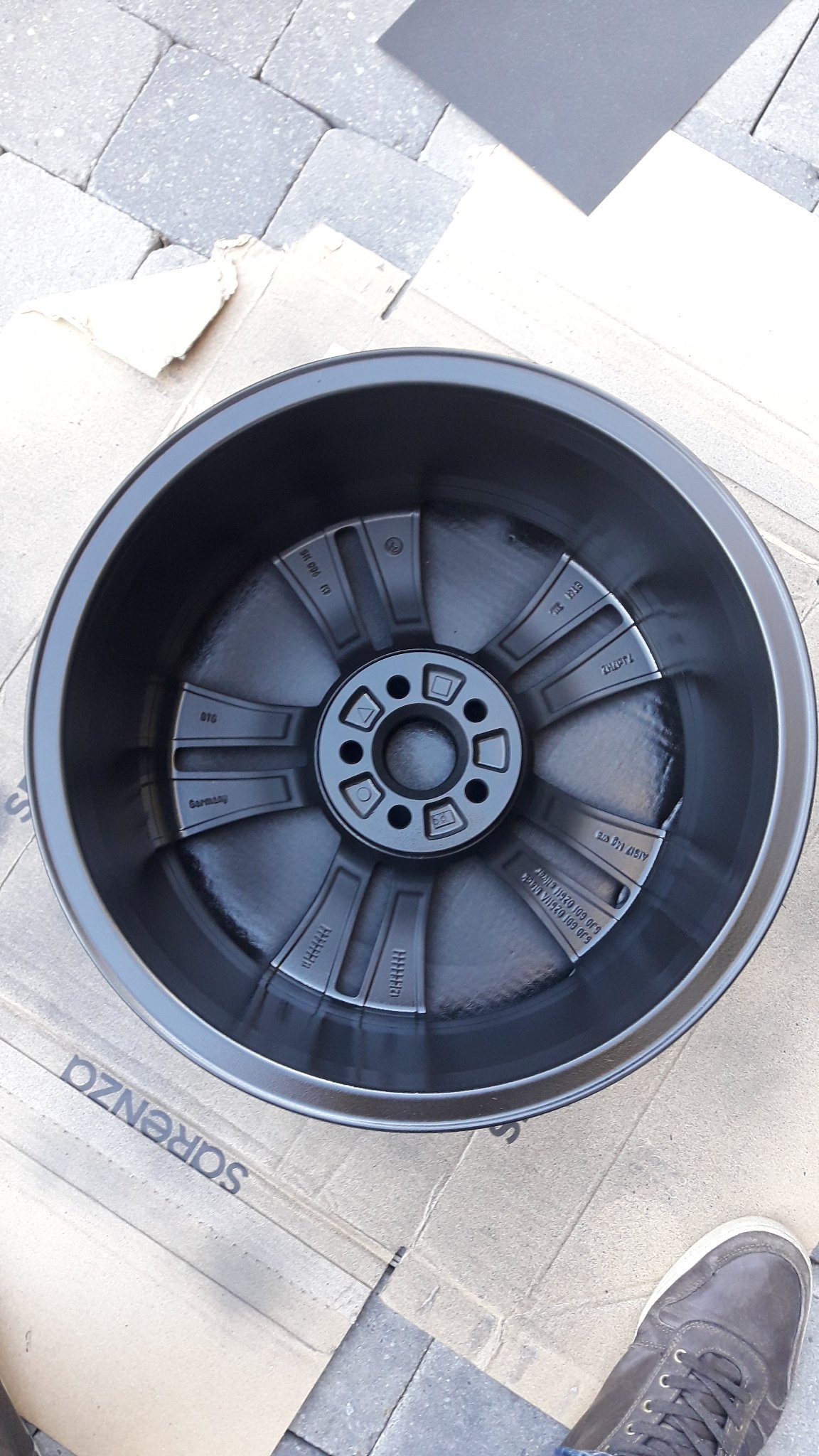

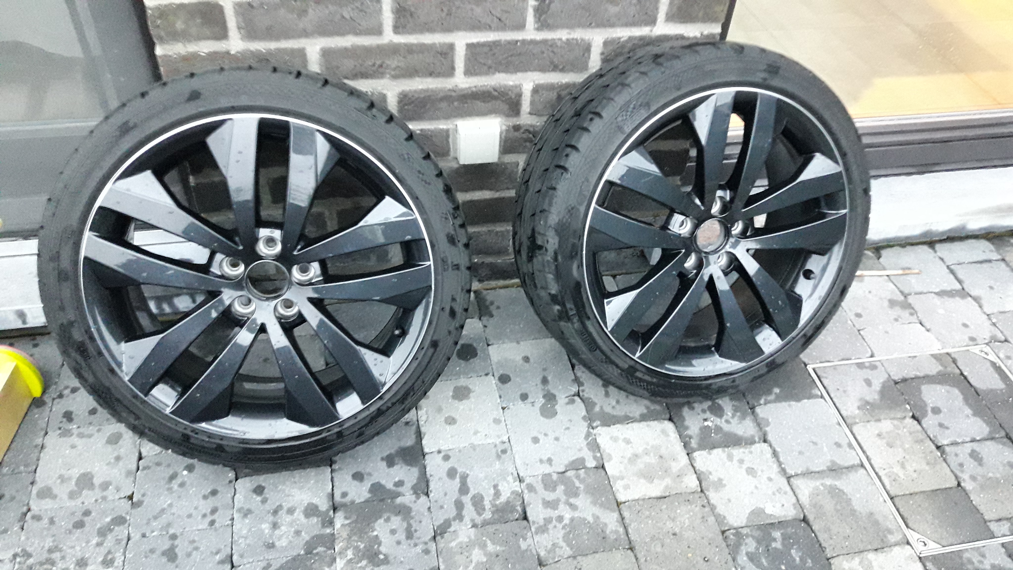

So today i tackeled the rims that cale with the car ..
Besides the O.Z superturismo GT's
Ive also had 2 VRs OEM gigaro black on continental sport contact 3
And 4 monte carlo rims
2 with continental sport contact 3
2 without the tire..

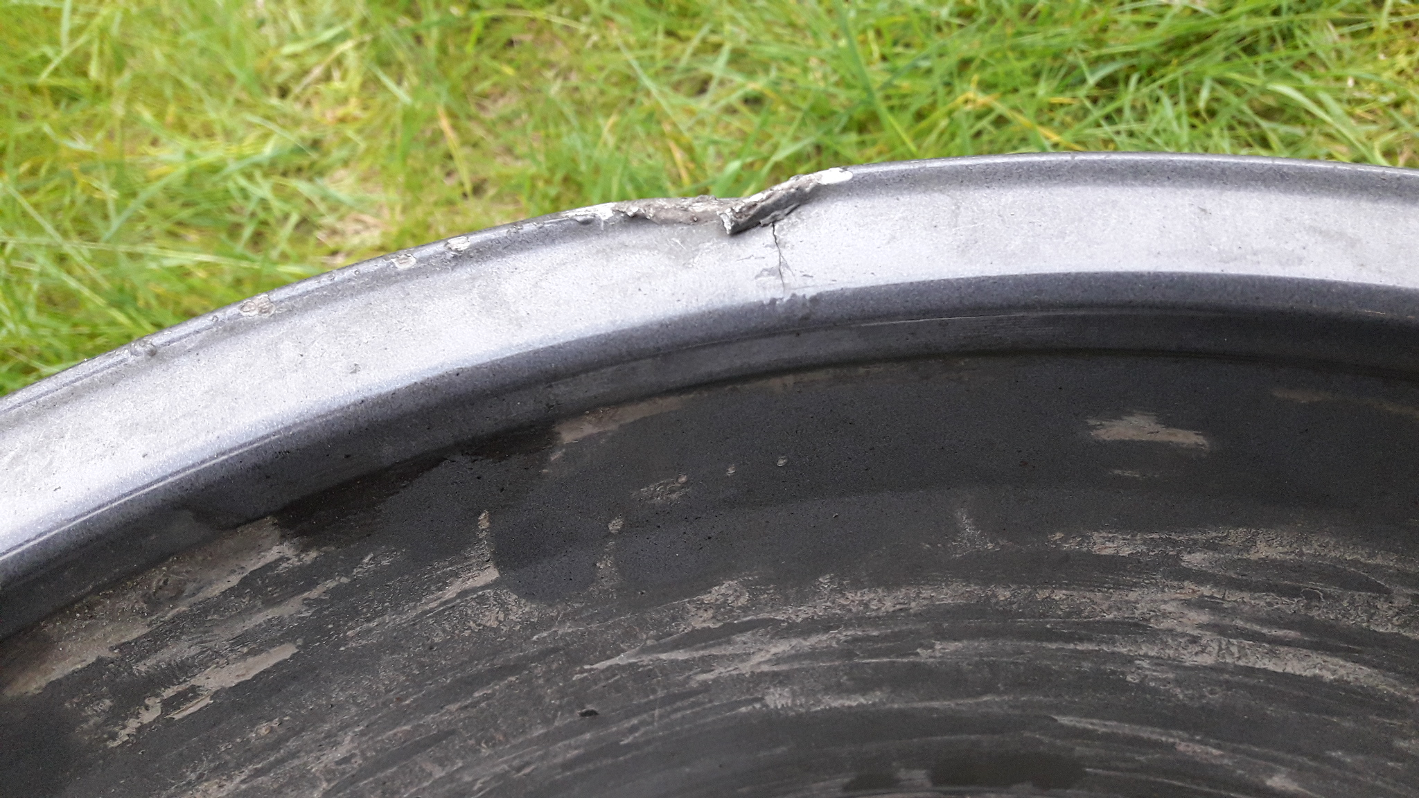

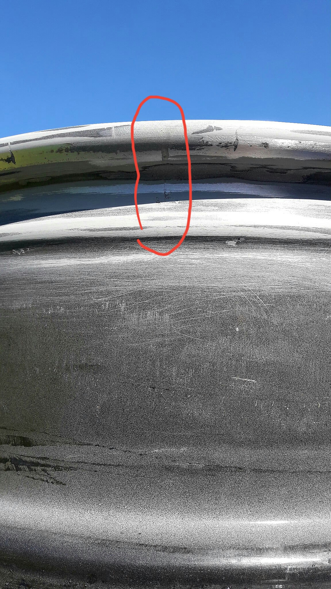

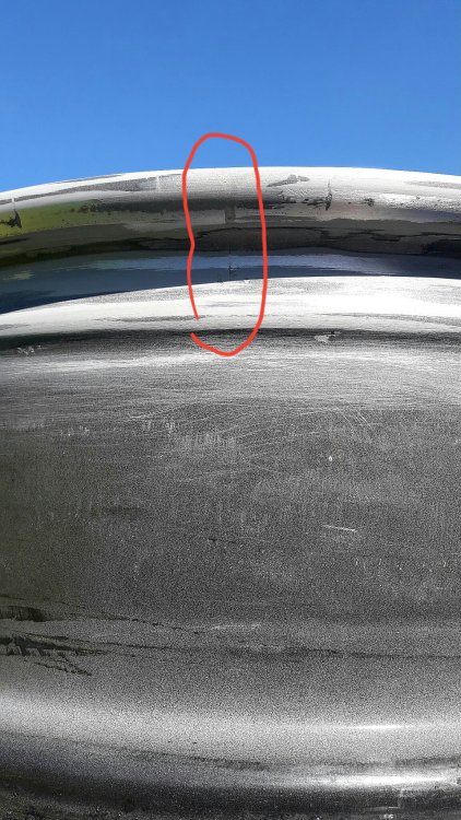

1 of those 2 had a crack inside ..
So whats the deal here .

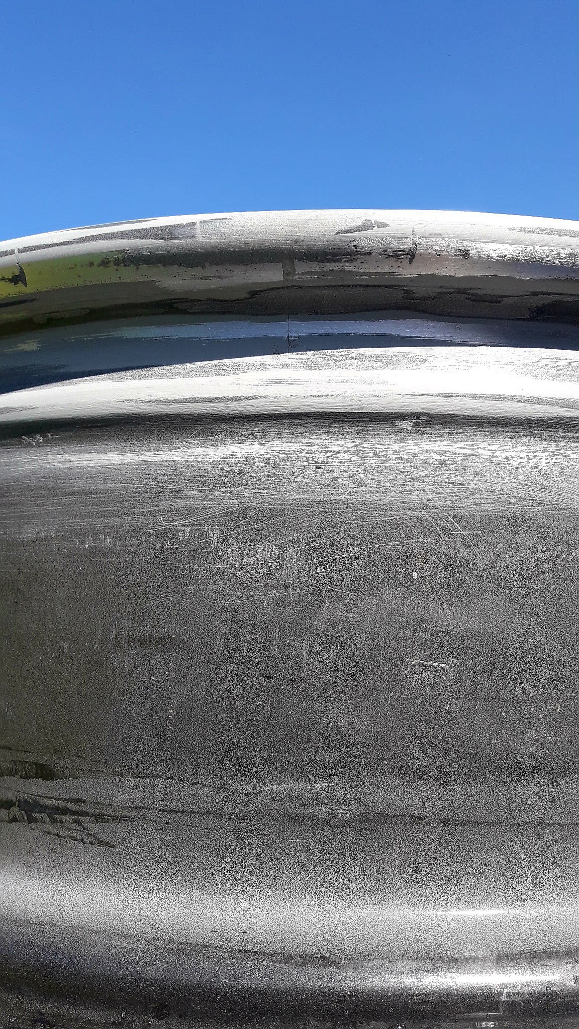

Getting the rubber of the monte carlo rims because they are still very good shape
And the vrs gigaros ar mint (2×)
So i need to buy another 2 new ones . And then replace the tire of the monte rims on the vrs ones..
So im left with 4 monte rims witch are curbed bad, tar'D bad , paint scuffs...
Ime going to weld the cracked one . And repaint them. And sell them on.
Ooh and i removed like thousand weights...
The 2 vrs gigaros need just a little polishing..
So the cracked rim went to this
Needs a little more metal putty to it .
Other rims got sanded and dipped black ready to go.20170509_200938.thumb.jpg.a735af67b80879aefcfc5f0302e9f422.jpg
And ime going to refurb my O.Z rims in gold dip . After the curbrash been sorted offcourse.

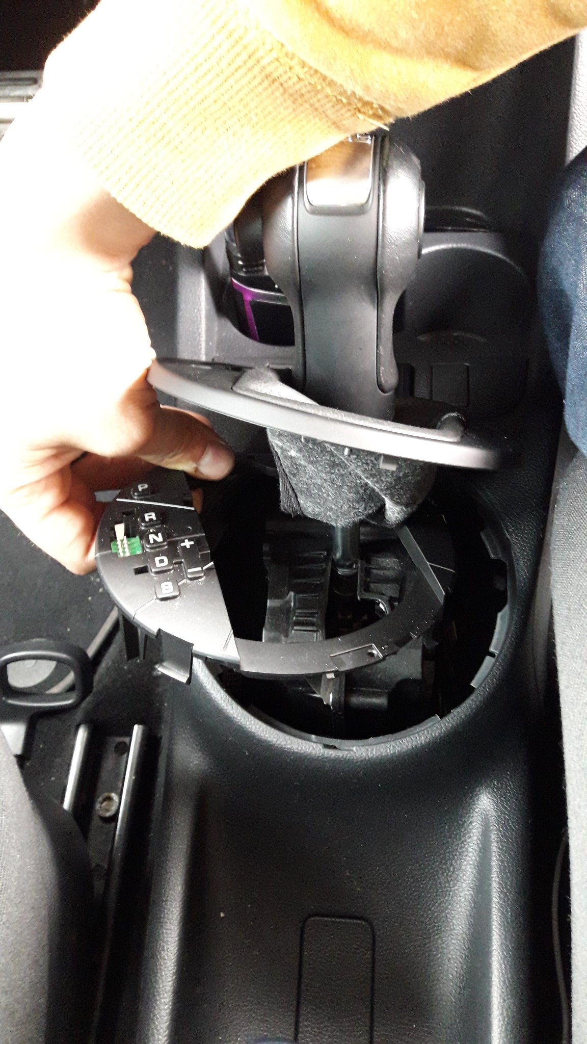

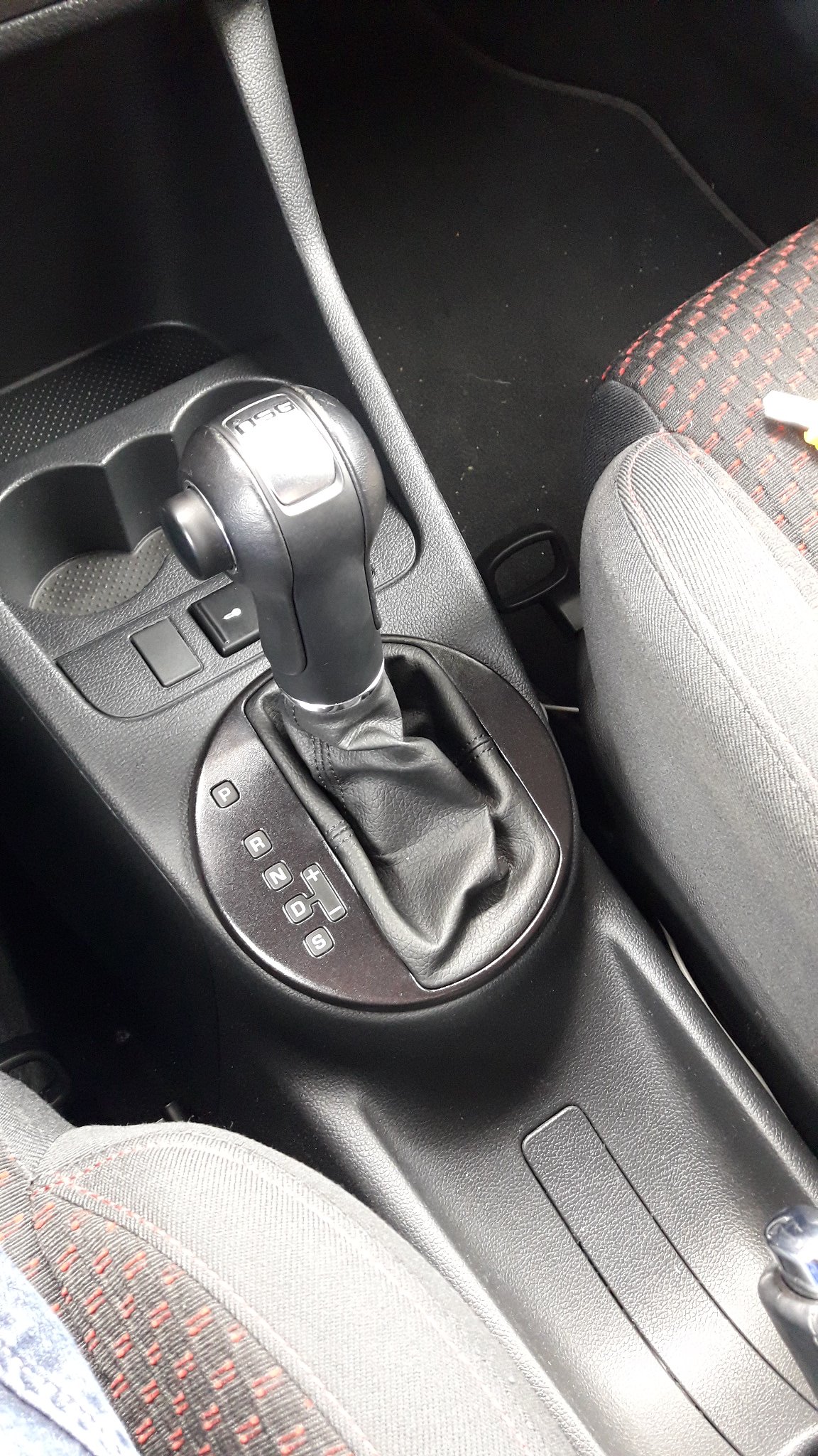

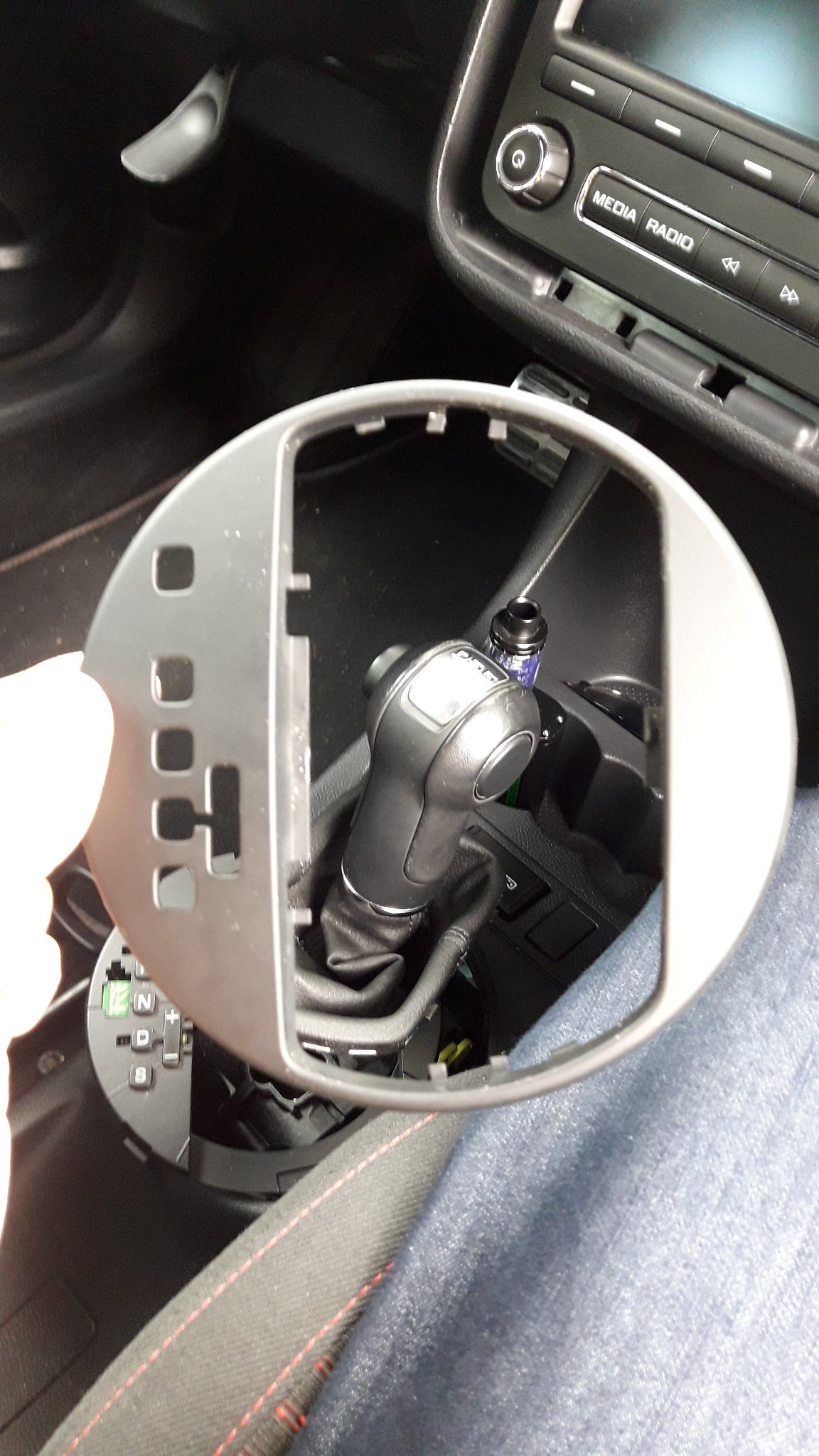

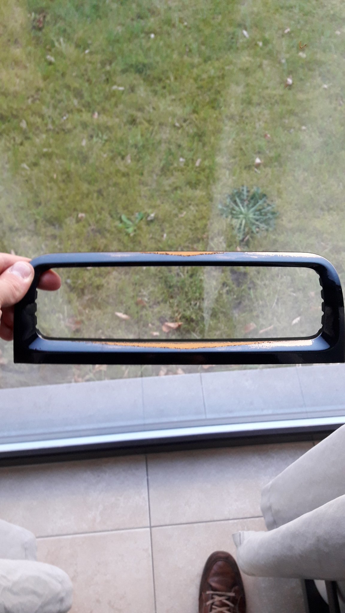

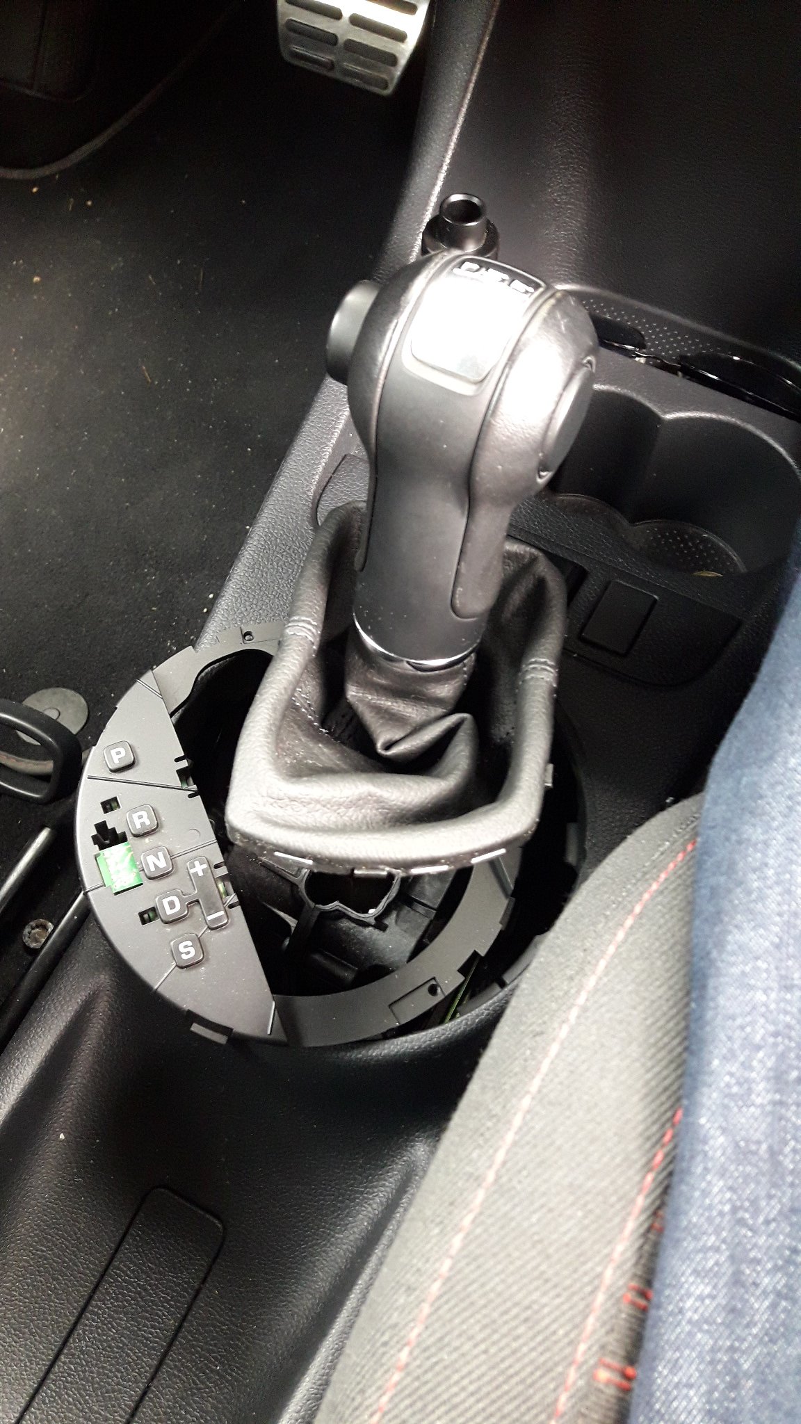

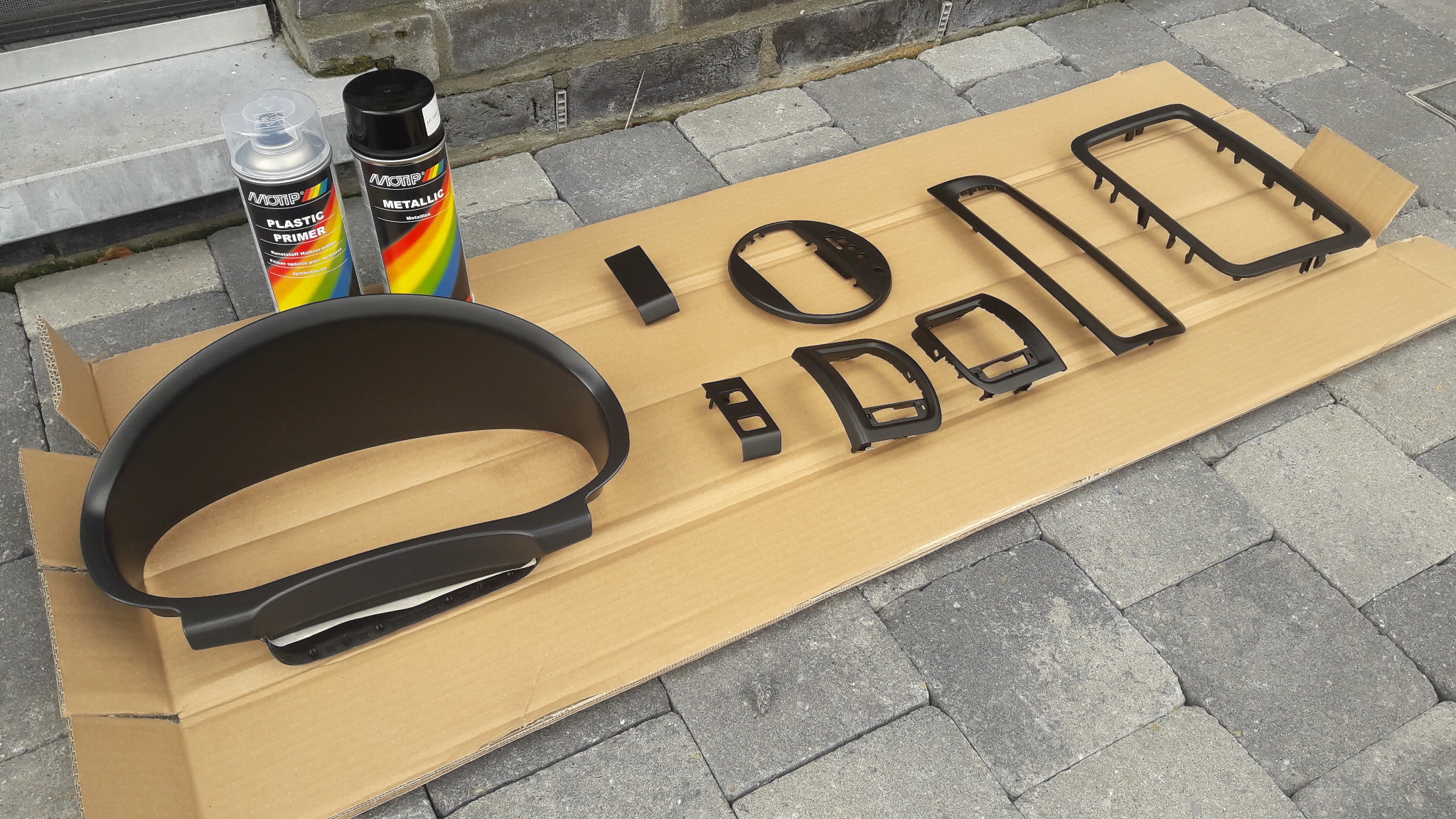

Next tackle. Wrapping pieces gloss black . Nerve racking to get the dsg part off ..
And almost snapped the middle heater cover . Bt i managed it.
Looking forward to seeing them wrapped.

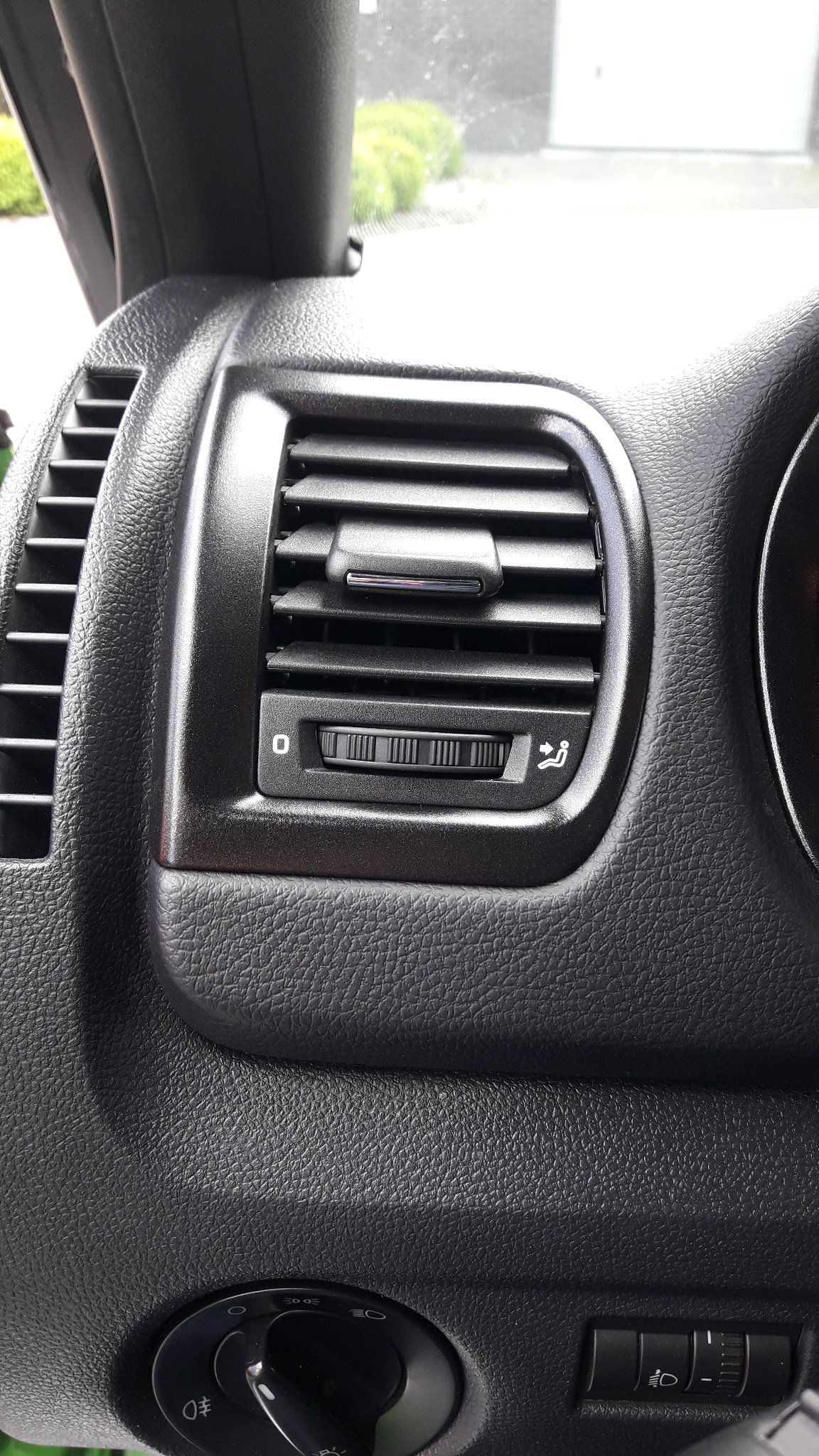

So the wrap didnt work out . Decided to spray paint them . Mettalic gloss black
The wrap turned out very orange peely... sadly it had to go .. was cheap to so ...
Painted and installed back . Not extremely different but it did change .

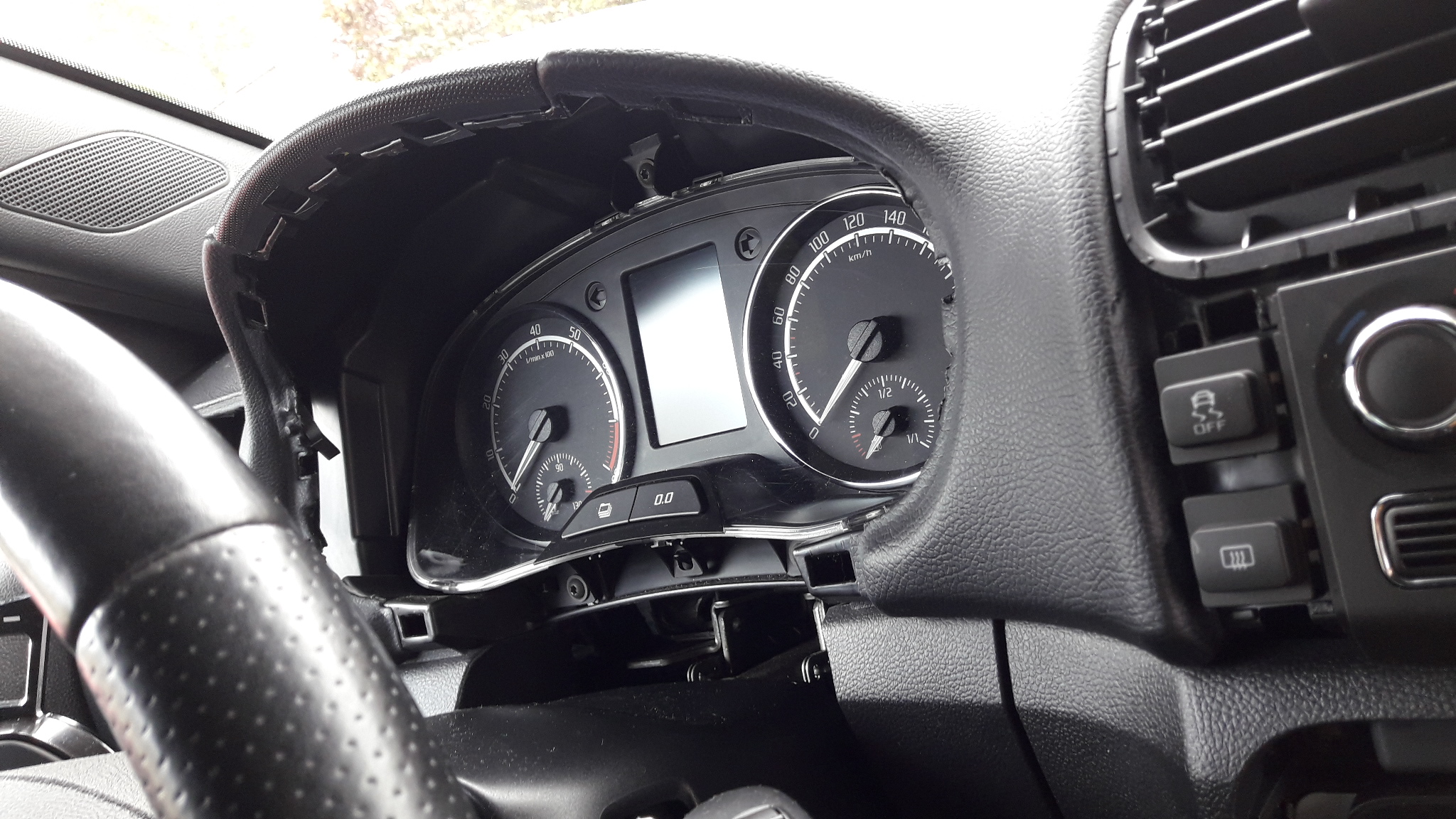

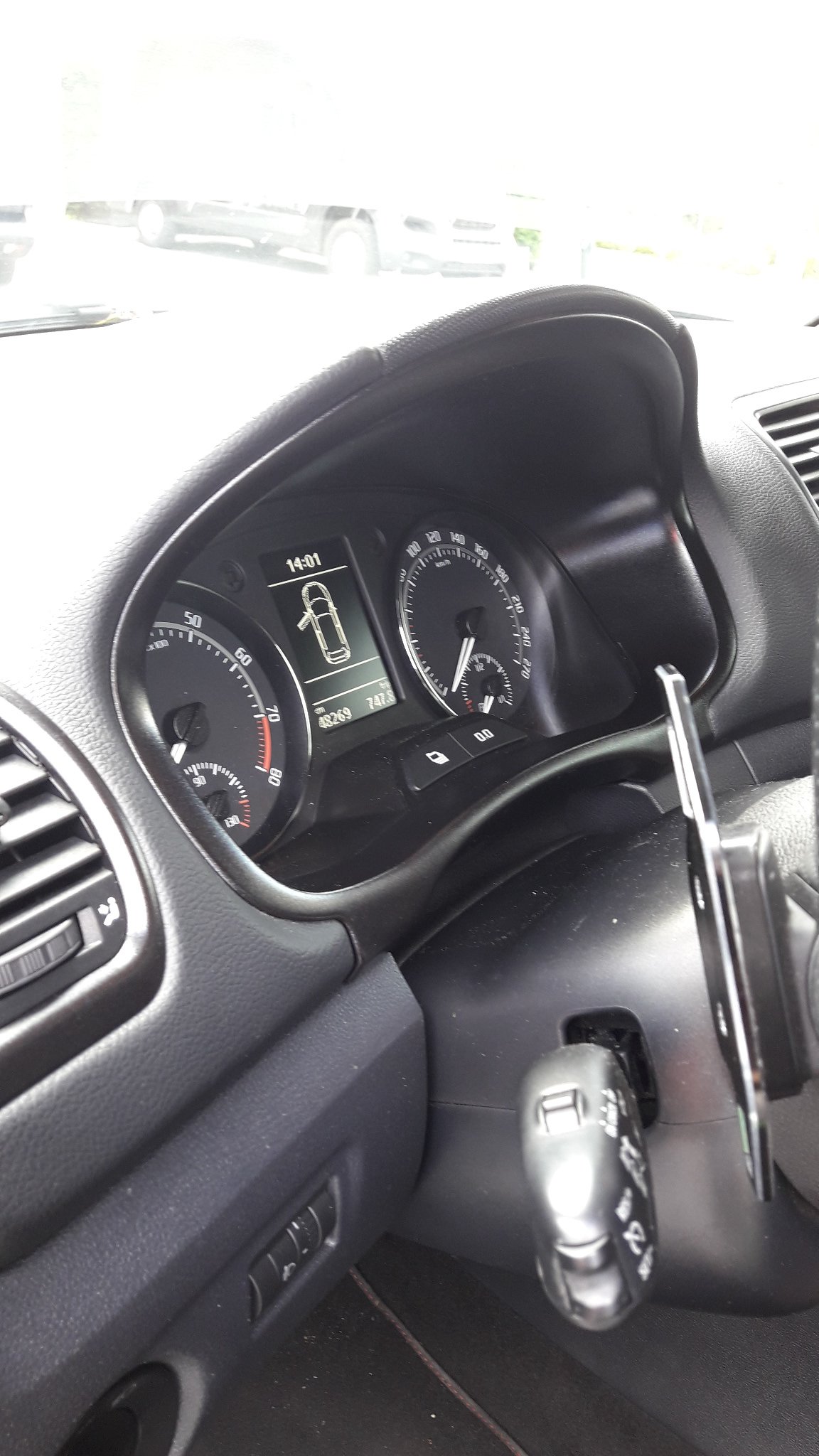

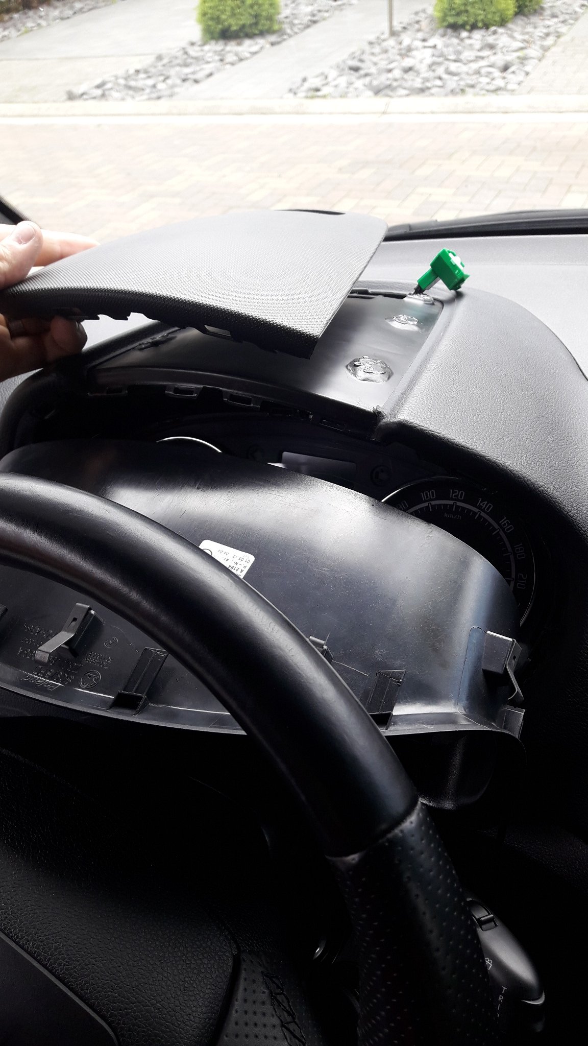

Dail cluster cover is a pain in the ass tl get back on.. during instal i snapped the topside loose . So painted that to.
