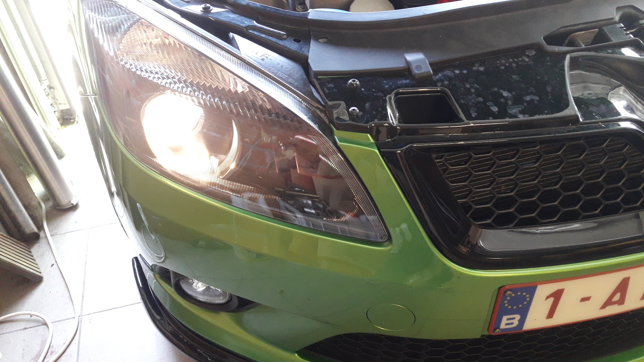

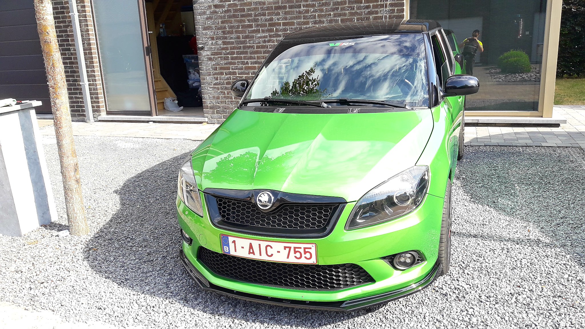

Drl mod gloss black inside

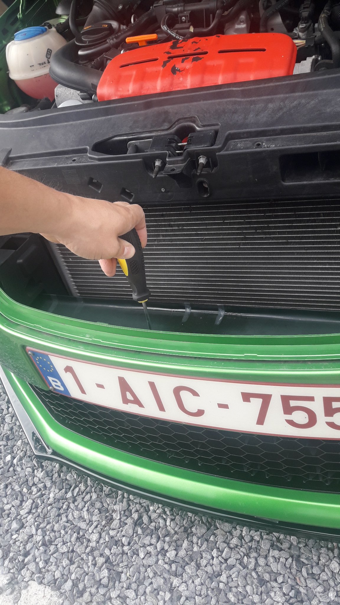

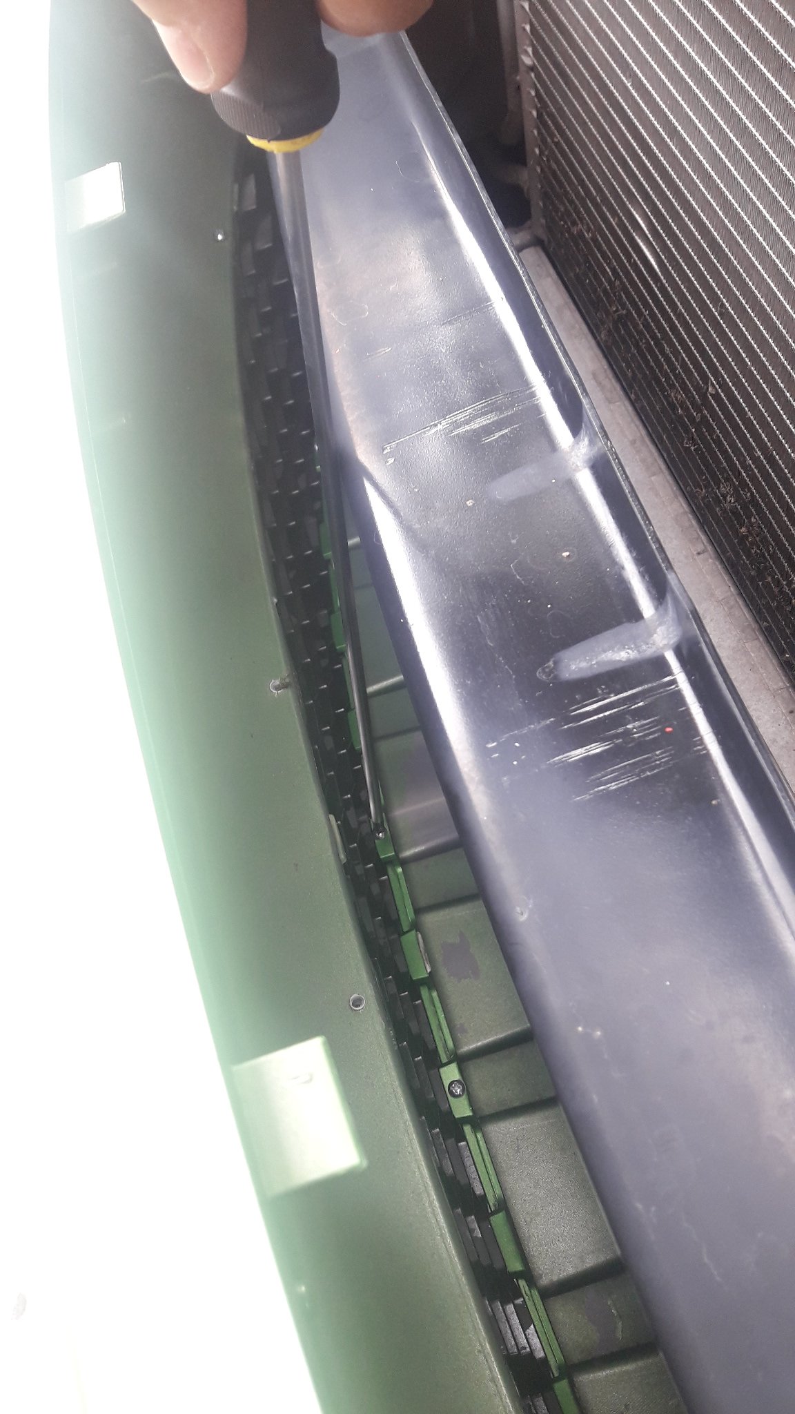

Allright . So thx to my previous grill mod. I could take the grilles off WITHOUT  removing the bumper.
The blistering paint wont come off so ive ordered new grilles for the drls and lower honeycomb grill .
The upper grill will be replaced with a milotec honeycomb one...

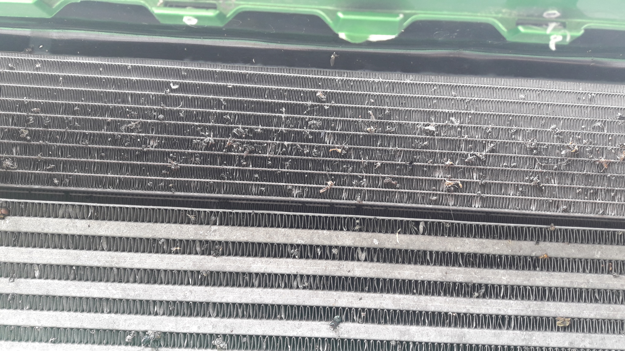

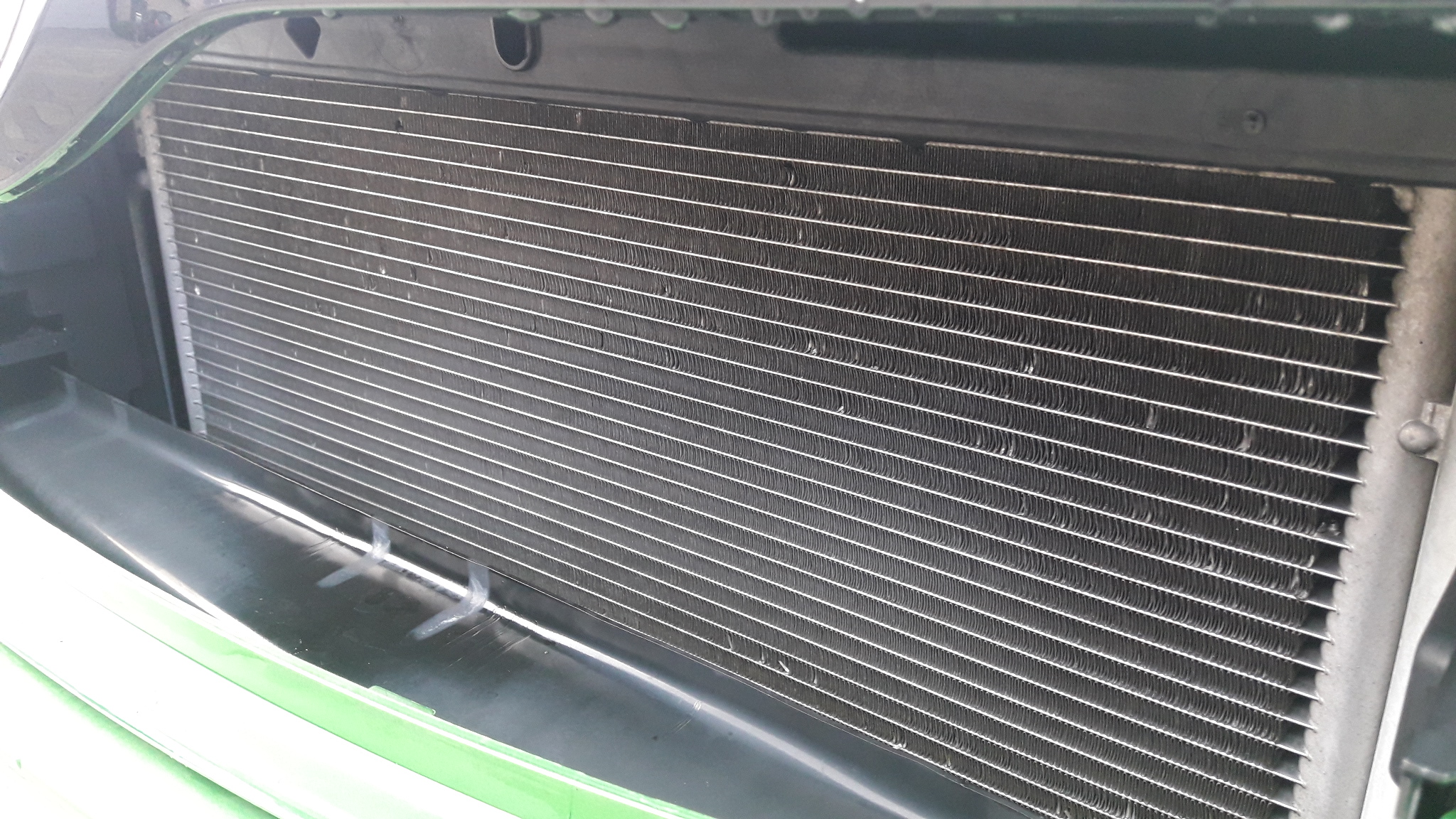

Whilsth the grilles where off i took the liberty of cleaning bugs out off the radiator and intercooler...
Coming on nice .
The black drls insert looks so much better.

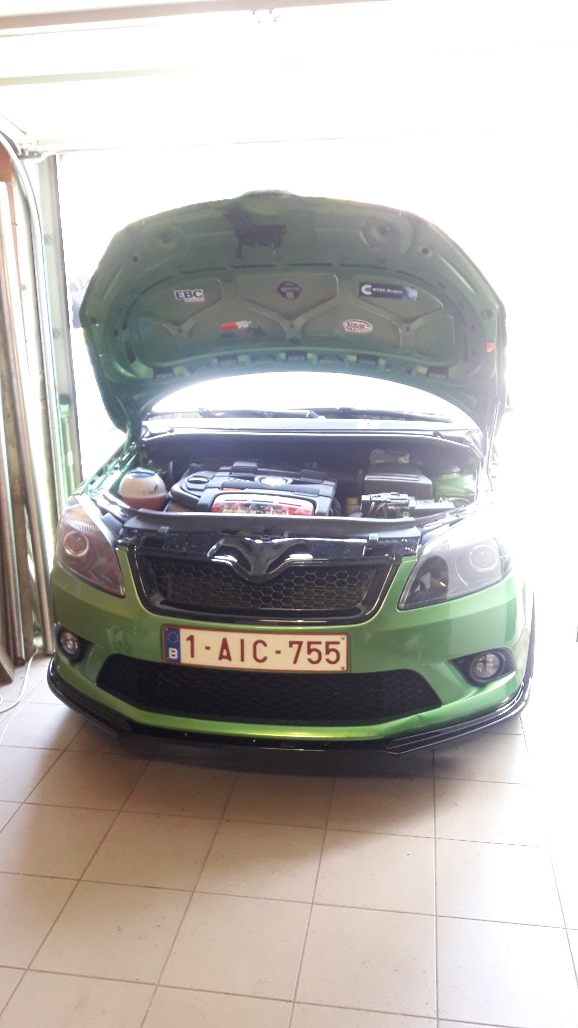

Okay so ive ordered new grilles OEM and a milotec upper grille . Now its coming along perfect.
Also notice the black drl's
And a new vrs logo

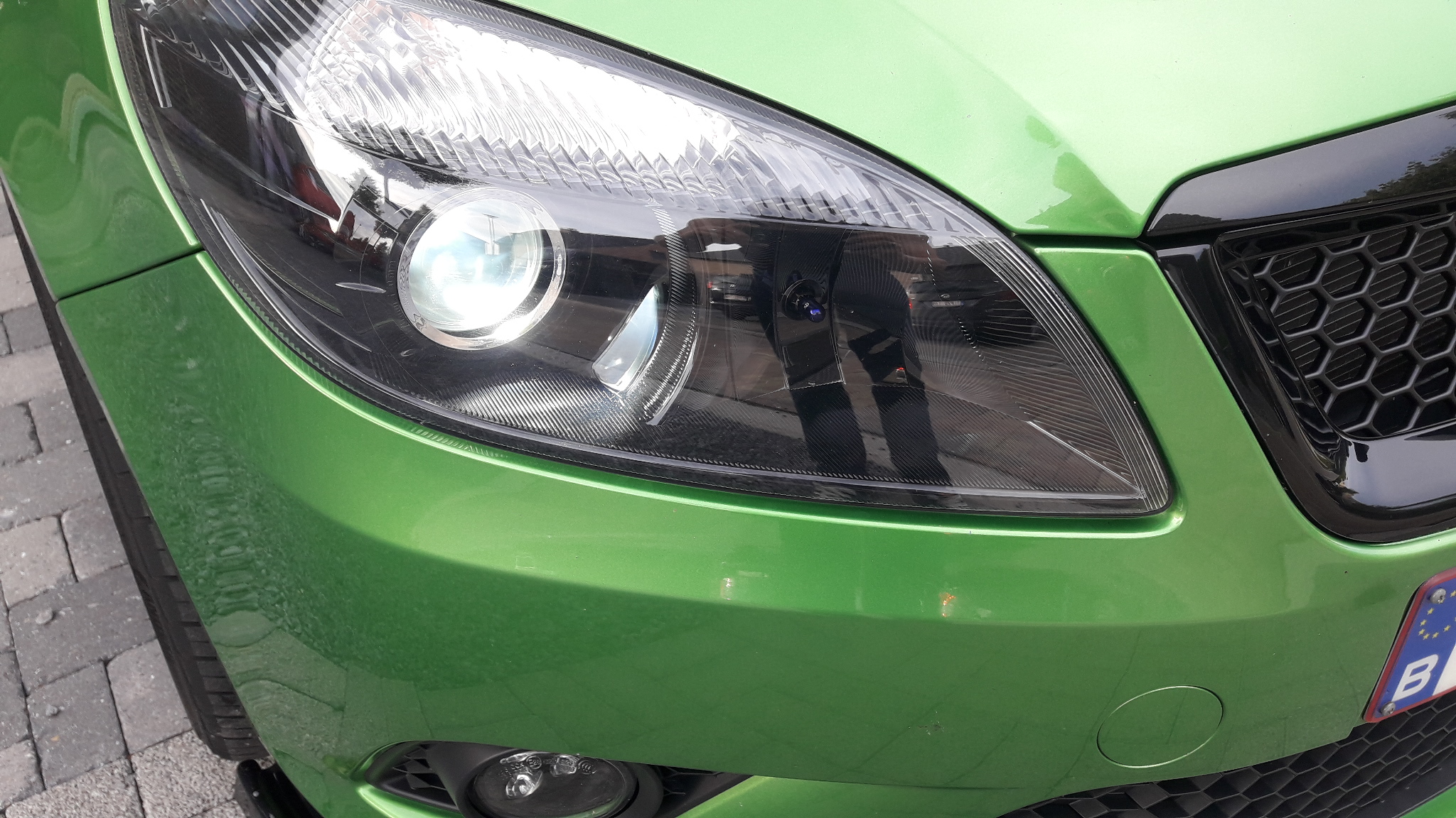

Ive bought some philips LED lights h7 today . Fitted them with my buddy . They are awesome. Bright white with a little bleu'ish tint
Pics of the led before and after later.
Before
After . Miles better.

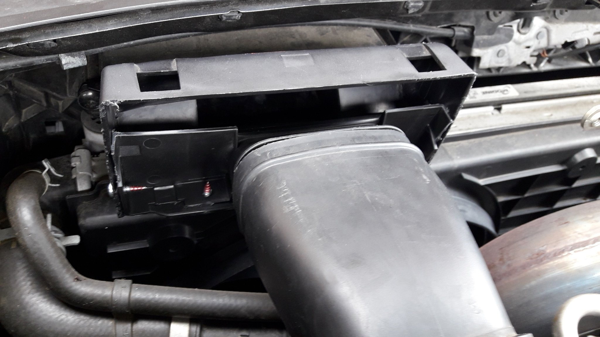

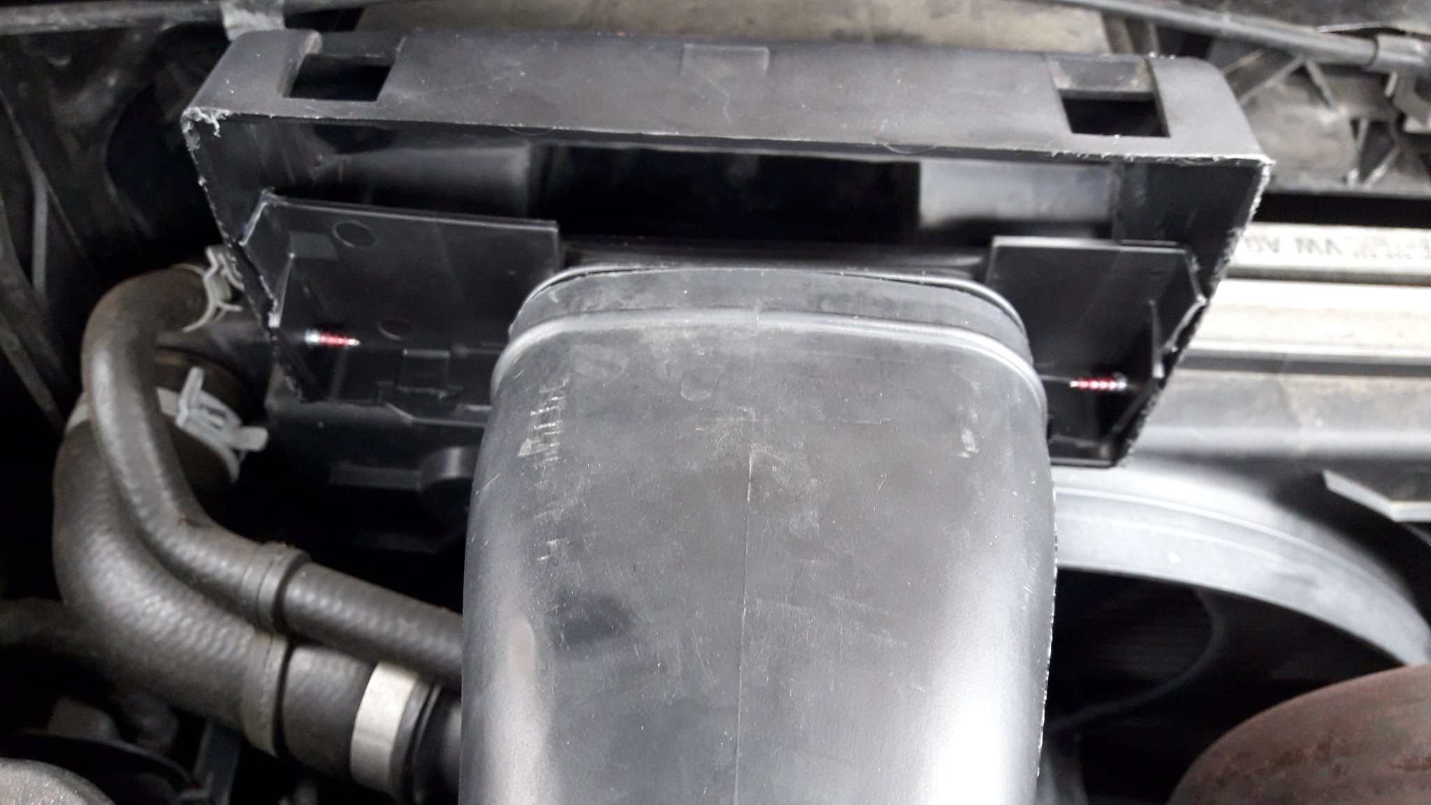

Air intake oem modifications .
So as i found out some time ago the air intake (oem) does not really helps my airflow. So i got the middle part out .
Cut away some plastics .
Put it back upside down.
Put in some screws and mount that pipe that goes to the filter housing upside down.
100% better airflow .only it needs a filtercheck ones an a while ..

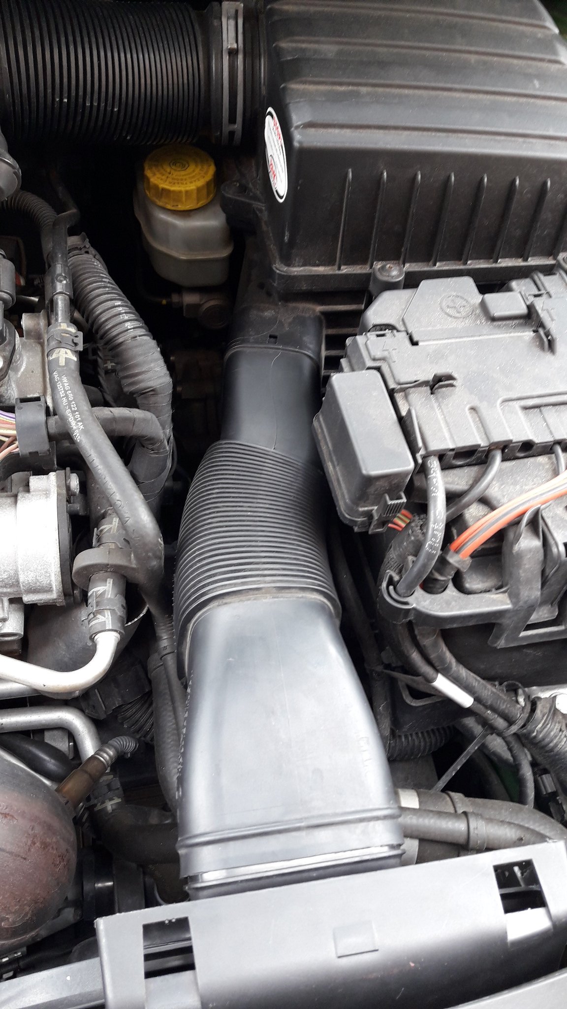

So this right here costs nothing . So i dont need to spend many euros on a upgraded intake ..

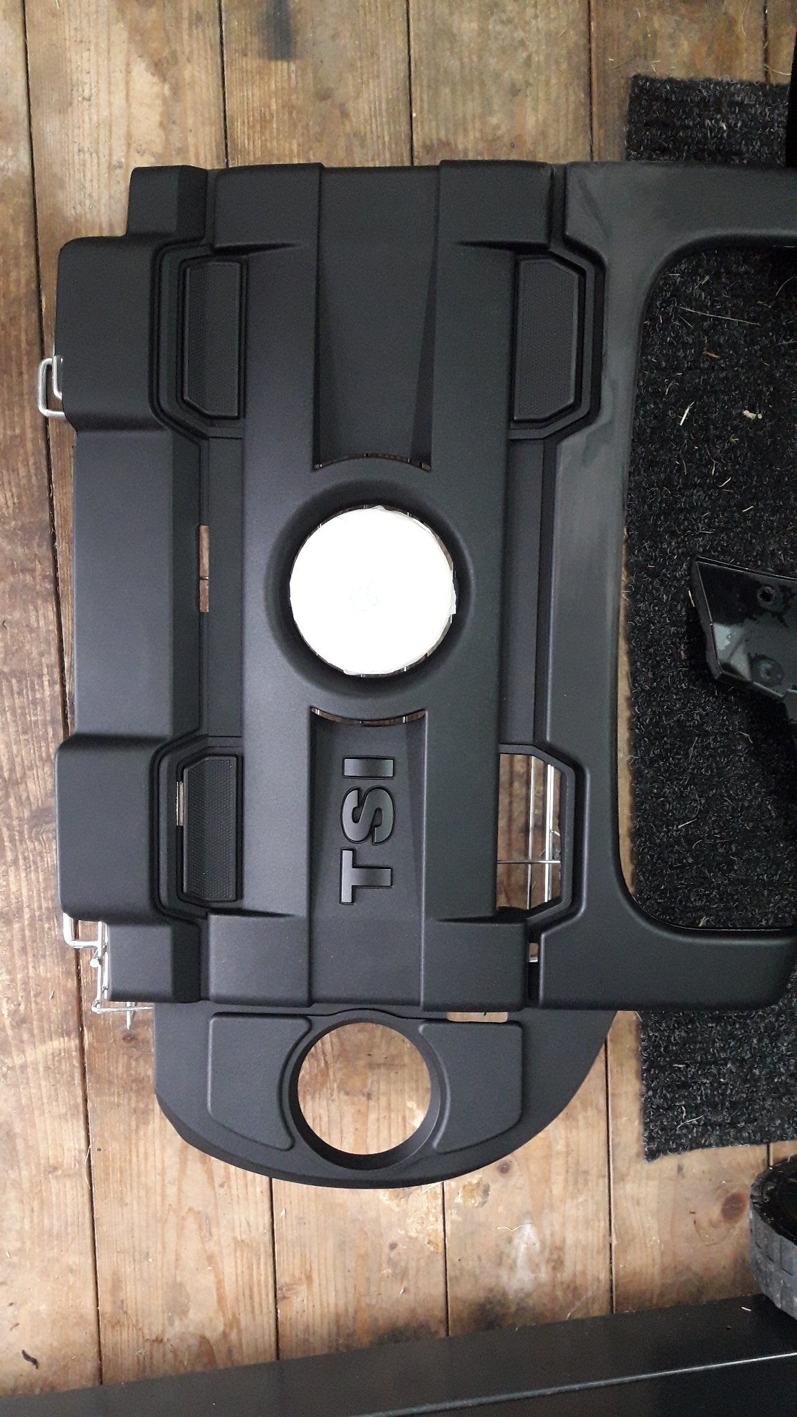

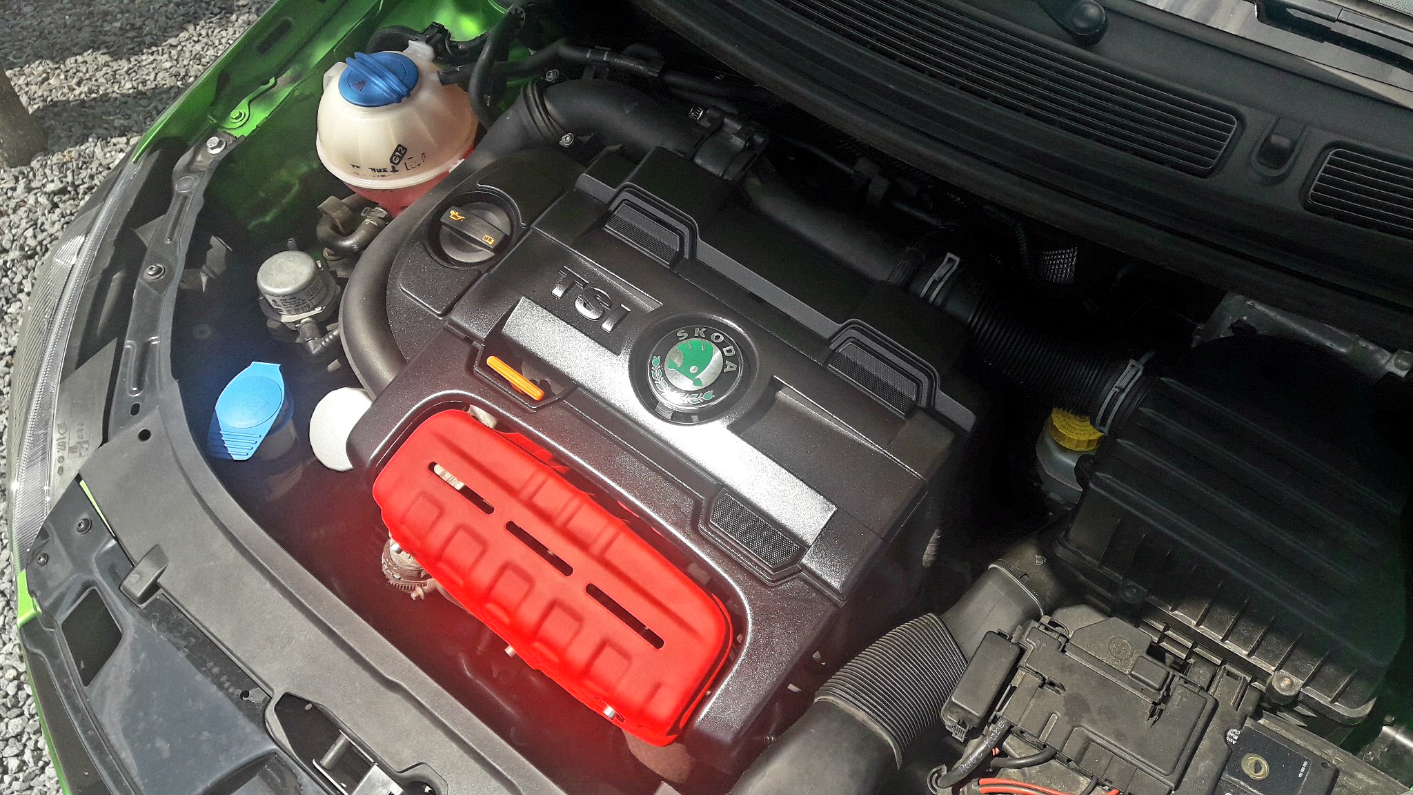

Snapped the engine cover today.. dont know why that happend . So fixed it . And painted it mettalic black.
And refurbt my turbo heatshield ready for new paint .
Crack right upper corner
New turbo heatshield paint . And cover refurbed and painted mettalic black .

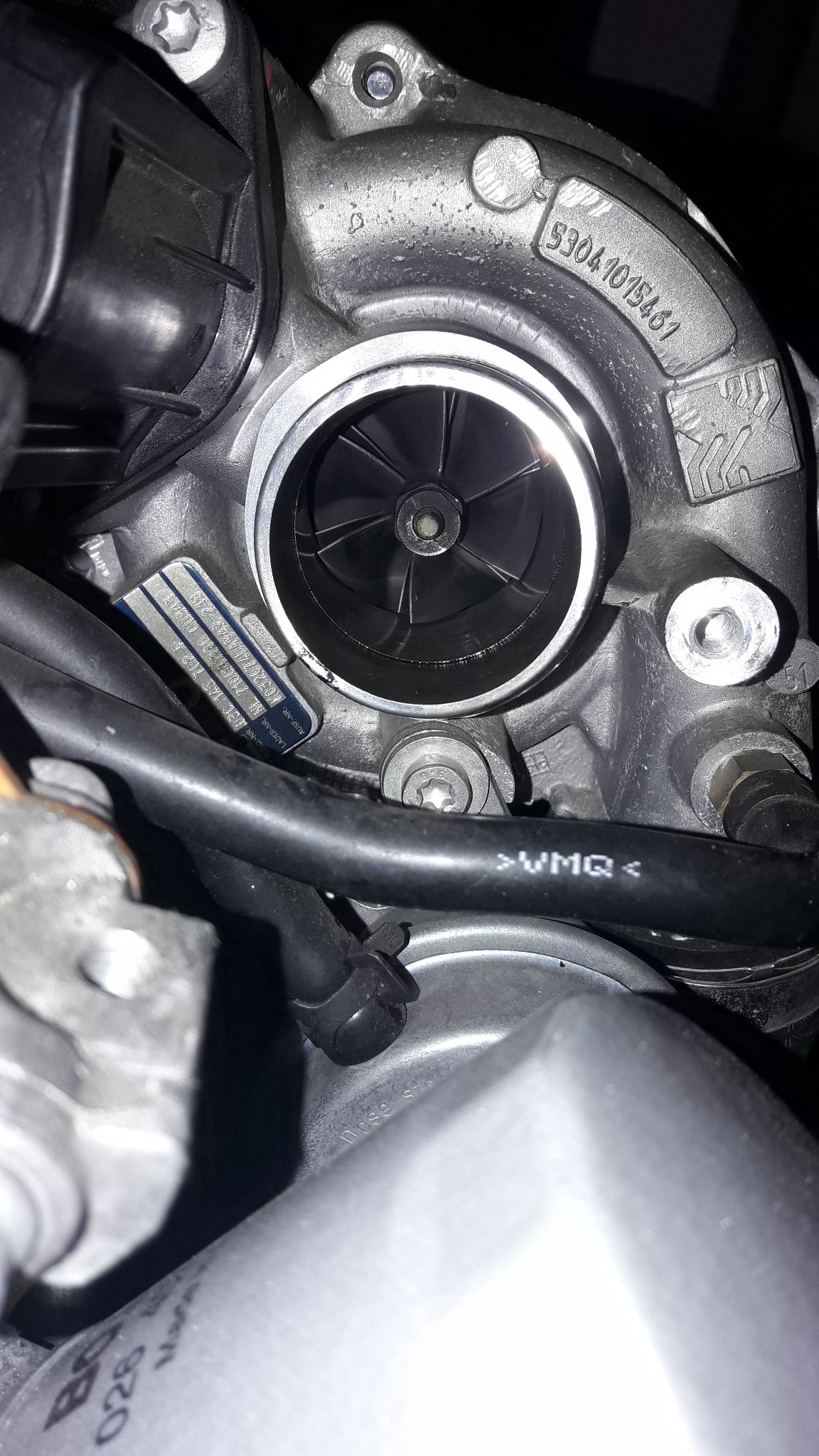

The turbo is a gonner ..

No other damage has been done . Its my fault i caked the turbo . Riding to fast on a cooler engine and cutting a hot engine off . .. feel bad about it . Never going to do that again.

 No a special made turbo with stronger internals stronger seals etc..
 a company from the netherlands . C&E turbos . They only make turbos . There quite know from the racing scene ..
New turbo cost me about 650 euro .
A weaker oem one would cost me a grand.

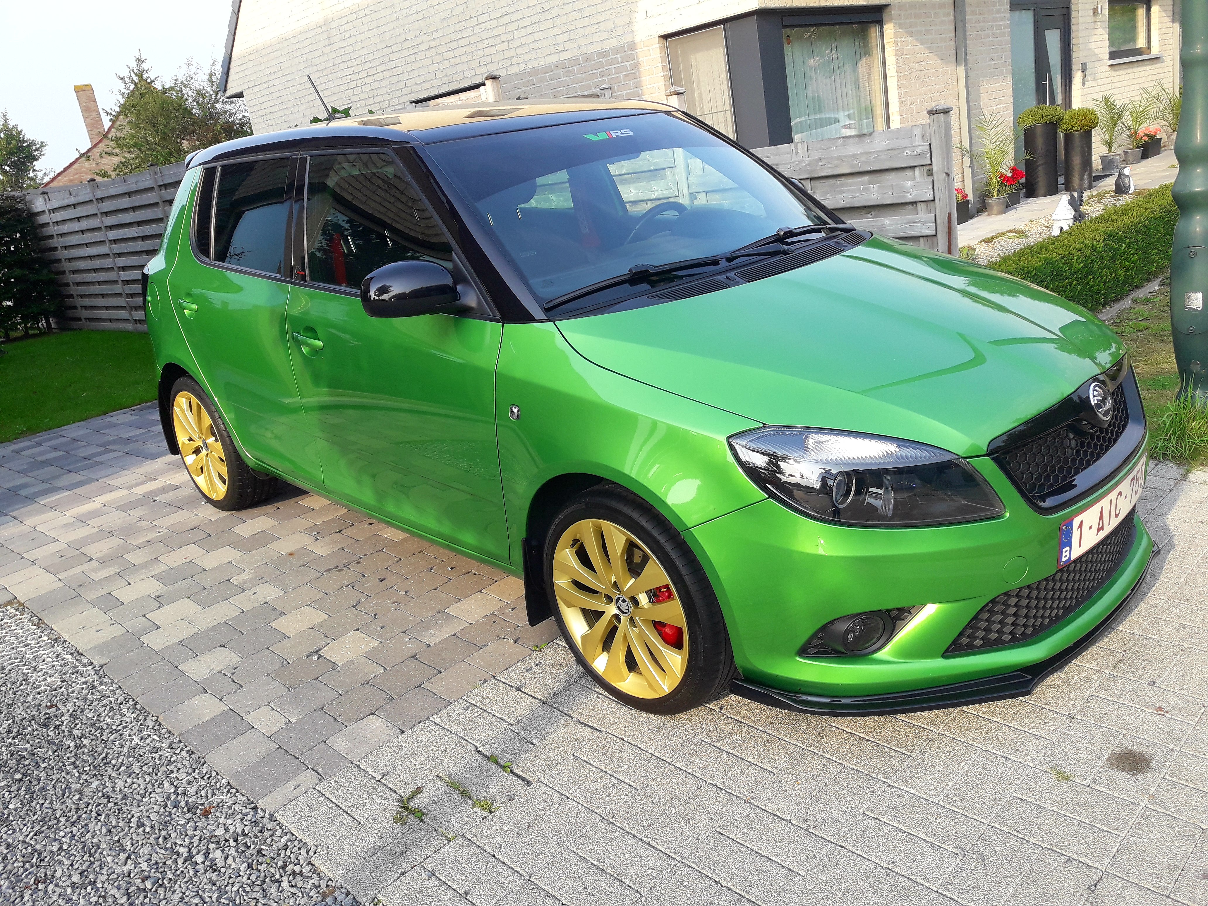

 The Car is repaired and looking beastly with my gold diy gigaros ...
loving the gold alloys! Mine are fully green, did u replace with oem turbo or with the loba
It's looking good!
I like the shade of gold on your Gigaros.
