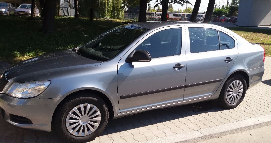

After 6 months - Short Review of 1.2 TSI Octavia
This is a chain belt driven - CBZB engine. Wanted to share my experience after 6 months.

I like the color, :) for starters
