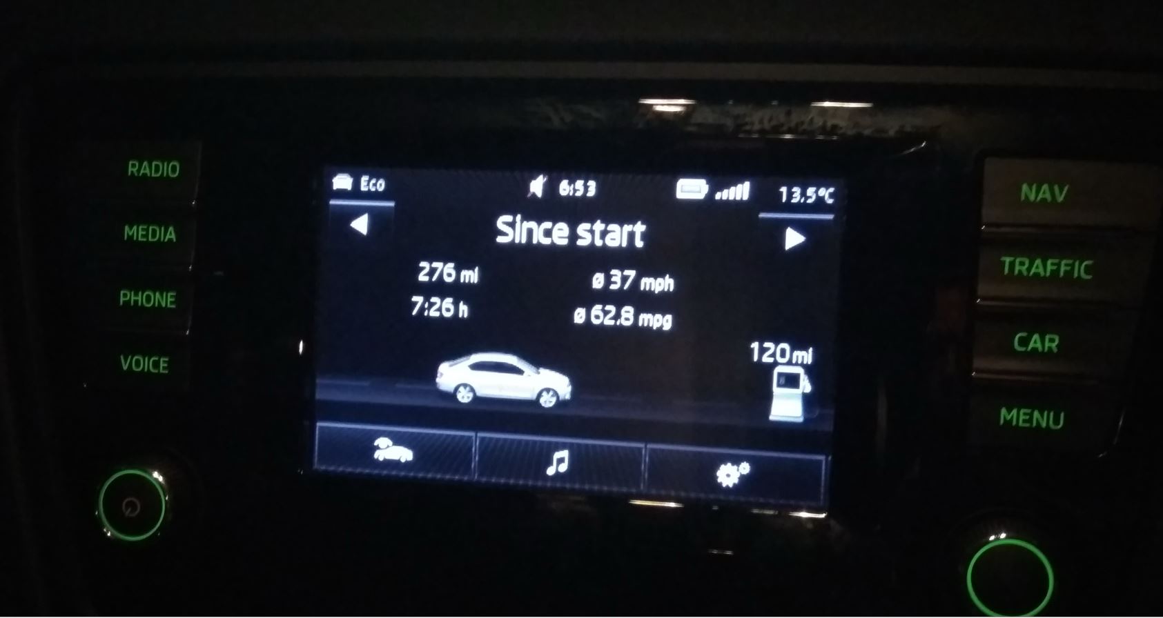

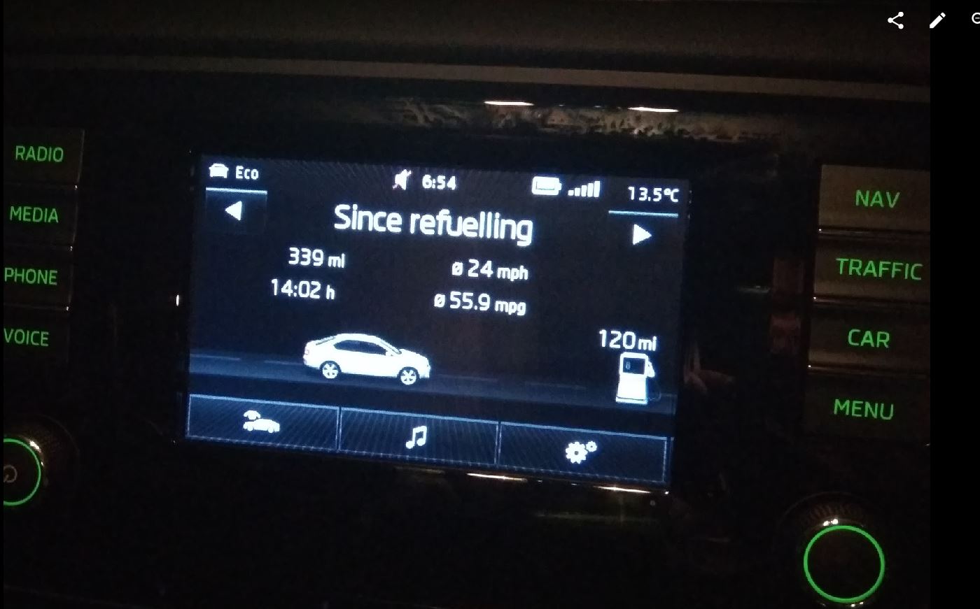

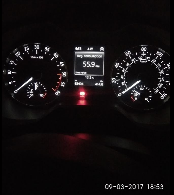

Hi guys,
Following pictures are the summary of my London-Birmingham-London fuel consumption,Since Refuelling Consumption, Average Consumption and SKODA DATA SHEET regarding this car. During my motorway drive i have managed to raise the MPG up to 65mpg only, but that time i was driving 50mph for 10 miles in 5th gear as there were road works on M6.
I have tried my very best to get the potential highest MPG out of this car which includes driving always by recommended gear, stick to 70-75mph (obviously sometimes had to overtake and stick to 80mph for few minutes to catch up the time), coasting etc..but no way i could get to over 65MPG in long motor way.
My car setting was..Normal mode/eco mode, AC off, Tyres 225/45 17 91y (all round), tyre pressure rear 37psi, front 37.5psi, tyres ages are 8years, 6years and two 2years,
Fuel from ASDA, I used an injector cleaner (Lucas) after driving like 1.25 hours.

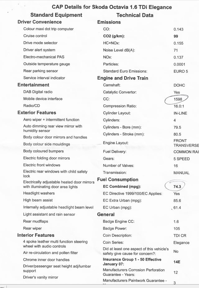

NB: READ THE FUEL CONSUMPTION SECTION FROM THE LAST PICTURES .
I JUST NEED YOUR OPINION GUYS. I KNOW THE FIGURES SHOWS ON THE SHEET IS THE HIGHEST MPG THAT CAN BE OBTAINED FROM THIS CAR IN A TEST LABORATORY. BUT I WANT TO COMPARE WHAT YOU ARE GETTING FROM SAME CAR.
The figure's u are getting are very good considering the milage on the car and the fact its weight is around 1700-1800kg's, That's alot for for little 1.6 cr tdi to pull along, you old citroen is a lot lighter at about 1300kg's plus the 1600 hdi is a pretty decent engine, which for the past few years has seen service in 90% of ford, mazda and volvo models.
Also take the figures on the handbook as a pinch of salt, because after 22 years as a mechanic/mot tester i have never seen ANY vehicle new or used match them.

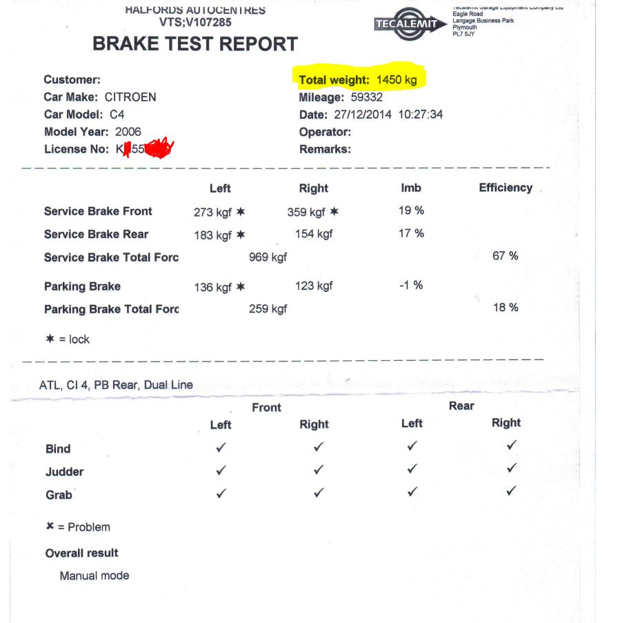

I seemed to have found brake test report of My previous Citroen..below is the picture..is it what you were talking about..i highlighted the weight.

Yes that what i ment so your citreon wighed 1450kgs, incidently i work form Halfords autocentre
All right..now i got what you meant.. so what Skoda Octavia weigh then?
