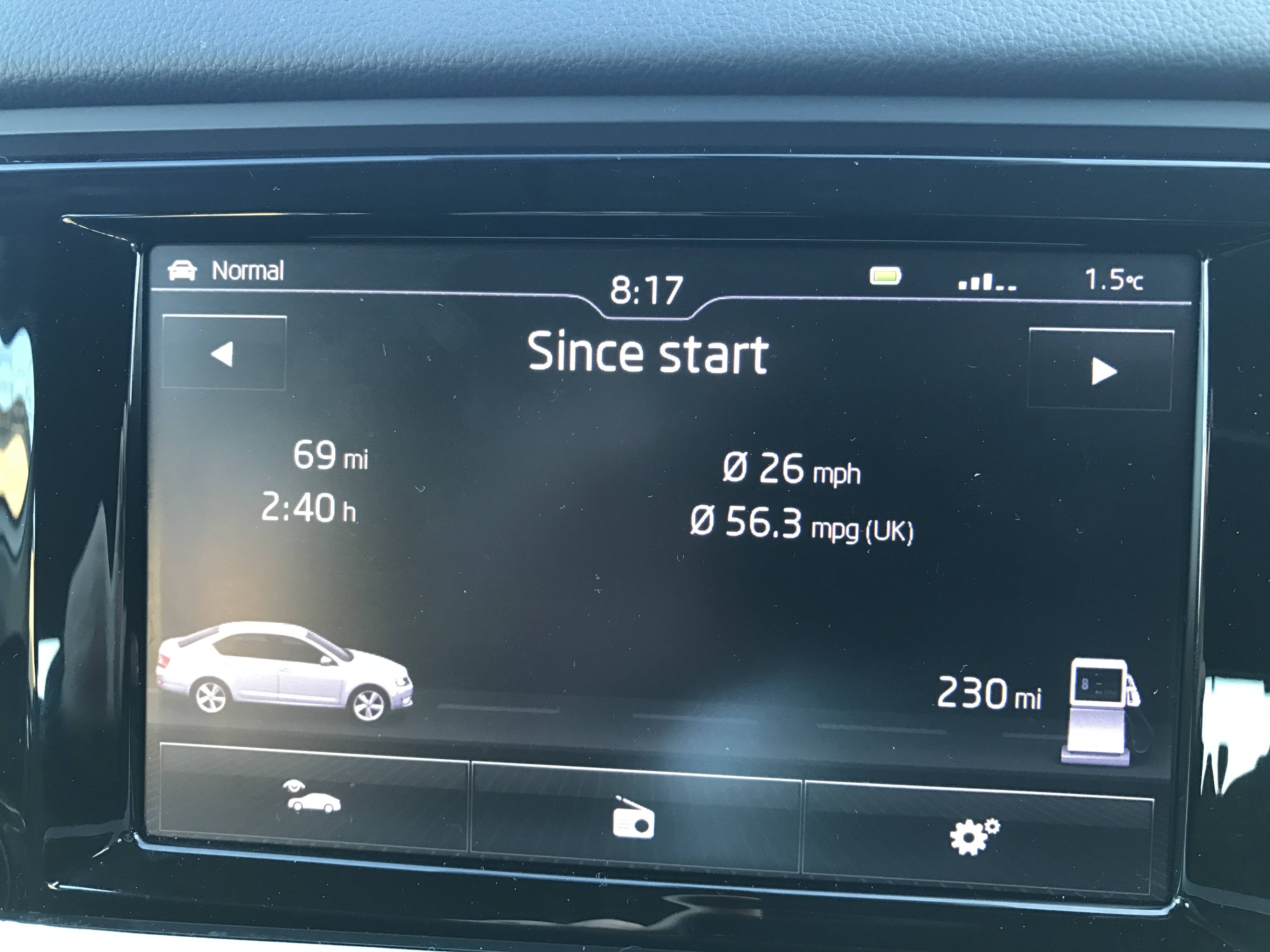

This photo shows my consumption while driving a number of journeys around town and on the motorway. The car is used for private hire so several short journeys.
Hi sneeks, What's your engine size? did you drive around City or combined?
I'm driving a 1.6tdi SE Business. Those miles were a combination of town and motorway.
