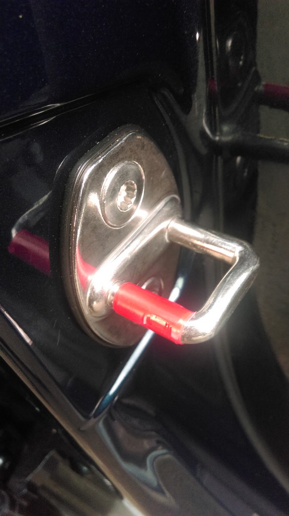

Taking the advice of others I wrapped some tape round the door latch at the same time as the glovebox taping.
I was rewarded with silence for most of the day but the rattle came back eventually.  Checking the tape it seems to quickly wear through and allows the metallic clunking to continue.  Tried it a couple of times but same result, silence for a while then back to usual.  I will take this up with the dealers I think.  I am sure I have seen cars with the door latches having a hard plastic centre core to avoid the direct metal contact.  I may give some duct tape a go as that may last longer but don't think it will be a long term solution.  Anyone else have this problem ?  Cheers
I wonder if there are any bump stops in the door opening that you can adjust to secure it more firmly? I know the boot has them.

Will check that out, didn't think to check that, will have a look later, cheers....!  Pleased I sorted the glovebox noise as that was driving me nuts lol !!

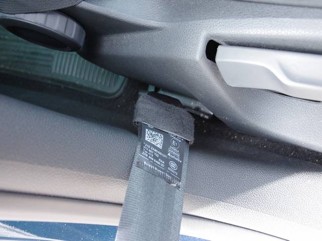

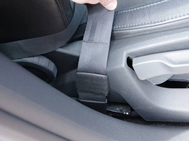

I finally cured the door rattle myself, after further investigations by the dealer which included packing the lock with white grease etc - unfortunately this didn't work and the noise continued.  Thanks to this forum I happened to find a thread talking about the seat belt rattling off the seat base and had a bit of a lightbulb moment....  Driving along, I shoved a piece of cloth down between the seat base and the belt.....I was rewarded with complete silence!!  All along the 'door rattle' has in fact been the seat belt clip gently tapping off the seat base, couldn't believe it!  Of course, it only happens when someone is sitting and belted in, therefore the clip rattles against the seat...
Having already had the wiring loom tape I wrapped a couple of turns round the plastic clip and the noise has disappeared.  I finally have a squeak and rattle free cabin which is a joy to be in !! :-)

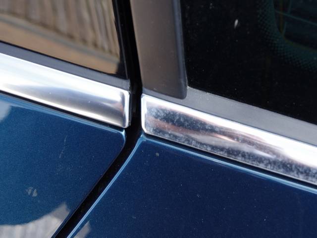

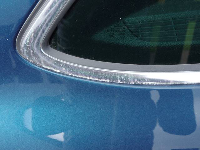

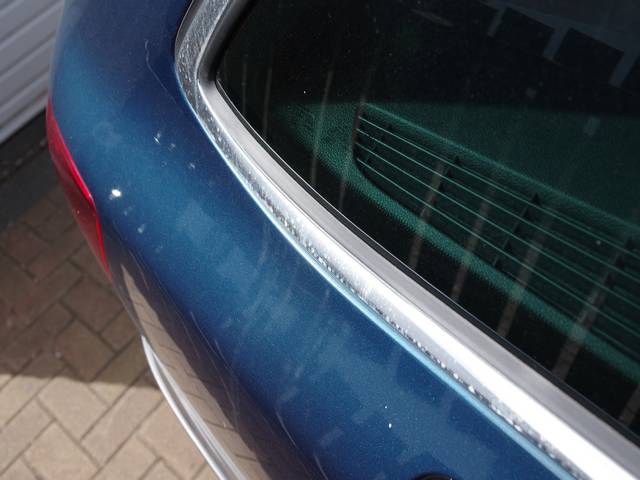

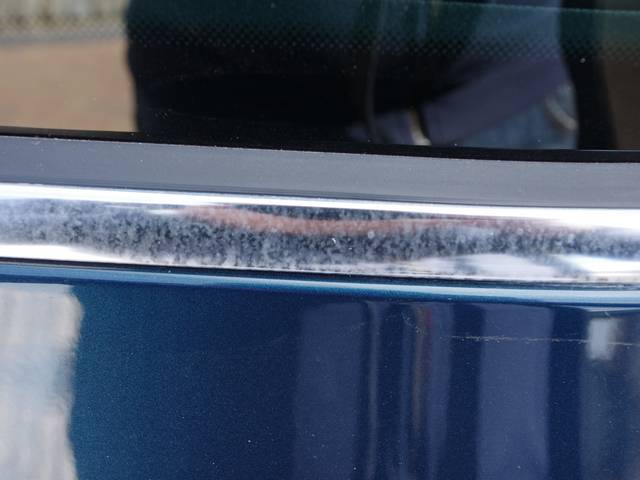

Next on the list which I hadn't mentioned before was the rear quarter chrome window trims.  I had noticed when I got the car in November signs of staining on the trim.  Had a go at cleaning/polishing to no avail.  I kept reading on here about the issues with this trim set and the chrome discolouring and having seen another Superb in the flesh with this trim almost turned white I wasn't happy to leave it while under warranty.  The dealer was excellent in reviewing the issue and confirming the fault.  I now have a new pair of rear trims fitted, which of course involves the complete replacement of the rear quarter windows.  The trims now all match as they should with no signs of staining.  The pics below are 'before' where you can compare the staining to the trim on the rear door which is unblemished.  I am very happy these have been changed over and even further impressed with the manner in which the dealer sorted the problem with no hassles whatsoever....

With ref to the tape on the door retainer , i had similar on my Octy and the service department were able to adjust the lock / retainer so didnt need to do this.

The tape on the door retainer didn't come to anything in my case, as you may have read further on the source of the noise was a plastic clip on the seat belt!  Most frustrating but the cabin has been silent ever since I sorted the various niggles with wiring loom tape...  :)
