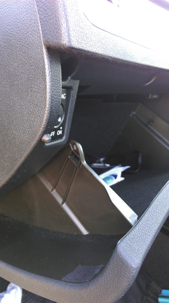

Some progress on the glovebox noise but yet to cure the issue...  I sat in the passenger side with my wife driving, the noise almost stops when you open the glove box.  I happened to give the glovebox door a shake from side to side when open and this replicated the noise!  Repeating this with the car stopped and door open you can actually see the whole side of the dash flexing which includes the removable side panel.  Where the dash fits under the rubber door strip is also moving so I think this is the source.  I am going to source some thin rubber or fabric strip and push this under the rubber door strip which will hopefully sort the squeak.  Once I have done this I will report back....:-)
Noticed another niggle this morning - a couple of pin head sized rust spots on the roof rails....I thought these were aluminium! ?  The rear quarter chrome trims also have a few white blotches.  I am aware of the issue with the discolouration so will mention when next at the dealers.
Engine rattle seems to have settled down for now.....!

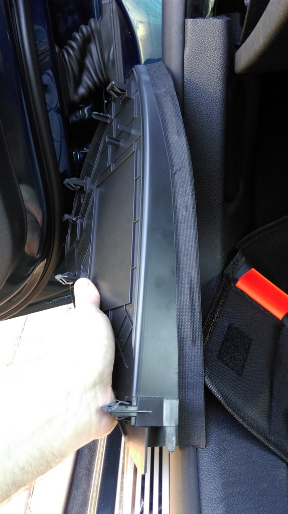

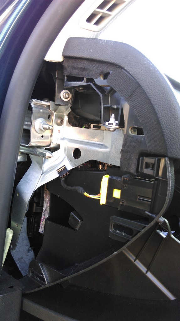

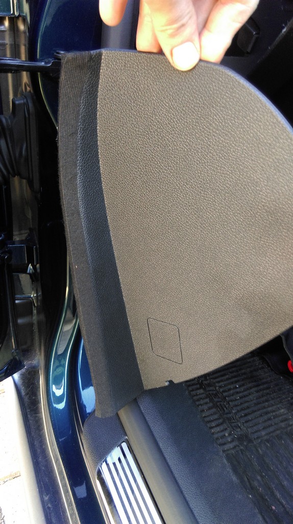

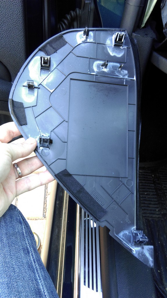

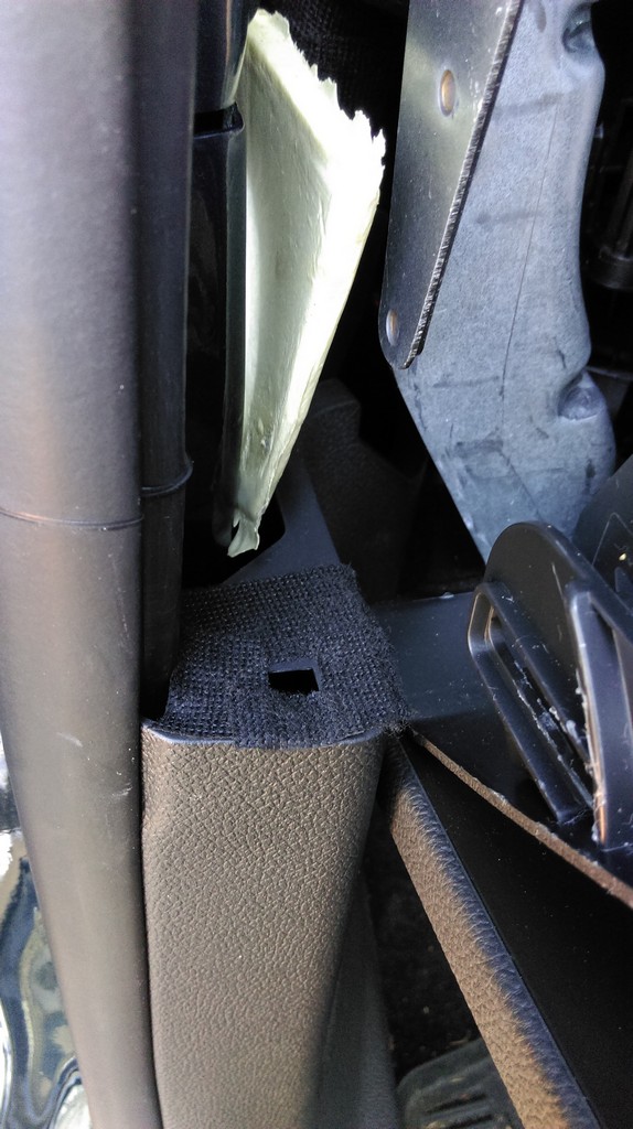

Update - Cured the glovebox noise ! :biggrin:
After finding the issue with the whole dash flexing when the glovebox door was opened, I bought some wiring loom tape from Ebay for about £2 to have a go at sorting the issue..
On Saturday I removed the side cover and applied the tape to the relevant surfaces which appears to touch or were likely to touch. The main point of contact is the section of the side cover which fits into the door rubber, this seemed to be where all the creaking was coming from.  In addition I taped the mating surface of the dash, the underside of the dash where the glovebox shuts against, and the surfaces where the rubber stops touch the door.  As belt and braces I sprayed some lithium grease on all the locating pegs/clips.  You can't really see any of the tape when everything is back together so I was pleased with my attempt.
I was rewarded with complete silence early on Sunday morning during an hour journey over a fairly bumpy road.  Normally it would have driven me bananas within a few minutes, particularly when the car was cold when the creaking was at its worse.  So far so good, the silence continues!!  I can't say for sure exactly what part of the tape has cured the problem but if you have the same issue, and repeat what I have done you will hopefully get a similar result.  The loom tape used was Tesa type and has a nice fabric finish.
Hope that was of interest......!
