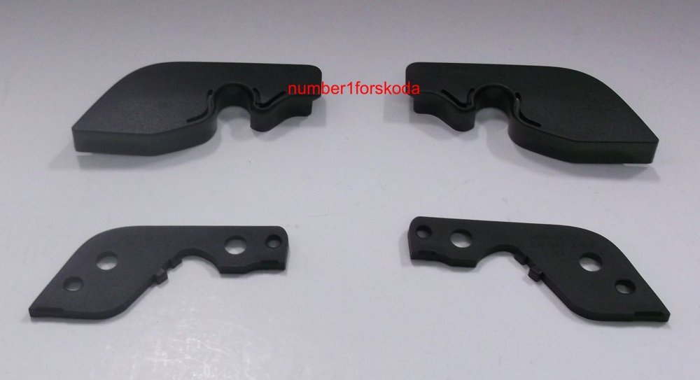

I am looking for the Part number for the retractable luggage cover to fit a 2008 Fabia Estate 1.4 tdi. It seems to be a common problem that with age they will not stay closed. Have seen sellers on ebay offering Fabia Hatchback parcel repair kits as pictured. Only £10 but not sure if this is what I need. This seems to be a cheaper fix than getting a whole new replacement cover.
If anyone has had this problem or can point me in the right direction it would be much appreciated
Not sure about the ultimate solution but those are for the hatch which has an entirely different  load cover arrangement. Id say look at where the mechanism to hold the load cover in place and see whats broken and worn.

checkout these codes
5J6 867 377 F
5J6 867 378 B
5J6 867 378 C
5J6 867 378 F
