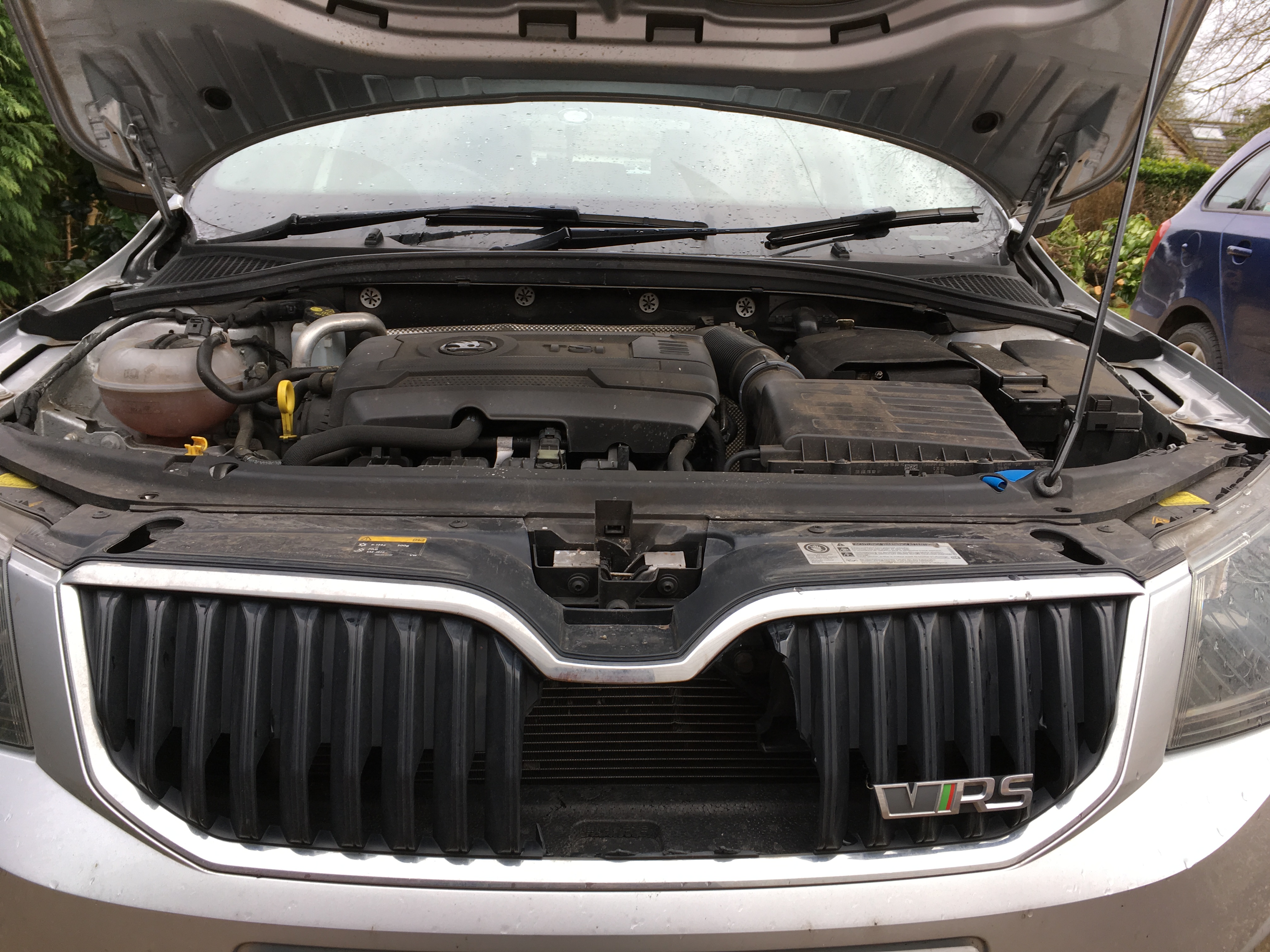

Pheasant 0 Skoda 1
Doing 60mph down an A road, pheasant appeared from nowhere and smashed the front grill, didn't have time avoid it unfortunately.
I'm assuming this part is fairly easy to replace?
Found a few similar threads, crap! I'll see if I can get hold of the grill and replace myself, f**k paying Skoda to replace the whole front end :angry:
Might as well give the engine bay a nice spruce up too ;)

You might be lucky on eBay. Or fit the Superskoda one.
Is pheasant for sale?
Good luck. I was in a similar situation to you, albeit with a deer.
Skoda rather wisely decided to change the removable grill to a fully integrated plastic welded one sometime in 2015. Plonkers.
I was lucky, found a pre-2015 grill with the Scout badge on eBay that a local body shop was able to properly attach back to the intact bumper.

I am going to call Skoda this morning to see if they sell the grill separate, I think I know the answer already. Yep, comes as part of the front bumper, £380 unpainted!

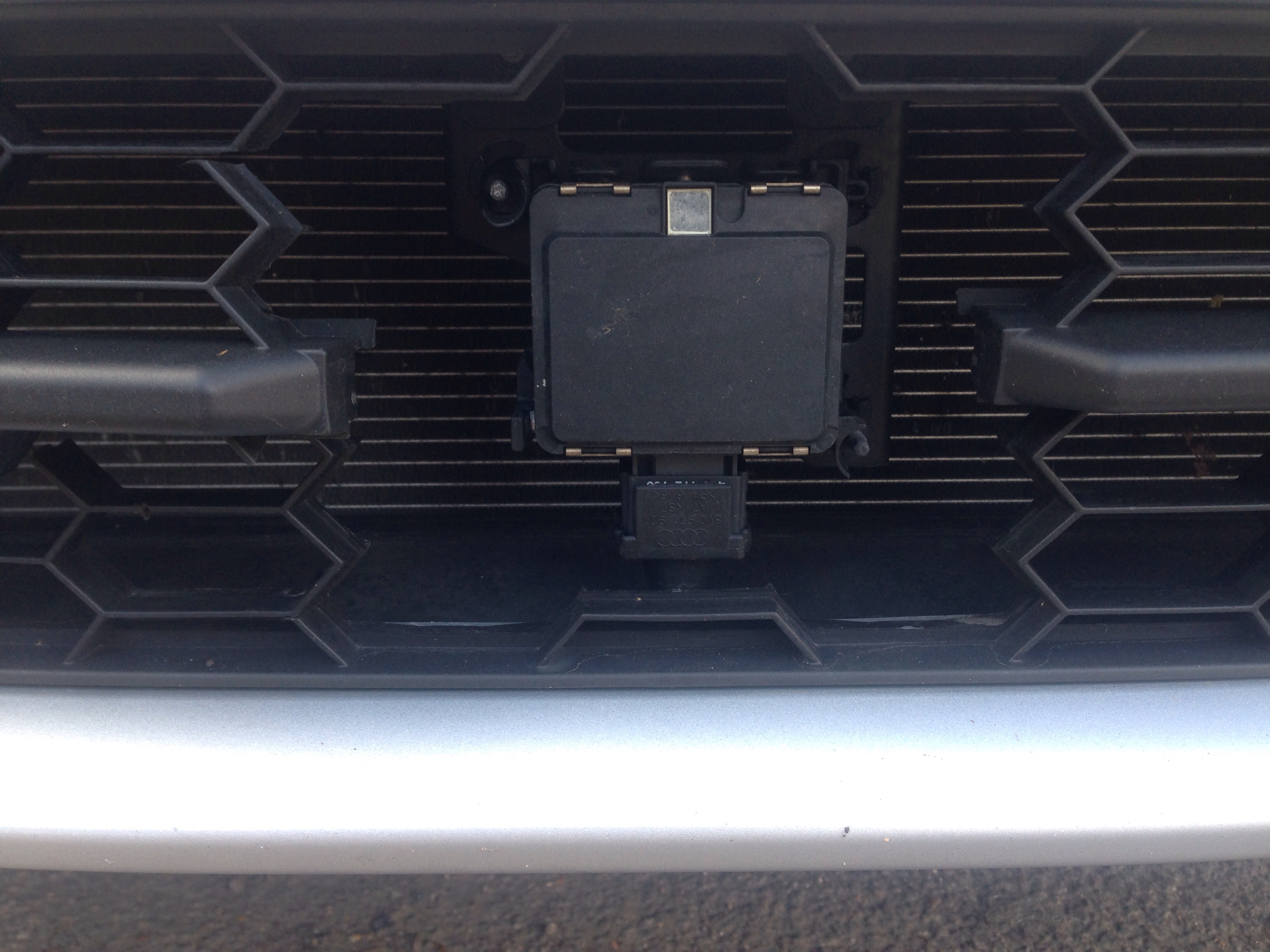

I would dearly like to find the above funny but as last Thursday a pheasant ran out on the A1 while I was doing 70, I now have an Estate with a missing ACC cover, smashed lower grille and numerous errors on scanning ACC at dealers.
Anyone got suitable lowe grills and ACC cover knocking about?
Dealers tell me they don't have equipment to test / reset ACC radar, will ODB2 do it?
Vent grill for vehicles with ACC: 5E0853677 G or 5E0853677 H (VRS)
Trim for models with ACC: 5E0853631 or 5E0853631 A (VRS)
Repair set for radar sensor: 5G0998561
I had the same accident with mine when it was 3 weeks old. I just bought the parts above at my Skoda dealer and had them to fit it. My radar sensor was loose but the sensor was OK, and after they fitted new clips (repair set) it start to work again without any adjustment. It cost me about 160 £, parts and work included.
It is very easy to do this your self and see if the errors dissapear
