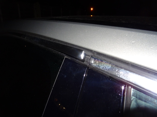

I think I mentioned this in passing recently, in a reply to someone else's thread. I got sick of the chrome window trim peeling back away from the car, especially at high speed and when opening the driver's door (the trims overlap front:rear and pull at each other). I gave up waiting for the first service, and booked it in for warranty work this week. I explained to the service desk over the phone that it's the chrome trim on the offside doors. I also explained there is a service campaign for it (they seemed shocked I knew this).
After arriving at the dealer yesterday, my job sheet had a big red stamp at the top saying RECALL ACTION, and a handwritten code/reference next to it. It was listed as 'window surround', so I made doubly sure they were clear and it was the same job. Yes, I was told, it's the chrome trim surrounding the doors coming loose and overlapping. Six hours later I got the car back, returned their courtesy car. Talking of which, I'm happy to say that the 1.2 TSI 110ps Rapid with the 6 speed MT is a nice little motor indeed for what it is. It's bigger inside than you'd think, and actually very nice to drive (not direct/full of feedback, but a nice runaround that beats the usual Fabia courtesy). It pulled hard low down and carried on pulling to about 4,500rpm so it was pretty fun to wind out to 6k rpm, and also easy to rev match neatly on downshifts. God I've missed having a manual! The suspension is also much comfier and quieter than my Superb's, by a country mile; go figure. That really shocked me. Larger tyre sidewall perhaps.
Anyway... Fast forward to today and I use the car for the first time. The chrome trim on the offside doors pops off. AGAIN. On closer inspection the trims and rubber seals still both overlap also. :dull:  So it looks like a call and re-book is on the cards tomorrow, with likely yet another three week wait for the courtesy car to become available. To the point of the thread:

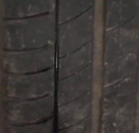

BTW replying to Sagalout reminded me of the useless video they sent me. "Your front tyres are at 5mm and your rear tyres are at 7mm." Yes, I know - I check them every week because I like staying alive... I appreciate not everyone else does, and I only say it's a useless video because it told me the tyre tread depths and brake pad wear (10% wear after 8k and almost a year), yet it didn't mention a single one of the six jobs it went in for! Anyway, the video is grainy and each tyre is only on screen for about two seconds, yet I still managed to spot this:
How come they didn't when it was on the ramps right in front of them? You'd imagine if they'd seen it they'd have removed it before shooting the video! Ho hum another little job for tomorrow, before it works its way into the rubber! It just makes one ponder the quality of the workmanship when service campaigns are returned to you in the same state they were beforehand, and they can apparently miss blatant stuff like this.

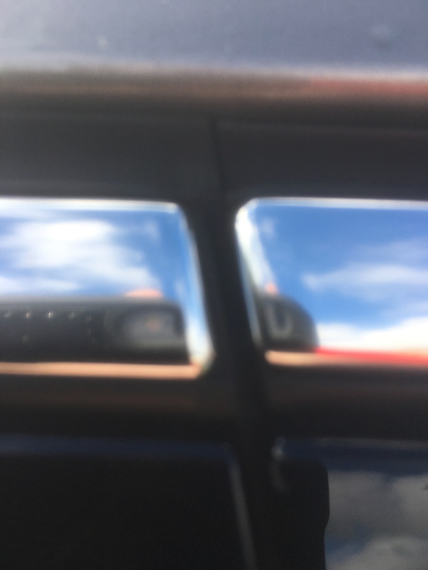

The only pre-repair picture I took was a night picture just showing the flapping trim...

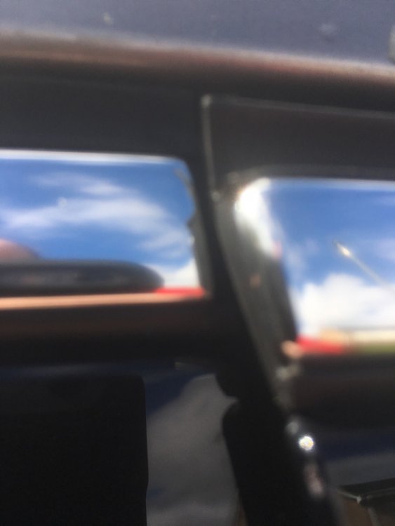

After repair showing door closed - and I apologise for the poor quality as I used a phone camera...
and ajar...
The rubber trim of the front door should barely clear that of the rear door.
I hope this helps!
