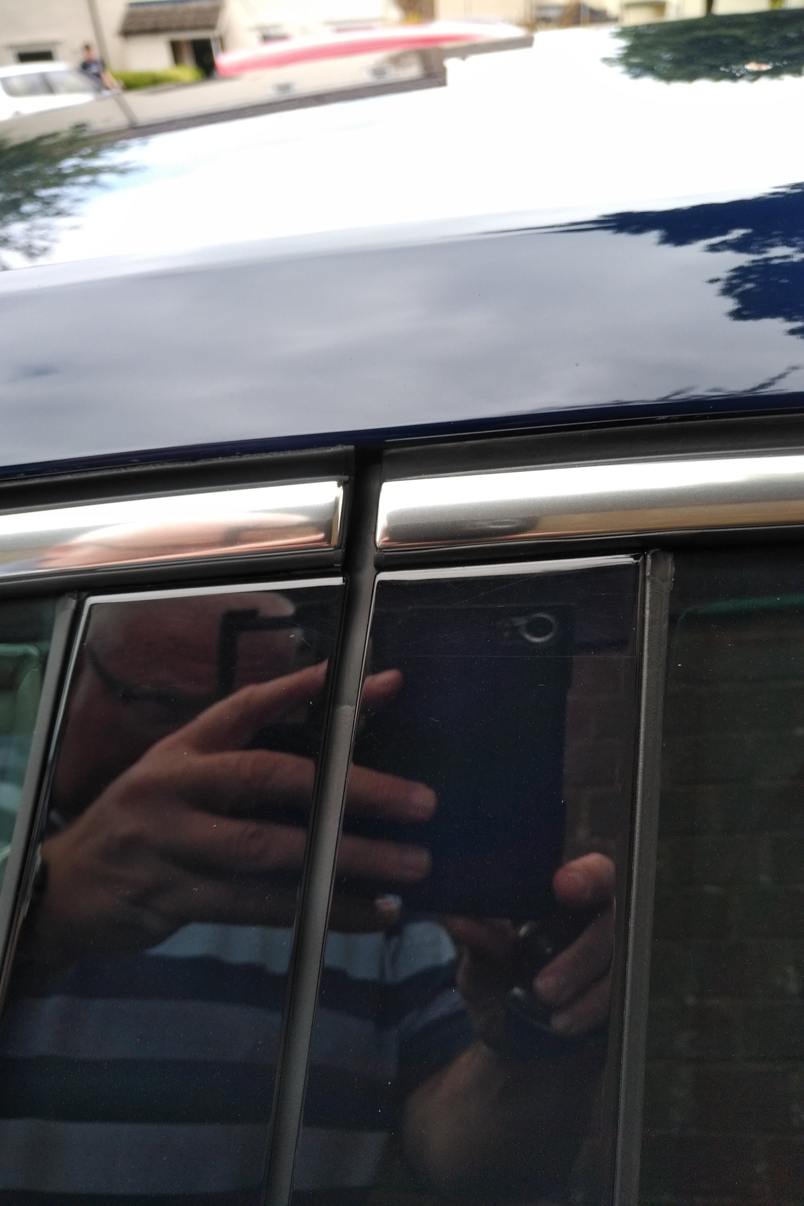

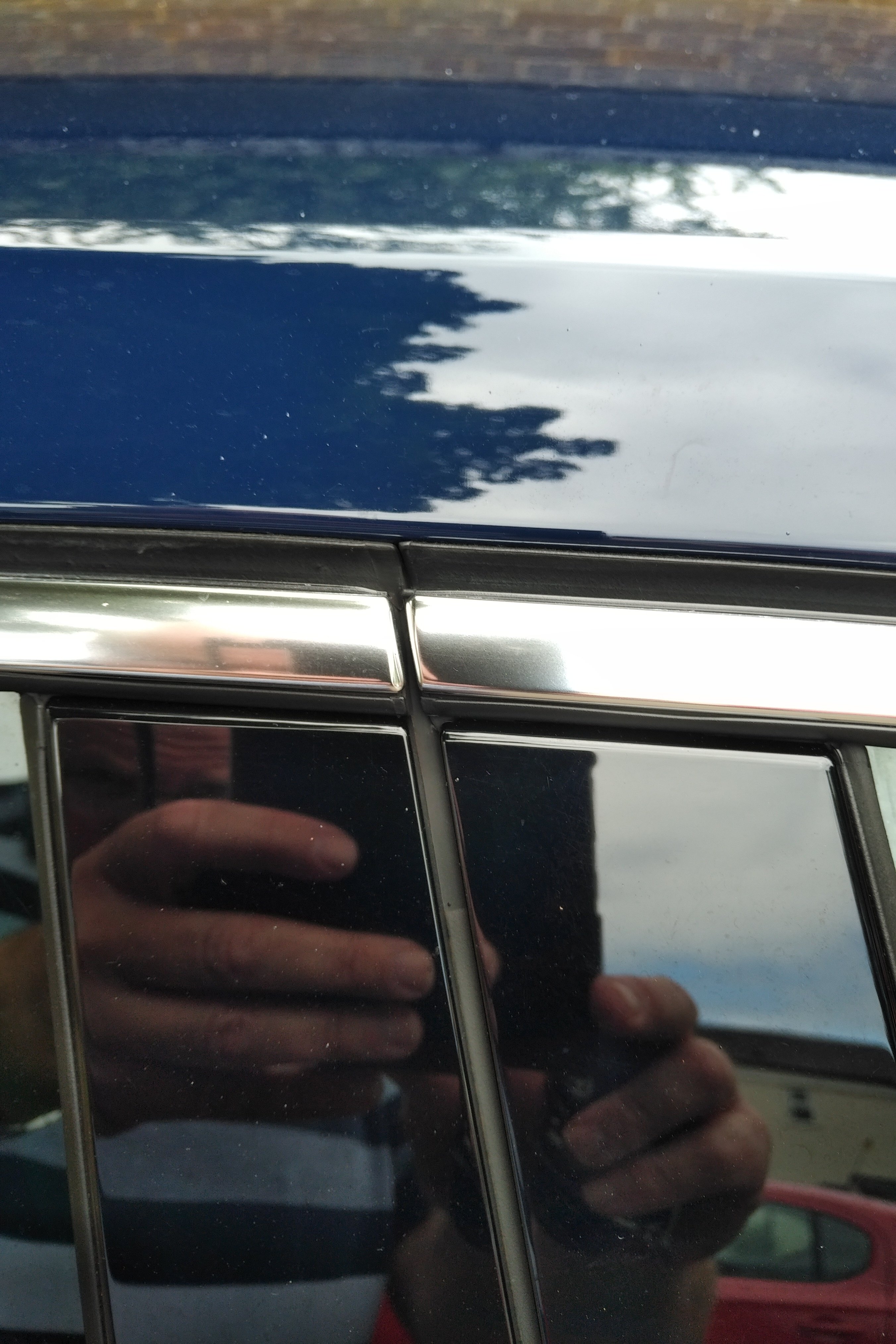

Hi There.  So, same issue for me but only on passenger side.  When I first saw it the trim sticking out I thought that someone had tried to break into car.  Anyway, after several attempts at pushing it back in, it always popped out again.  Eventually I had to stick it down with tape.  Anyway, service was due and mentioned it when I dropped car off, dealer (Silbury in Cramlington) said they would have a look, which they did.  Needs a new door seal and trim was answer.  Under warranty I asked and after a very short discussion amongst themselves they said yes.  Car was booked in and sorted a few days later, took about 90 minutes.  Cant fault the service at all, no arguments or debate, with me anyway.  Photographs show nearside now with a much larger gap when compared to the offside, which I've had no bother with.

On our 2016 Superb it's being replaced for the 2nd time.
This is an installation problem as the driver side was done for the 2nd time by a high quality panel beater repair shop and has never moved again. While the 1st time was done by the dealer ship. Unfortunate for warranty reasons, the dealer ship has to do the work on the passenger side (both front and back). They just ordered the chrome strips and we had to point out that the rubbers need replacing as well, due to them being the real problem. It's the rubbers that creep past the vertical door edge if not installed properly.
I put my money on it that I will have to replace them again in a year or so as the dealers aren't experts in chassis/trim work.
