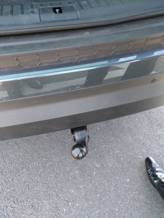

I test drove the 1.4 TSi 150 manual 4X4 Edition model that had a towbar.
I ordered the 2.0 SEL 150 TDI 4x4 manual. I was told if I want the tow bar I had to have an automatic.

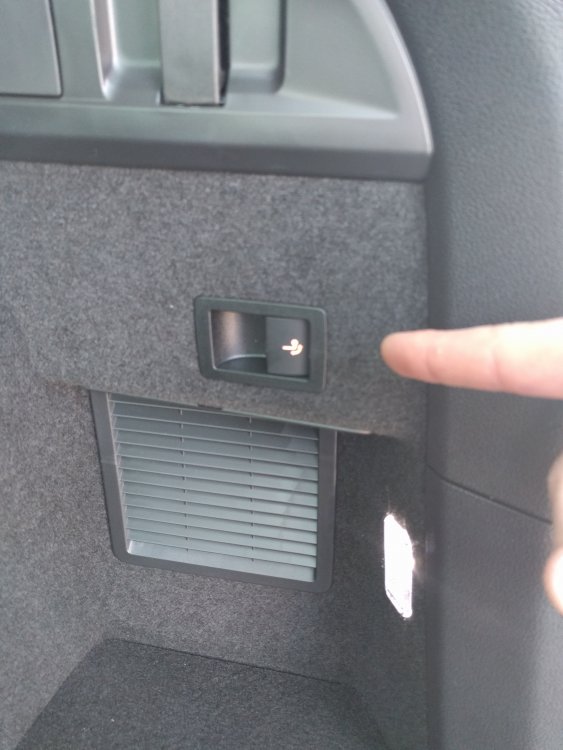

Short video of the towbar release:

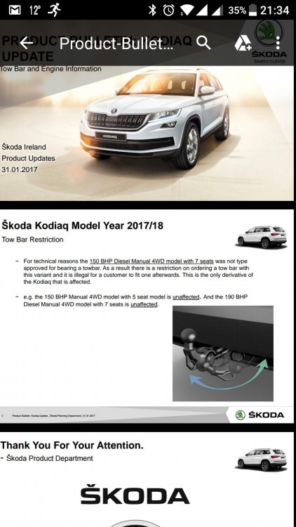

See the product bulletin issued by Skoda Ireland below - I saw it in a thread here: Kodiaq Tow Bar Product Bulletin for 150PS Manual
That sounds pretty ridiculous to me, I would just love to see the reason for that restriction. I once had a Isuzu Trooper 4WD, petrol 2.6, 9-seater with 4 wheel discs - which had a lower max. permissible  towing weight than the earlier model with rear drum brakes, but I struggle to understand how the Kodiaq DSG can tow whereas the same model with a manual box cannot.
1/Because they haven't Type Approved it. See the other "pinned" thread.
2/Because I suspect that having both the extra rear seats and the tow bar could exceed the stated permitted rear axle weight limit.
