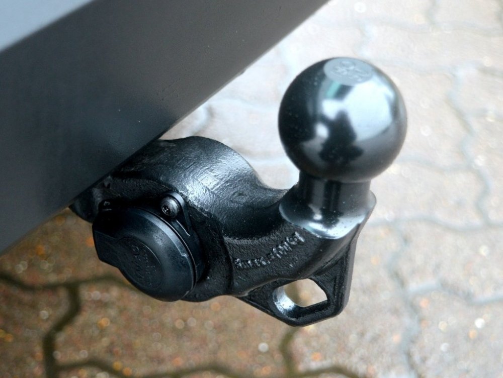

Hi all I am new to this and I have just bought the Skoda kodiaq 2.0dsg 4x4 190ps is my car ok to tow I am literally going to headlys tow bars on Tuesday to get one fitted when I spoke to Dereck Slacks they said if I got one from the ie the only one they do the folding one they had to change air intake parts. Will I have to do the same if I go elsewhere.

Hi guys it has happened again. When I put my car in reverse my blind spot and rear assist disables it's self just as if I had my caravan on but it's not does anyone know how to over come this problem I had it back to headlys towbar once they fixed it but now it has started again..
Also does the Skoda kodiaq dsg 4x4 need the coolant system updated coz I had a swan neck fitted but not by Skoda
You've got to keep taking it back. Let the dealer know too each time you are inconvenienced by taking it back, after all it was the dealers choice of tow bar fitter right? If so then they need to help here too.
The additional cooling system requirements relate to the 1.4 TSI petrol engines only. Your diesel should not be affected. This isn't 100% confirmed though, it is information I have gathered through this and other forums, feel free to reach out to Skoda UK and ask too.
