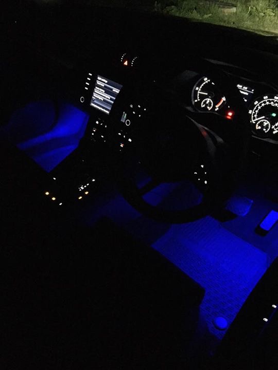

image.jpeg.5f66e3f705a123b632a733a47b9a253e.jpegMy DIY ambient lighting.
imageproxy.php?img=&key=66c1d7df650950da
Edited by Jaytip
I have no idea why I have a duplicate photo in the post above. Tried editing it out but it only shows me having uploaded two photos. Strange.
