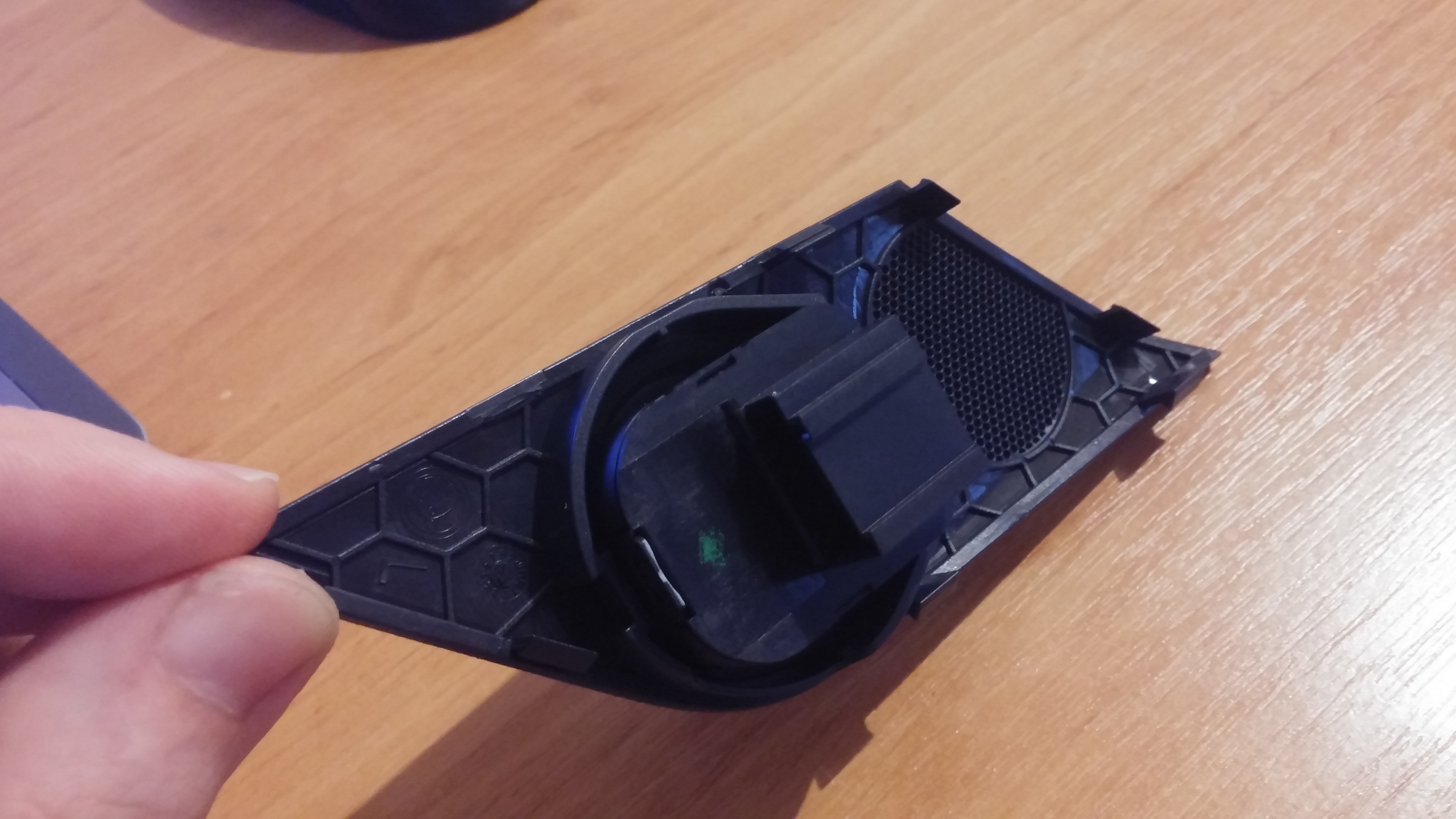

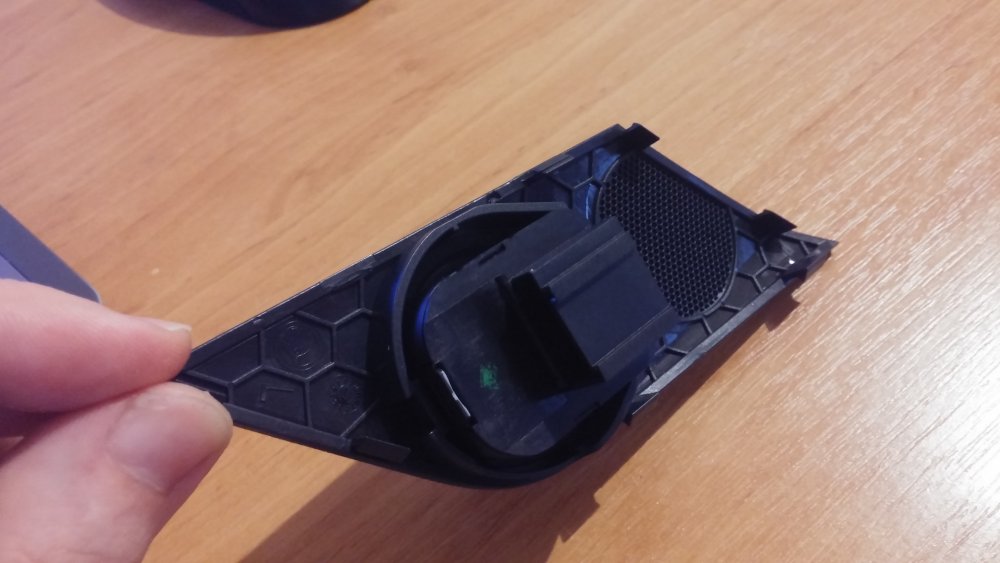

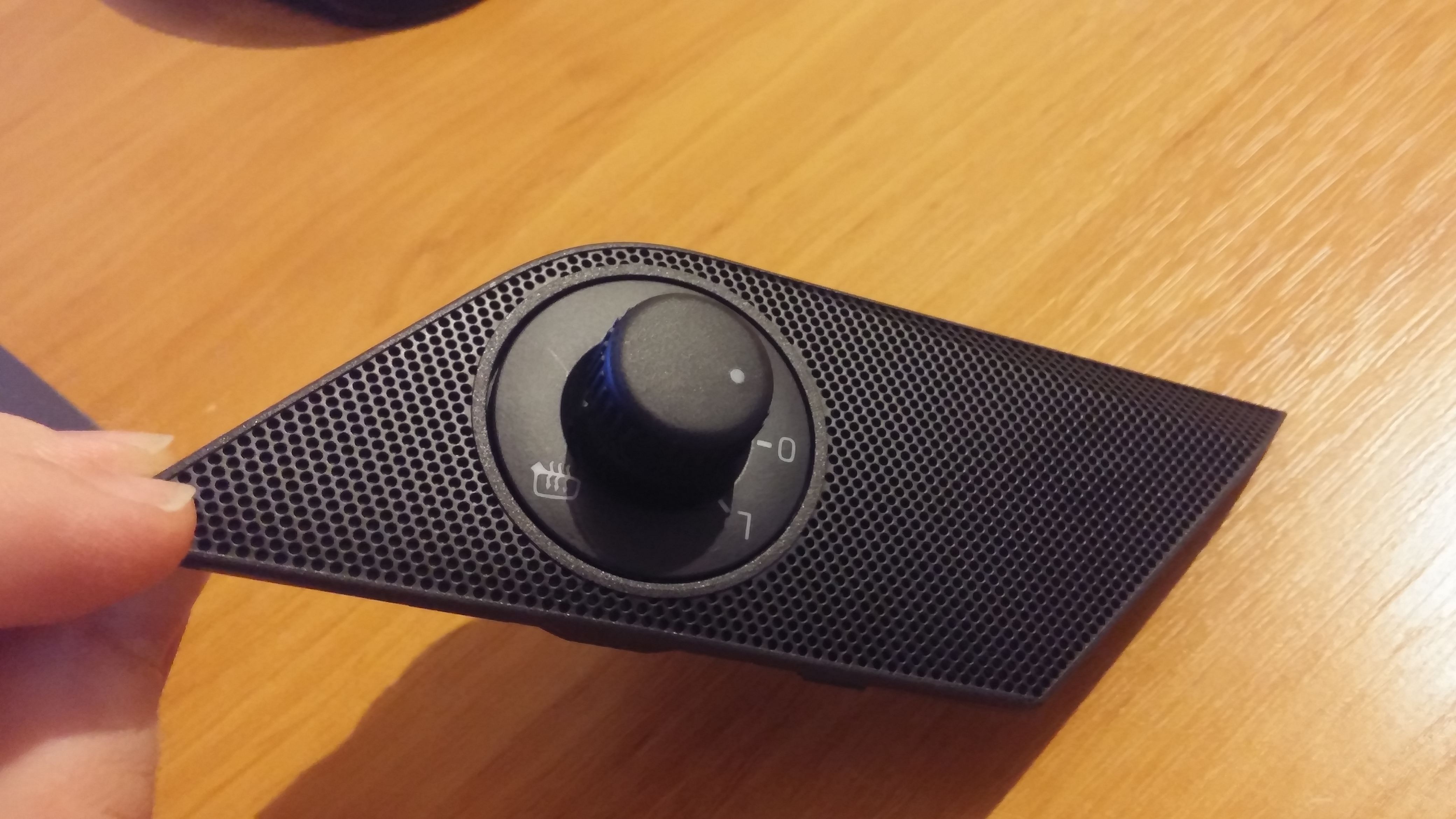

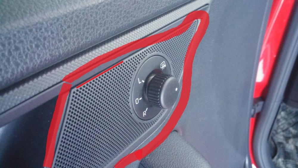

you must use old credit card and insert it in to space around speaker
or here some photos :)
20170420_175113.thumb.jpg.abebc1d08e480295c78cbd8ede9253f7.jpg20170420_175117.thumb.jpg.b29bbe531624d9266dff5272e03cb481.jpg
