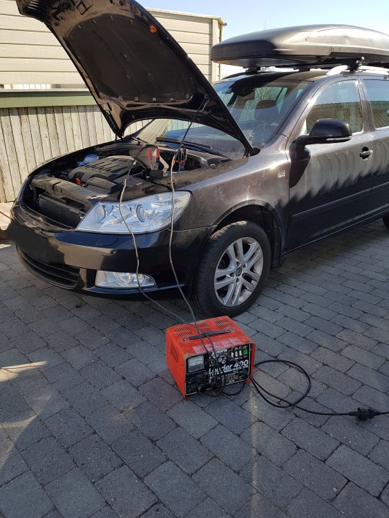

Charging battery...
Edited by Lindeman
Here it is...
