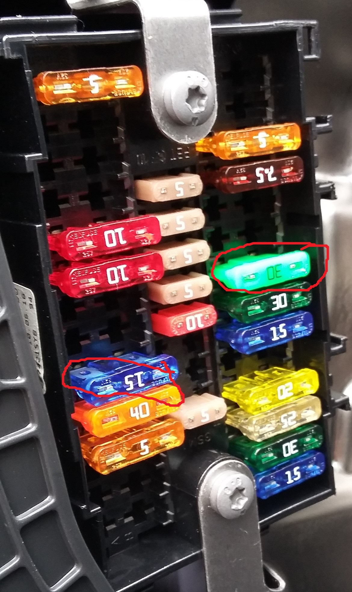

Zoto camera arrived today did a quick test quality looks good.  Got the hard wire kit and piggy back fuse all installed (rear wiper fuse, made sure by removing the fuse and trying the wiper)  just need to know what fuse rating to put in the piggyback fuse any suggestions please?
Is there not a power specification in the manual or on the camera somewhere?
I'd have thought it would not need anything beefier than a 2A - 5A.
Thanks Urrell, now why didn't I think of that! It says 5v 1 amp!  So 2A I think would be ok.

On 04/05/2017 at 07:54, TeeDeeEye said:
Just done mine using a Nexbase 312Gw took about 30 mins. Next base is a very good dash cam with a great mount and hard wire kit to piggy back in the fuse box. I've fitted in a few different cars and the yeti is the easiest because the fuse box is so close. Mount as stated in the other replies. If you don't fancy doing it yourself Halfords will fit it cheaply while you wait.
How are you getting on with the nextbase 312gw as this is the one I'm considering for my yeti .. saw footage from a friends nextbase112 and that looked good so hopefully the 312gw will be good to
Yes perfect, put same in an old fabia with no bother. Now got three cars with this model in the household, also previously had them in a Focus and a Peugeot 107 as well. Very satisfied with fit, use and quality of dash cam and footage.
Thanks .. Which fuse did you piggyback off .as don't want to piggyback off the accessories socket as they appear to be permanent live
Most people seem to use the rear wiper supply fuse for the piggyback.
I've used the 12v/cig lighter socket fuse which is permanently live for the dashcam, so I can leave it on when required (i.e. car parks etc).
Used the rear wiper (switched live) fuse for the reverse camera/mirror display and phone/sat nav. (only got the basic S model 1.2TSI)
ps. used the bulkhead torx screw as the earth point as couldn't get my spanners in to undo the 13mm nut.

So I like the idea of piggy backing off a fuse in the box, but does that not put to much load on that wire when using both the camera and the device it's piggy backed to?
Being how manufactures as so tight these days, I would think the wire is barely enough to cope with it's original load.
Almost negligible extra load.
My BlackVue is rated 4 Watts, which is equivalent to 0.3 Amp
