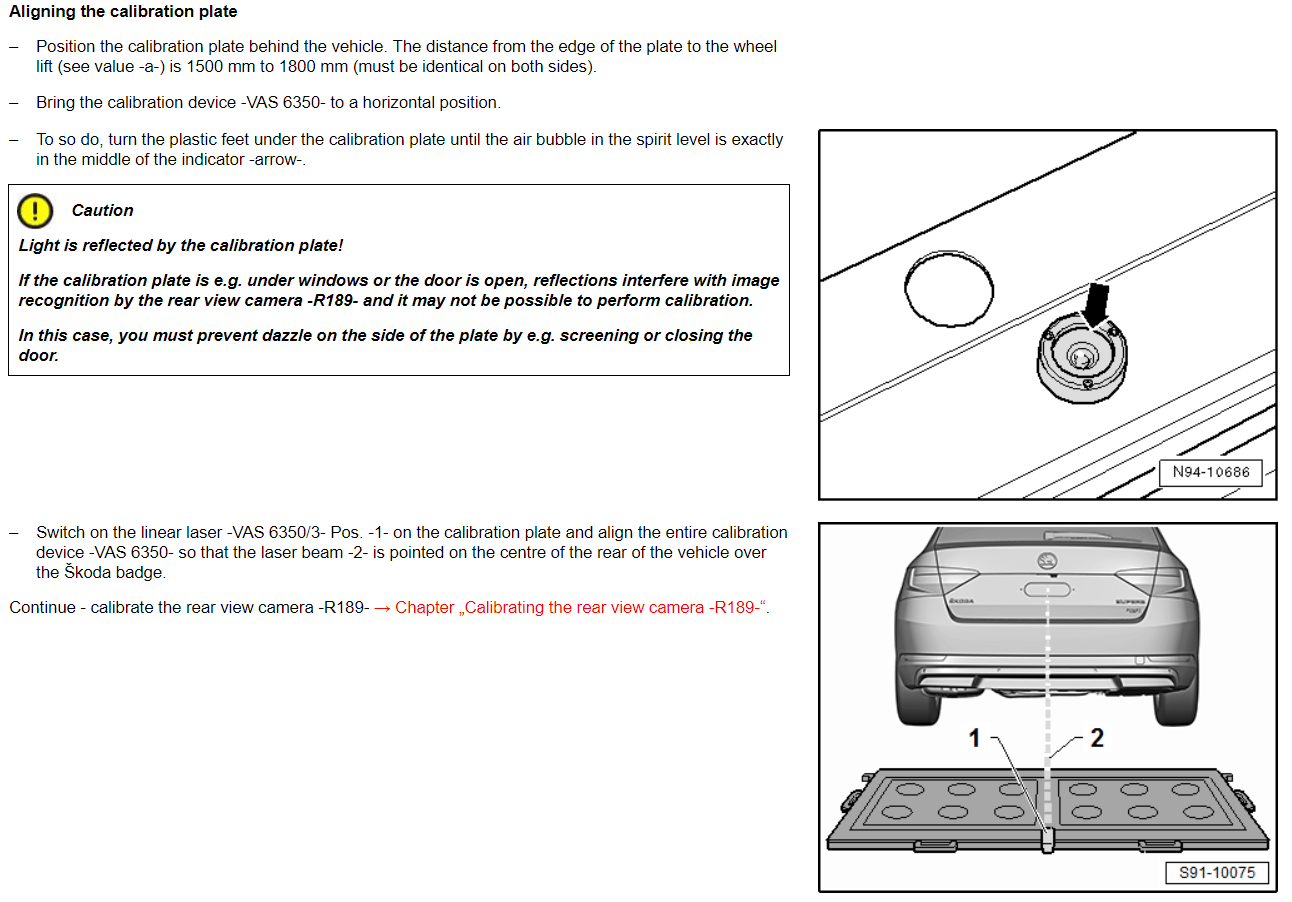

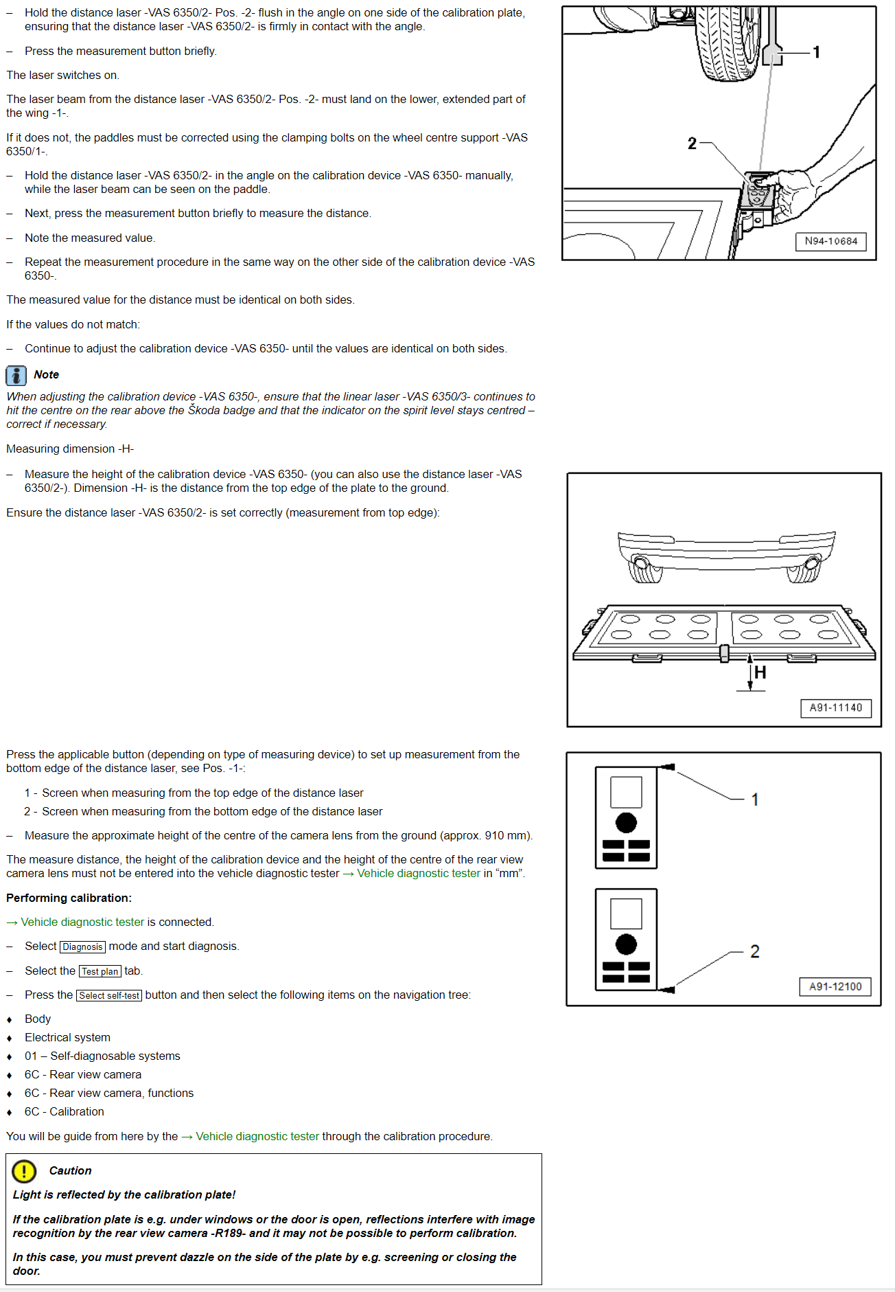

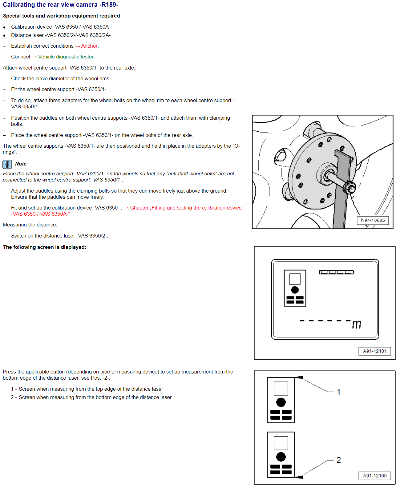

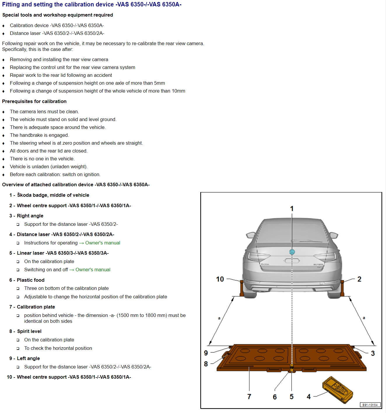

Local dealer quoted 369 for three hours of fitting and two hours of calibration.   The calibration kit is available to them on hire (Or you can buy for a grand and a half ;-) at some point next month.   Dealer insisted that calibration was essential and part of the install job.   I do wonder how they do this in the factory?  When you look at the calibration notes it talks of measuring distances, wheelbase, etc which seems nonsense when the car has fixed mounting location and one would expect they flash a standard calibration into it and not faff around (Cant imagine there's a special calibration process in factory due to the low volume?).   All in all its an expensive add-on but my wife only has accidents going in reverse so it will hopefully pay for itself in the longrun :-D

As mentioned earlier, my camera was not calibrated. And apart from a fault when scanning with VCDS everything was perfectly fine.
Yeah, that's what I initially thought would be the case - the camera would have some element of preset calibration out of the box because its model number is for a specific vehicle.  The dealer was adamant that calibration was a necessary part of the installation and a two hour process.  The price was such that it was only 60 quid for the calibration when compared just to the pure install costs from the other dealers in the area so figured it was worth the expense and I couldn't argue from experience against the 'expert'.  The install would also be properly warranted so another aspect to consider.
This is the calibration procedure for those interested.    I did wonder if it was possible to just print and layout the exact same pattern as the calibration board and the onboard cal routine would detect the pattern?
