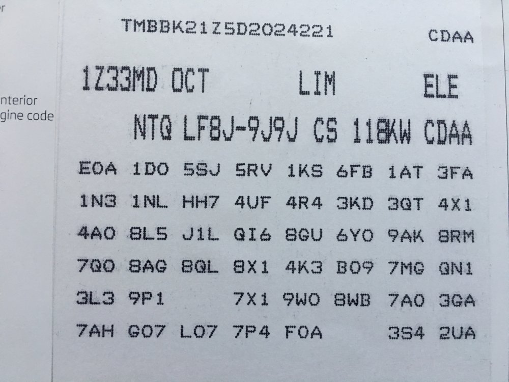

Below are pictures of the VIN plate and the radio software screen etc if it helps at all.    But if there is any other info you need in able to assist me, please ask.   I can extract codes from the ECU, as I have a CARISTA OBD2 Dongle and APP. If there are any you need.

None of the Bolero units have Bluetooth I'm afraid. The one's you've seen showing a Bluetooth option will have been fitted in a car which has Bluetooth fitted to it (a separate unit usually under the drivers seat).
The only OEM head unit with Bluetooth is the Amundsen+ unit, and only some of those have the Bluetooth unit inside them. So if you buy one, make sure you get one which has Bluetooth. You'll also get sat nav, and possibly DAB as well (under the same restrictions that the Bluetooth is, some have DAB and some don't).
