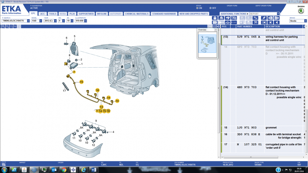

Thanks Wardy, they do have individual sensors. Tricky part will be identifying the part number. Is there an online resource for this?
If you email [email protected] and provide your VIN and what you're after, they should be able to confirm what is required in ETKA for you.
And they might also be able to provide that part as well. But worth checking a few places, for pricing.
I've found it usually works out cheaper obtaining bits from the EU suppliers, even taking into account a bit more in shipping.
You should get something like this back.
