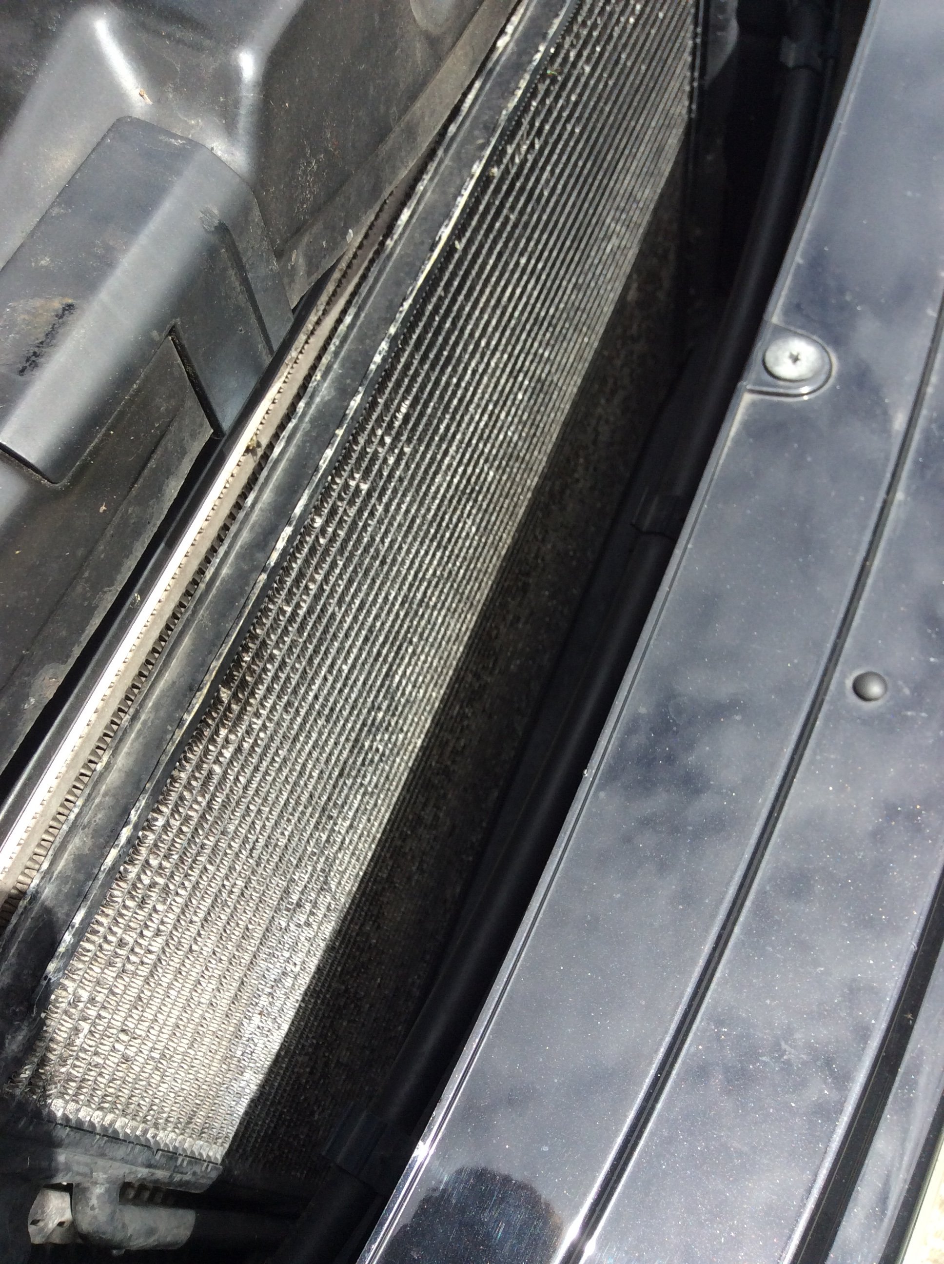

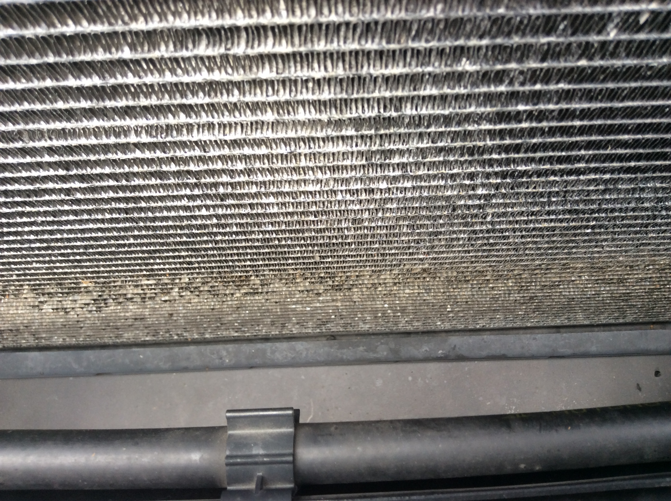

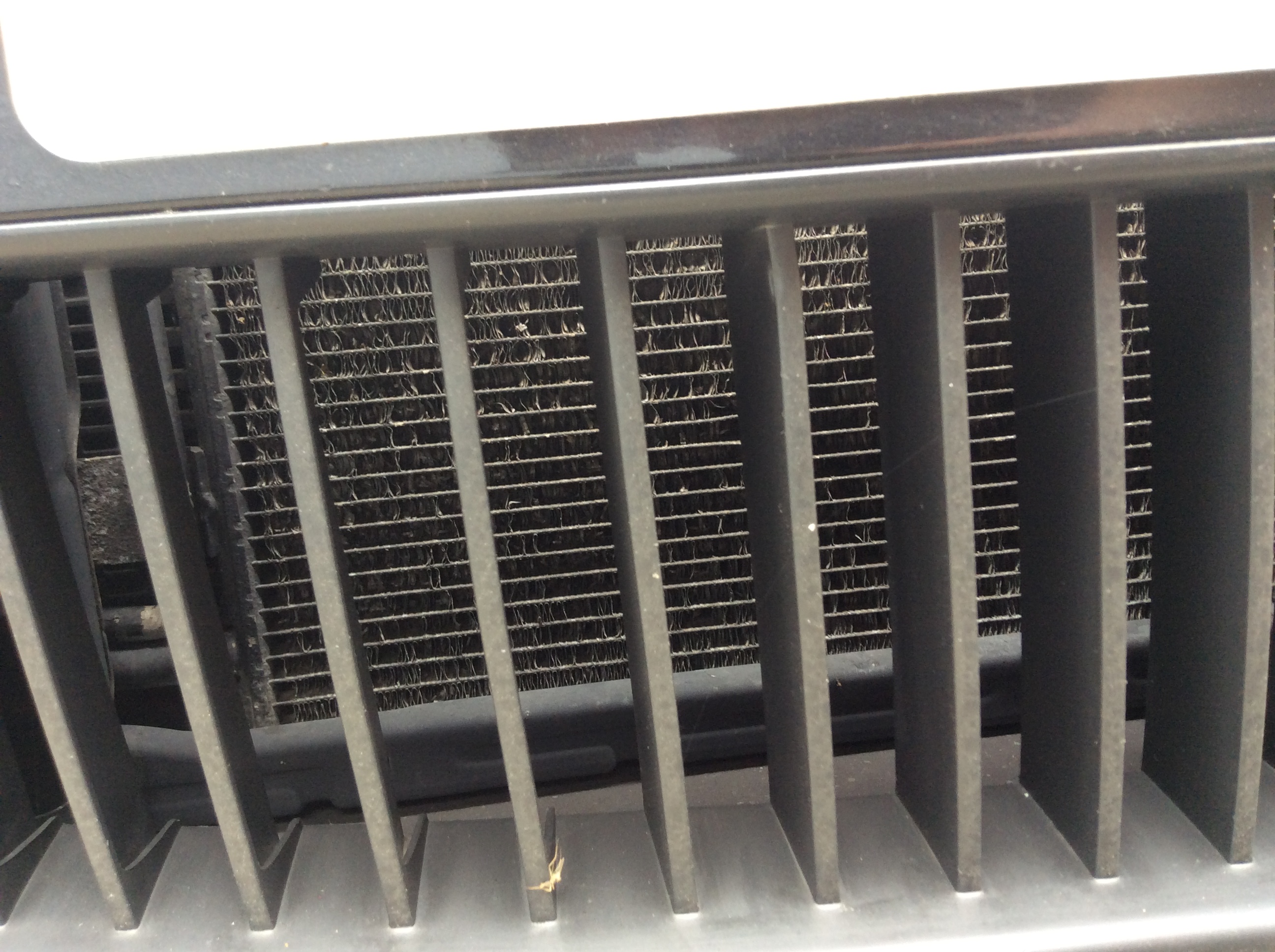

Pin holes in the condenser are common as this is the "radiator" at the front behind the grill. Low refrigerant shows up as cold air only on the drivers side, which you had. Best cure is to take it to a air-con specialist and likely they will fix it with one visit at lower cost than garages.
As the external grill is just a series of open bars, many of us on here have fitted a plastic net behind the grill to catch stones before they damage the condenser. When I did mine I found not only many strikes on the condenser but also 5mm+ pieces of concrete on the plastic shelf beneath.

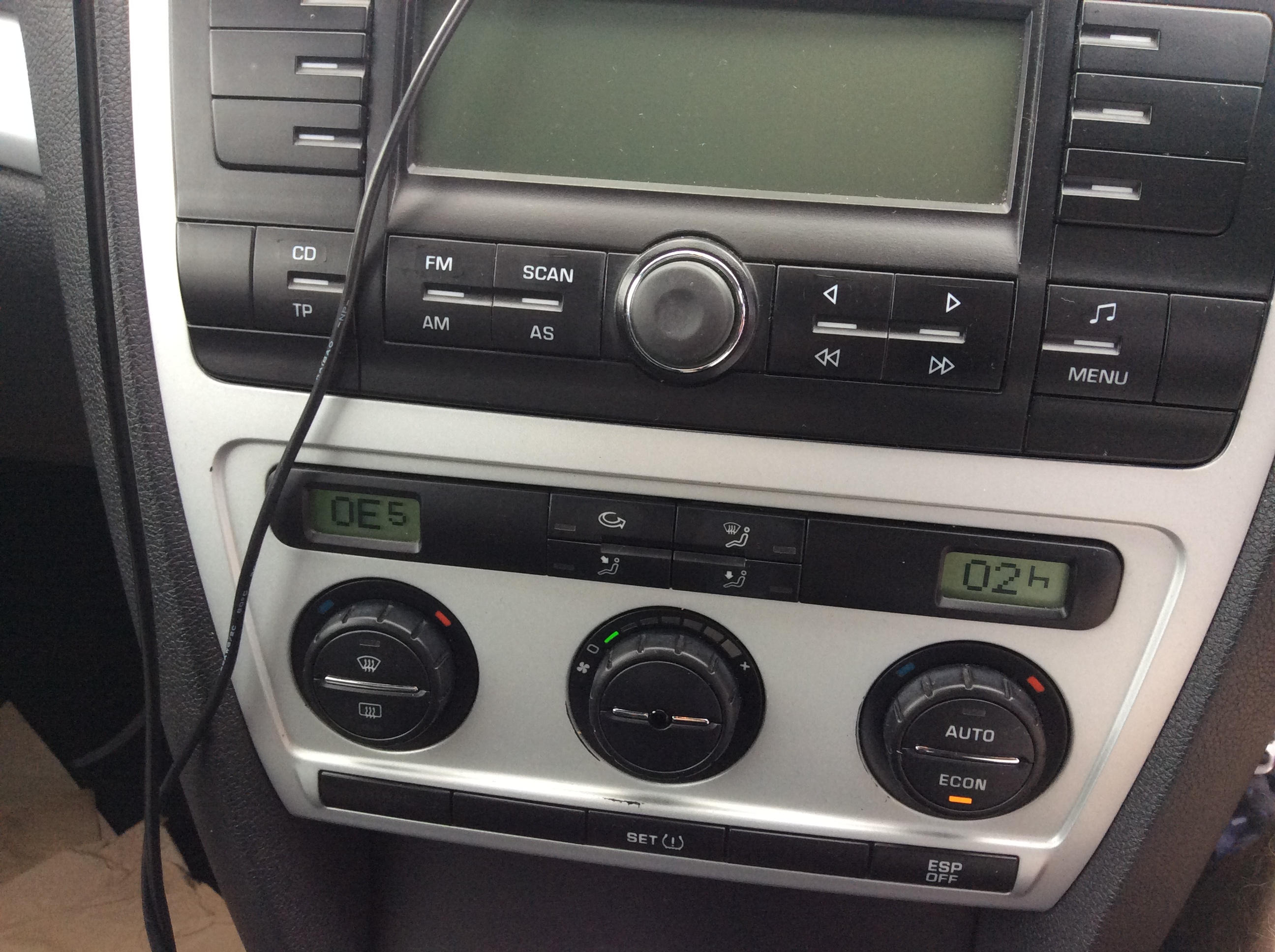

Update just, ran a self diagnostic and got the error code 0E5 02h, can anyone shed light on this code?

I'd say this could be the culprit of the fault as it's seen better days from stone chips (condenser)
The h after the number means it is a hexadecimal number. Converting to decimal, 0E502h is 58626.
Normally one can get full information by putting the decimal number in the Ross-Tech search engine but this time it is not recognised, probably because it is not a car fault as in engine or electronics.
However, a quick search shows the two sets of numbers may be independent. It shows that code 0E5 in hex, 229 in decimal, is coolant pressure but that may be a red herring. I will leave you to do further searches.
Yea checked it and it was flagged as coolant use referring to gas level, it may due to the condenser being in such a bad shape it could be leaking
