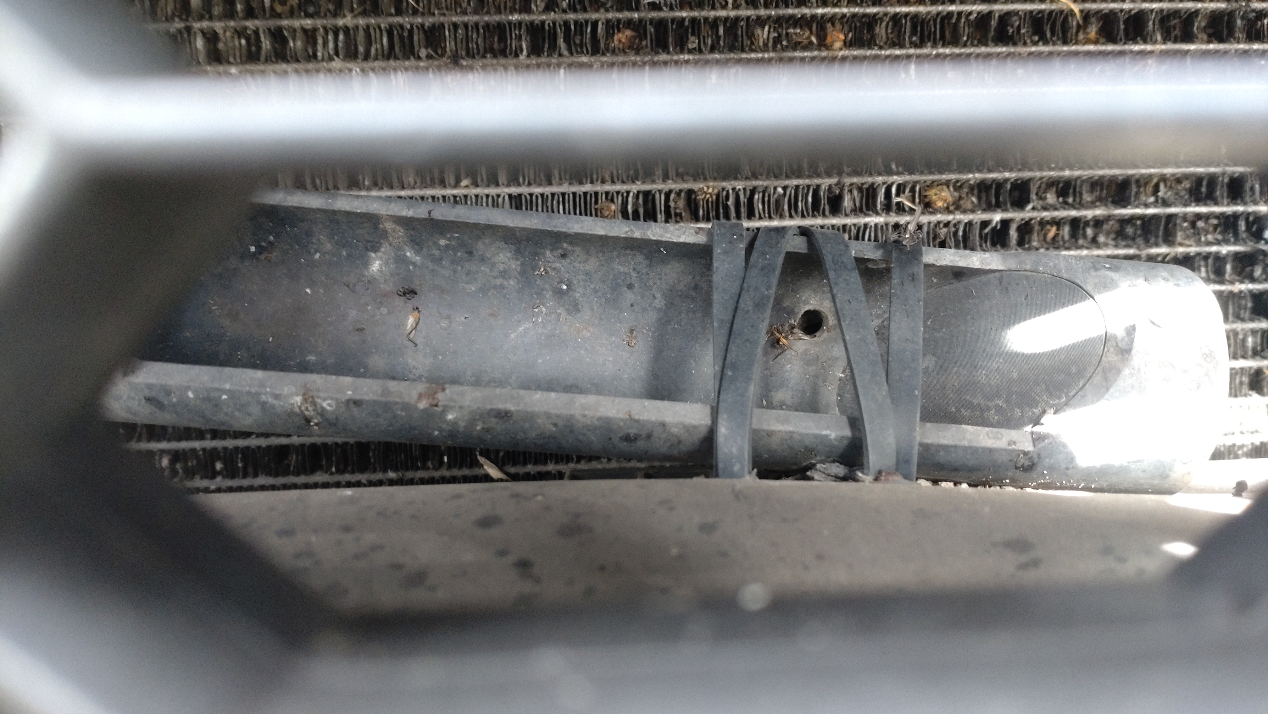

Anyone know what this might be for?
Hi guys, as the title states.
I only noticed this tube thing in behind the lower grille, in front of the cooling pack after I got the car. I think it's an intake for an extra heater or something like that but not 100% sure.
I managed to get the car up on a lift the other day and thought I would pull off the panel under the fog light and see what this thing feeds. However, as you've maybe guessed by now, what I found was nothing. Nothing but a piece of rubber pipe with a loose jubilee clip on it.
I was aware the car has had a bit of a bash on the driver's side front and this intake is clearly not sitting how it should. And so this leads me to think that whatever was there was also damaged and was removed.
Apologies for the pic being quite close up but the camera couldn't pick out the tube thing from further away.
Any thoughts welcome.
Road or repair debris. There should not be anything there.

It will be an EX emergency services vehicle most likely.

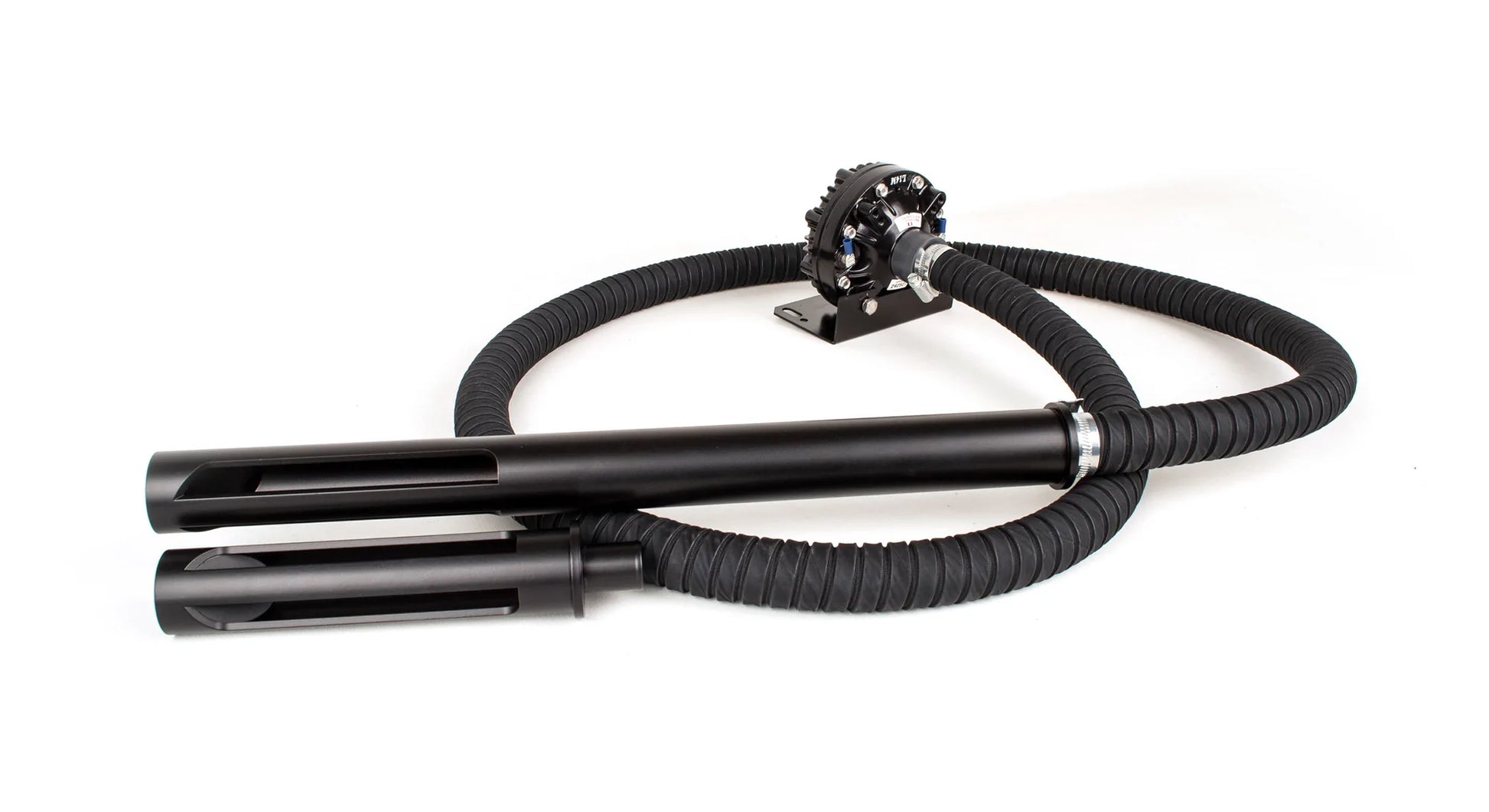

if you take a look at the below link it’s called a flex siren and allows the speaker to be located somewhere remote but the actual output a bit closer to the bonnet.
https://www.vehiclebodyfittings.co.uk/products/siren-flute-tube?_pos=5&_sid=578122236&_ss=r
this siren flute will be what you are seeing behind the grille I would assume.
when you say a small button on the steering coloumn it would have been a bullhorn or ptt button. And got any photos of the lights in the headlamps?
Another photo of a remote siren flute with pipe and driver.
The lights in the headlights will have been flashing blue lights, probably LED's.

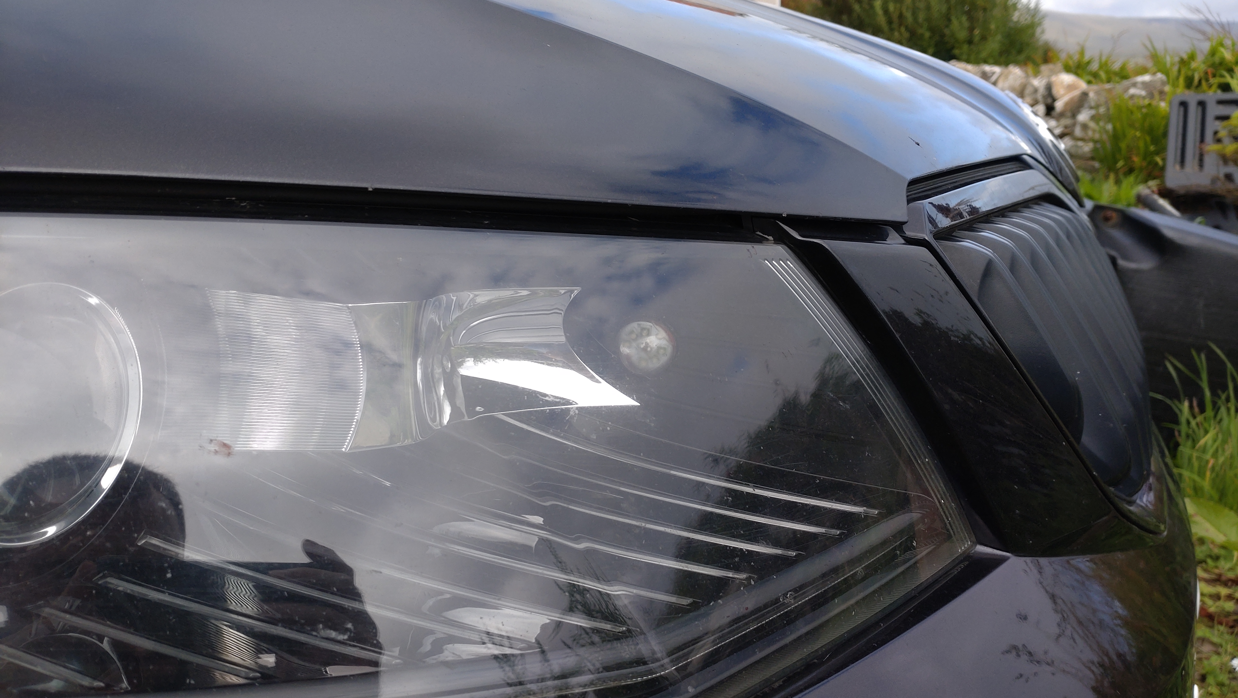

Pic of the extra LED bulbs as requested by @ApertureS. Upon closer inspection behind the grille, I also see brackets for further lights. So I would say confirms that it has been Emergency Services related.

Yeah that’s a Whelen vertex strobe so I’d same it’s ex emergency service spec.
