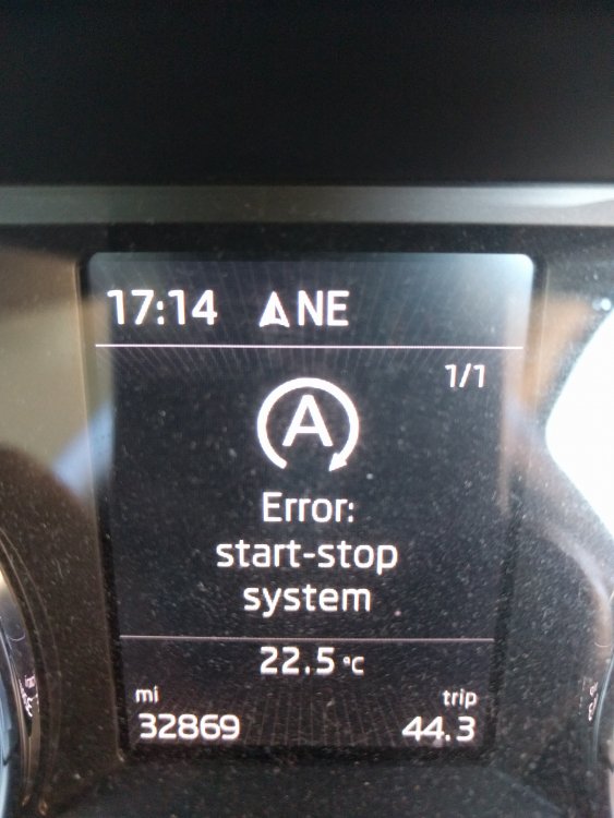

Well, after a week with a new battery the error is back! Happened twice today at the end of journeys.
Checking the battery SOC and it shows 80 or 90% so maybe the battery and the start-stop were different issues?
I'll give the dealer a call tomorrow morning unless anyone has any other ideas?

What DTCs (fault codes) does a diagnostics scan (e.g. using VCDS) show?
I don't have any files or to do a reading unfortunately. The garage said they didn't find any faults when they ran the test. Unless the codes were lost when the battery died?
If you get that error a fault code is most definitely logged.
This won't make you feel any better but when I had that error on my first O3 keep coming back it took them a while to fix ........
Thanks, Andyvee.
I can live with a fault with the system as long as it's not going to drain my battery and leave me stranded.
I'll speak to the dealer tomorrow and request that they check for codes, I'll show them the photo of the error too!
Unless anyone has VCDS near Gloucester?
Took the car in yesterday and it was reporting a ”module error". Didn't catch which module, sorry. Anyway, the module was working fine but the technician traced do a loose/broken wire and fixed that up.
Took about 45 minutes, didn't charge me anything. Hopefully that's it fixed now!

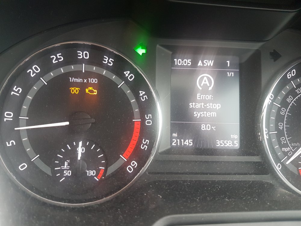

I’ve the same sort of error but also have Engine Management Warning light on. Car runs fine, except for stop-start. Which is cause and which is effect? Is EM problem causing S-S to disable or S-S issue flagging up EM problem?
Stop-Start Not Available or ACC Not Available will be displayed for almost all engine related faults.
The fact you have a MIL light says its an emissions related fault so should not be related directly to StopStart .

this came up this morning..it went into limp mode..engine light is still on.16 reg octavia scout dsg
Mine turned out to be an exhaust valve sensor (?). It was this fault that was disabling the start-stop.
Sensor replaced and all OK now, start-stop back to normal.
Ok thanks....did they have to plug it in
Yes, it showed up when I was there but cannot recall the specific code.
The odd thing was the EM fault cleared from the display intermittently on 2-3 occasions between booking the car in and it arriving. Seemingly pretty random.
