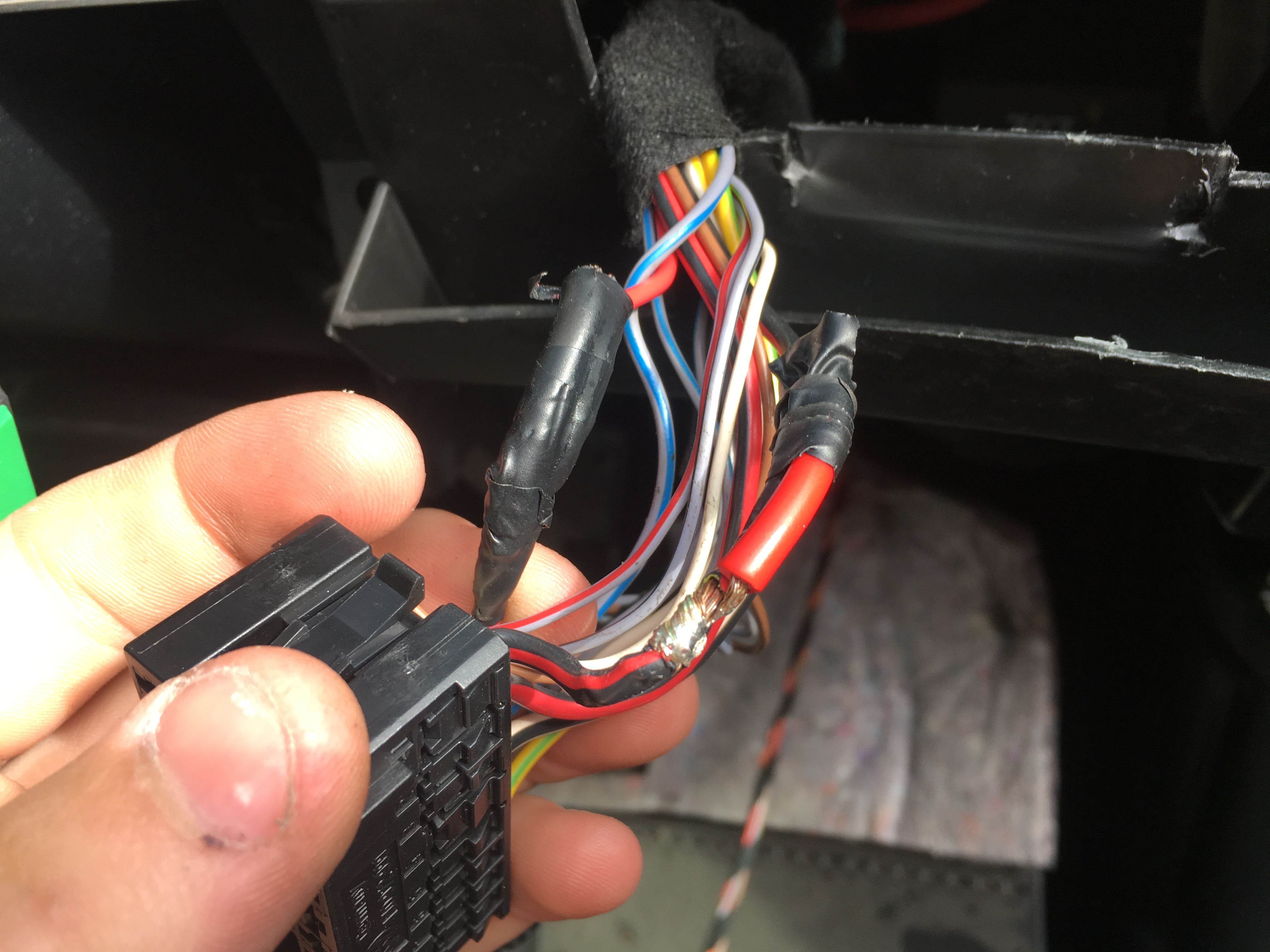

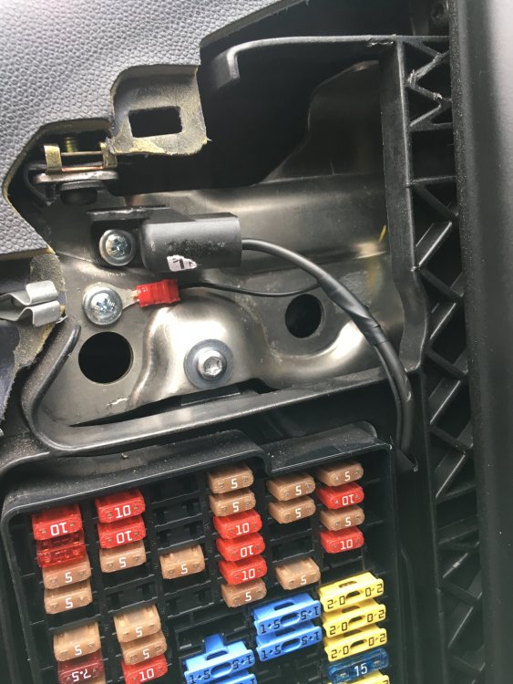

What's this connected to the fusebox??
Does anyone recognise this connection in the fusebox. I know its not OEM guessing its from a Parrot system or something. I suppose I should take the panels off under the dash and have a look but thought I'd try asking first.
  • Sponsor
Part of one of those 'spy on your driving' systems favoured by young drivers and their insurers.
There'll be another plastic box about the size of a matchbox at the end of that cable, probably wired in via an inline fuse into the light switch, for power.

Thats interesting, the previous owners were in their 30s with kids and the one before was a company exec in charge of a large garden centre chain, so strange they would have had a black box fitted. Still, thats my job for tomorrow to disconnect it if it hasn't already been unplugged. Are the insurers who own it likely to be able to still see the data?

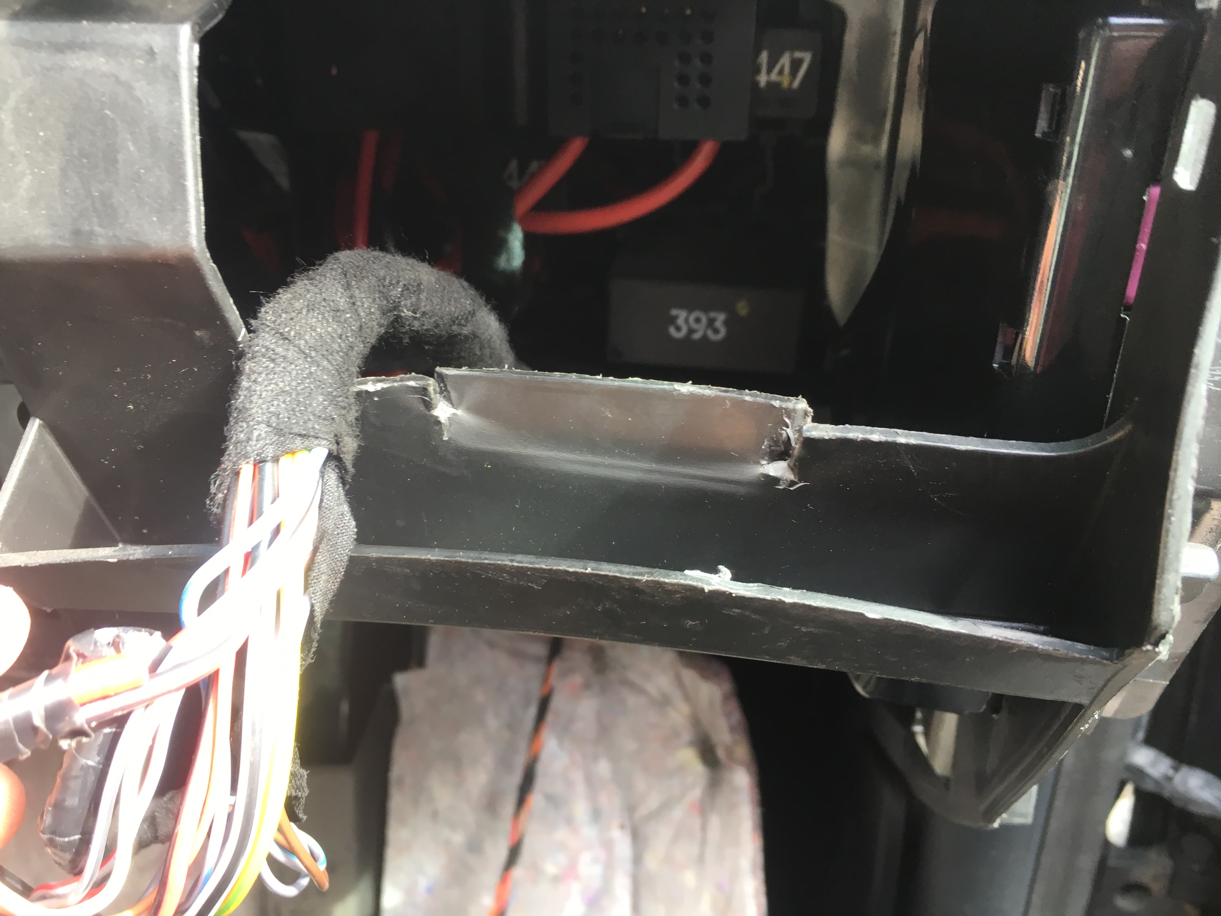

Ripped the blackbox out, whoever installed it had made a right mess of the installation. Most of the screws were missing from the dashboard panel, plastic had been ripped and damaged and the neat wiring to the headlight switch had been hacked apart and some wires wrapped round and soldered in place. To finish it off nicely electrical tape wound over everything.
Also, the pipe to the air conditioned drivers compartment was not even attached.
Wouldn't want one of those boxes fitted for this reason alone that they could cause so much damage fitting them let alone being tracked my every move!
The laughable irony of insurance companies fitting these boxes to encourage safer driving to lower premiums whilst the shoddy installation leaves the risk of a fire in the car. Hmmmm,

There was a(n added) fuse close to the splice into the positive supply, right? If so, in the circumstances of the installer probably being given a target time of about 20 minutes to fit this set-up, I wouldn't say that's particularly shoddy or dangerous, TBH. (The missing screws and broken plastics are very poor though, access much easier on the Polo, no such damage on mine).

The fusebox wasn't even screwed in properly obvious they had undone the screws holding the panel in to feed some wires through and never bothered refitting them. I'd never seen such a shoddy bit of wiring done by a professional although they might be on a tight schedule its not really an excuse when most drivers who have these boxes would be paying quite a lot anyway on their premium.
