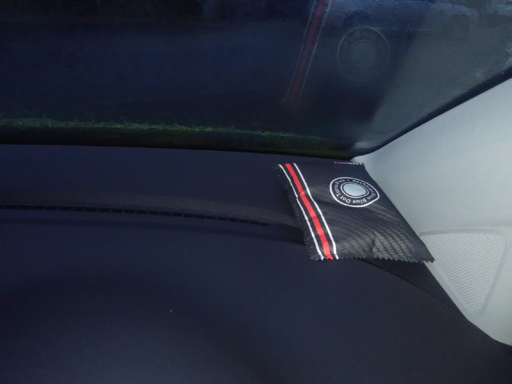

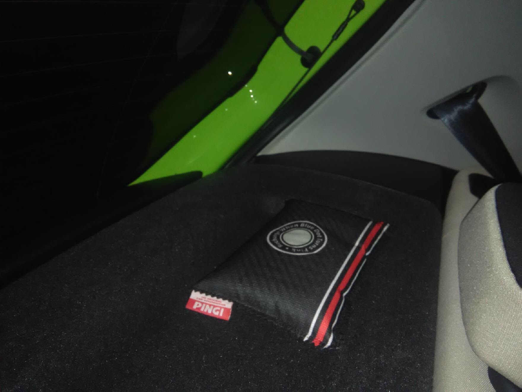

Hi,
I’ve just ordered Pingi reusable car dehumidifier on amazon for my Citigo.Will review on it later.
Excellent item. I have one in my Yeti and one in wife's Mii.

It’s almost 5 months since I’m using Pingi dehumidifier and with good results.In last couple of weeks, when temperature went down to 0 over night, I had to clean the windscreen from ice on the outside couple of times.But inside is always nice and dry.Today I did dry both bags for the first time in a microwave.After that I left them out for about 15 minutes to cool them down as they were very hot.Now they are back in the car ready for the job again.
