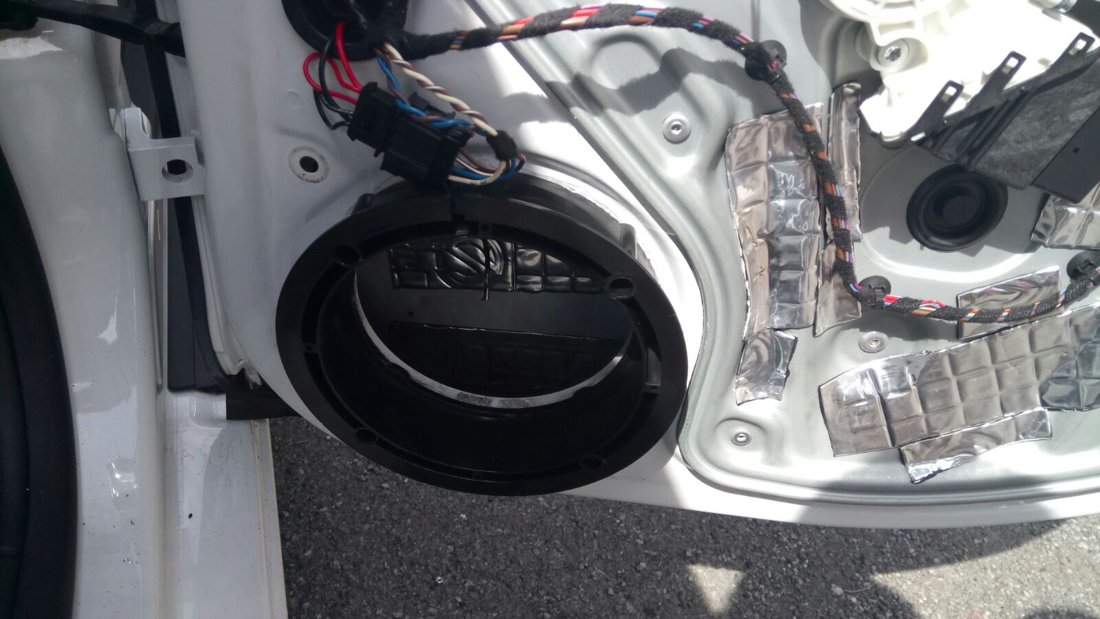

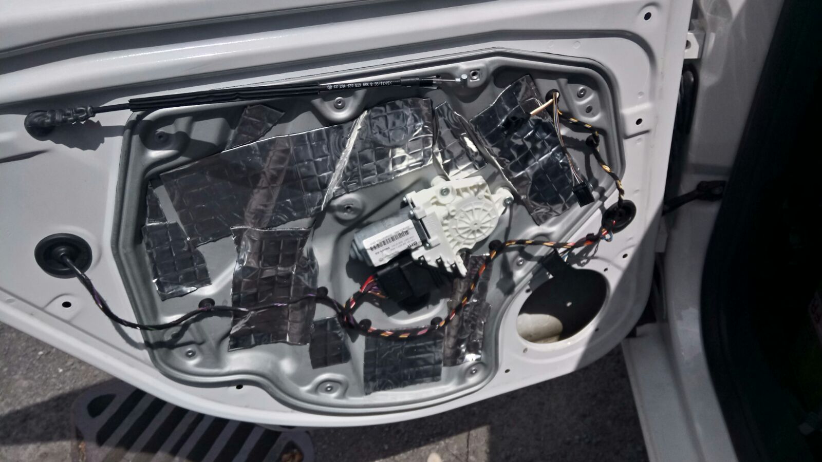

ok so a heads up on this one, they are mounted with the lip out, and was fairly straight forward to do and the SAK 3103 are a perfect fit lining up with the holes perfectly fixed on with m4 bolts and nuts silicone in for a better seal, I used bolts instead of the screws and backing plates they come with the SAK's because as you can see on the first pic there it a 80 degree lip on the speaker hole which makes it impossible to use them, so bolts are your best bet
door cards off ( 3 screws T20  x2 T30's)
Drill out the 6.4mmm rivets
fit adaptors lip out and bolt up tight
fit speaker cable adaptors ( should come with SAK's)
fit speakers ( 64mm mounting depth on mine and no issues with clearance)
place some dynamat or similar ( I like to feel for vibrations and use as little as possible, hence it looking weird but works well)
refit door cards
job done IMG-20170708-WA0006.thumb.jpg.50003aaee89acbfa5540cd945e1aa768.jpgIMG-20170708-WA0008.thumb.jpg.ad9119bea057e7835232cc87dbf5302a.jpg

I'd suggest using as much as possible rather than as little as possible when it comes to deadening.

hmmm doesn't make a difference, if you stop all the rattles then why use more, all you're doing then is adding unnecessary weight.

It does make a difference trust me, but if you are happy with partial coverage then its up to you.
