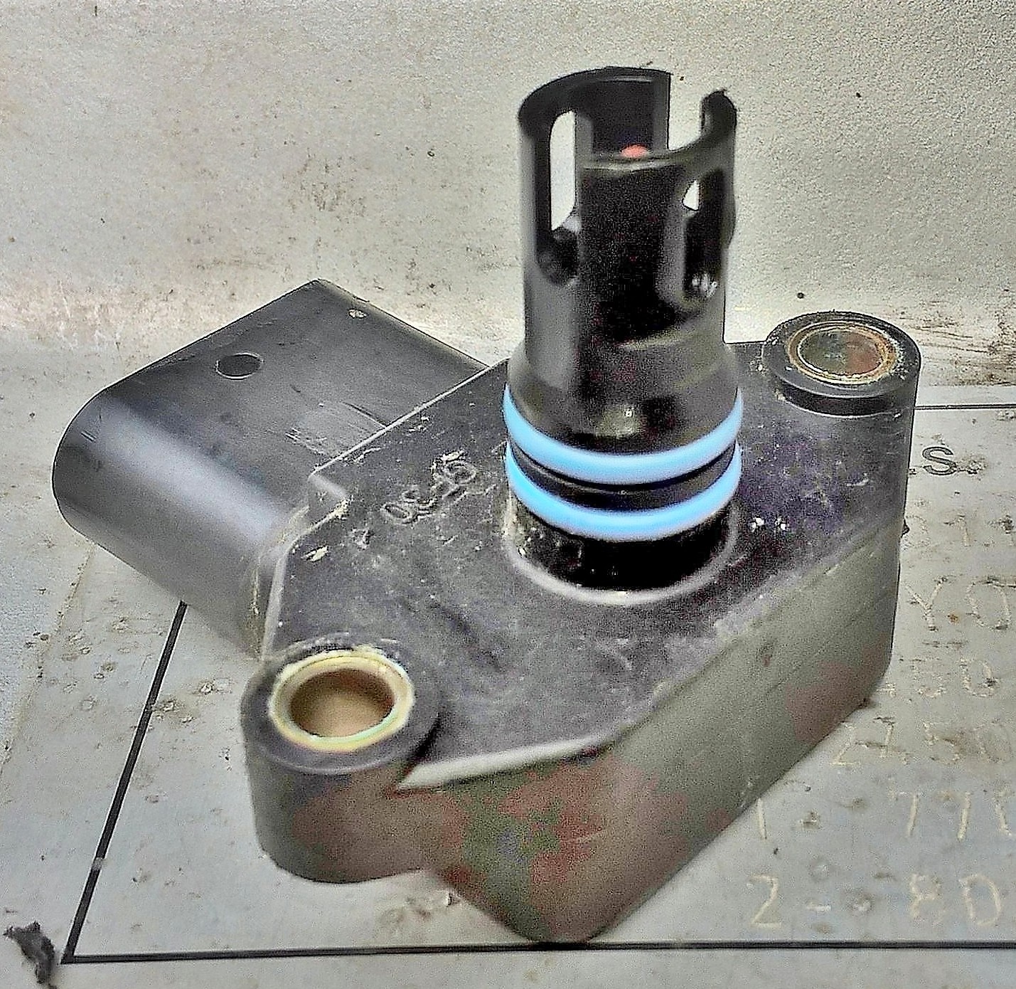

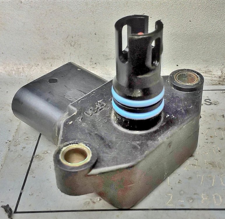

Ok so today i have cleaned the map sensor, also another sensor attached to throttle body (not sure what it is).
When I removed the map sensor there was a visible film of oil/residue and also inside it on the metal sensor part. Here is a photo, you can see some dripping/film on the top. Coated it in brake cleaner, and electrical contact in the plug and gently wiped the outside, careful not to damage the fragile bits.
I haven't removed and cleaned the throttle body, but the rubber ring on the air intake pipe, which snugs over the top of the throttle body, was coated in oily residue, also a bit around the top of throttle body. Breather pipe is a bit black inside too, but not wet. Anyway cleaned all this too.

9 hours ago, Fio said:
The ht leads are old and may be contributing?
It's possible but misfire is a topic in itself. There are many things that could cause a misfire. Electrical related (dirty/corroded/cracked dizzy cap, worn carbon brush, cracked ht leads, bad sparkplugs, corroded connectors), fuel related (dirty injectors, dirty throttle body) and air related (vacuum leaks) to name a few.
@Fio - The oily MAP sensor suggests to me that you should clean the crankcase ventilation system because that's pretty much where the oil must have come from.
As to the HT leads, are they stiff to the touch? Does the misfire improve if you clean them with a cloth and spray them with WD40? If so, then in UK conditions a new set of HT leads will certainly improve and may cure the misfire, and probably give enough better mpg to justify the cost.

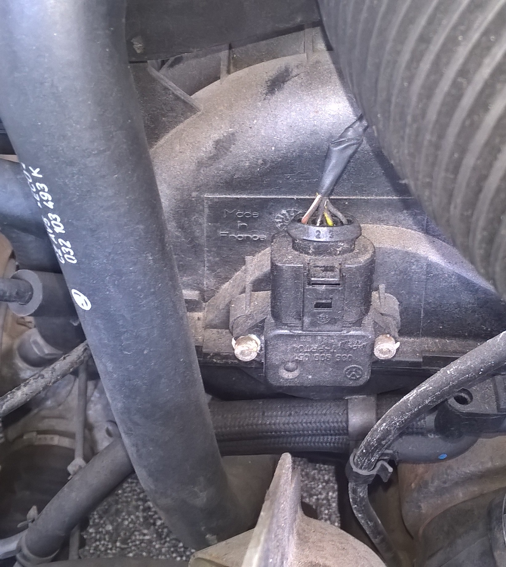

I checked the MAP yesterday, it had a small film of oil on it, but nothing untoward.
Anyone know if you can test it in situ? and how to do it?
Edit = just tried unplugging it once the car was running --  it died immidiatly  - plugged it back in and it ran
so it is working --
