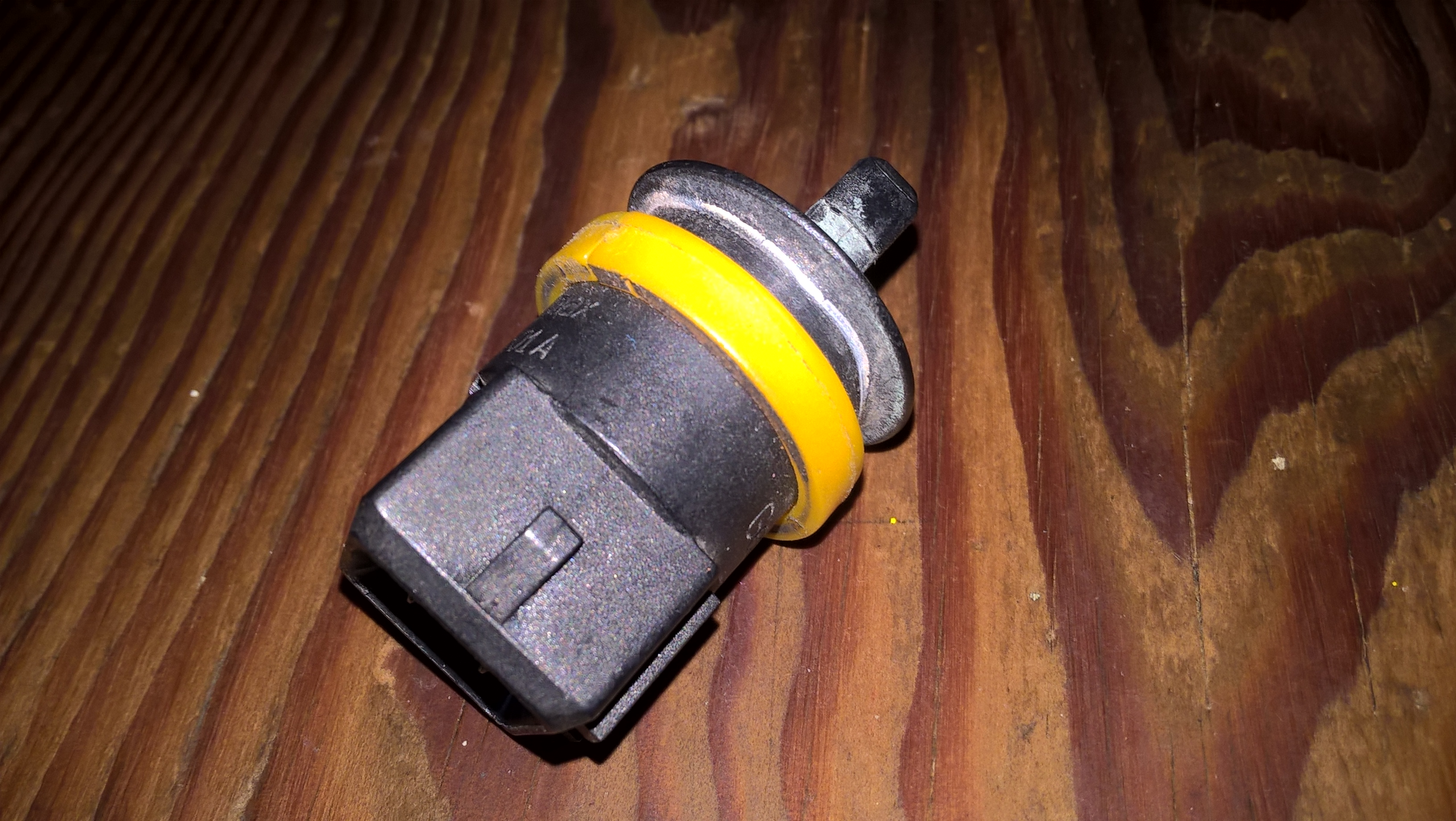

Picked up a replacement temp sensor for the project car.
It's a HAAS part  - Equivalent to 1331294  shown my my local motorfactor to fit the felicia
I removed the original part..   and initial inspection it apeared to be broken ..
just a small blade that sat in the block, with an O ring and yellow lock ring on top
The replacement is a flat circular affair more akin to a rad sensor, but 4 pin
well no matter which sequence of  yellow ring, O ring, no  O ring  placement on the sensor, i cant get the snap clip over the yellow ring.
It will not sit low enough into the housing.
I could file the  housing slightly to allow the snap clup to sit higher, but i'm loath to do that due to potentially cocking up the oring seal.
Dont ask me about getting an oem part from the main stealer ...  see my other thread for that ...
any ideas?
Mart

I didnt buy the part from VW or Skoda.   It was bought from a motorfactors.  who supply pattern parts.   ie parts made by tier 2 or 3 suppliers to meet OEM specifications .
Looking at OEM PC, it lists the correct part for the Felicia as 6U0919501B.
This part fits  - 34 other vehicles from the Seat,  Skoda, VW Group from 1994 to 2009  - conservativley thats over 36 million vehicles all using the same sensor!
Black box changes to parts from tier 1 suppliers happen , but these are reflected in part number or AI number changes.  no other part number is given for this sensor.
if you do a search for part number 6U0919501B you will find it returns a 4 pin flat bottomed sensor with a yellow id ring ...   Haas, Febi, etc.
The part i removed is a 4 pin sensor with a yellow id ring, the only difference is the sensor case is a smaller T shape.
In terms of diameter is the same,  its the same size O ring,   what is different is the height of the clip face to the yellow snap ring.
What would be helpfull is if you have encountered this, and what did you do,  as per my original request!

i had to swap the cars around, so decided to revisit this.
Looking at a video on youtube, it was just in / out  and no leaks.. so i thought lets give it a go.
so i unclipped the origianal sensor, and teased it out ..   no spurt of coolant this time,  ( i released the header tank cap last time )
I assembled the new sensor as per the pics online and popped it in ...
Ok instant change.   instead of a quick burst of rpm (1100 or so), then dropping back,  the RPM stayed constant ...   and no leak from the sensor housing ...
The temp gauge.  then started to move  :) result  ... as soon as it hit 70,  the rpm dropped to tickover 900 or so ....
No leaks ....
I let the engine get up to temp and waited for the fan to kick in, watching for leaks ..
the fan kicked in just as it hit the lower red bar,   and cycled to drop the temp ...
i turned it off then as no leaks were evident ..

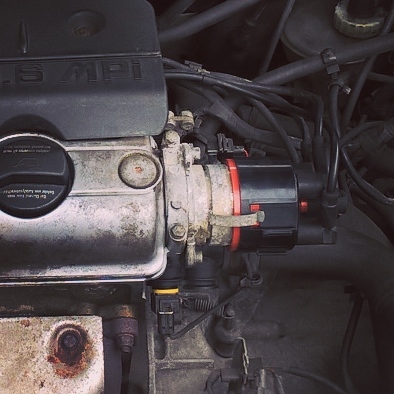

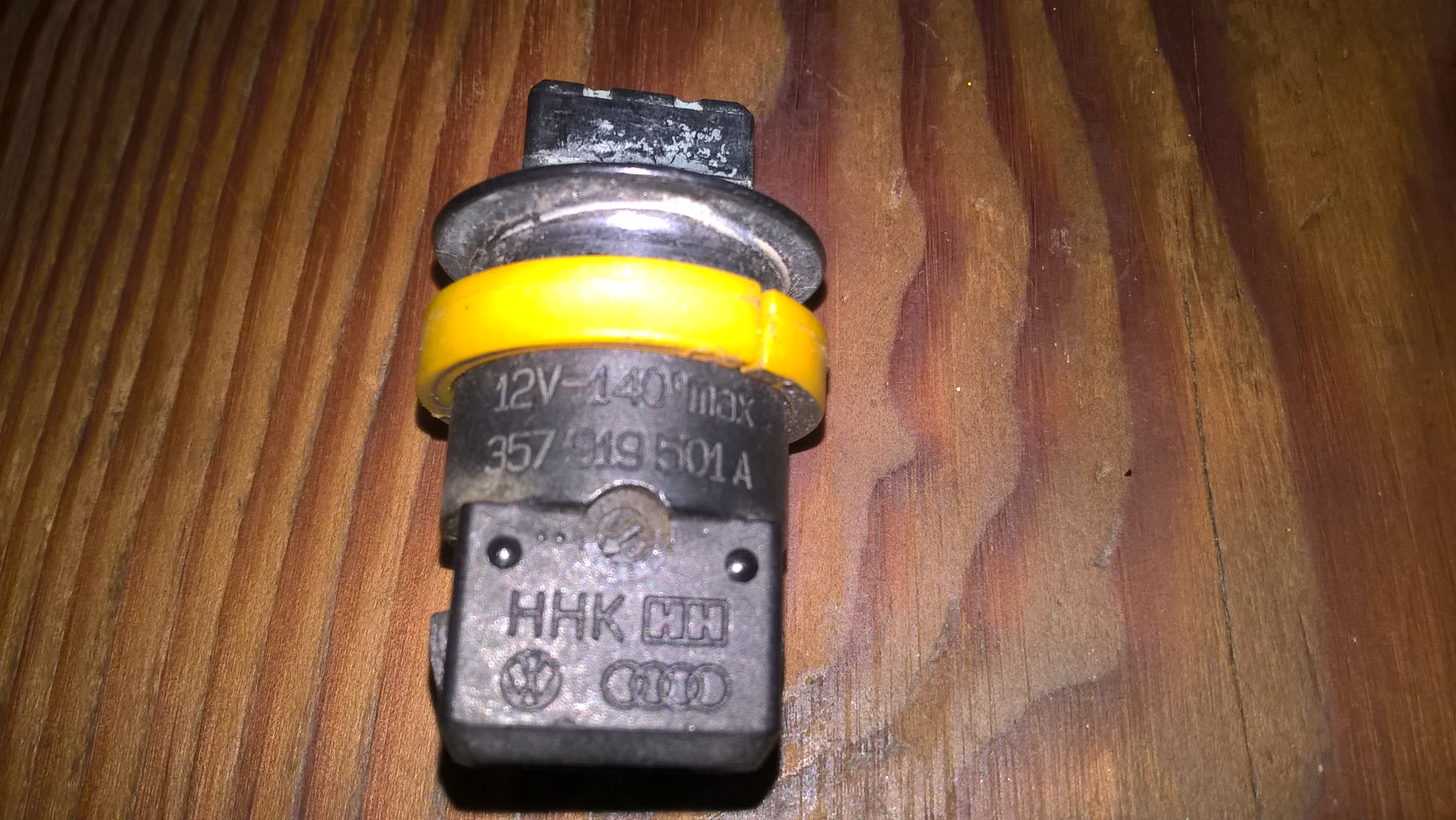

Hi,
On the original subject of aftermarket temp sensor:
I also replaced mine with an aftermarket sensor branded "topran" (my temp gauge wasn't working), I managed to buy it with a gsf discount coupon so it only cost me about 15 quid, so I thought id give that a try. Here are some pics of the original t shaped sensor, the aftermarket one and also one of the new sensor fitted to the car.
As you can see they look different, but the diameter of the new sensor is the same as original, so I had no issue with fitting. The rubber o ring slides onto the metal sensor, instead of the groove on the original (see pics) and it does clip in securely, allthough the yellow band sits about 2mm further out.
It did cure the problem of the temp gauge, which now works just fine.
There are some issues I had hoped the new sensor would solve, which is as follows: After a run of short trips and parking up for a few hours, when started again the idle is around 1100, and rich sounding (chug chug chug), for 20 seconds approx, then it settles to 900 and idles fine. This doesn't happen if I'm doing longer trips. Could this be related to the temp sensor? Or is it normal if I'm doing the short trips (I cant avoid it sometimes unfortunately).
Thanks and hopefully some find these pictures useful.
The brand Topran is distributed in Europe by Hans Pries company from Germany. Of course, 'distributed' is not equal with 'manufactured'. They are in fact low cost parts made in China. In case you wonder what is their level of technology and quality, see the videos below. Note: for Felicia 1.6 the part number of the CTS is 6U0919501B.
In case you didn't know, one thermistor inside CTS serves for indicating the coolant temperature on the dashboard. The other thermistor feeds input data to ECU. If the temperature-resistance characteristic of that thermistor is not correct, the engine might behave like you have described. One other possible cause might be the oxygen sensor. But most often cleaning the throttle body and the IAT/MAP sensor solves the issues.
52 minutes ago, RicardoM said:
see the videos
Doesnt look like it will last long then... Might have to bite the bullet and try the main dealer..
I'll see if cleaning throttle body etc helps,
cheers!

Before we relpaced the one in my sons car, it woul start and idle immidiatly, however you had to give it a bit of throttle to get it moving.
With the new sensor  it starts on fast idle ( approx 1100) and stays there until the coolant temp reaches 70c then  drops to 900 or so
if i recall from a hot start, it goes to 1100 but drops to 900 idle immidiatly.
I would  follow Ricardo's suggestion and clean the throttle body  and MAP sensor.
When i did my MAP sensor on the SAAB, it was full of oily carbon gunk, and would give me a CEL (Check engine light) every couple of month's
cleaning it with brake cleaner or similar  cleared out all the crap.   i never had a problem with it since ..  dont use a cotton bud or anything in the sensor opening , there fragile parts in there.
You could also try running some millers octane booster through the tank, it does a good job of cleaning the fuel system, or redex
Thanks Santa,
From what you describe I had similar, rarely had fast idle on start up untill I replaced the sensor, and no temp gauge reading.
With the new one I have 1100 after starting, which drops to 900 gradually. Hot starts its quickly. So maybe thats ok then, its more the chugging sound while its idling higher, almost like a small misfire which settles when at 900.
I'll give the map sensor a clean and try the fuel system cleaner (I tried some redex a few months ago) to see if it helps with the chugging start.
