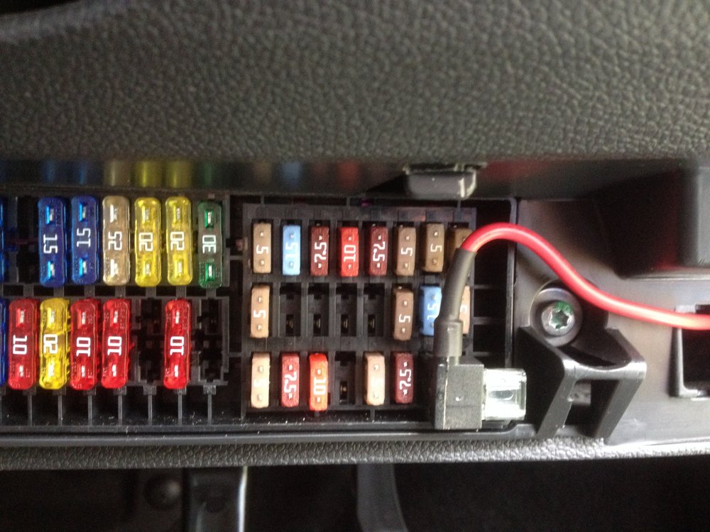

I plan to do this with a piggyback fuse in the fuse box - but don't know how.
I have included a .JPG photo of the Fabis vRS fusebox, can someone please tell me which socket I should use?

This is on a 1.2 Tsi. It's fitted in the space below your 5 Amp fuse.
On the mk2 vrs the far bottom left fuse which is empty is an ignition live, I have my blackvue pro magic plugged into that.
the standard fuses not the mini.

Hi LGM, can you please tell me how exactly you have connected up your DashCam?
I imagine that the original lead terminated in a USB plug? Did you cut that off, strip out the live wire and connect it to the piggyback and the negative wire to Earth somewhere or did you connect up some sort of USB socket to the piggyback fuse?

I have a black magic pro wired into the fuse box which has 4 wires, a constant, a ignition, a earth then a female cigarette socket.
ebay item number 232281861523
Connected to that is my dual cigarette lighter which is stored in the right side of the dashboard (if you open the drivers door you'll see a panel that you can pop off)
eBay item number 162462339762
and my 2 dashcams are connected to that. The wires are ran up the pillar then the front goes across the roof lining and comes down just behind the rear view mirror.

before i installed the black magic pro to my dashcam setup I was getting quite a bit of interference with the radio reception, since that has been put in I get zero interference. For the sake of £30 I'd buy that too.
The black magic pro let's you run the cameras whilst your keys are out of your ignition, you simply flick the switch and it keeps recording. Comes in handy for the when you pop into the supermarket or park up somewhere you're not familiar with.
its ****ing it down at the minute so I can't take pictures.
As for finding an earth if you pop your fuse panel cover off, there's a torx screw on the far right hand side over your obd port, mines connected to that.
