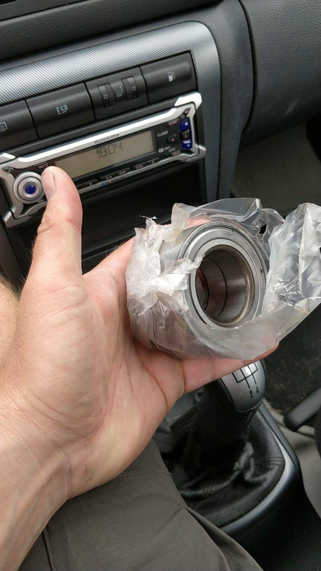

The kit i bought.
SKF bearing kit - Came with a spring and three nuts.

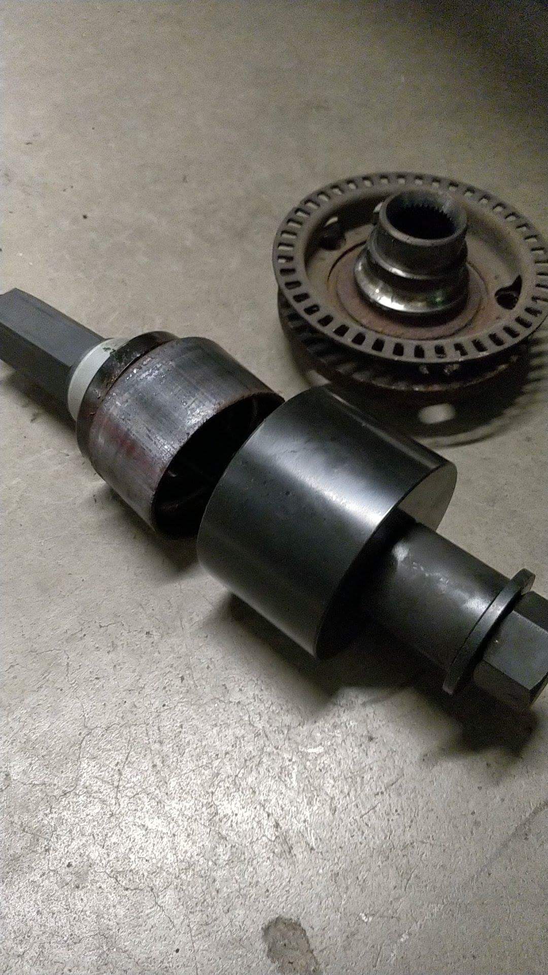

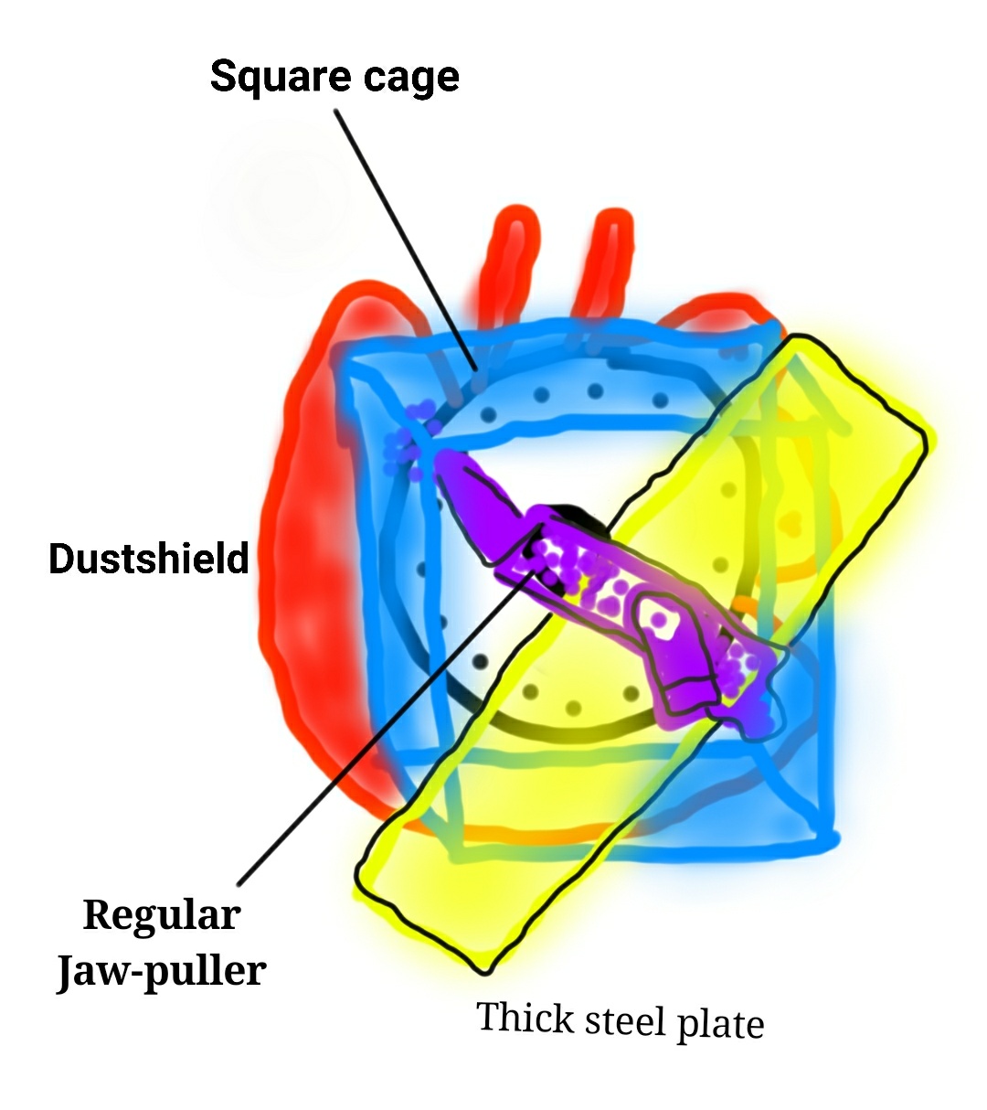

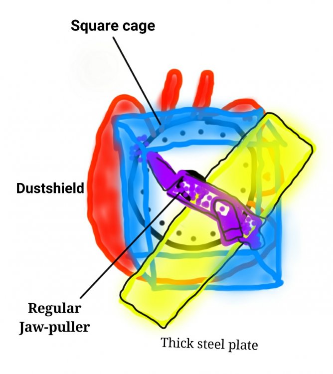

Made a contraption-cage so i was able to pry against something with my regular jaw-puller. The cage laid against the dustshield and the housing.
Then i laid a thick plate on top to press against.

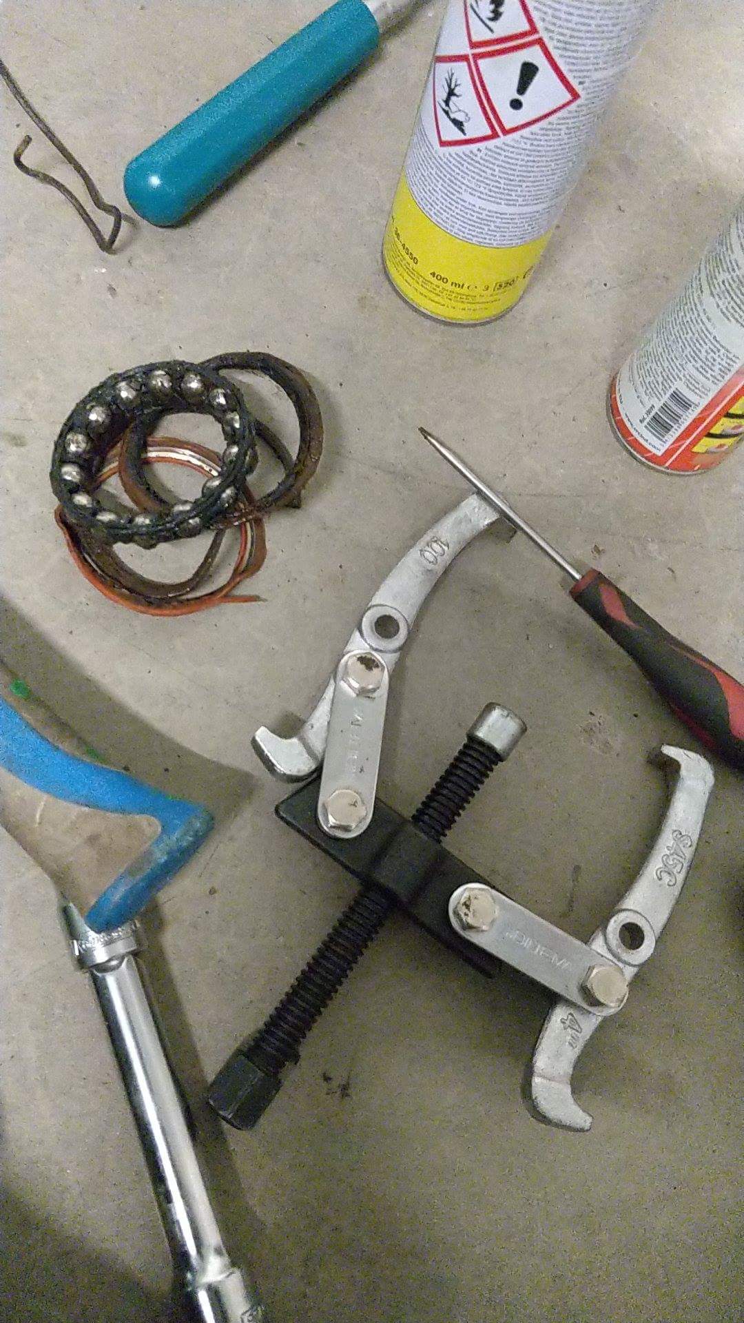

The jaw-puller i used.

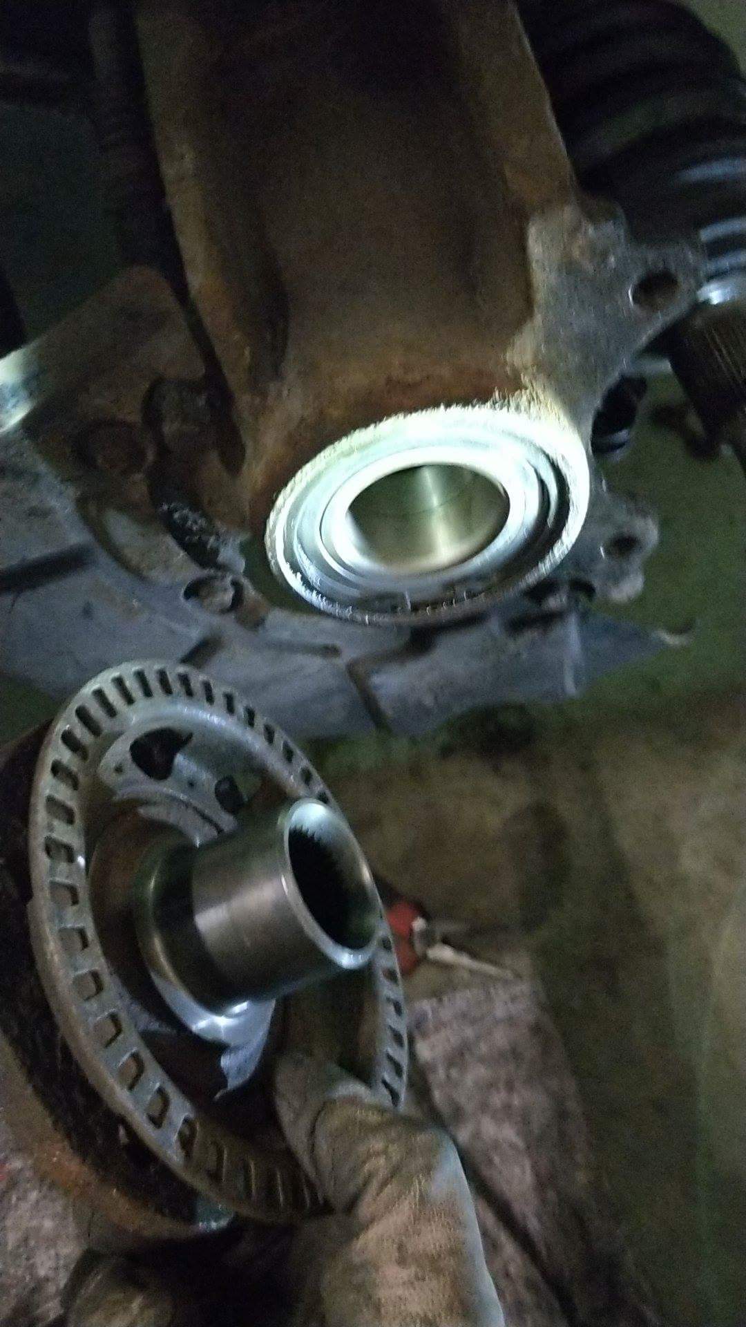

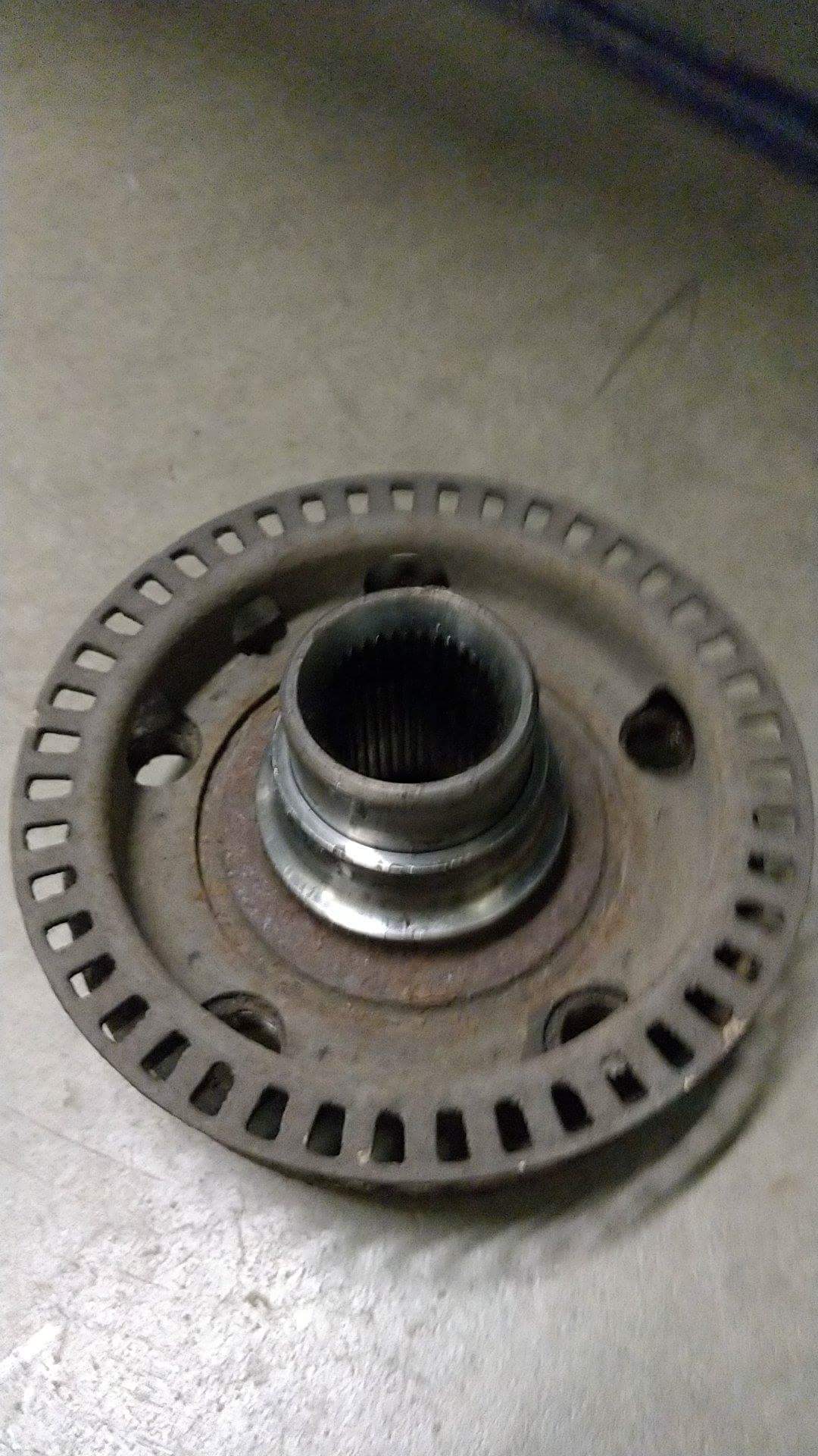

Hub out, inner race still left on the hub.
Bearing left to be pulled out.

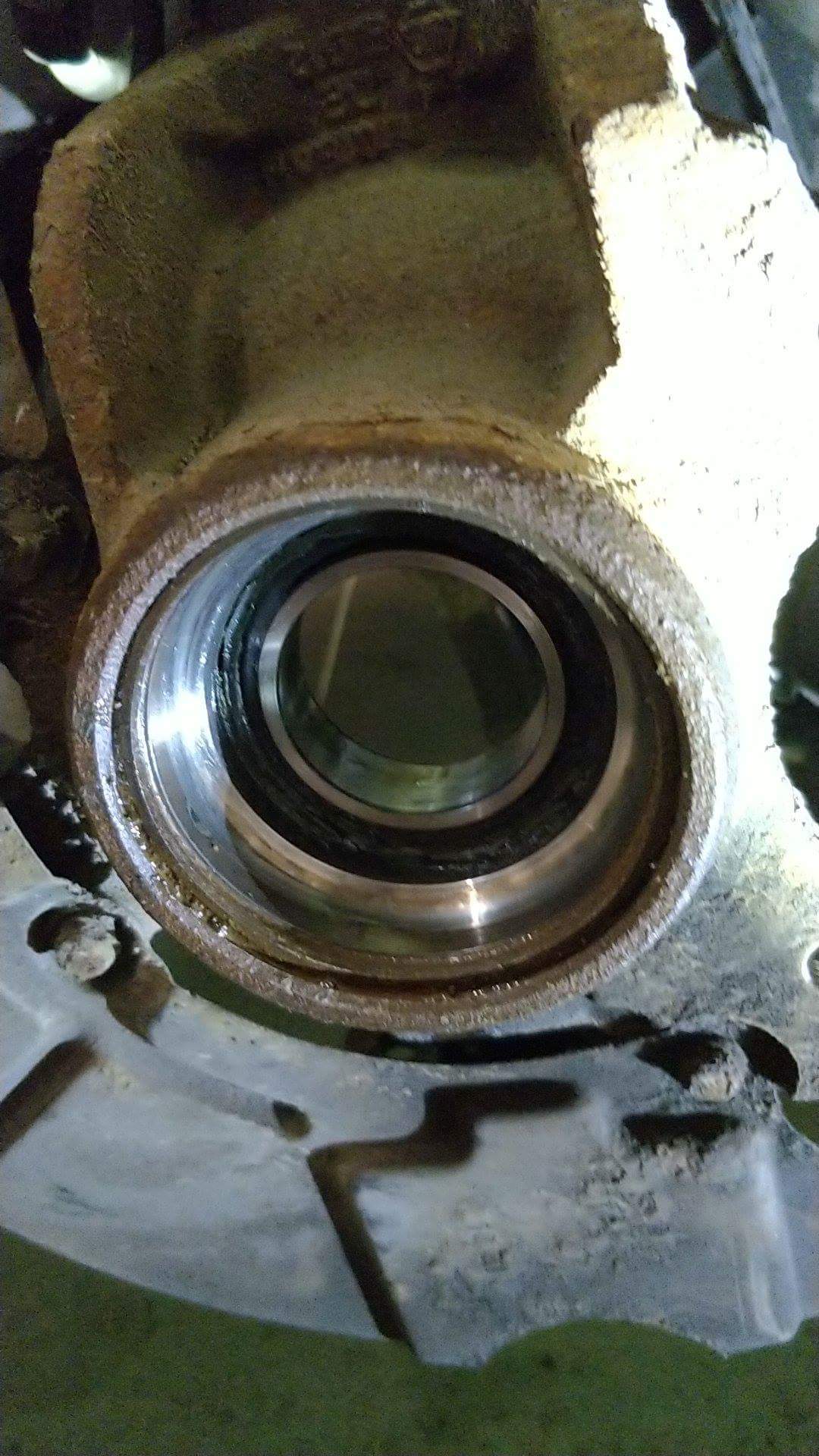

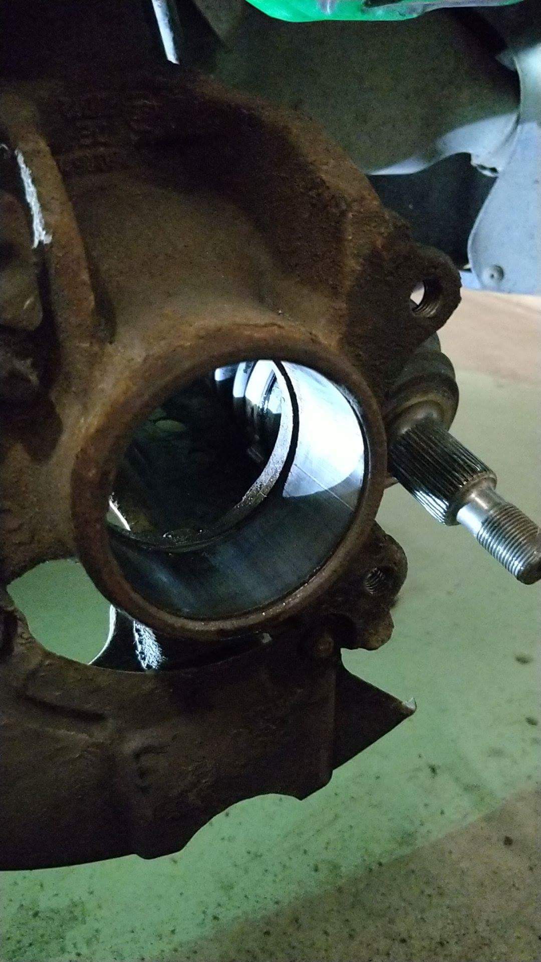

Housing got cleaned up.

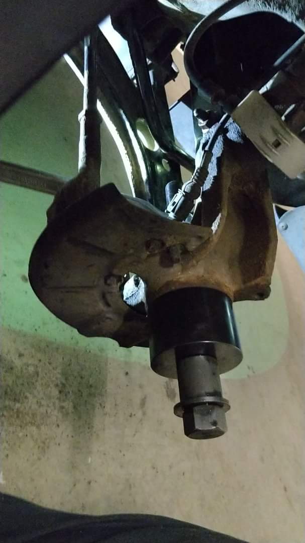

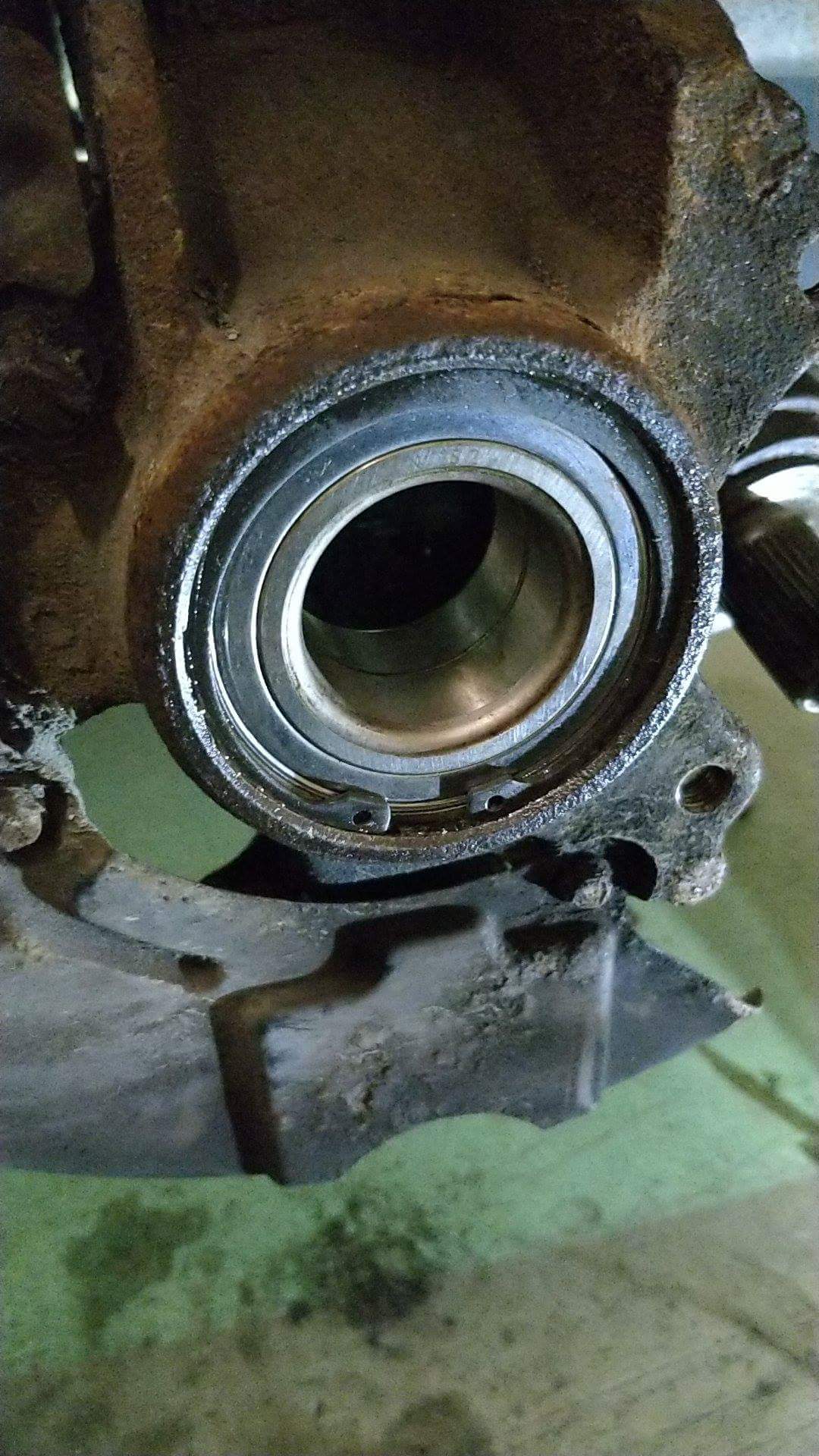

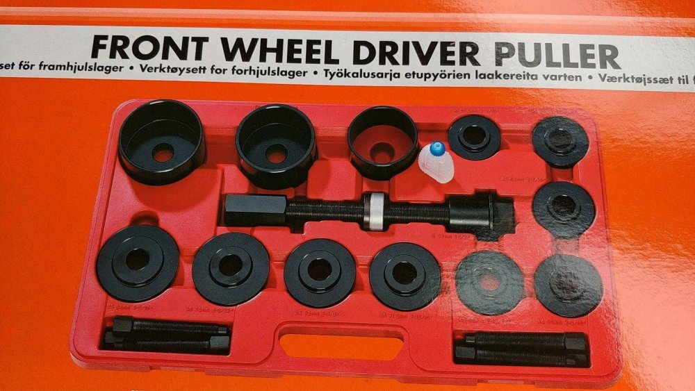

Pulling in new bearing with greased housing.
Seated with lock-washer installed.

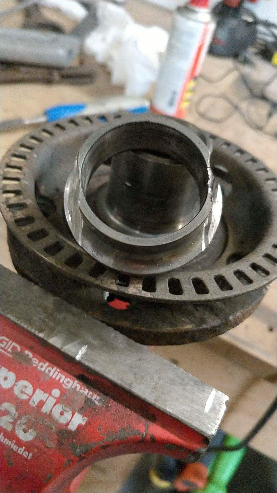

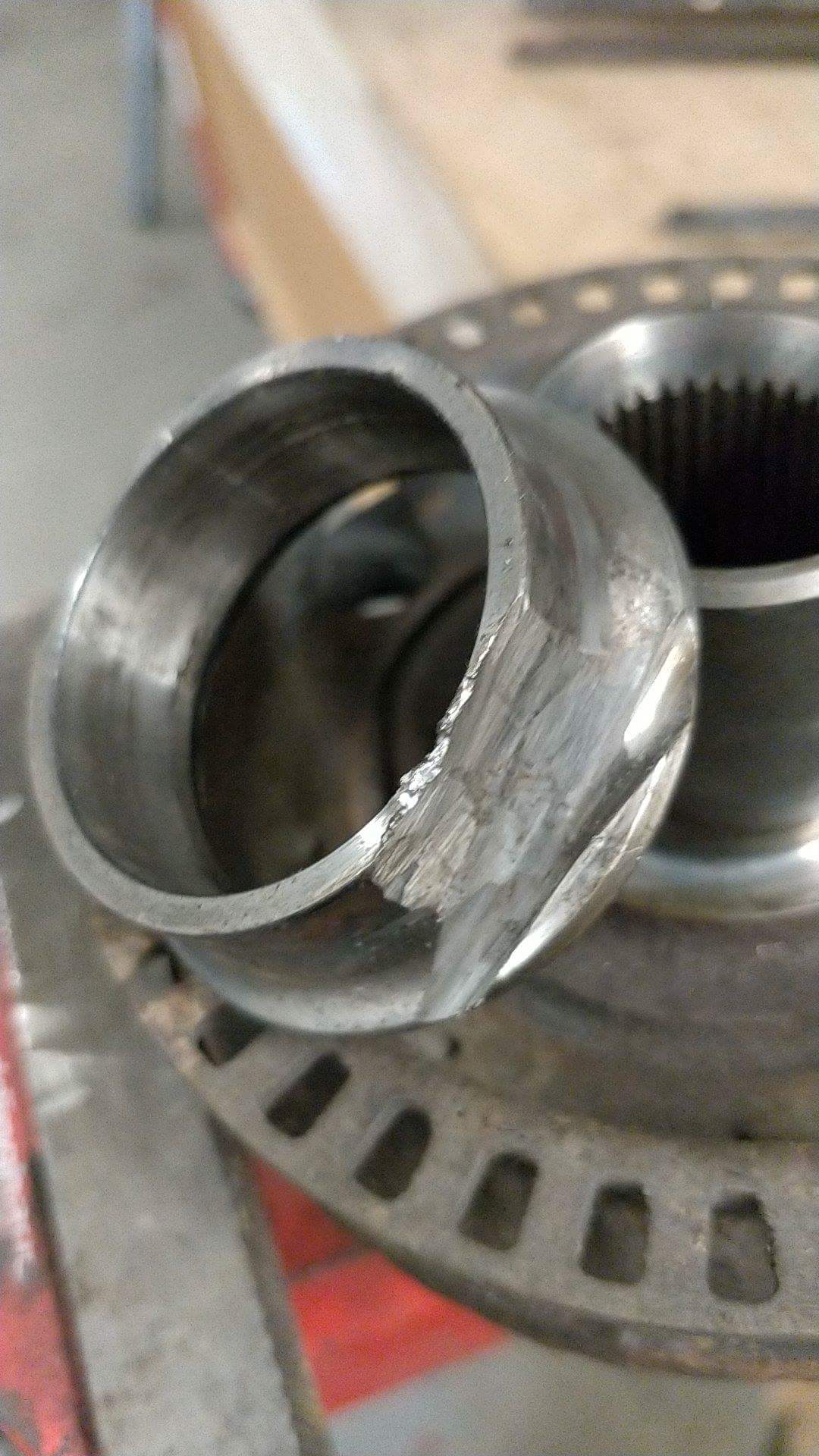

Had to grind down the sides of the Inner race to weaken it so i could use a rod to crack it.
It cracked and I was able to pull it off, wear eyeprotection when hitting on bearings.

I have a brand new knuckle on the way from Germany after my original shattered when the garage tried to press the bearing out. I have the same installation tool as you and am looking forward to getting this job done. (I did order a "used" replacement knuckle after the first shattered but that turned out to be bent).

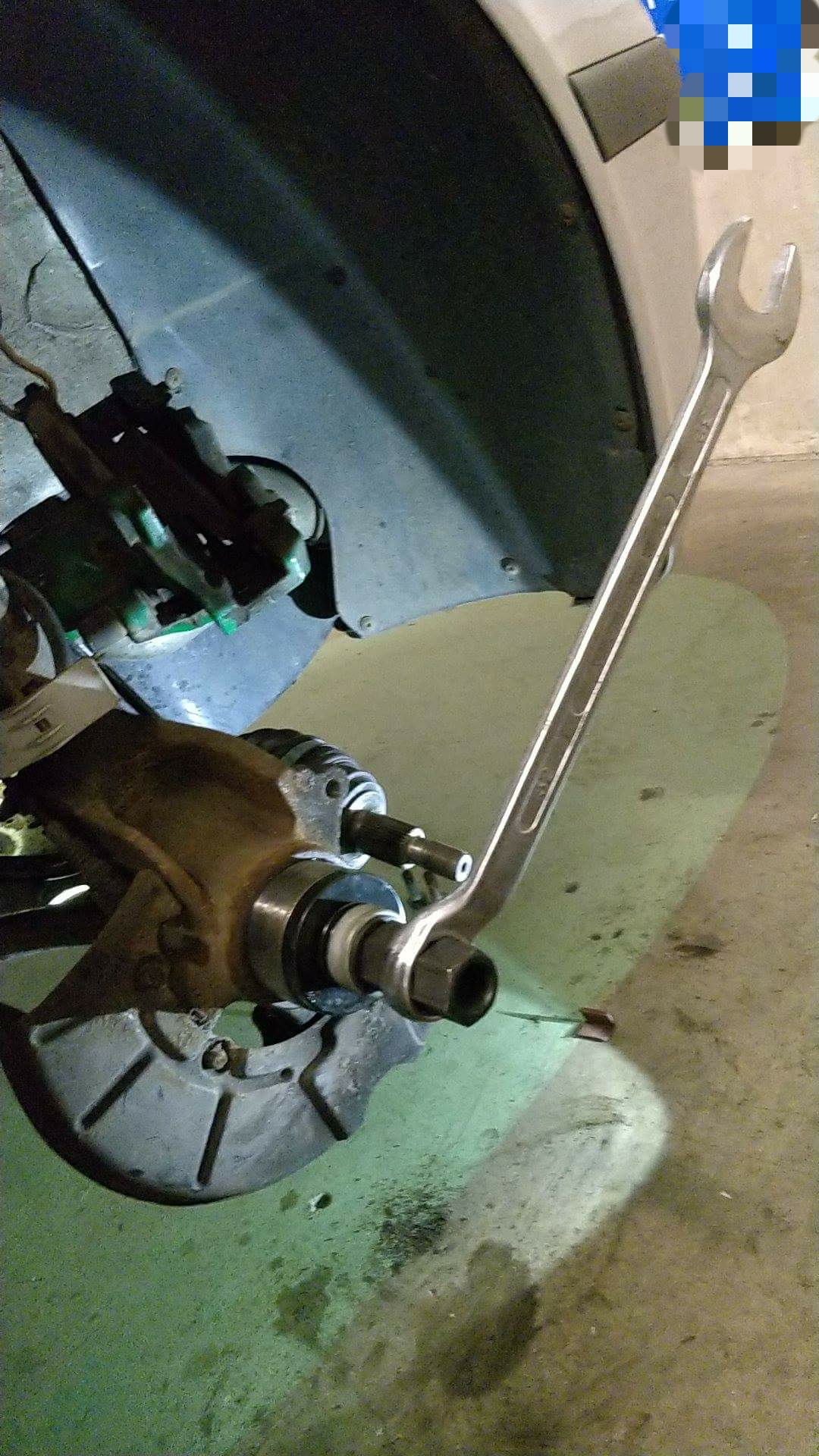

I pressed the bearing and the hub fully seated. I hadn't a torque wrench that was going to 200nm so I torqued it to 165nm then  the rest with a breaker bar until it went to a firm stop, and I couldn't turn more.  (didn't want to damage the nut.)
I understand  that this step is to seat everything fully home.
Then I released the nut 180 degrees, rotated hub 180 degrees, then I retightened the nut to 50nm. Finally it should had been tightened 60 degrees, I tightened with my breaker bar aprox. 40 degrees then it went to a firm stop, then I tightened just a little more.
I can't understand the last 60 degrees, it would had been too much in my case, I didn't want to damage the nut. The bearing type can't be overtighten because of the cylindrical shape, only the nut will be damaged if overtighten.
I'm confident with the torqued I applied, had done a lot of mechanical work in my life so my feel of it guided me.
I had done ca. 80km since the change and everything is fine. The nut also has a plastic inner part of the end of the threads so it should hold in place without undoing itself.

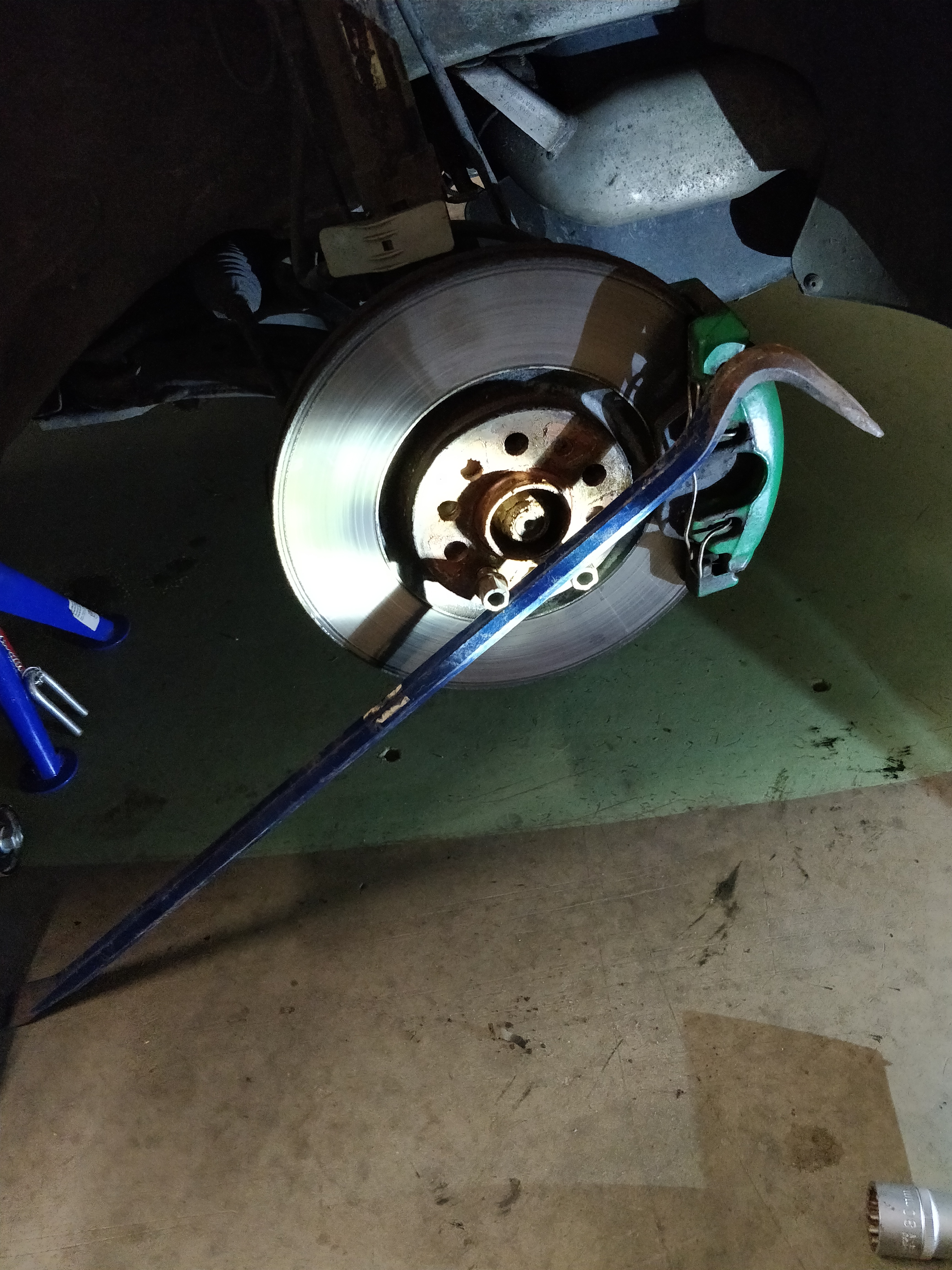

I torqued it unloaded on jack stands using a crowbar and two wheel nuts to hold the crowbar. Picture showing when untightening the nut.
