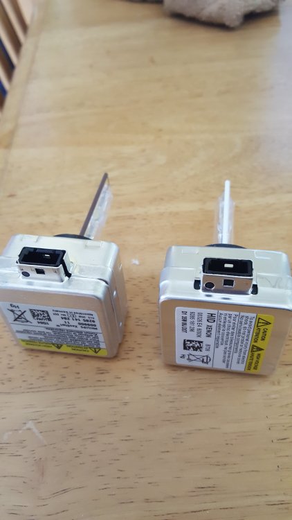

Spot the difference ...
Left one is a Zen Phillips at about £167 plus vat (I got quoted from Skoda for 1!)
Right one is a hid brand off the internet (20 quid for 2!)
Had them both in the car for 3 months now and no issues, however they were more blue in colour (6000k)...im not sure what the original Zen Phillips are.
A genuine Philips XenArc D1s bulb is about £50 from a decent supplier :)
