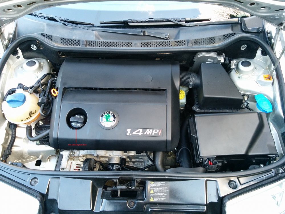

As for the hydro-lifter. Does your engine have a cover with a little (dirt/water) hole next/below the oilcap (like on the pic below)?

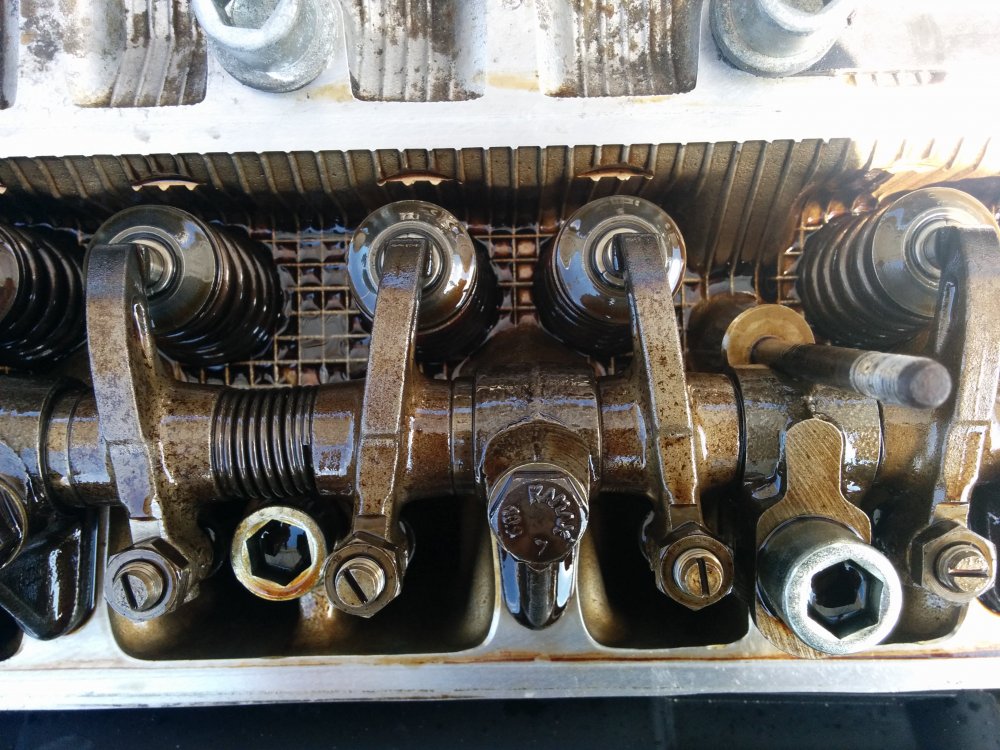

I have the same noisy lifters in my MPI, changed to full synthetic and I haven't heard them since. Below is my 16 year old engine valve-head that was never flushed before with 11 months old synthetic oil in it.
