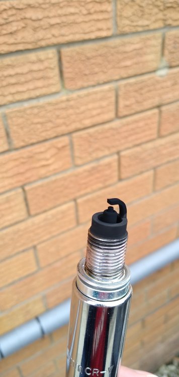

I changed the spark plugs to NGK from bosch. Cylinder 2 spark plug was black with soot.

This is the spark plug from cylinder 2 which is the NGK plug I have just fitted along the a new ignition coil (individual coils)
You did almost everything to check for spark issues on cylinder 2.
Unless the high voltage lead for cylinder 2 is bad, you're left with an injector issue since the black spark plug shows clearly a very rich mixture.

I had no compression tester so I decided to get a garage to do a compression test, and then I remembered I had a 12 month warranty on the car that covers the engine so I took it back there and they tested it, and the compression was fine so they took the fuel rail off and said there was an issue with the cylinder 2 injector and the fuel rail wasn't looking too clever, so they replaced the fuel rail and the 4 injectors and luckily they did it for free under warranty.
