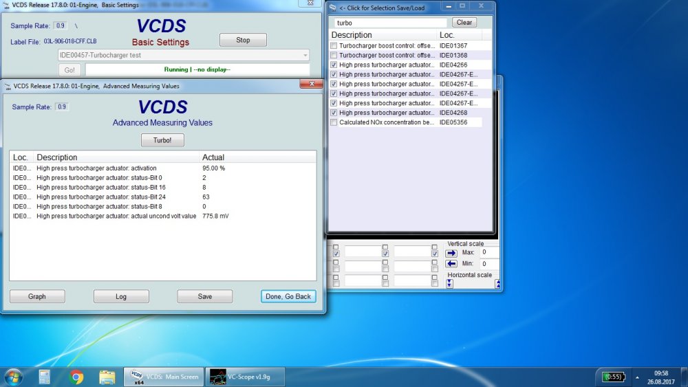

I'm having an issue with engine running in cold oil conditions. It makes a "bump" in the acceleration in 1st and 2nd gear.
My suspicion is the VNT actuator.
In VCDS i tried to measure blocks but it is blocked and i can only see the turbocharger VNT actuator opening in the readings. Attached a pic.
Do you have any idea how i can test IDE04266 as measuring block test?

Hello again,

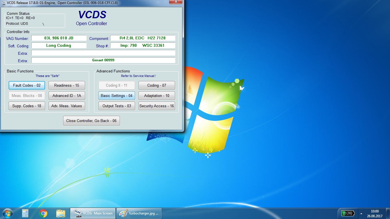

I made some screenshots. Please see below:
1. the first one is to see that in 01-Engine the 08-Measuring blocks controller is locked.

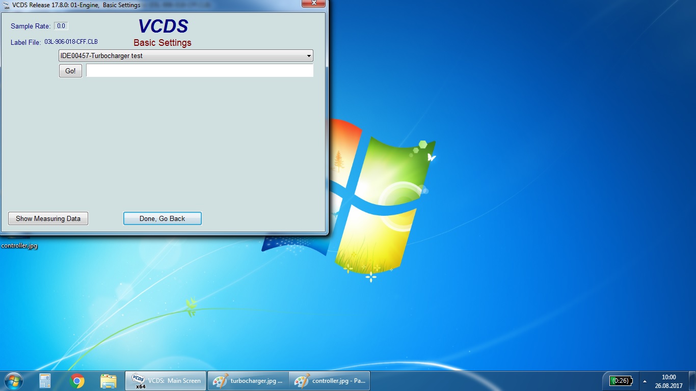

2. in 04-Basic Settings i can reach the Turbocharger Test
3. the available measurements of the Turbo are listed. I am interested in more accurate analysis of the first test listed IDE04266 to see if the VNT is working properly.

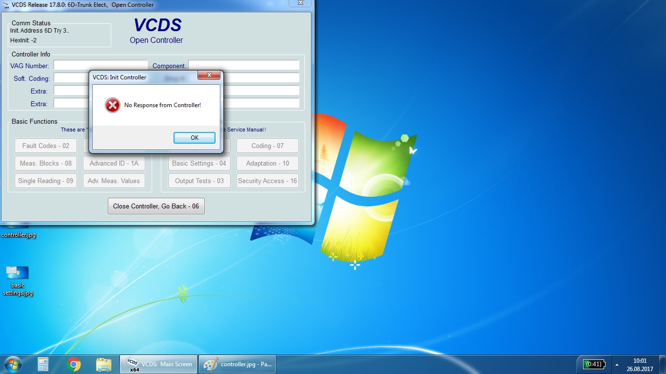

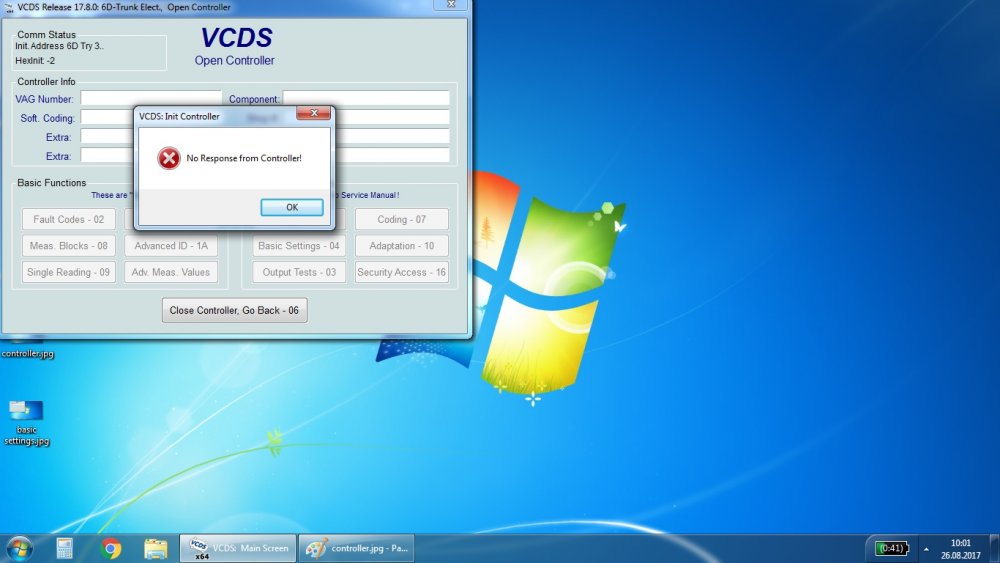

PS: i have tried the adaptation regarding the electric trunk to be closed from the remote key, but i get the message from the 4th prt scr in 6D" NO response from controller". Do you have any suggestions?
