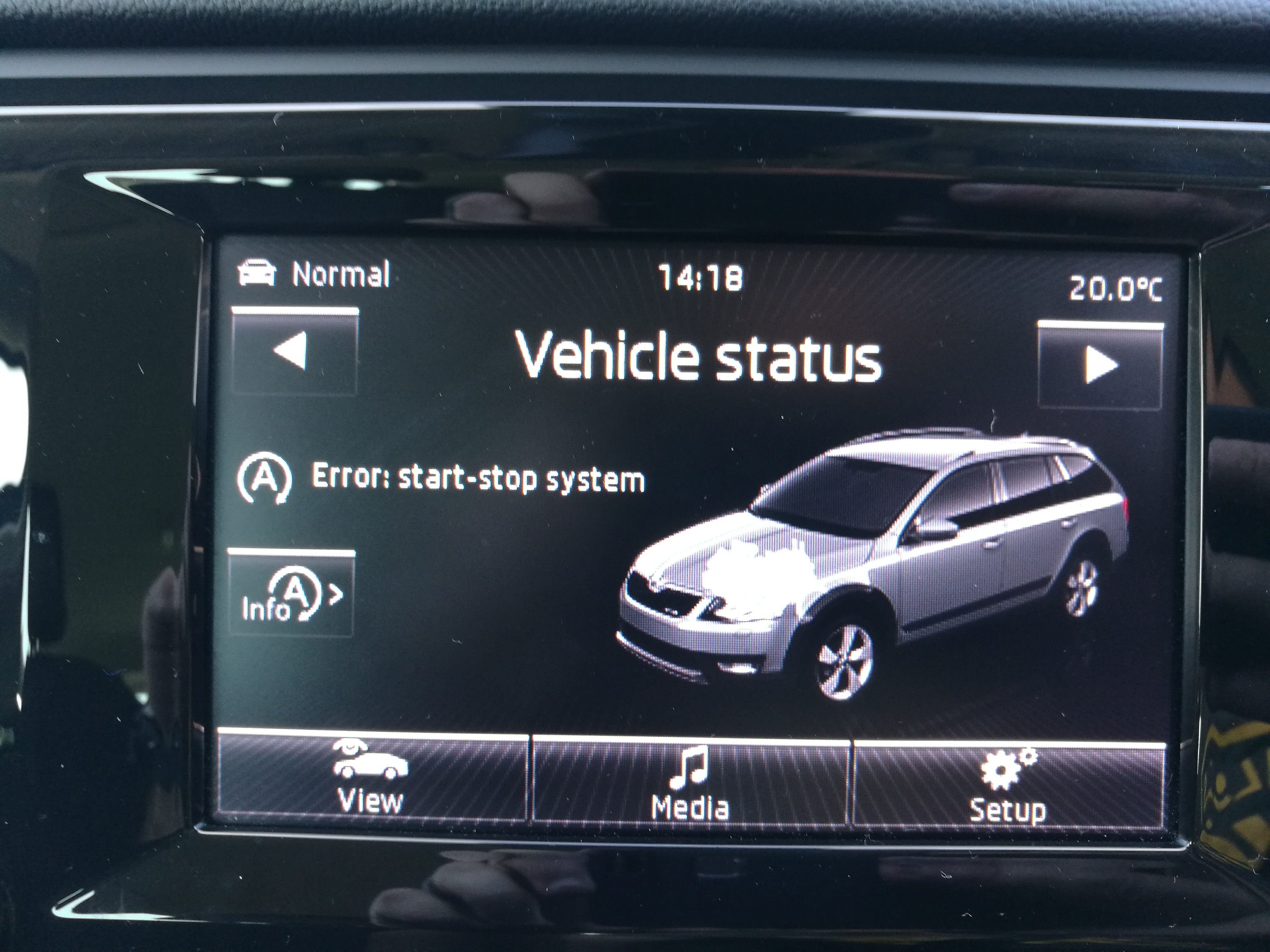

So im an Octavia owner again and love it, however, on several occasions now my car has struggled to start and brought up a 'Start stop error'. So heres the sequence of events:
I hop in the car, turn the key so lights all come on, whilst the glow plugs do their bit I put my seatbelt on.
I then turn the key to start the engine, and it struggles to start, it turns it self over 5-6 times (today when I picked it up from the skoda garage it did the worse yet, turned over so much it stopped itself trying to start then started up again!!)  before starting then displays 'Start stop error' in the display!
I turn rhe car off and immidientlt back in and it starts perfectly and no error message.
Its been in with the dealership all weekend but they can't do much as theres no fault code to go off! Then as I started the car at the dealership it did it again! (As mentioned above) the worst its ever done it!

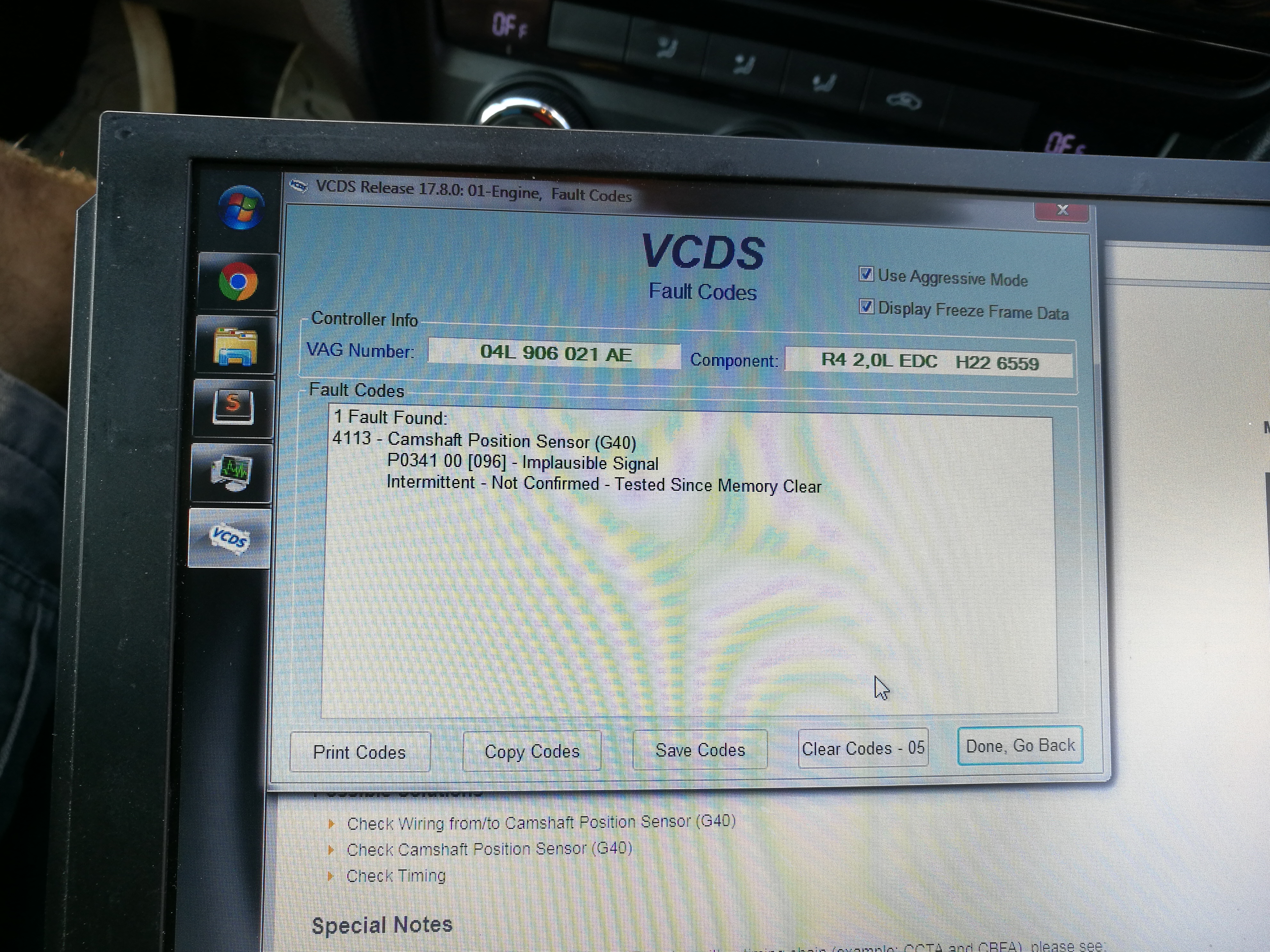

When it first happened, I had the breakdown come out and they found a fault code on the system to do with the crank shaft position sensor. They said its possibly to do with this if the engine doesn't know where things are lined up?!?! It had a timing belt change last year (its a 14 plate) because of a failed water pump. Could it be the possibility of it being replaces wrong?
Just wondering if anyone has any ideas???
I've attached some pics of the error, and the fault code.
Any help is welcome.
Thanks

I would suspect that the error with the crankshaft position sensor is causing your problem.
These sensors can be sensitive to how they are fitted as they operate with a very small gap to the trigger Wheel that they are detecting.
When the garage looked at it last time, did they change, replace or try to diagnose any problems with it?
When it has this problem, are there signs that fuel is being injected like stutters/stumbles with the engine or is it just dead-cranking?
If there is a problem with the crankshaft position sensor, the engine will not be synchronised & the injectors will not be activated.

Hi,
When it starts, it simply turns over and over, doesn't stutter or judder.
The problem is, when the fault occurs it needs to be plugged on to diagnostic to see a code. When I turn the car off and restart, the code seems to be cleared! The annoying bit was, when it happened at the garage when I collected it yesterday, the techs were all packed up and walking home so couldn't stick it on the diagnostic there and then! Which meant I'd of stopped the car and the fault would of gone.
I don't know what testing they did, I kept trying to point them in direction of the sensor and the possibility of timing (maybe to do with the cam bely change??)
I guess its not impossible that they mabe slipped a tooth when refitting the belt & water pump but normally the engine is pinned in position during the proceedure so it shouldnt happen.
However, I would expect there to be more problems than just intermittant starting in this case as you would be running with a perminant offset.
I dont know where the sensor is located relative to the water-pump but perhaps the wiring loom, connector or sensor was damaged/dislodged during the proceedure causing an intermittant problem.
It is strange that the fault code dissapears & cannot be viewed afterwards.
When a fault is not longer present the error code should be shown as a "pending" or "historic" DTC.
Are you sure that VCDS is not clearing the fault codes automatically when you disconnect?
