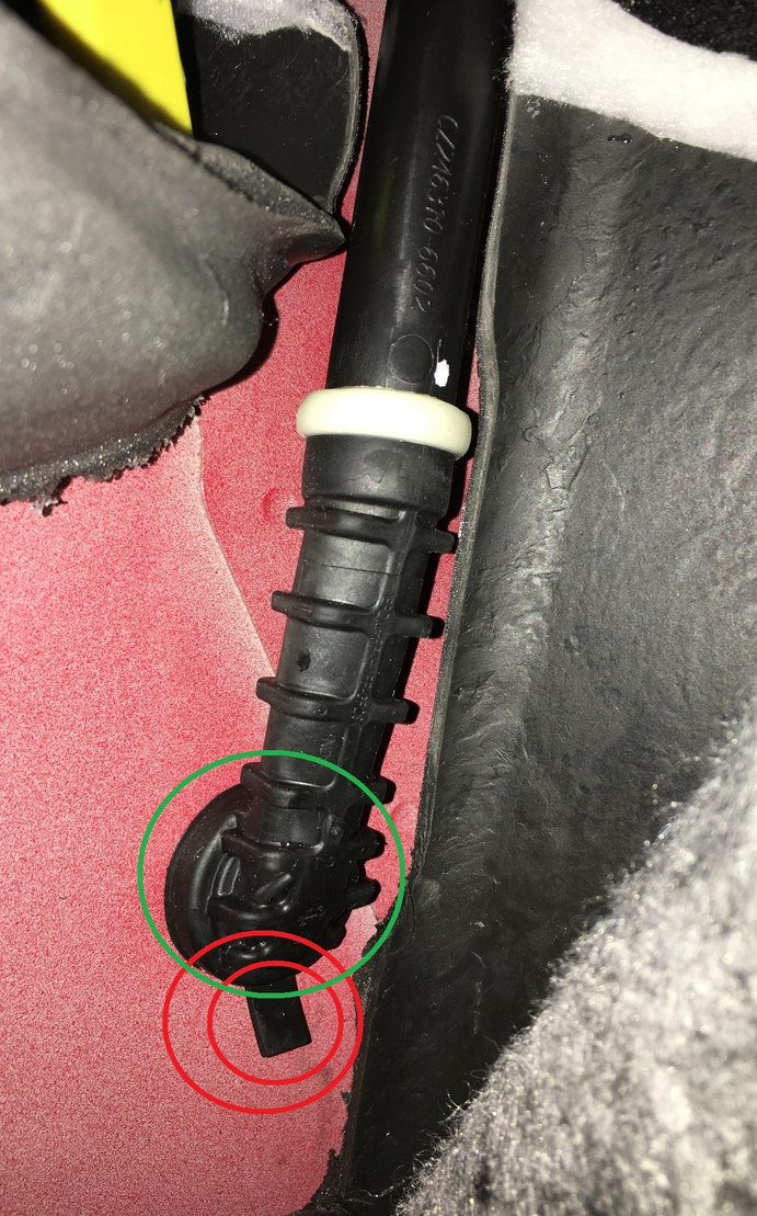

Hi there,
I am new to Skoda, and this first experience is not exactly perfect.
I bought my Superb Combi MkIII L&K in july. It was brand new, and has now a little more than 8.000 kms on the odo.
Last sunday, as I was cleaning the car (I know, how original), I took the floor mats out. The rear passenger mat was dripping wet...
It was not as bad as SEtech's car, but you could hear the squishing sound of a soaked sponge when pressing down on the carpet.
I did not relate it straight away but my bluetooth connection started to become irregular a couple of weeks ago. Could it be related? I dunno...
On monday, the dealer checked the sunroof drains, and they both seem to run perfectly. They had no time to take it so the the car is going back there next Tuesday.
In the meantime, it did rain and that didn't seem to worsen the situation.
Conversely, as I have already encountered a similar problem with a Nissan Pathfinder, I stopped using the A/C. And that did seem to work; the carpets are now noticeably drier.
I also switched back on the A/C, with full fan and maximum cold, in my garage, for 10 minutes. Not a single drop of water on the floor.
So maybe, it is a clogged A/C drain. But that does sound weird for a 3-month old car.
The dealer plans to keep it at least 3 days.
I will keep you updated.
A quick update - dealer got the car back from the company setting the windshield and it was still leaking. They ended up sending it back twice more because of it still leaking! Now it is apparently all good and tested and I’ll get it back with mats and insulation replaced on Tuesday...
Hope you get yours fixed @JFCarter
Thanks @SETech ! Quick update on my case: I finally dropped the car today as the garage was too busy to take my car on tuesday. It did not bother me that much as I work a couple of kilometers away from the garage. They looked at it, and called me in the afternoon: the culprit is a badly installed A/C drain. Apparently, the pipe was twisted in the factory and got clogged rapidly. They ordered a new piece and I should get my car  back tomorrow. They do not plan to dry the carpets and soundproofing as it would mean a complete removal. They think moisture will slowly evaporate. They will only provide me with an antibacterial spray, to prevent bad smells during the evaporation process. Kinda odd.
EDIT: the A/C drain on my car looks exactly like the one pictured above, but I don't know yet which part was twisted. I will try to know more about that tomorrow and will report.
