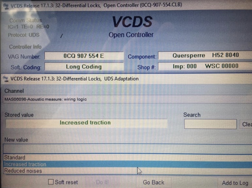

not sure if anyone has seen it yet but it looks like it’s possible to turn up the performance of the VAQ diff fitted to the Octavia.
under the adaptations there is an option to set it to increased traction, apparently the guys on the GTI forums have noticed a significant difference with this mod on the grip and performance.
i haven’t been able to test it yet but apparently it also may work the same on my R for the rear Haldex diff.
From the factory it is set to standard
credit goes to the GOLF GTI forum, the DRIVE TRIBE forum and the Audizine forum.

It should be as it’s the same Haldex system as the R.
go to module 22 AWD instead and make the mod.

I’m not sure but the Cupra may be set to increased traction as standard, but check with VCDS.
What effect is there likely to be practically? It won't alter the front/rear bias, as I understand that is electronically controlled? I can understand it being obvious on a FWD. One way to find out I suppose...:biggrin:

I'd read that people thought it might be a hardcoded setting that could only be altered by remapping the VAQ ECU, I'd hoped otherwise, same as the XDS setting on the MK2 which can be altered with VCDS with great improvement.
This really should turn a great handling FWD VRS into an excellent handling one!

Tried it on my golf R and it makes a difference - much more planted and neutral (FWD or RWD) under hard cornering

Nothing much to crack. Just had a look in Module 22 - AWD and it's there as an adaptation option.
